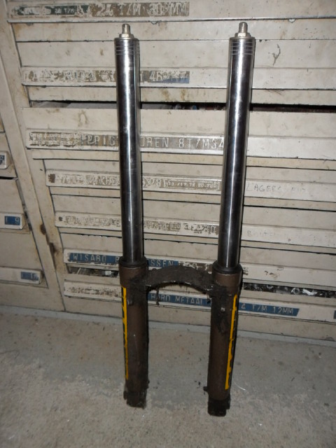

It will be a sporty looking bike.

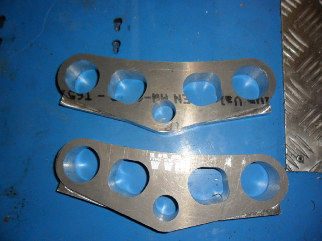

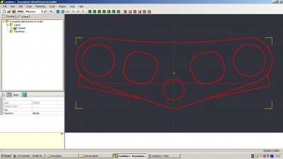

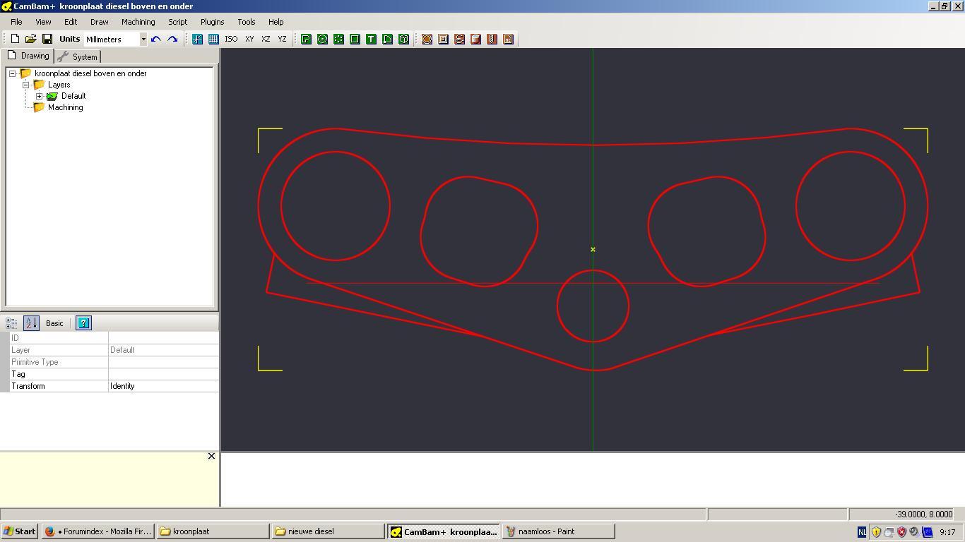

I started with making the easy parts.
Here are the first parts.
A set of triple clamps.
Made out of 6082 T6 aluminium.
Cnc milled.
Cnc milled.

Good to see someone else using CamBam.
- boutje
- Posts: 69
Re: Bike with homebuilt engine
I have several cadcam programs.Mouse wrote:Good to see someone else using CamBam.
But i find cambam the best one.

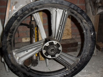

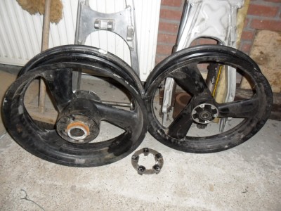

I have bought a set of ligthweigth brembo wheels.

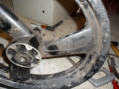

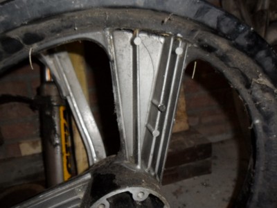

And i lost more weight on the wheels by removing the spoke covers.
Each cover weighs 500 gram.
So the total weight reduction is 1.5 Kg each wheel.
The next step is to sandblast the wheels.

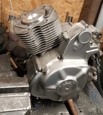

- boutje
- Posts: 69
New start with the project.
Because i was very busy in my own company (making motorcycle parts and building motorcycles) i had no time for this project.
I started with the engine build a few weeks ago.
First i wanted to build a complete new engine , but i took a suzuki dr650 engine as a base.

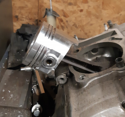

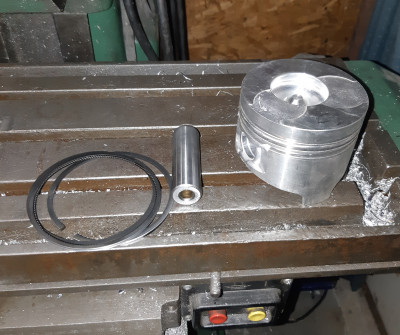

- boutje
- Posts: 69
And back on the project.
and from now on I will continue with the diesel every Saturday or Sunday.
I took a piston from a lifan 192 diesel because the piston pin exactly matches that of a suzuki dr650.

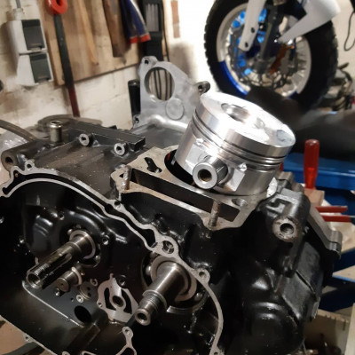

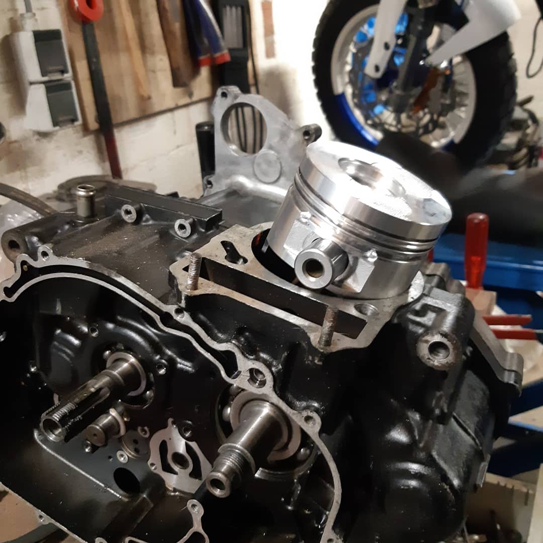

- boutje
- Posts: 69
the piston is about 6mm higher than the dr650 piston.
but a new cylinder liner has to be made.
make it 6 mm longer and make a pocket into the cylinderhead .
