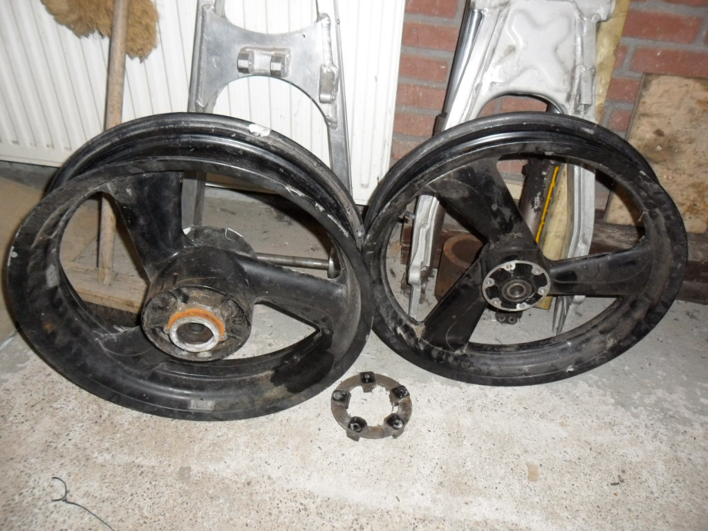

Some update on the build.
I have bought a set of ligthweigth brembo wheels.
Set of wheels
Set of wheels

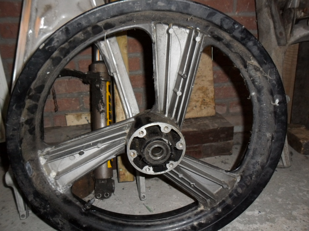

And i lost more weight on the wheels by removing the spoke covers.
Each cover weighs 500 gram.
So the total weight reduction is 1.5 Kg each wheel.
The next step is to sandblast the wheels.
Total overwiev of the wheel without covers
The spoke without the cover
Closeup over the wheelcover
Re: Bike with homebuilt engine
Aerodynamic drag w/out those covers might be more of a gain then the weight you reduced? Besides what weight you keep you want down low. But judging by your post you know shiats more about this stuff than I do :oops:

Post by boutje »
You are absolutely right about the drag.
But the advantage of light wheels are much bigger than the drag isseu of the wheels.
Light wheels give a much better handeling in corners (specially good for the suspension) , better braking and a better acceleration.
