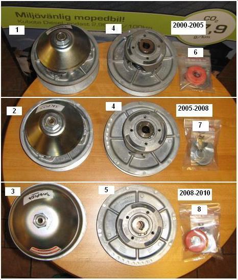

Description / [Pictured Part] /Part #
Drive (Primary) Pulley-Clutch [1] 3WP22 [2] 3AAP22 [3] 3AAP22A
Driven (Secondary) Pulley-Clutch [4] 3WP24 note 400 N / M [5] 3AAP24A
Repair Kits [6] R123 [7] R124 [8] R125 REPAIR KIT

these Primary Cluthes/Pulley seem to resemble the CVTech Series 06 buttt.... according to their website.... are not reccomended for mini cars
http://www.cvtech-ibc.com/client/page1. ... =4&clef2=2
Where the Powerbloc AT is
then again maybe the Powerbloc ALT was not available before 2010?
Re: Aixam CVT
the secondary seem to be the LP3 model
http://www.cvtech-ibc.com/client/page1. ... =5&clef2=2
