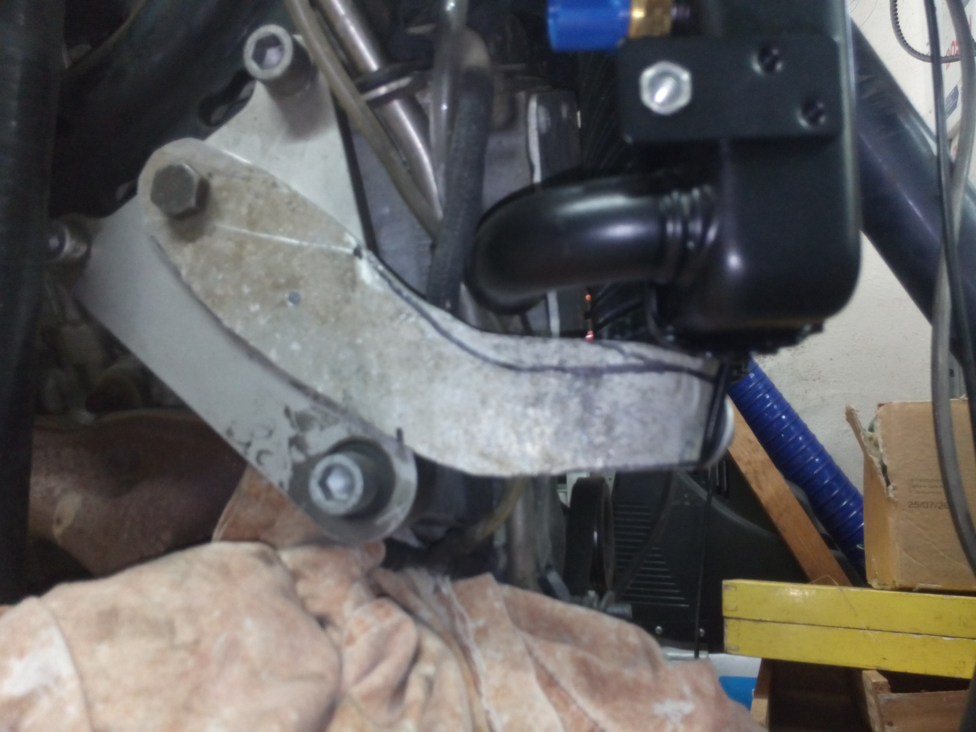

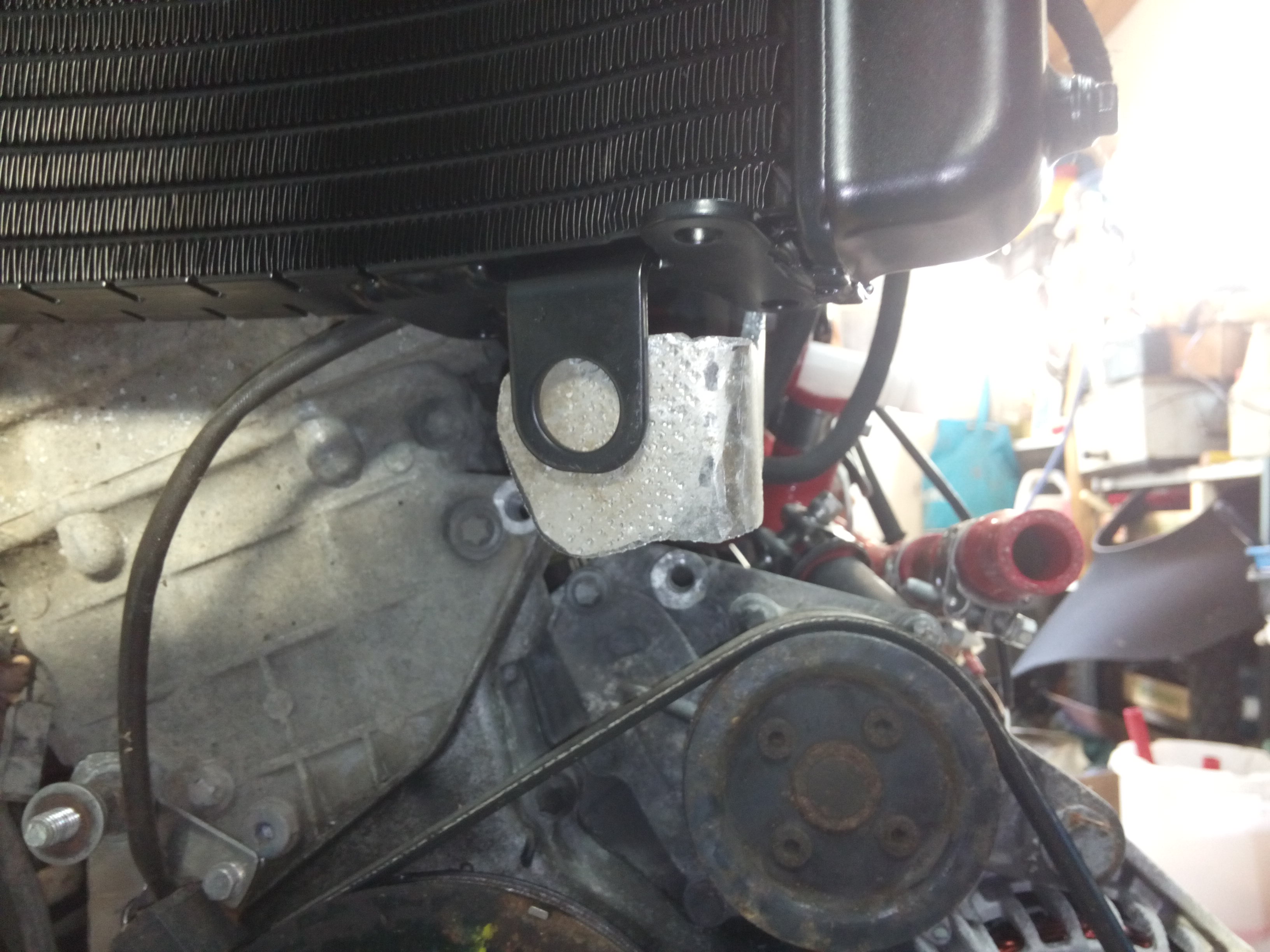

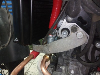

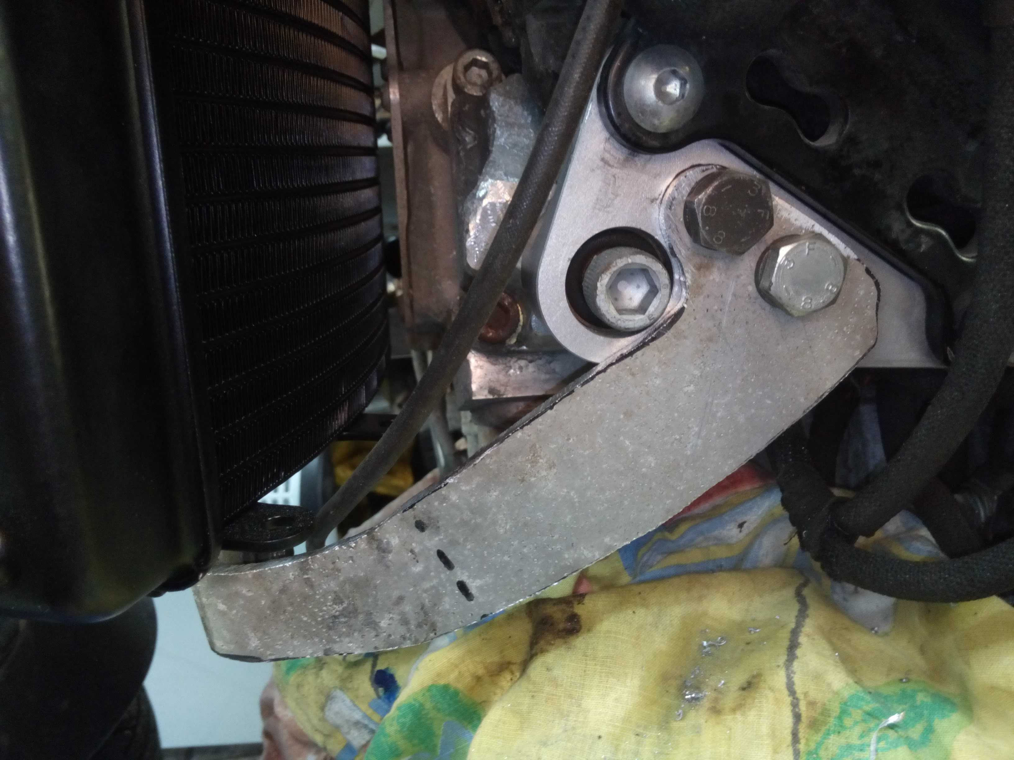

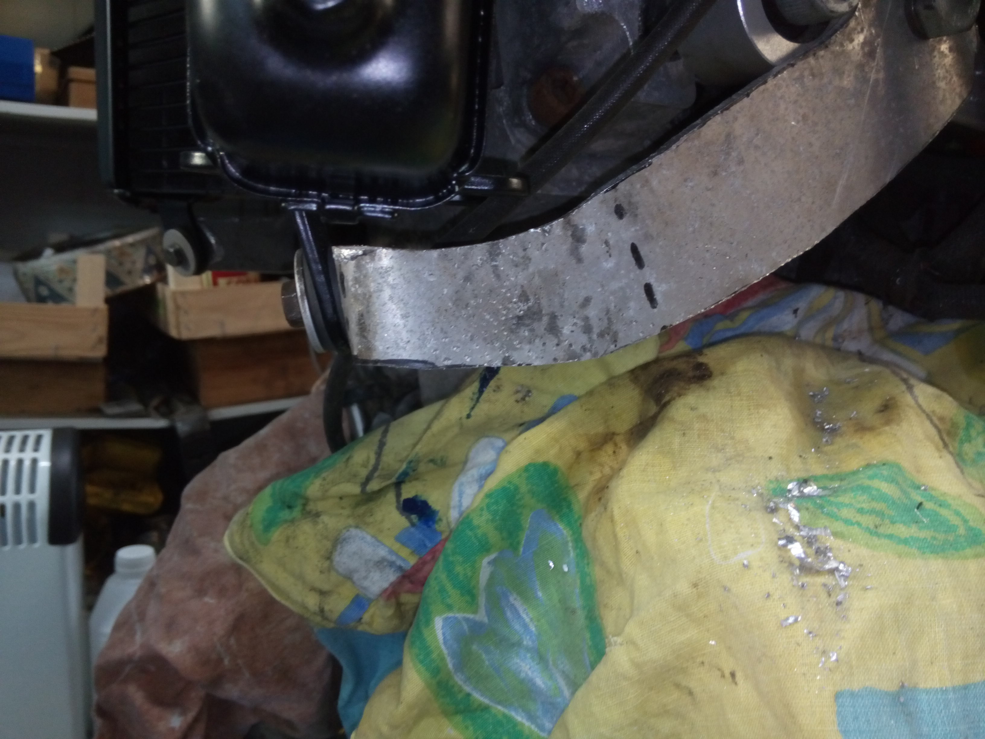

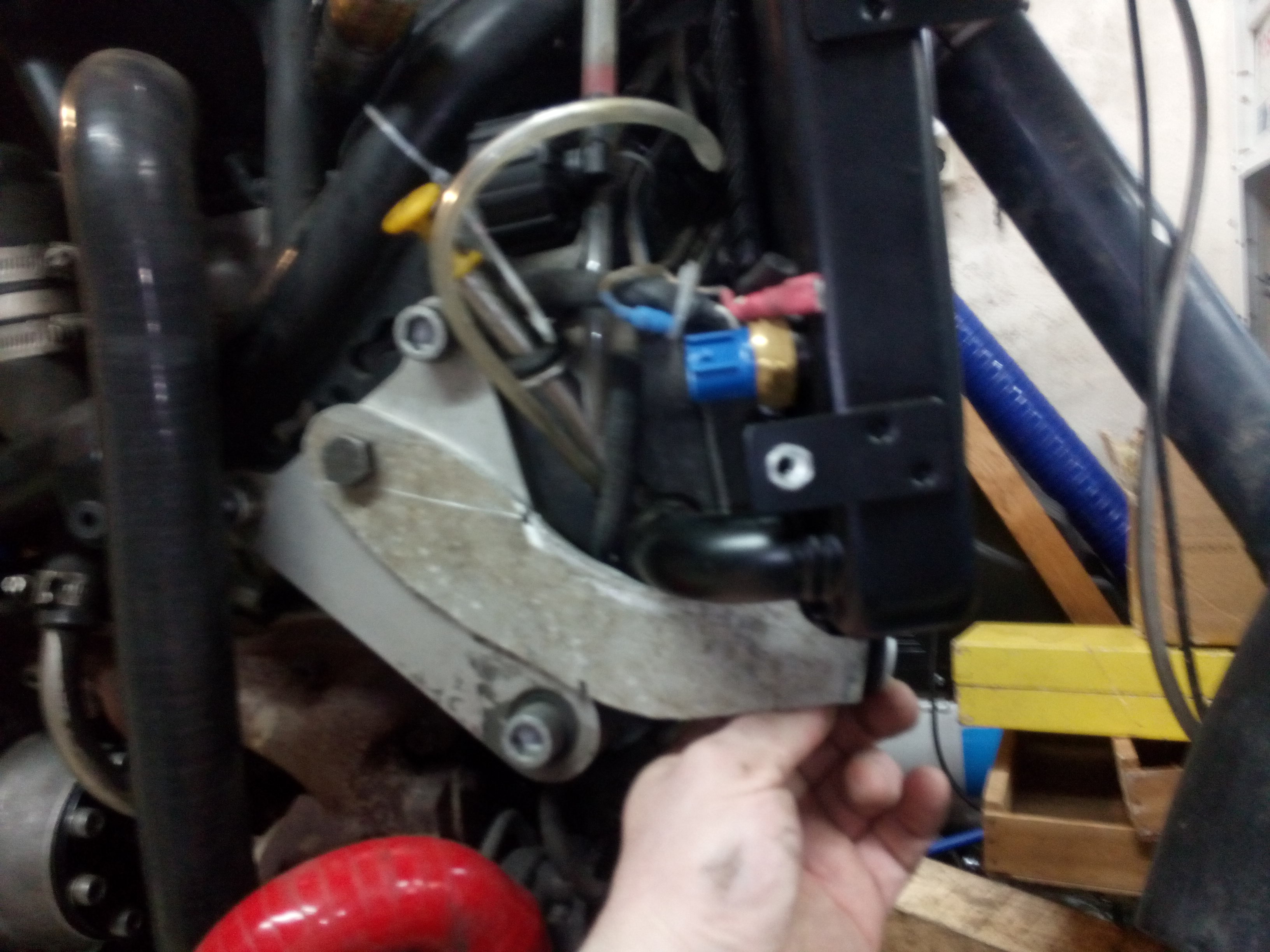

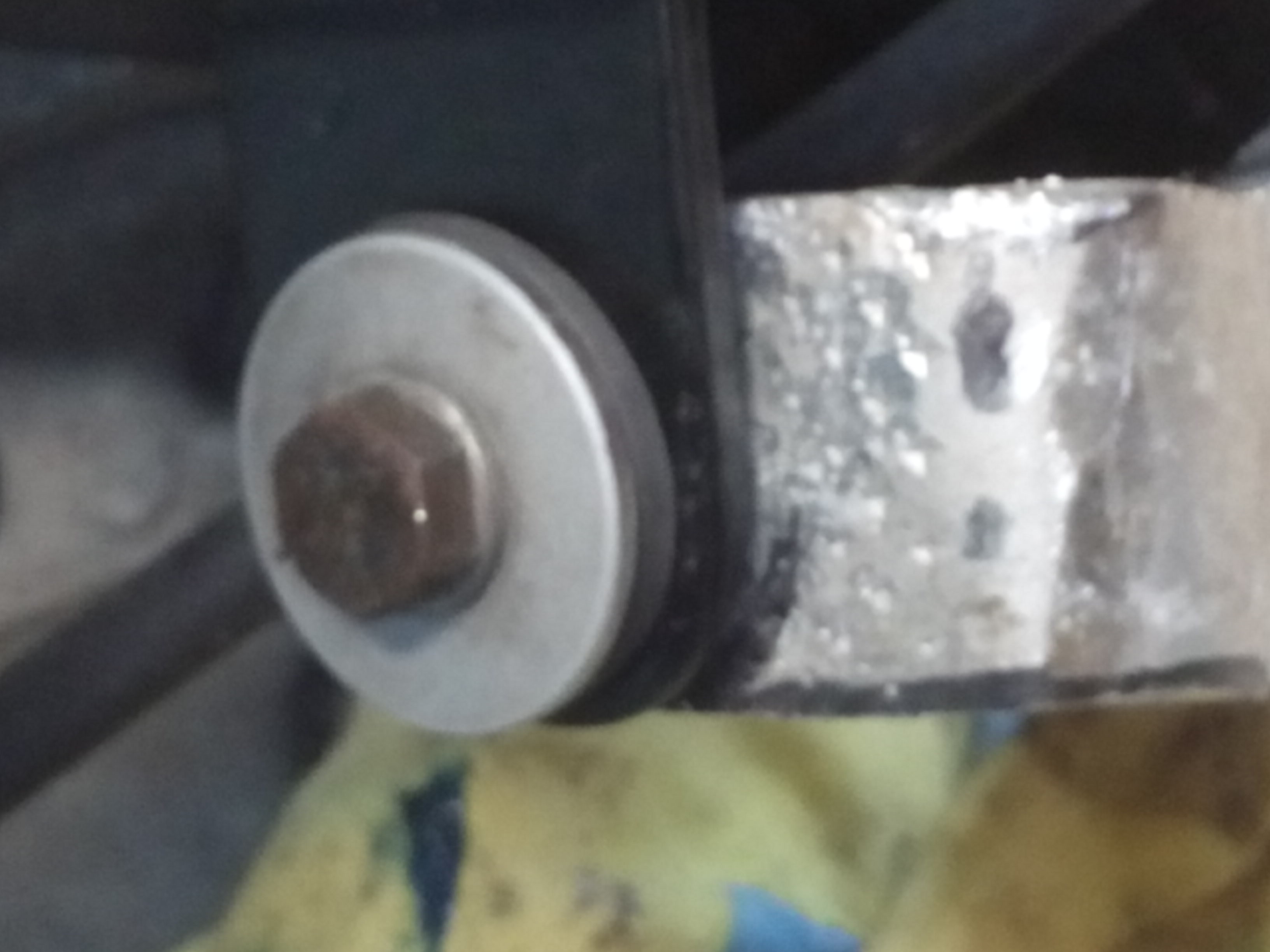

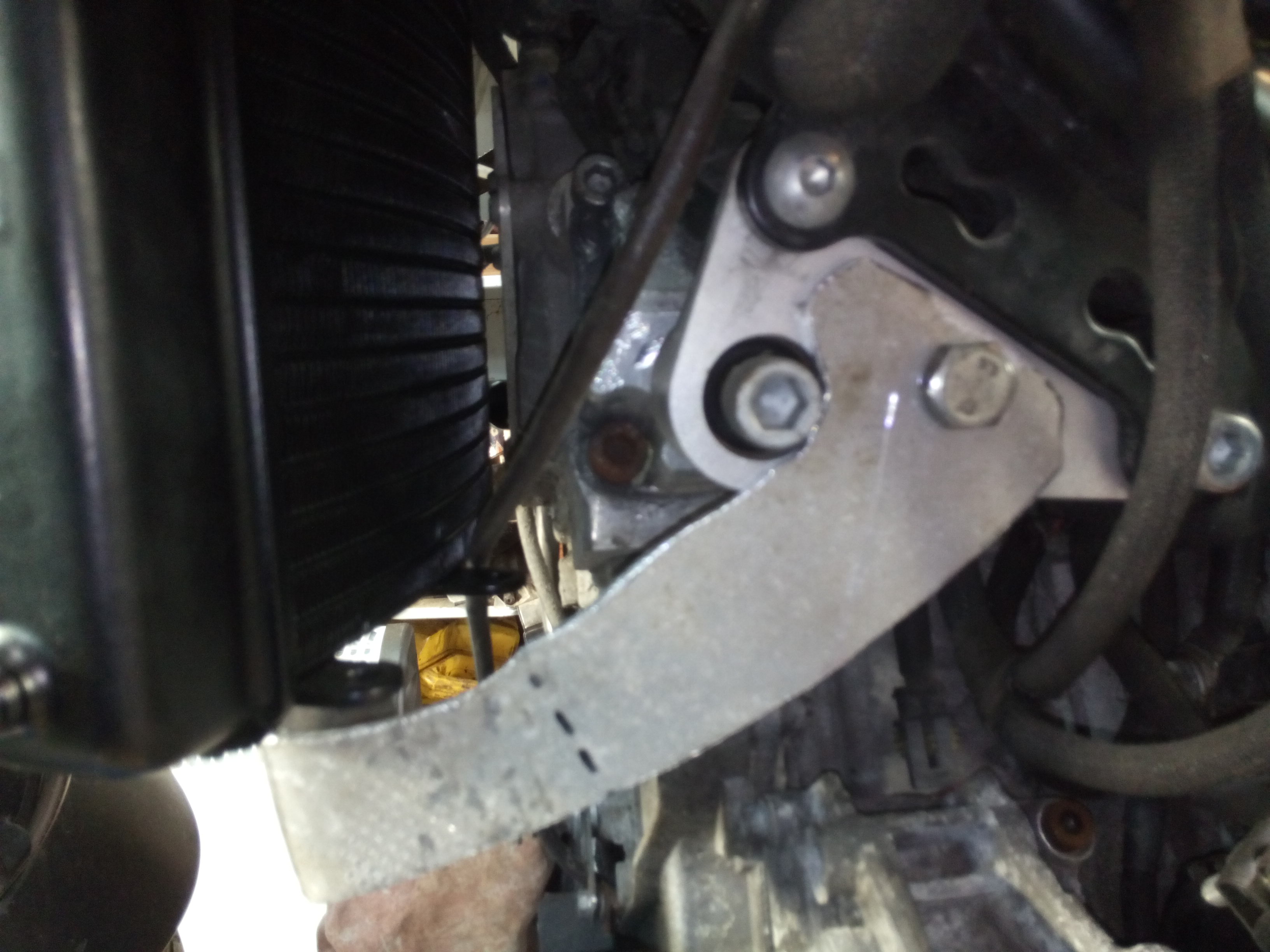

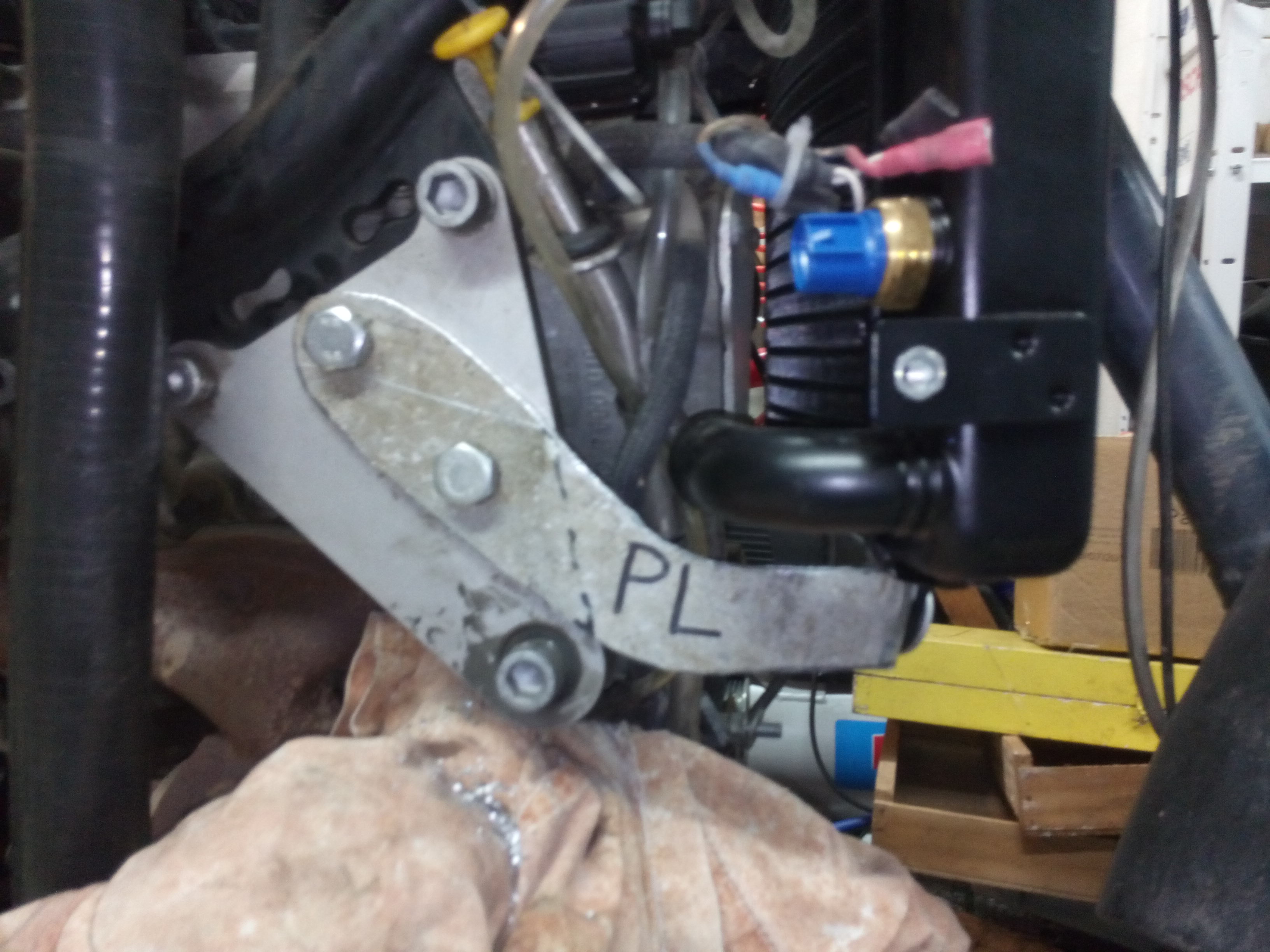

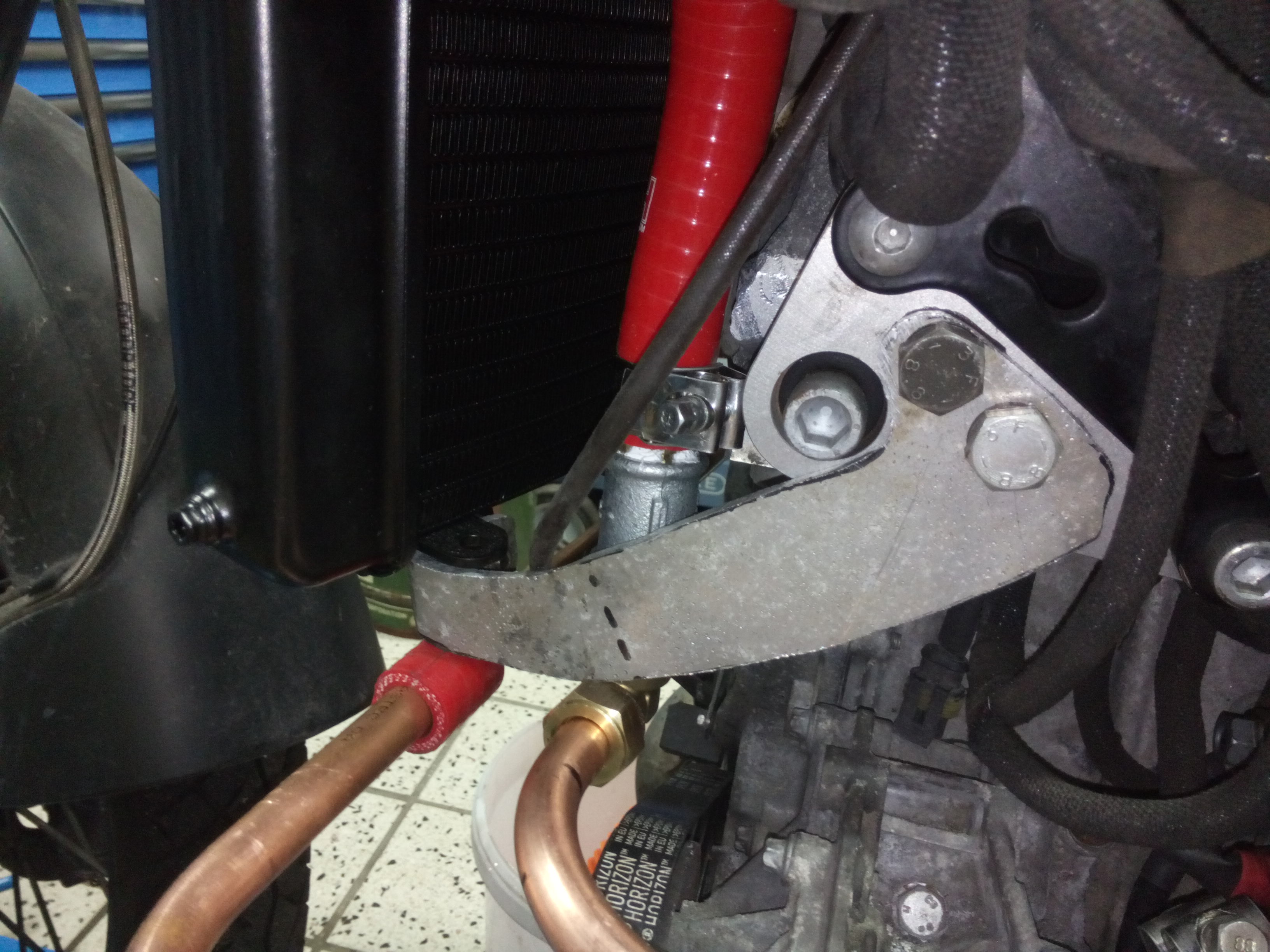

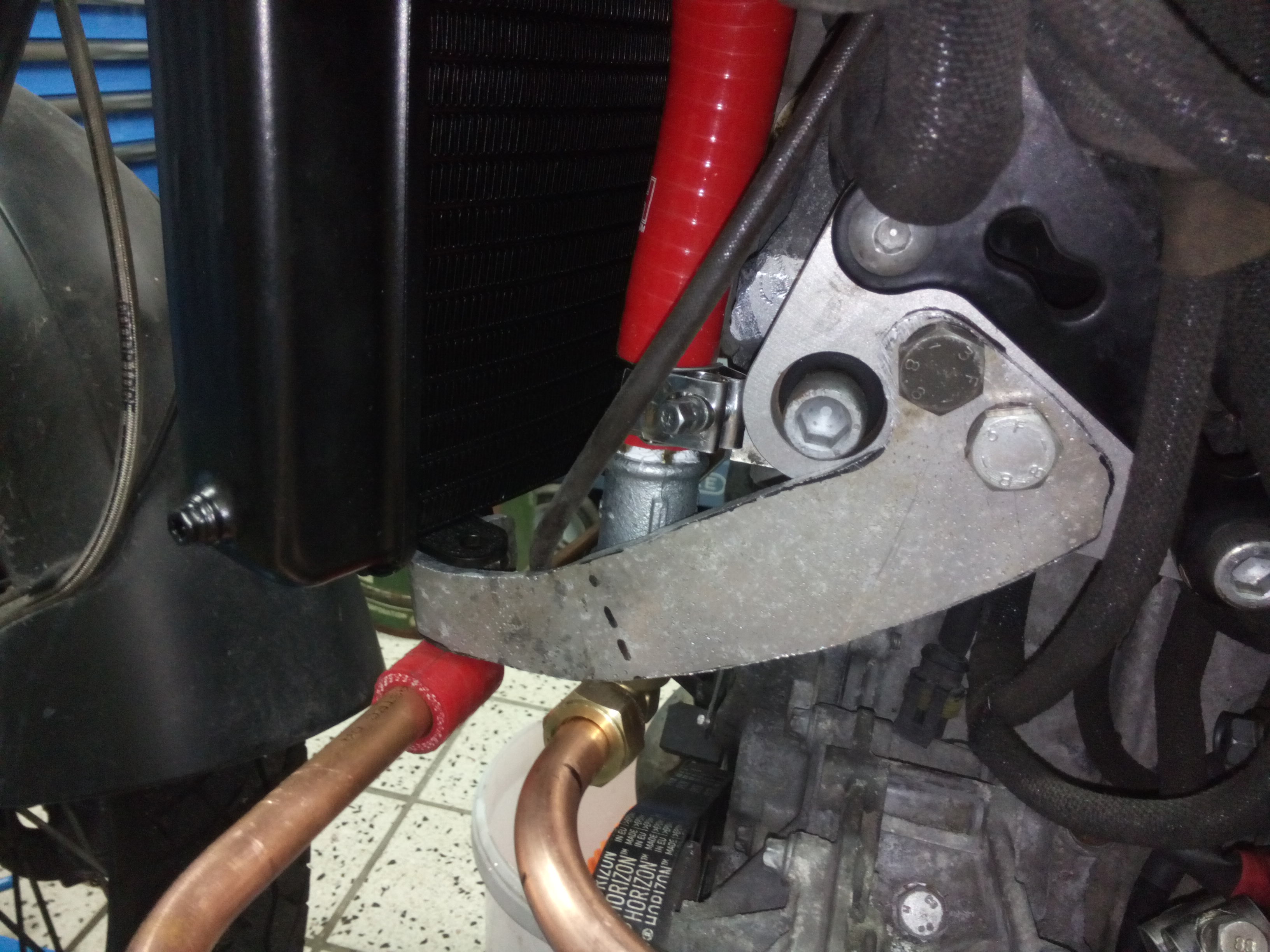

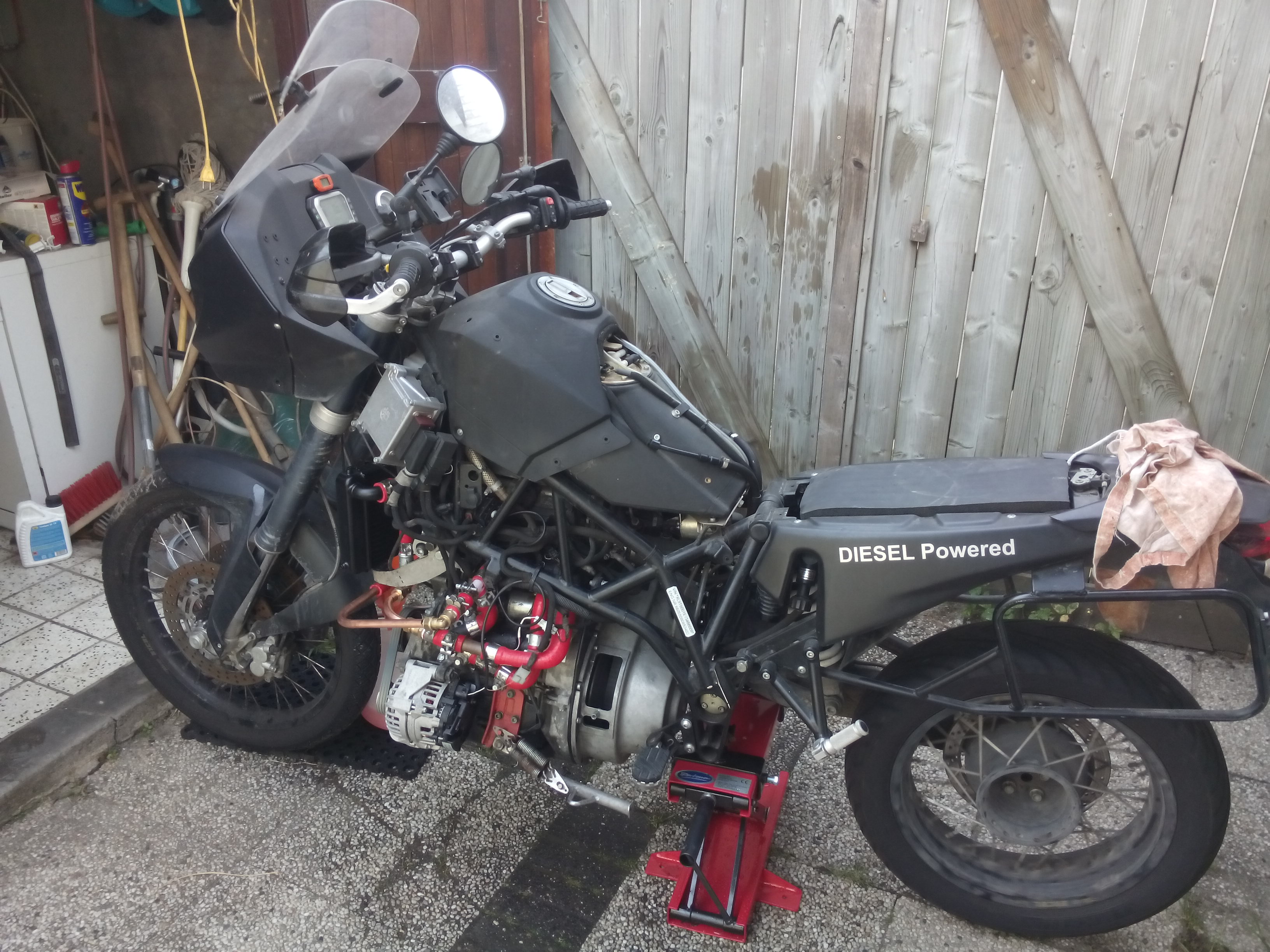

The c.v.t is back on and i have taken some time to come up with a piece of aluminium to (brace?) hold? It's 5 mm wide and easy enough to work with.
The original plate behind it is also aluminium. Tomorrow i'll start on the other side.

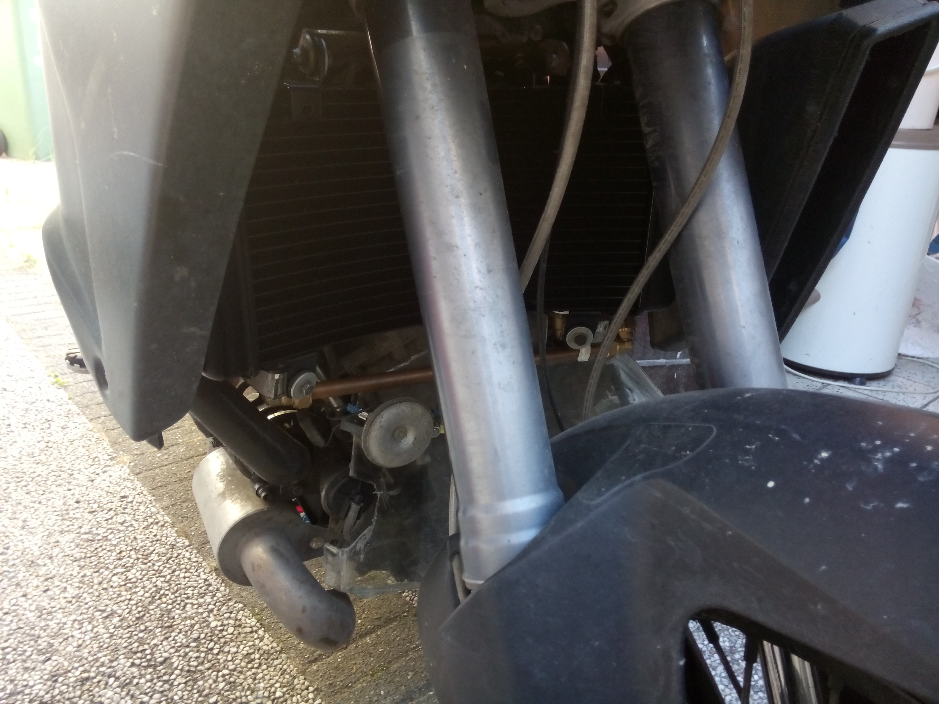

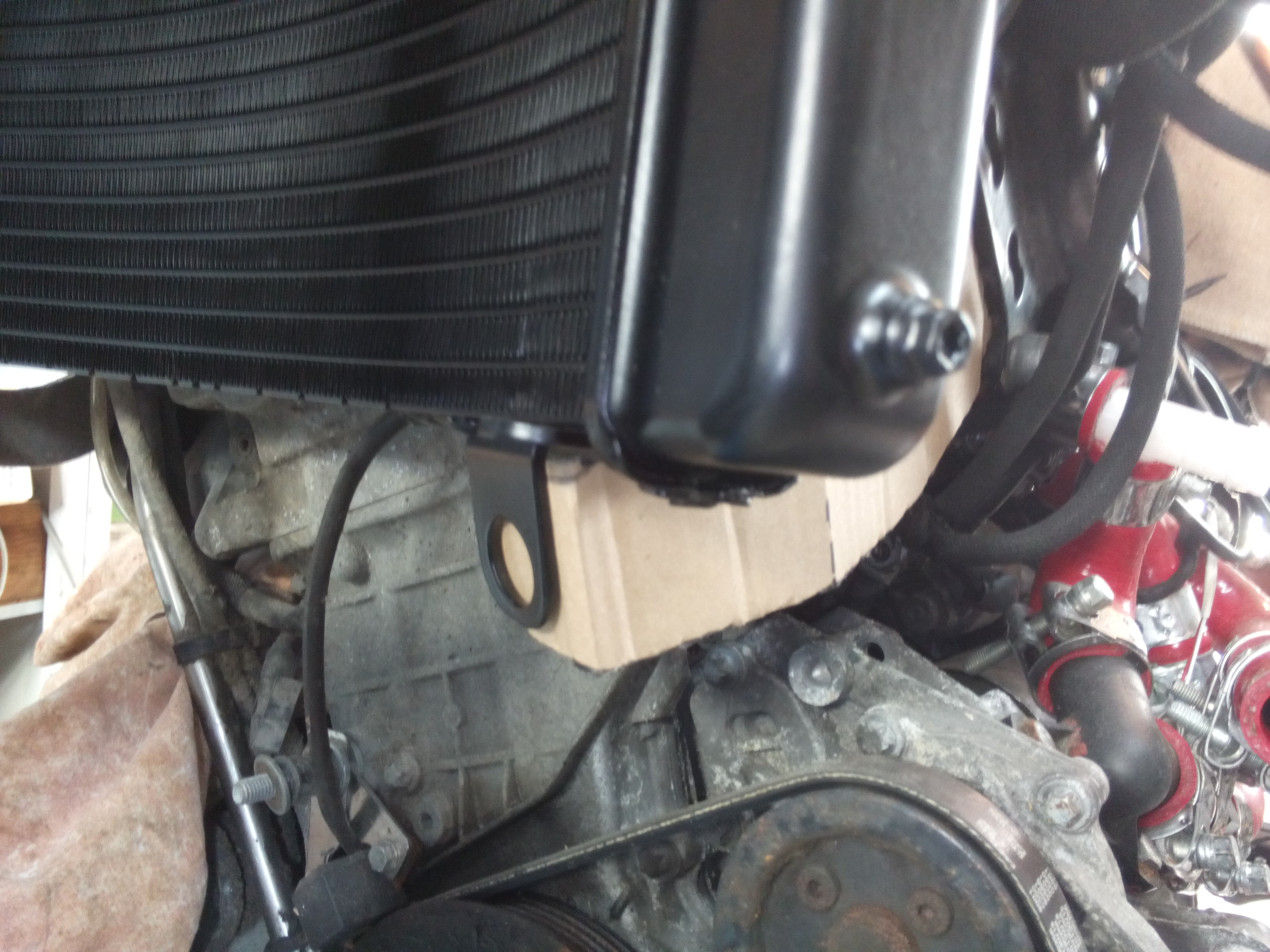

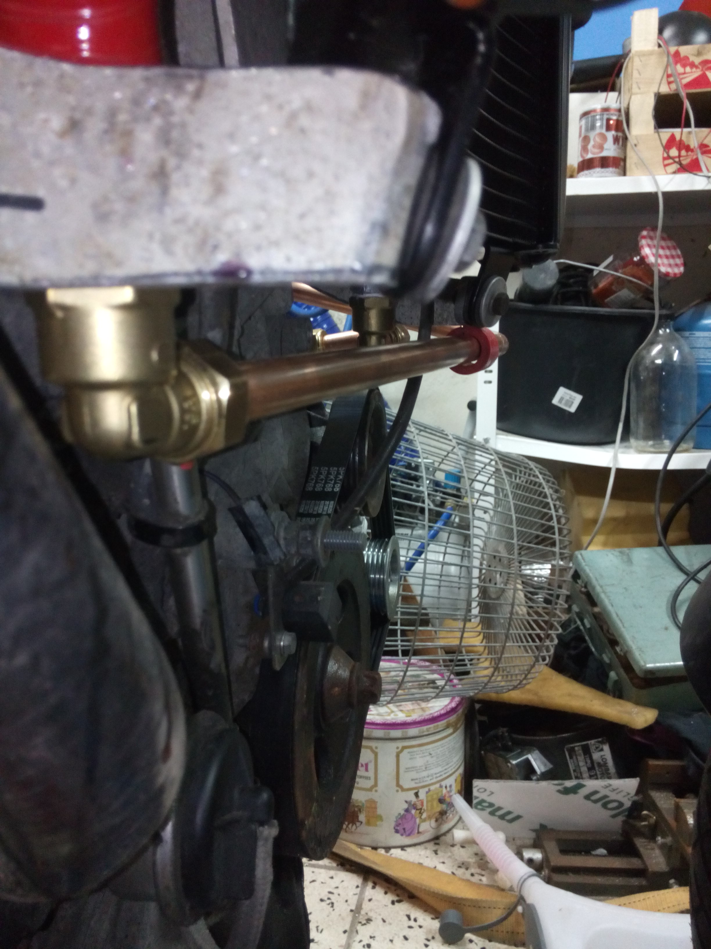

Hi Bert, Looking at the recent Radiator bracket pics, Is that an idler pulley for your modified alternator, or is it the water pump pulley?
Bob
Bob

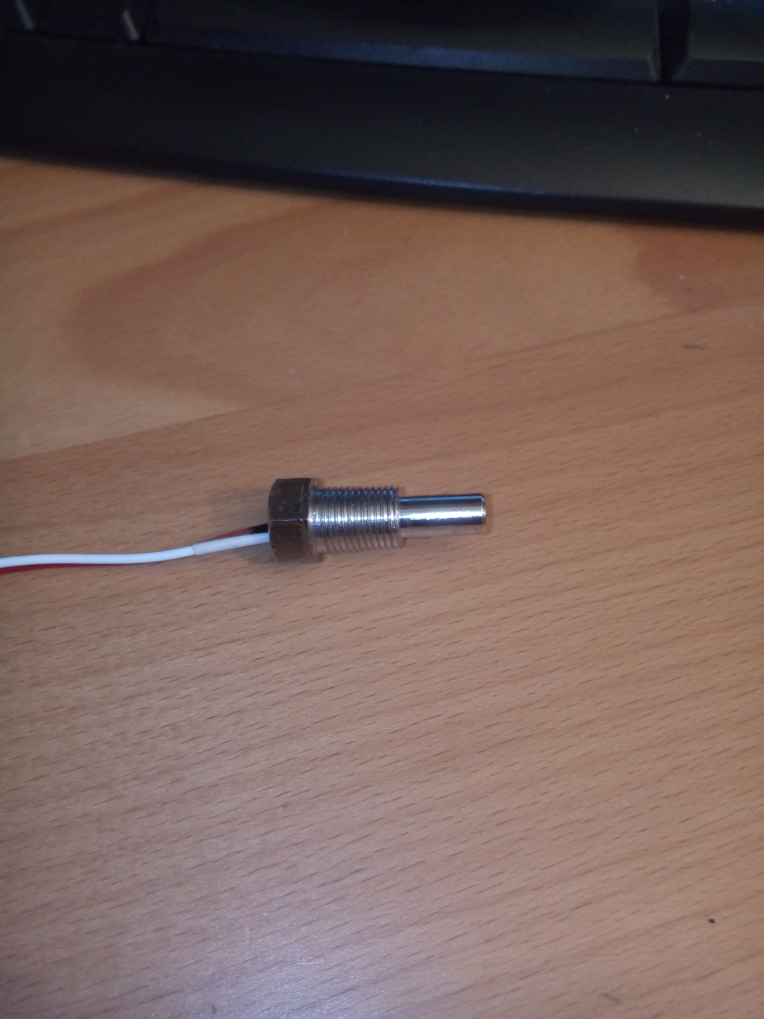

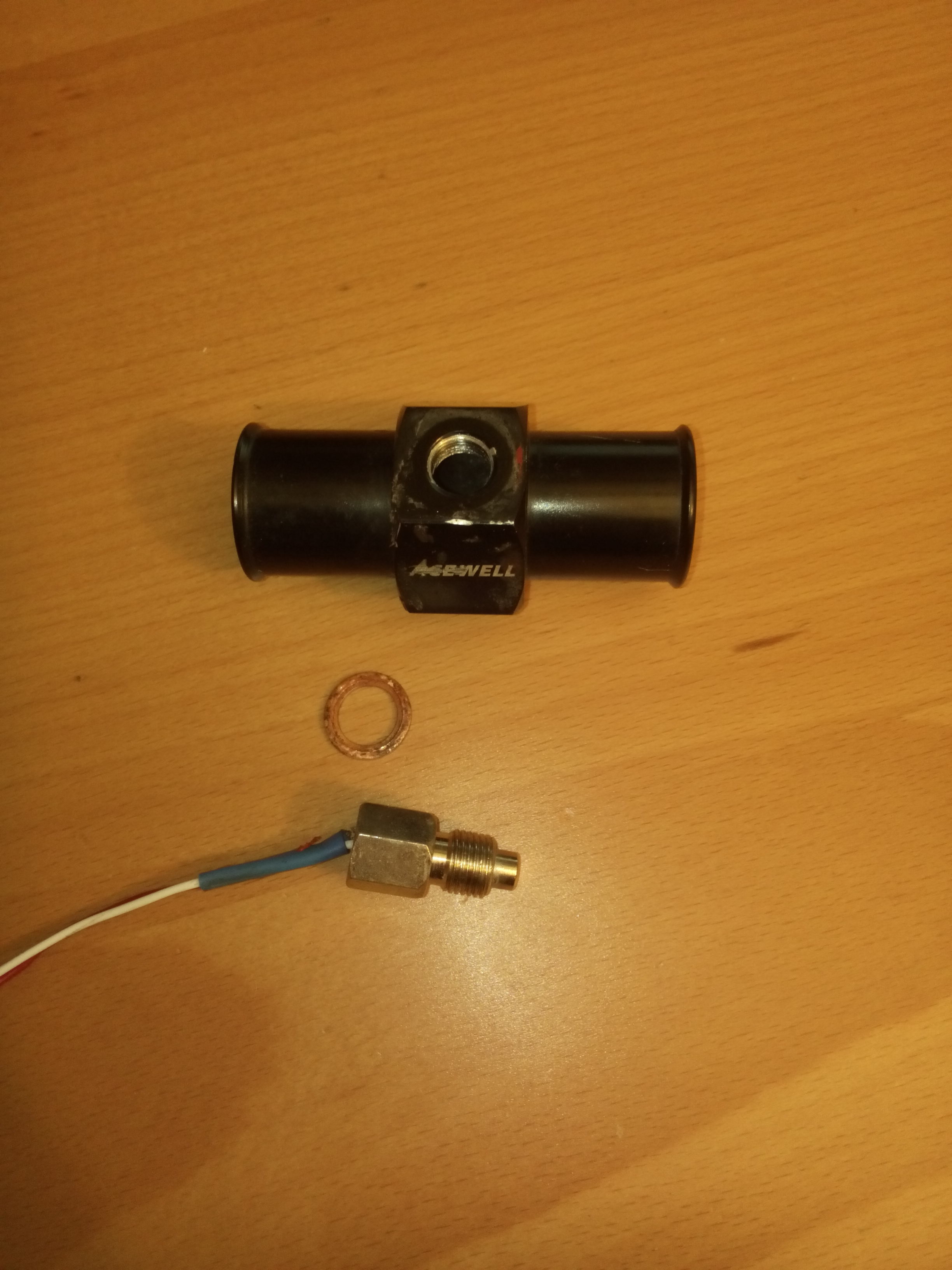

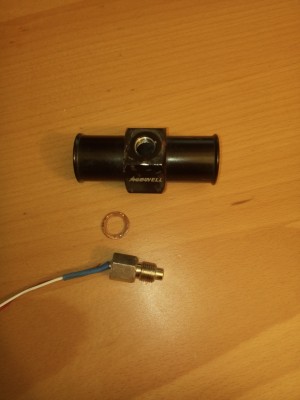

The 24mill temp housing by acewell. http://www.acewell.co.uk/Acewell%20Acce ... full&id=54
Comes with 1/8npt thread. Simple normal standard for measuring equipment. (in my line of work)
Anyway so what do i pull out of the original temp housing? M-10... http://www.acewell.co.uk/Acewell%20Acce ... full&id=32 Are you kidding me?
And this is what is supposed to go into such housing.

You don't state anything about why it is "wrong" one so am curious
. the website says these inline housings take the 1/8 npt sensor OR the M10 sensor so it may not be wrong at all
see: http://www.acewell.co.uk/Acewell%20Acce ... full&id=55
. One (the one Erik installed it looks like) would restrict flow of coolant less? That may be a good thing if that is the case.
. One will report temps different than the other? But if that is the case did Erik do anything to compensate for that or not?

Thanks coach. Didn't catch that!
But the 1/8npt is conical thread and m10 isn't so it messes up the hole.
Also judging from the thread remaining it fits but not exactly well. (M10)
I got some 1/8npt thread cutters so I'm making a nice self sealing thread in the housing and plug the other hole.

IMHO go with the smaller unit with the M10 threads so not to impede coolant flow as much.BertTrack wrote:....I got some 1/8npt thread cutters so I'm making a nice self sealing thread in the housing and plug the other hole.

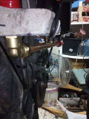

The temperature sensor is located in a coolant line that has a 2 mill diameter restriction in it down the line. I don't mind the ting sticking out.coachgeo wrote:IMHO go with the smaller unit with the M10 threads so not to impede coolant flow as much.
And i only got the 1/8th one new. The M10 is broken beyond repair.

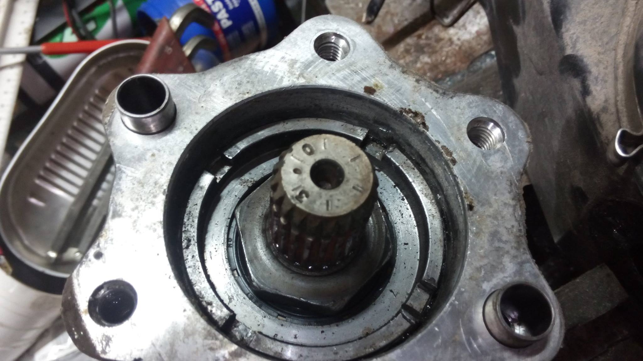

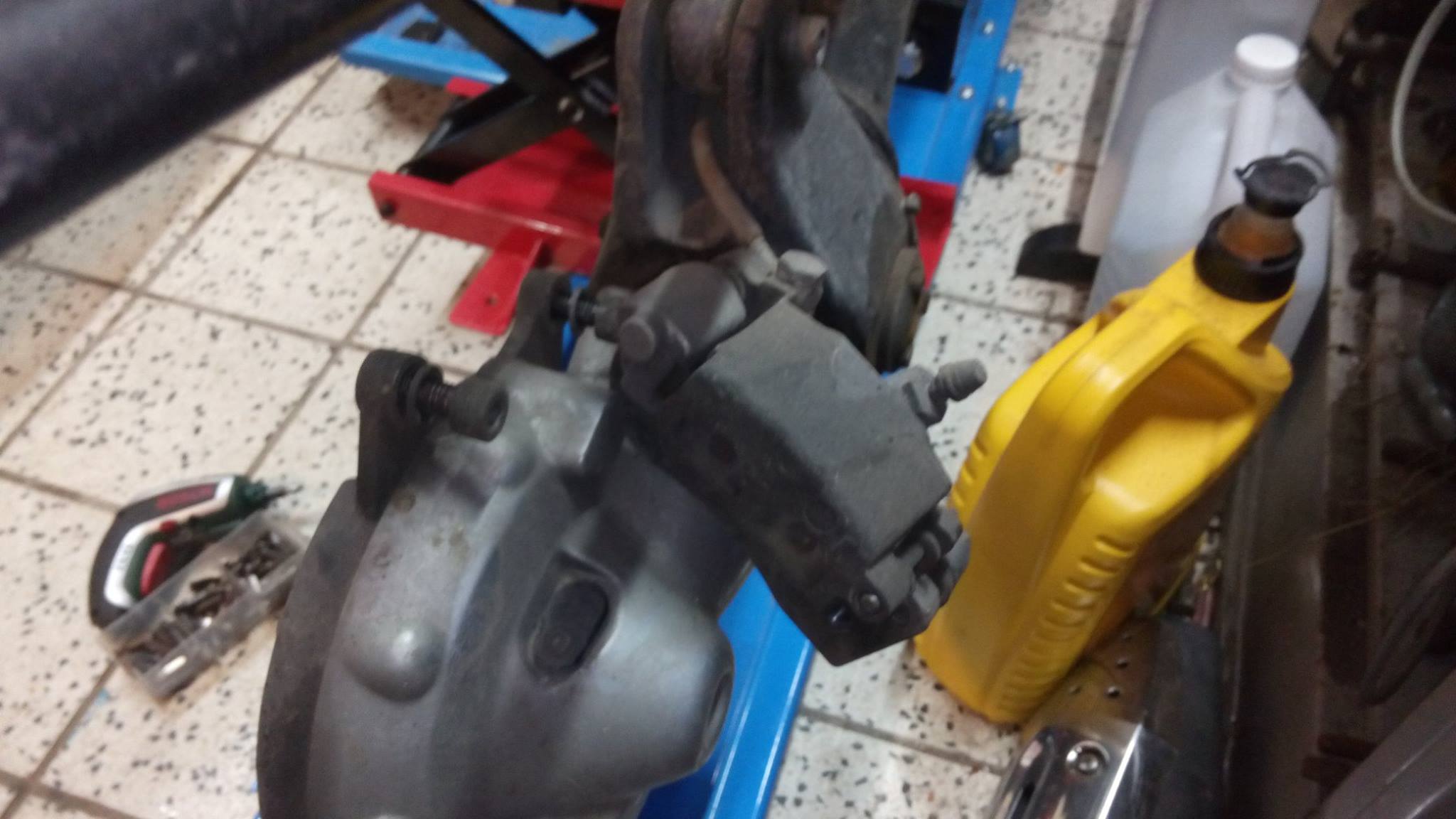

I took the next step and took out the secondary c.v.t. now looking for a much stronger spring. I want to say good bye to the ramps/helix parts.

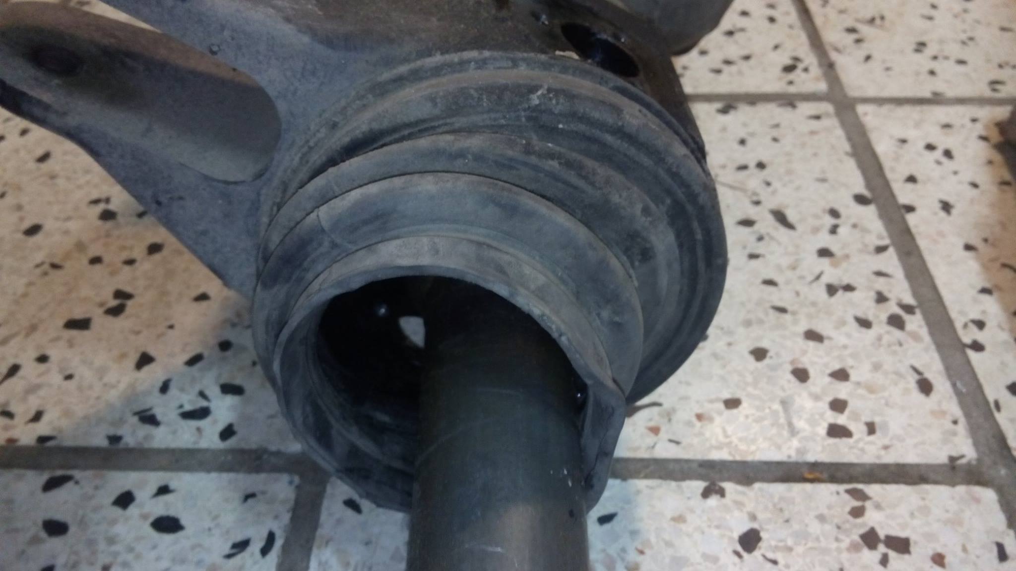

That Universal CV joint cover is holding out nicely btw.

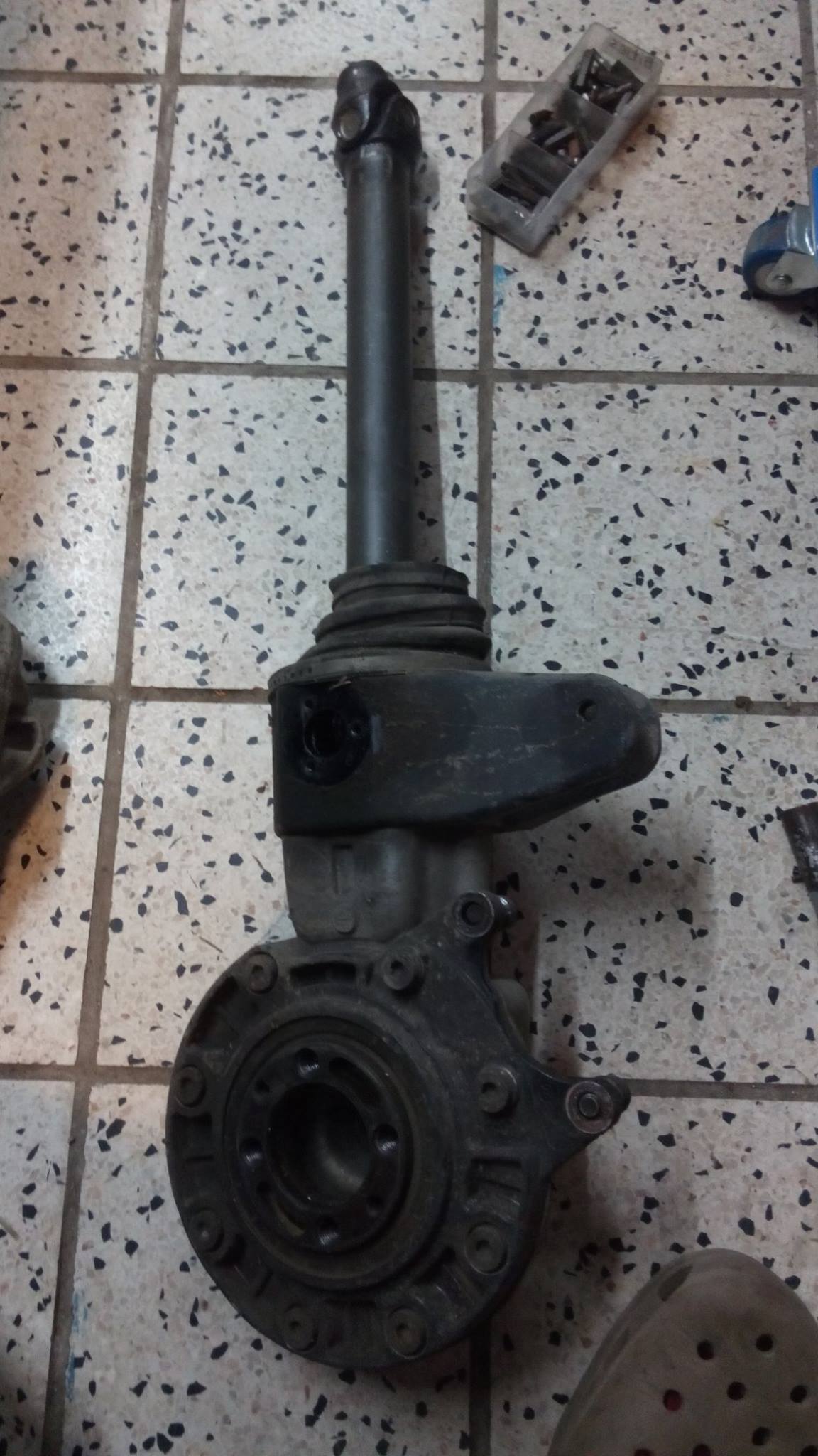

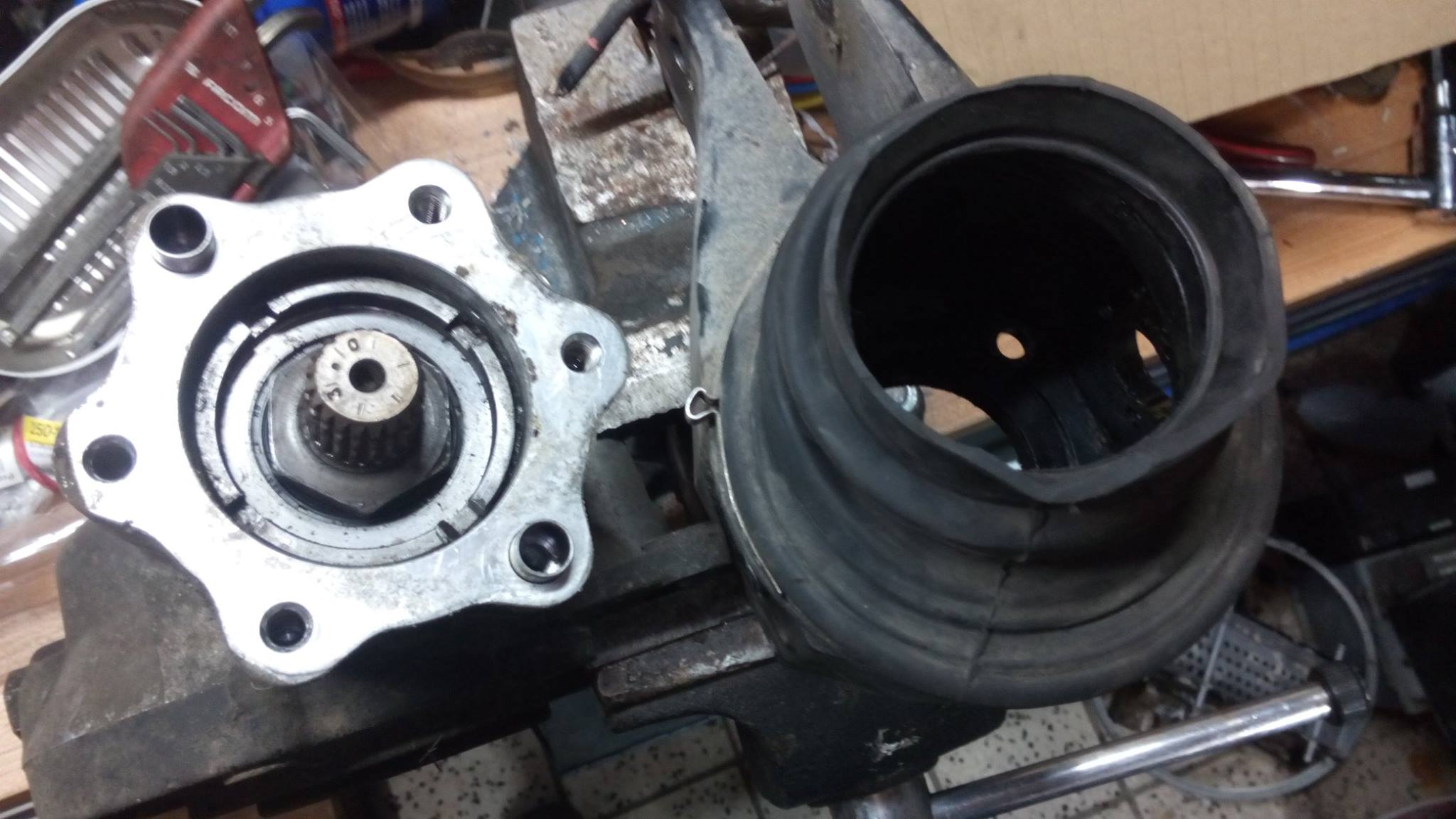

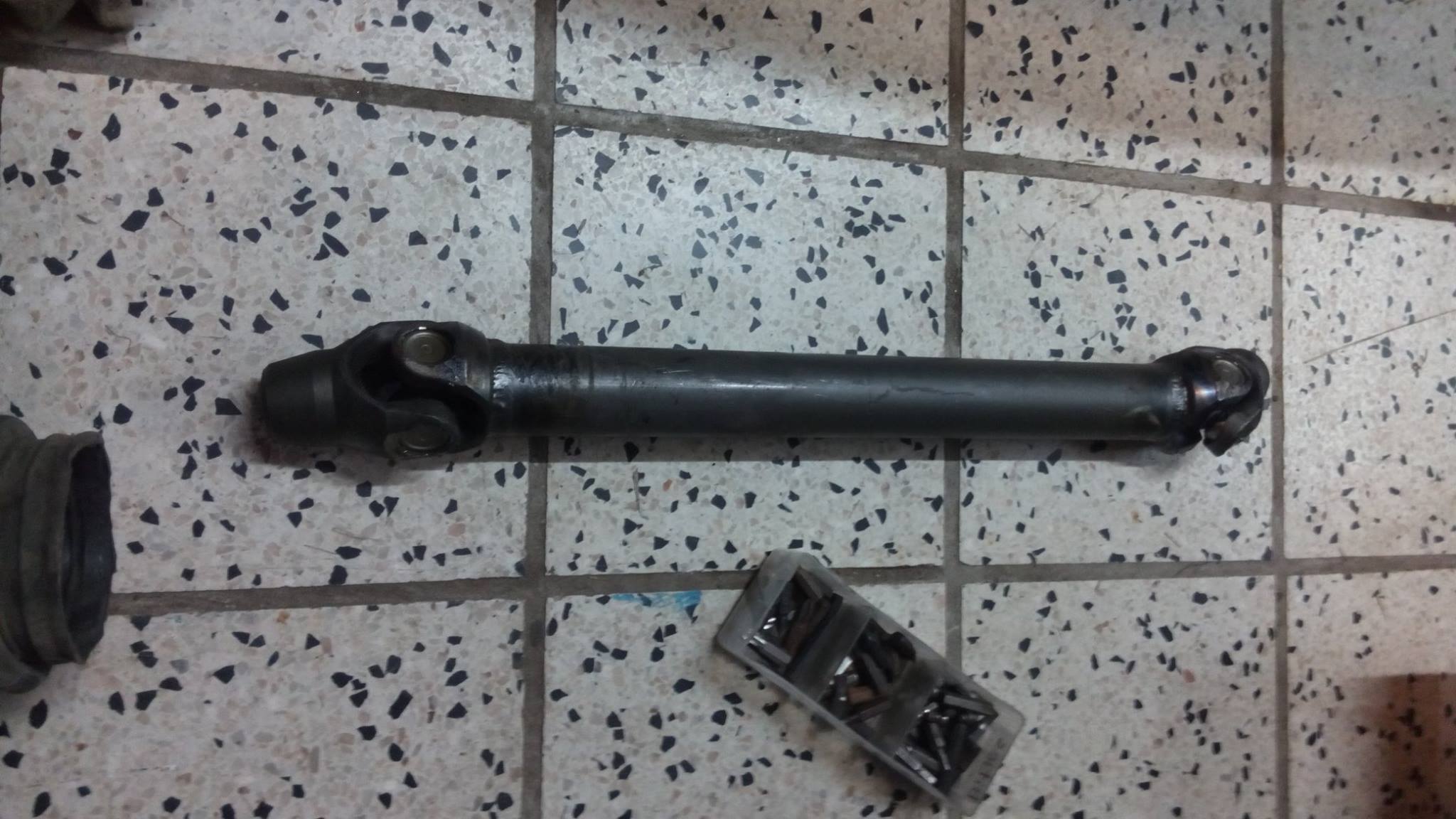

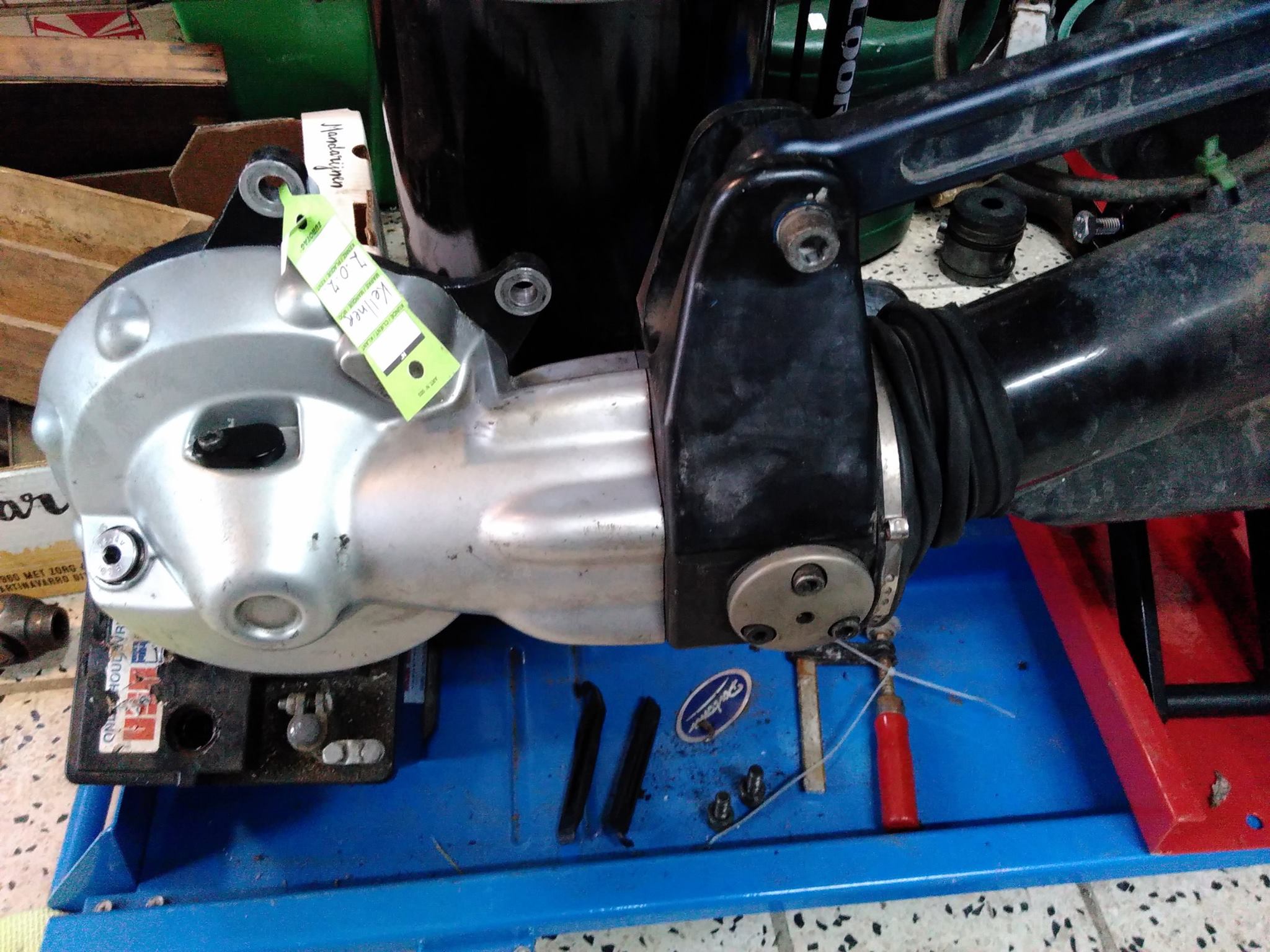

The reduction has been installed. And chatting with the lads over there in the "Knalpot" where they have a lot of parts for beemers and oldtimer beemers we got to delve a bit into the workings of the drive shaft.
So i ended up returning the next day with the Track drive shaft and they will adapt a driveshaft of an old BMW with radial damper to fit. This way maybe the sudden shocks in the drive line are also reduced.
Should take a few weeks probably.

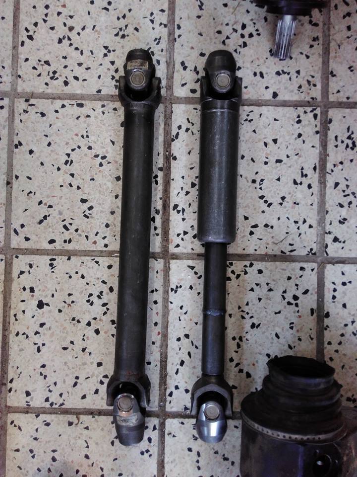

The axle with radial buffer has also been made and installed. Next step putting the c.v.t. back together.

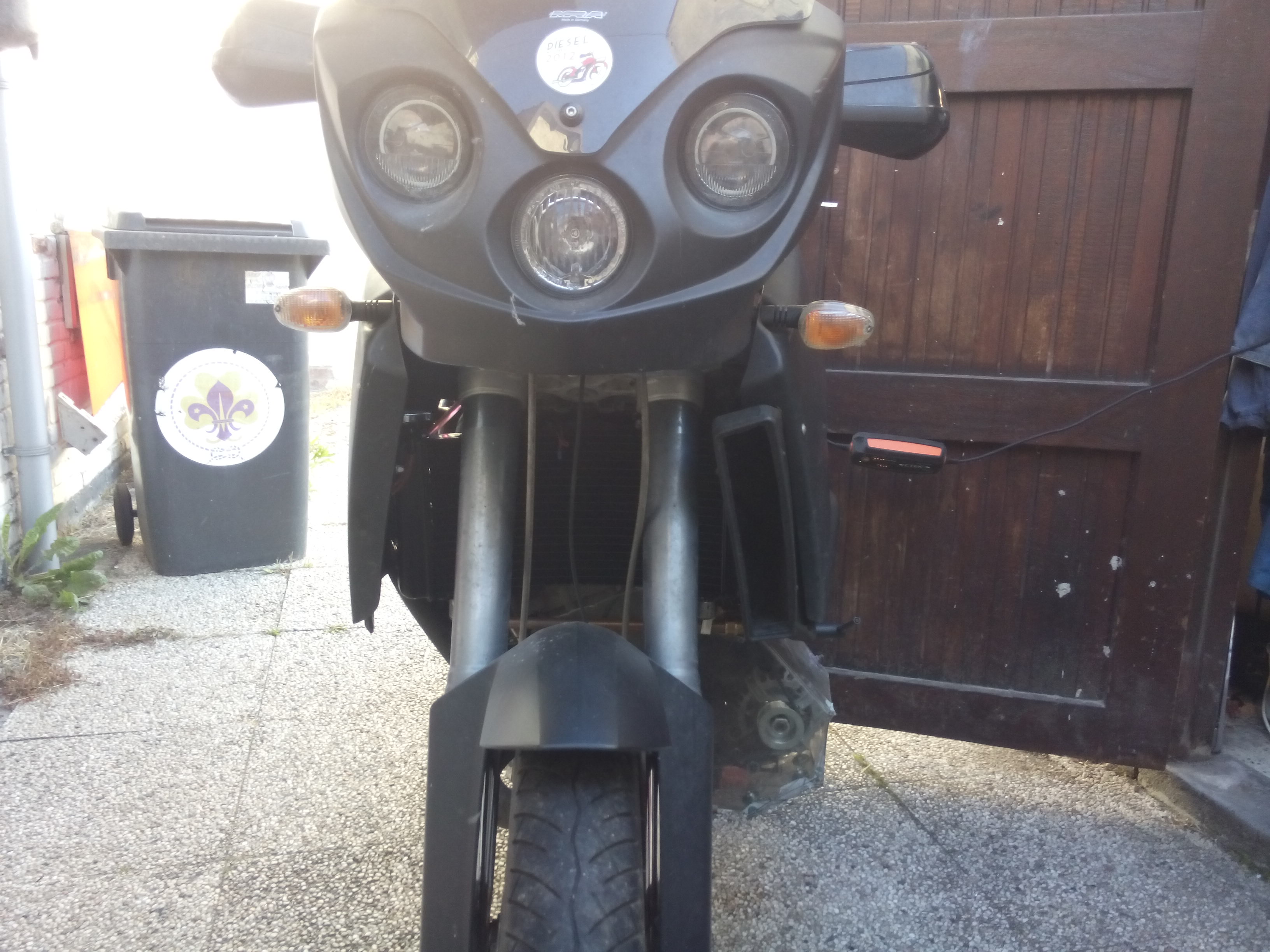

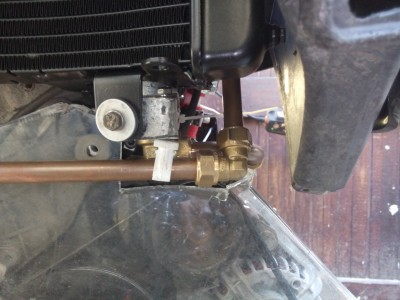

Had a nice test ride. The drive line works well. Still a bit of material to take out. And a bolt that's too long i think. And...
A leaking new radiator. Argh.
Time for a complete makeover i think of the whole front end.
