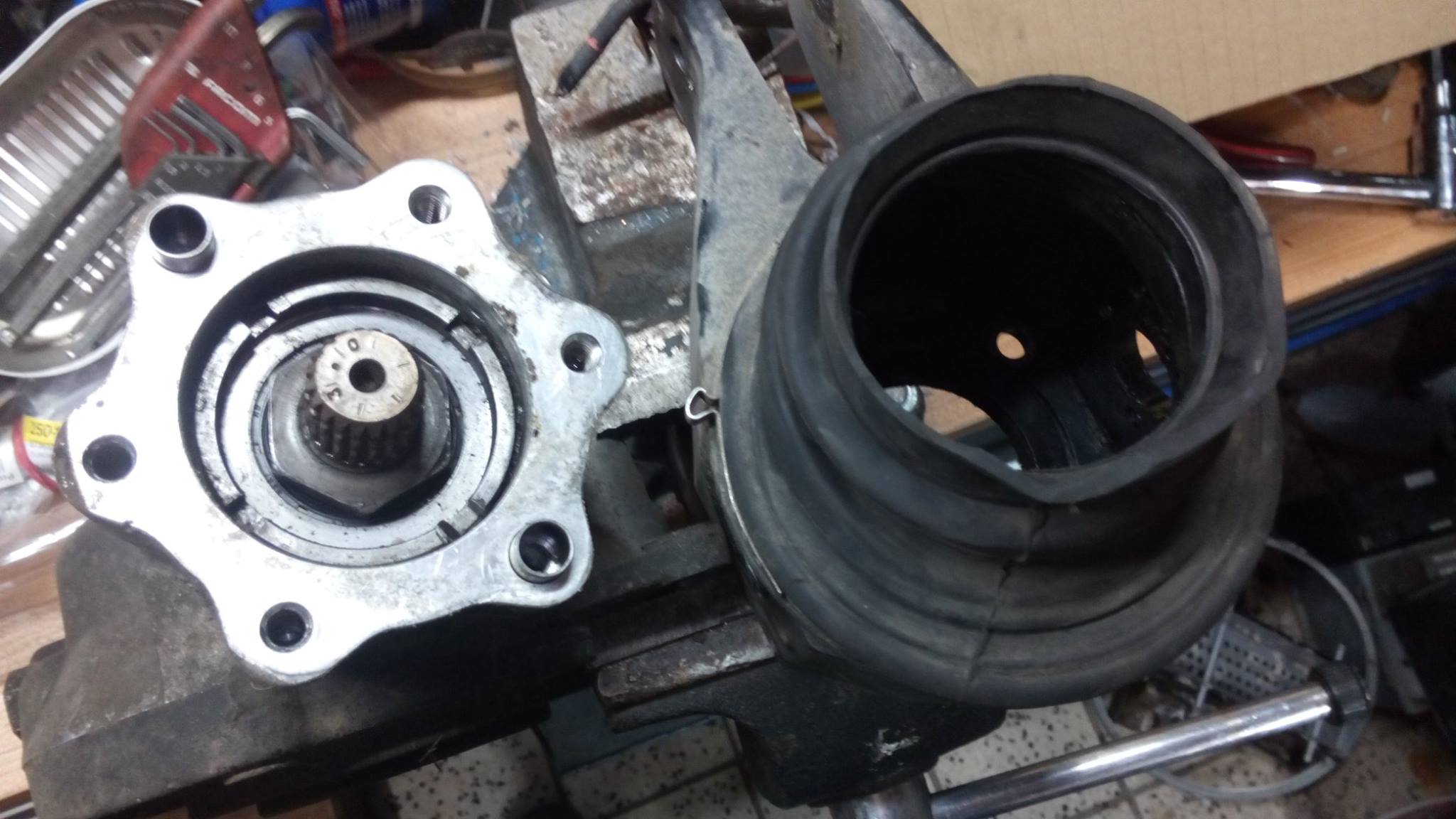

The reduction has been installed. And chatting with the lads over there in the "Knalpot" where they have a lot of parts for beemers and oldtimer beemers we got to delve a bit into the workings of the drive shaft.
So i ended up returning the next day with the Track drive shaft and they will adapt a driveshaft of an old BMW with radial damper to fit. This way maybe the sudden shocks in the drive line are also reduced.
Should take a few weeks probably.

The 3.36 ratio is in.
The axle with radial buffer has also been made and installed. Next step putting the c.v.t. back together.
