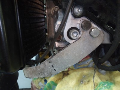

The c.v.t is back on and i have taken some time to come up with a piece of aluminium to (brace?) hold? It's 5 mm wide and easy enough to work with.
The original plate behind it is also aluminium.
Tomorrow i'll start on the other side.

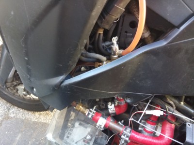

The left side is all done.
Redkite
Posts: 24
Joined: Mon Aug 23, 2010 10:31 pm
Location: Central England
Re: My Track T-800cdi (Bert's!) 3,2
Post by Redkite »
Hi Bert, Looking at the recent Radiator bracket pics, Is that an idler pulley for your modified alternator, or is it the water pump pulley?
Bob
Posts: 334
Location: Netherlands
Post by BertTrack »
HI Bob,
It's the waterpump on the highest point.

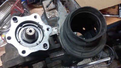

The reduction has been installed. And chatting with the lads over there in the "Knalpot" where they have a lot of parts for beemers and oldtimer beemers we got to delve a bit into the workings of the drive shaft.
So i ended up returning the next day with the Track drive shaft and they will adapt a driveshaft of an old BMW with radial damper to fit. This way maybe the sudden shocks in the drive line are also reduced.
Should take a few weeks probably.
Posts: 334
Post by BertTrack »
The 3.36 ratio is in.
The axle with radial buffer has also been made and installed. Next step putting the c.v.t. back together.
