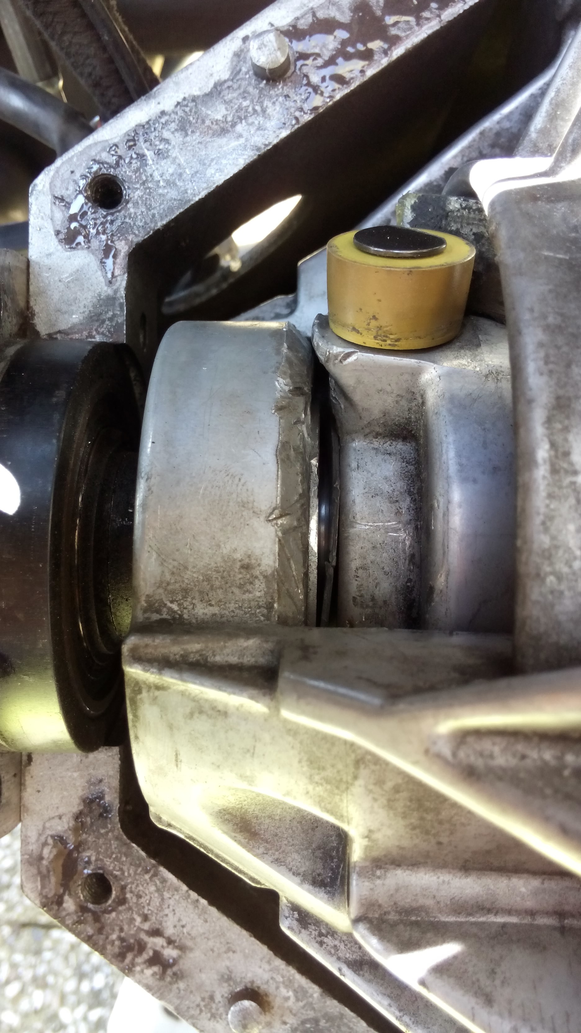

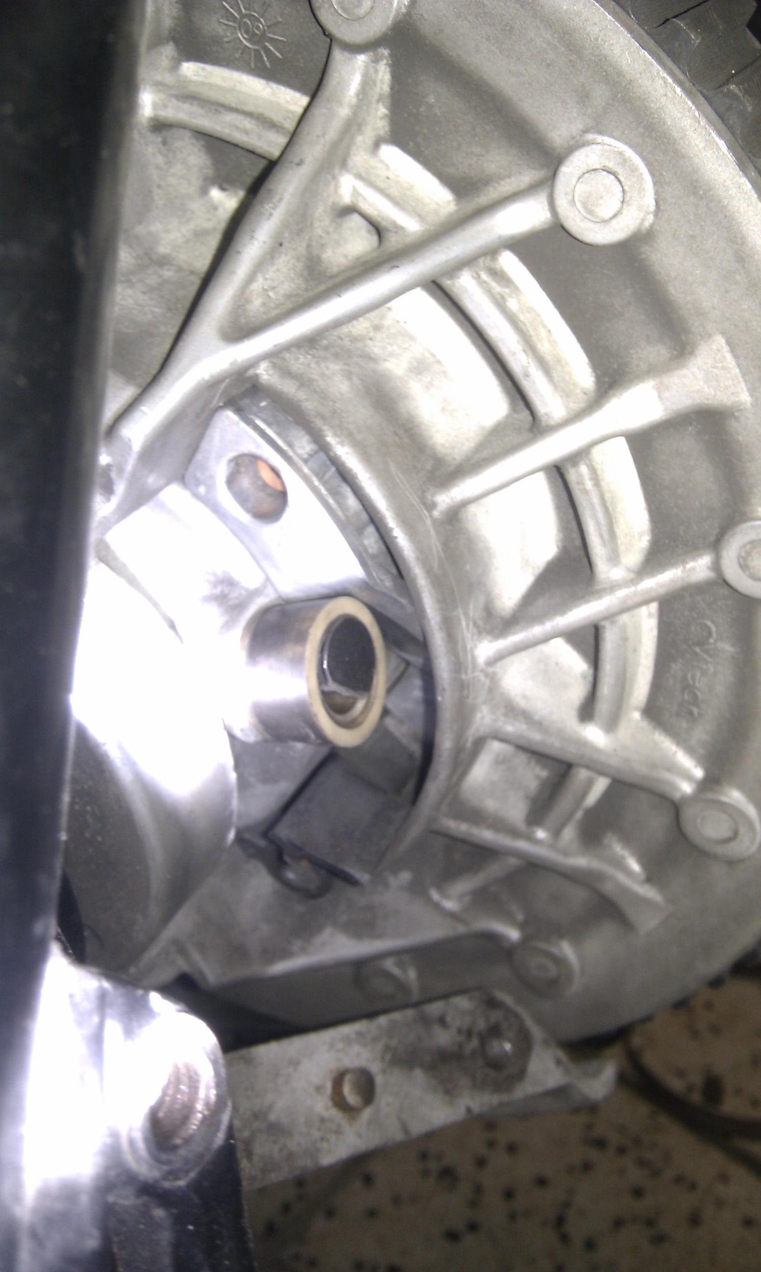

The radiator has been fixed again. But i lost a roll from the sec. cvt. Got my custom helix part fitted and found out the track for the wheel in the cvt narrows so much any deformation of the wheel in the cvt causes it to block halfway another ratio limiting item. Oh bugger.
Re: My Track T-800cdi (Bert's!) 3,2
BertTrack wrote:The radiator has been fixed again. But i lost a roll from the sec. cvt. Got my custom helix part fitted and found out the track for the wheel in the cvt narrows so much any deformation of the wheel in the cvt causes it to block halfway another ratio limiting item. Oh bugger.
Sorry it's a little late in the evening....... maybe I should wait for clarification till I gander at what you say tommorow........ but hind sight is 20/20 lol so I'll make a fool of my self and ask now...
tell me if I read you right...... your custom Helix allows the sheaves to close tight enough it pushes against the rollers thus now allowing it to use the full ramp of the helix?
BertTrack
Posts: 334
Location: Netherlands
Post by BertTrack »
I don't mind you asking Coach on the contrary.
Because it allows me to think again about it.

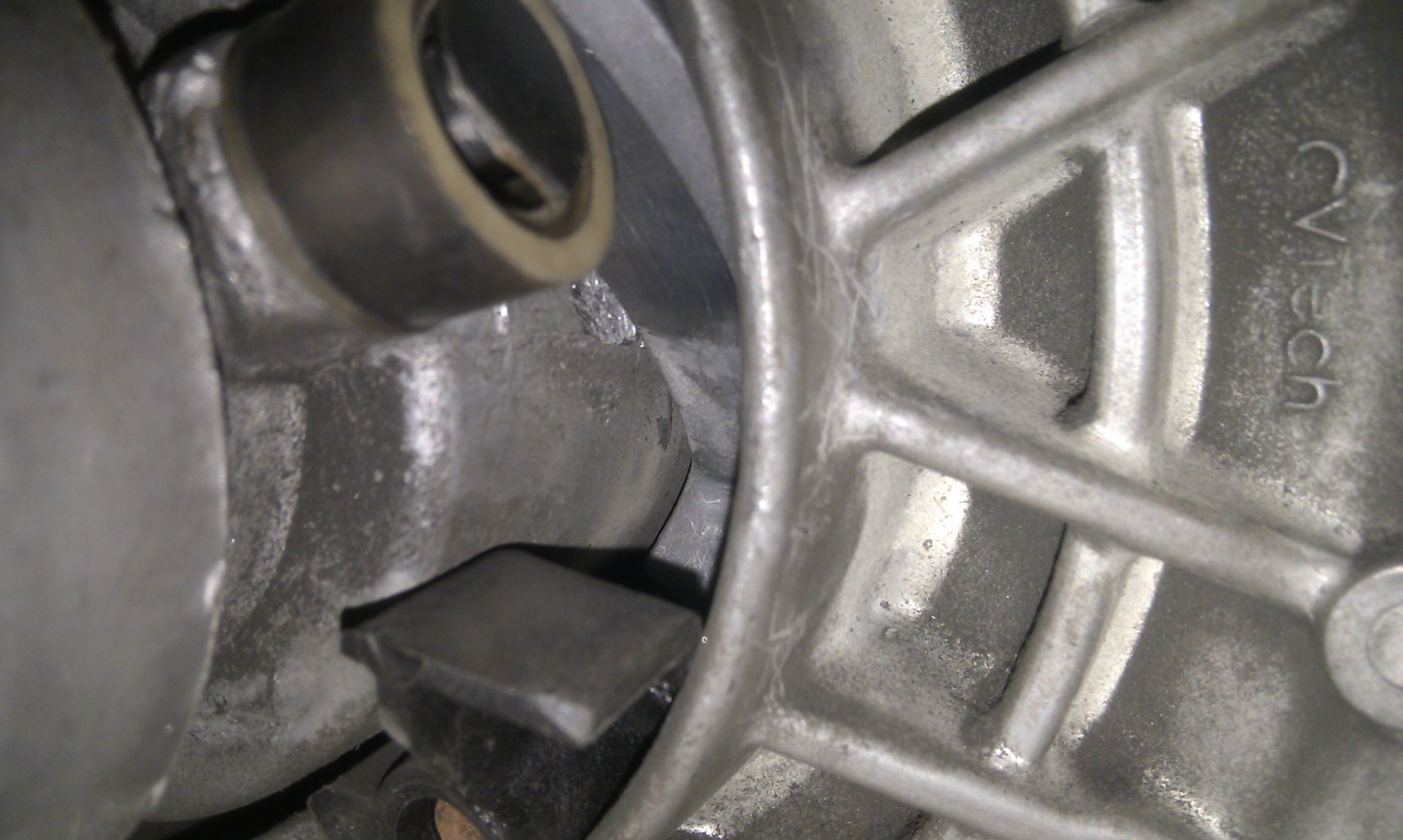

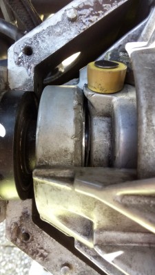

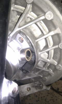

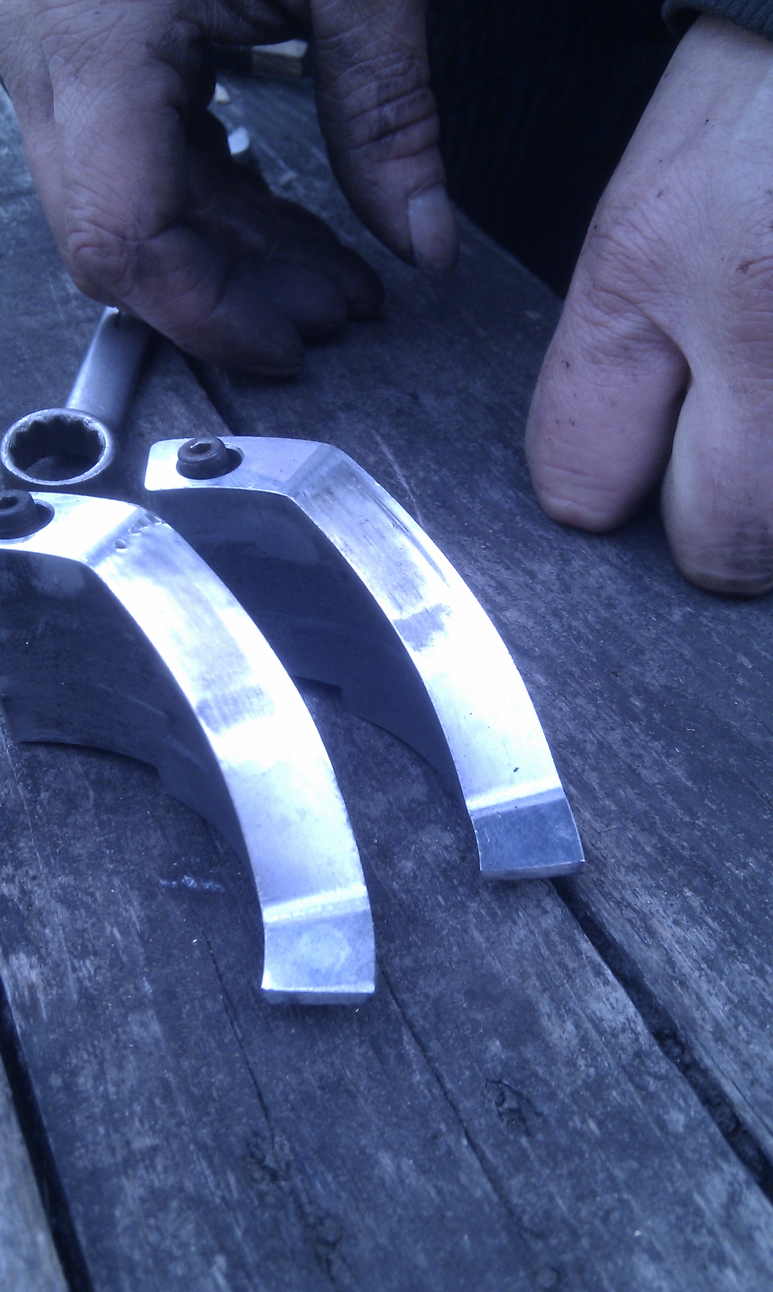

Originally: The roll in the sec. cvt has a tight fit on the outer half of the cvt. (high gear) When that roll deforms it has trouble fitting and increases the resistance to reach high gear causing the Track to remain in mid gear area. (another but big reason why it won't shift up)
With my custom helix the space is even more of a tight fit (together with the new rolls) I do not know how it would perform with old non deformed rolls.
http://youtu.be/HvIaLvcHPc0 The movie.

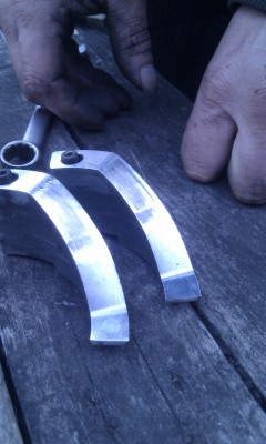

Here are some pictures of the old deformed rolls.
This is how far my custom helixes were used with the old deformed rolls.
I simply never thought the fitting between the two helix part would be an issue. And with the spring in the sec. cvt it's not an easy thing to test. But now that i have removed the spring i see what a tight fit it is and i have to wonder if, that margin is the cause of all evil (with deformed rolls)
The rolls deform quit easily because of them hitting the helix unrestricted when the motorcycle takes off from standstill. The belt is a little too long and in the stationairy position the sec cvt plates are pressed on to each other and no longer pressing against the belt. So no restrictive friction to keep the rolls from slamming into the helix.

In the picture 2 posts above you see the black plastic helix guides. Those actually inhibit the travel of the c.v.t. once the rolls get a beating. (very little play originally)
The beating happens because the belt is too long. I think the c.v.t. will work well with a shorter belt and loosing the black guides.
Don't have the belt yet so i'll try without the black bits soonish. Will update when i do. :)

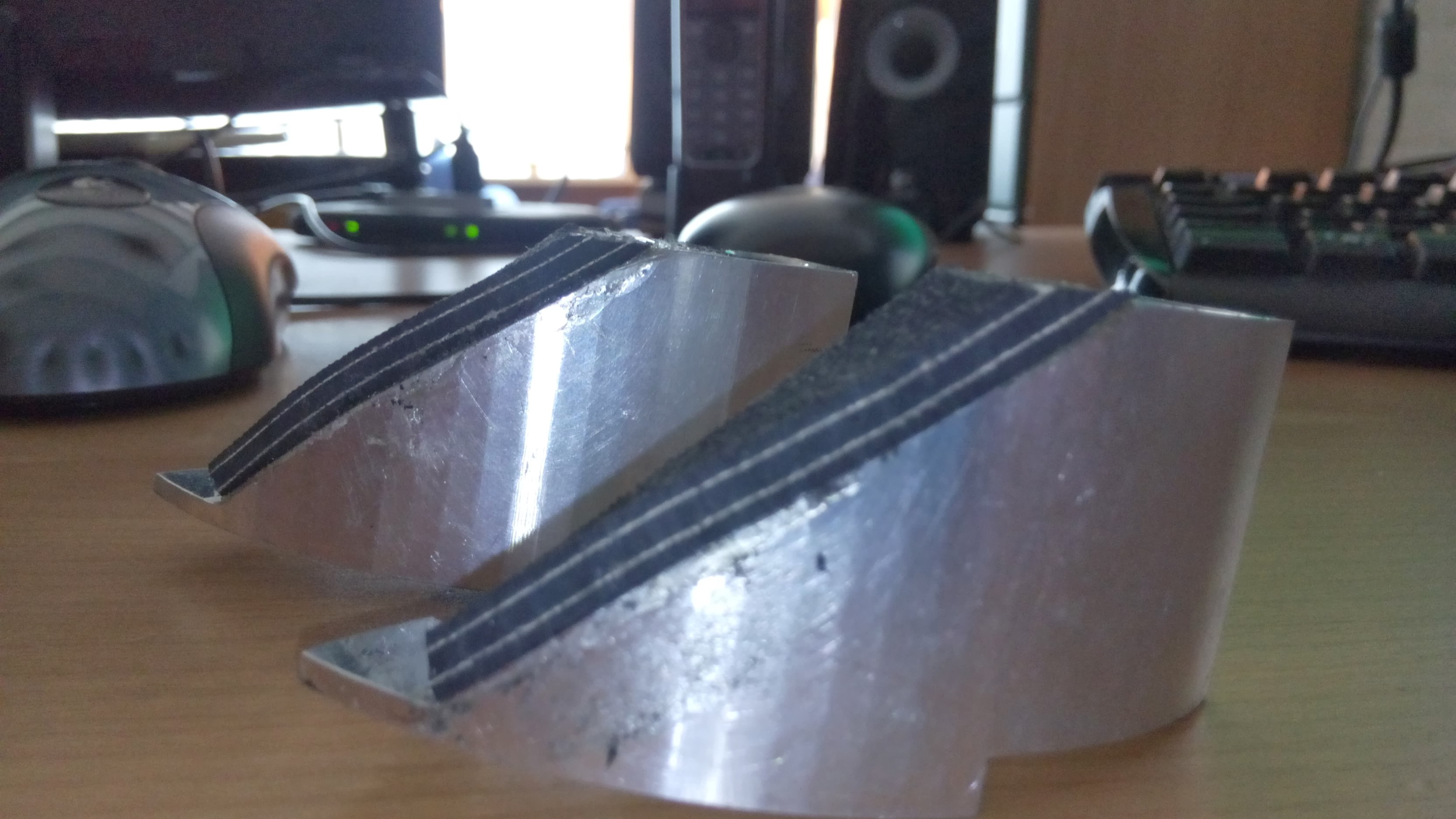

Next step is putting some rubber on the helix surfaces. I'll be cutting a 20degree triangle from an old piece of stirdy rubber and fit that on the helix slope. Giving me a 65 degree angle overall. I'm still debating to either only cover the area where it can hit. Or go for the whole helix.

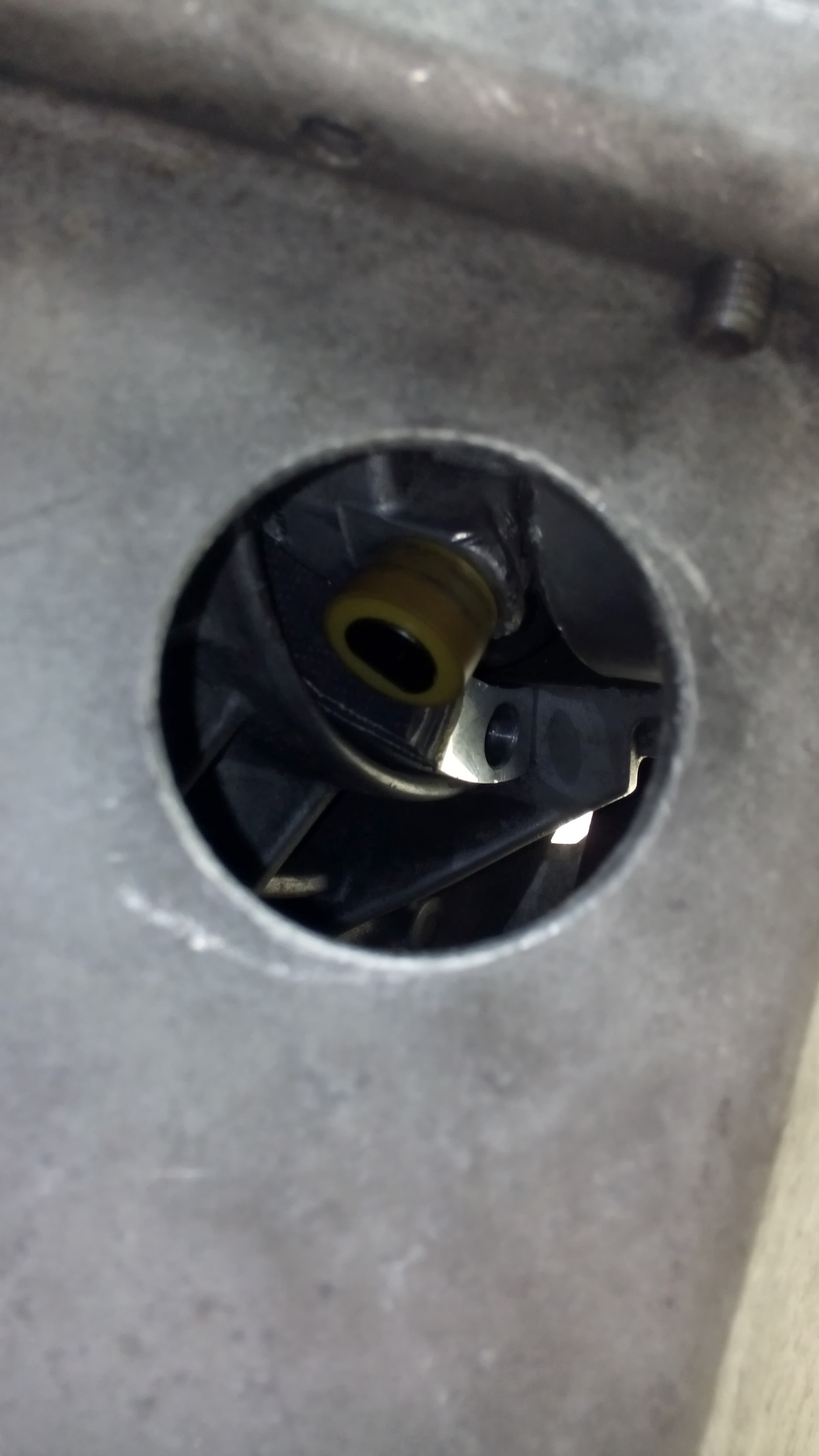

The rolls get slammed into the helix. Deforming them a little every time. It's hard plastic/fiber and every time it deforms it stretches.
Increasing the diameter stops the cvt from using about half of the ratio available.
And at one point they increase so much that the roll comes off the little shaft they are on completely. Causing the steel axle to hit the aluminium helix. Not a pretty sight. ;)
I have tried with the rubber and it worked well. Untill the rubbers let go. Then it's back to clunk and clonk. But up till that time it was pretty fancy smancy all the way.
I'll have a talk with the chap that drew the helix i have now. He's quite the materials specialist.

The helixes with rubber glued on.
Installed.
After the test ride. Rubber has let go.
Note the space between the parts indicating the plates are resting on the belt rubber instead of the teflon ring.
So with the rubber it ran as sweet as can be.
I have since then reinstalled the original helix parts to see how that new roll/wheel holds up in the original setting. Conclusion. Too much clunk.

Ah well, there is no end point. There is just the roller hitting the helix. That's why the rubber is on the helix. ;)
When you go off throttle. The roll leaves the helix surface and ends up in the far corner away from the helix.
Open the throttle and the roll comes rushing into the helix at force with the momentum of one sheave behind it. Only then do both sheaves transfer power to the axle of the c.v.t. It's then when you hear a clunk.
BertTrack wrote:Ah well, there is no end point. There is just the roller hitting the helix. That's why the rubber is on the helix. ;)
ahhhhh...... ok missunderstood earlier. hmm....... wonder then if the roller was in a slot and the slot had a spring in that to cushion things some like its own shock absorber so to speak. Or if the helix sat on springs to give it an initial cushion as the rollers make first contact.
But...... beside that....... snowmobiles with high rpm potential Im sure got to be going thru the same slam. You might consider popping over to a snowmobile board to pick their brains. See if you can find one with good CVT discussions. That might hint that there is a few good CVT knowledgeable folk on a particular board. CVT's have been in snowmobiles longer than any product that uses them.
