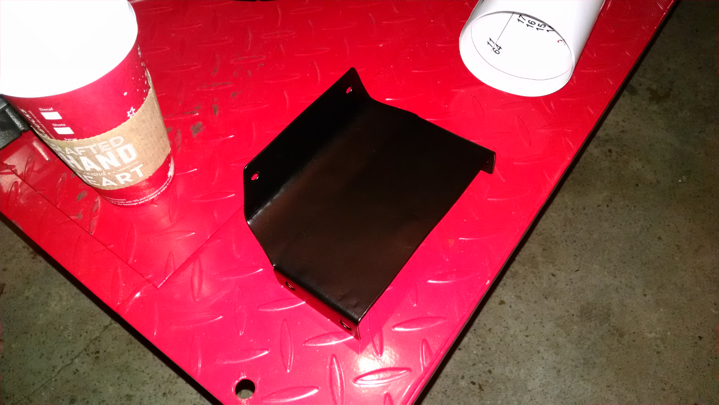

During testing, I determined that the fuel pump was not running once the battery umbilical cord was disconnected. These pumps require clean 12VDC to run properly, but the output from my alternator is pulsed 12VDC. I had installed a large capacitor in the system to attempt to smooth out the pulses, but apparently this wasn't sufficient.
Unfortunately, the stock battery tray in a Sportster is inside the oil tank, so I could not install a factory replacement. There are not many mounting lugs in this section of the stock frame, so I designed a battery tray that clamps to a frame rail. I cut a pieces of 3/4" 6061 aluminum plate on my bandsaw, finished with a hand file, and machined a pocket with my mill.

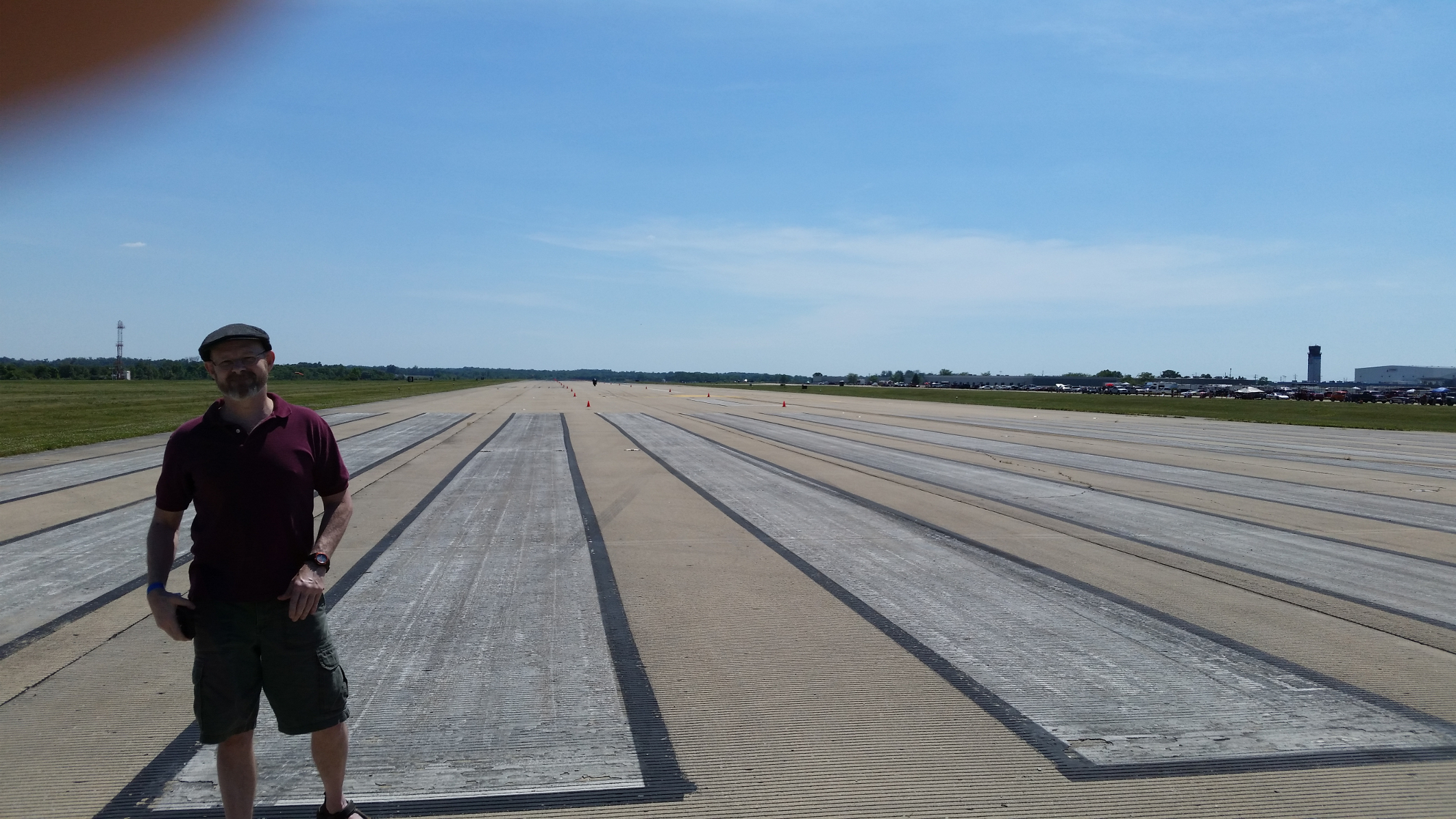

We rolled into Wilmington, Ohio around 1AM, overslept, and nearly missed the driver orientation meeting in the morning :shock: After rushing to the track, sitting through the rookie orientation meeting, and registering, we brought the bike to tech inspection, which it passed with flying colors :D

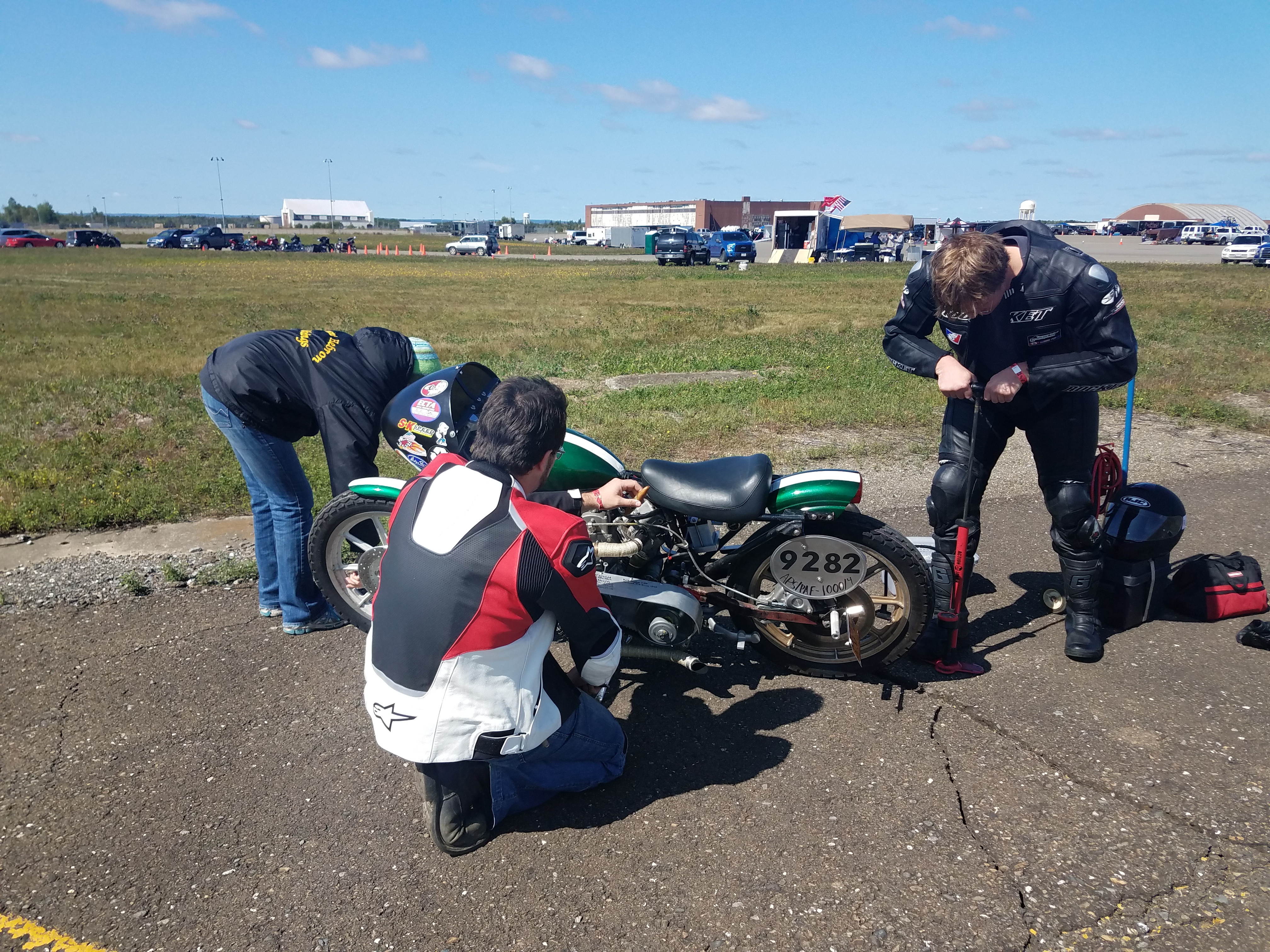

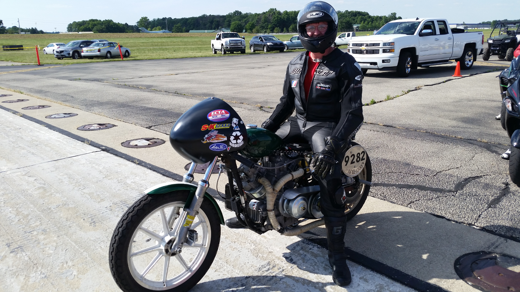

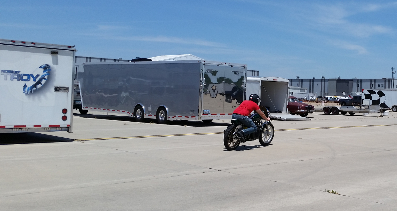

Here is a video of the first pass. The Comet CVT did not shift fully, so unfortunately the fastest speed I could manage was 67mph. This was still enough for the record, but I have a lot of tuning and improvements to do for next year.
https://www.youtube.com/watch?v=gF_87dtSysw

After we discovered that the CVT was either slipping or not fully shifting, we moved the GoPro mount to the left side of the bike and pointed the camera towards the transmission. During the next run, we were able to document the CVT behavior.
https://www.youtube.com/watch?v=N3d-XNZzP5Q

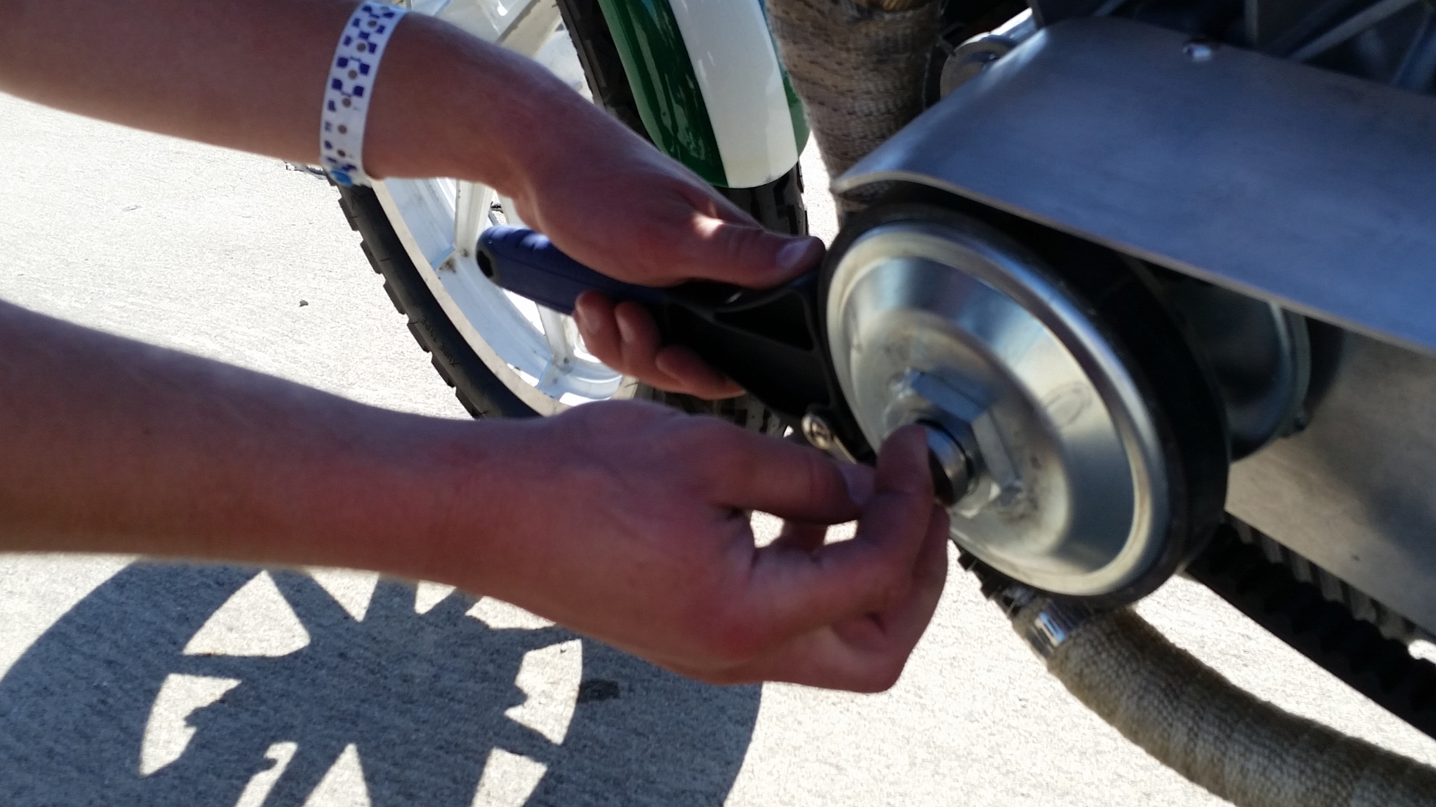

It appears that the CVT simply does not shift all the way to top gear. We suspect that this is occurring because the diesel engine isn't revving high enough to throw the weighted rollers out to a full shift. We will either make custom heavyweight rollers, install weaker return springs, or some combination of the two.

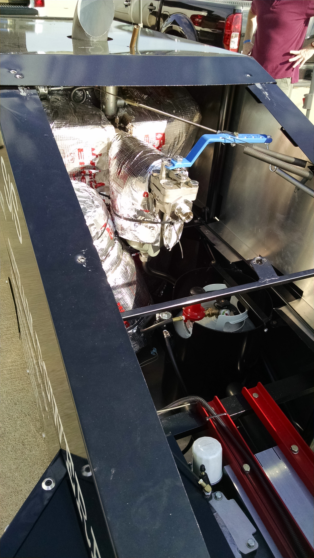

This is a homemade steam car :D
They used a Doble-style flash boiler fired by propane, and the engine is a heavily-modified Mazda rotary engine. They machined custom rotor housings out of solid stainless to prevent rust and optimize the port positions. Unfortunately, they suffered a valve failure on their first pass and had to retire without completing the run.

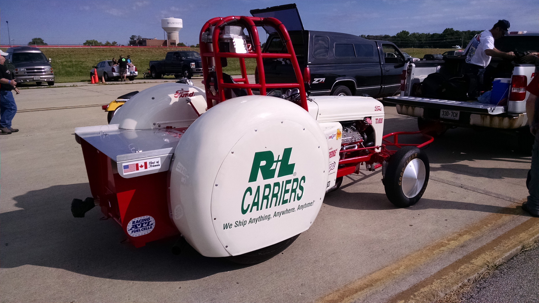

This is a land speed racing Ford tractor with a flathead V8. Apparently, this was a factory-available conversion back in the 30's and 40's. The rear tires are sourced from a Boeing 747.

HondaJohn wrote:It appears that the CVT simply does not shift all the way to top gear. We suspect that this is occurring because the diesel engine isn't revving high enough to throw the weighted rollers out to a full shift. We will either make custom heavyweight rollers, install weaker return springs, or some combination of the two.
With my c.v.t experience on the Track I'd increase the weights a bit and possibly bring the gearing down a little. What's the current theoretical max speed at max rpm currently with the c.v.t. shifted all the way?

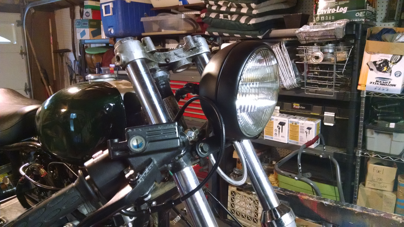

Following the race, the Sportster became a show queen for the rest of the summer and fall. I brought it to numerous cruise nights, as well as two Maker Faires. During that time, I was also steadily improving it. The first order of business was to repair a few assembly issues that I discovered at the race. I corrected some alignment issues in the wheels and CVT, installed a proper seat with actual cushioning, and tinkered with the CVT tuning. Once the winter weather kicked in, I started performing the major surgery:
- Installed a homemade fork-shortening kit to drop the front end by 1.5 inches.
- Removed the bearing seals from the rear wheel due to binding. I had installed sealed single-piece ball bearings, so the seals were unnecessary.
- Built an auxiliary wiring harness, and installed a headlight, taillight, horn, and brake light.
- Had the bike registered, titled, and insured.
- Installed a homemade plate bracket.
The goal of all this was to allow me to perform road-testing before taking the bike to the track, so she is now fully legal....though still hilariously uncomfortable.

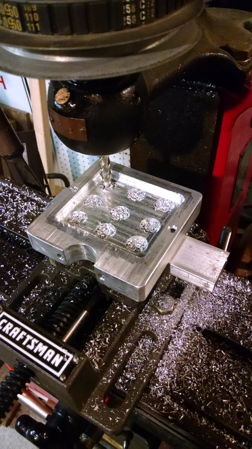

Here are some updates of the supercharger installation. I've fabricated the mounting brackets, remachined v-belt pulleys from the hardware store, and started welding up the plenum.

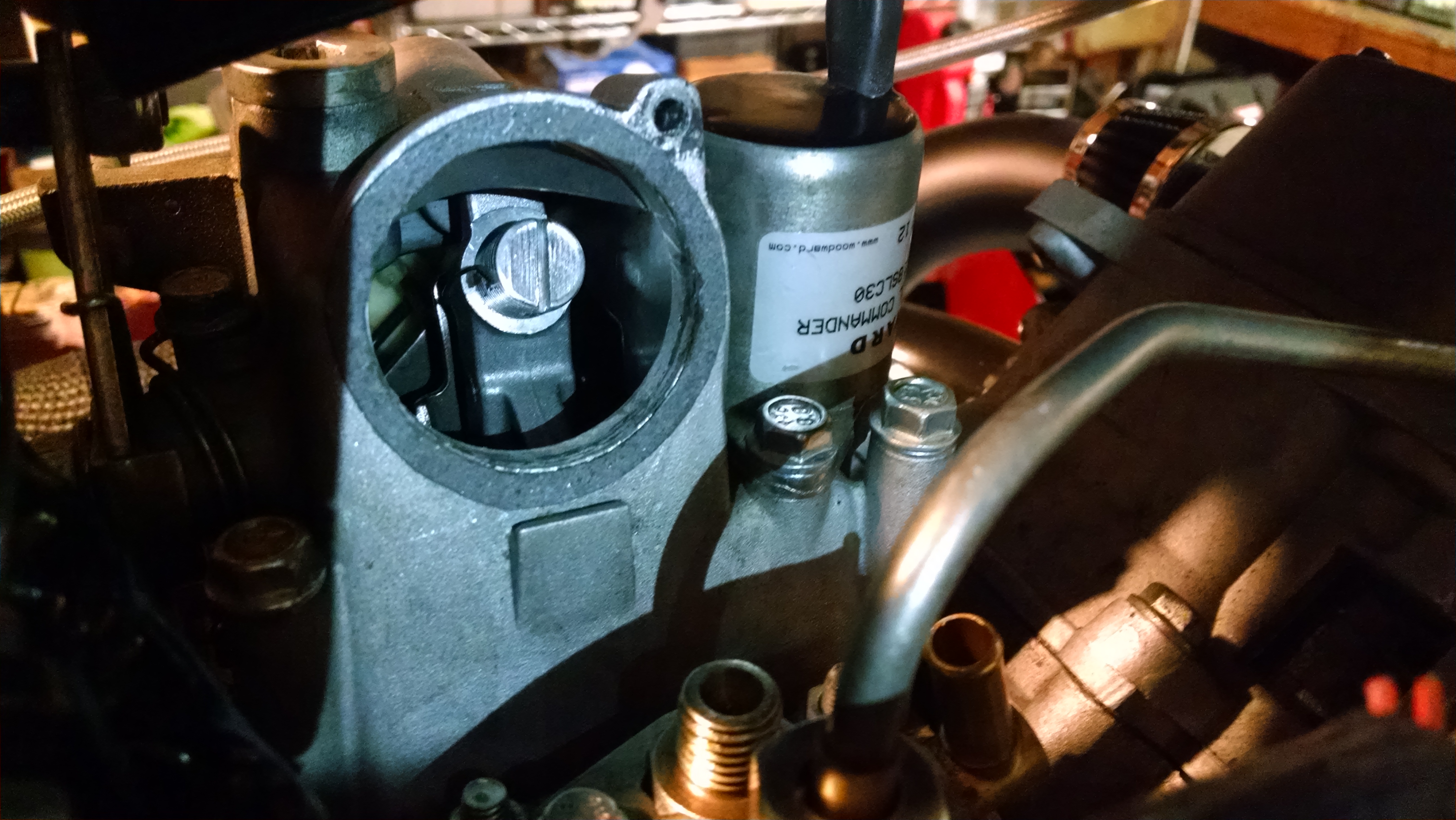

Information is limited for this engine, so I finally decided to open the governor housing to document the design and look for improvements. It's difficult to see through the small access hole, but after a few hours of tinkering, I drew this diagram:
- Lever "A" is the main pivot in the assembly. The governor pushes against it on the upper left, and it adjusts fuel on the bottom right.
- The throttle cable is attached to lever "B". Both pivot on the same shaft, and are connected by springs and direct contact as they rotate.
- The main spring to fight against the governor is attached to lever "B". There is a tiny spring attached between "A"and "B" that is too weak to have a anything to do with governing. I think it's just there to keep things held in place and prevent slapping.
- I noticed during examination that, when lever "B" is held at full throttle, lever "A" isn't held tight against it. The governor can push it back a bit before it comes to a rest against lever "B". This basically disables the upper 10-15% of throttle position at the injection pump, because there is nothing to hold it there against the governor.
- Lever "B" has a threaded hole that is missing some type of set screw. When at full throttle, without that set screw, the only spring fighting the governor for the top 15% is the tiny spring. Once lever "A" makes contact with lever "B", the main spring takes over.
To increase pump position, and horsepower, I needed to purchase or fabricate a new set screw, then adjust it until there is no slop between the levers. Factory replacements are impossible to find, so I decided to make one. Unfortunately, it is a very unusual, and unavailable, thread (M14x1.0), so I had to special order threaded rod from China. Once it finally arrived (2.5 weeks of shipping!!), I made the screw.
Posts: 320
Re: Land Speed Racing Mk2
Post by mark_in_manchester »
Ummmmmm - why was it not there? No chance that your impressive (I mean it) reverse-engineering is reversing a quick mod carried out by manufacturer or importer to knock the top end off the engine's performance and improve reliability / longevity? :) I vaguely remember a thing with these (I think it was these) V-twins and crank-case breakages. If you're racing, death or glory might be the way to go, mind.
