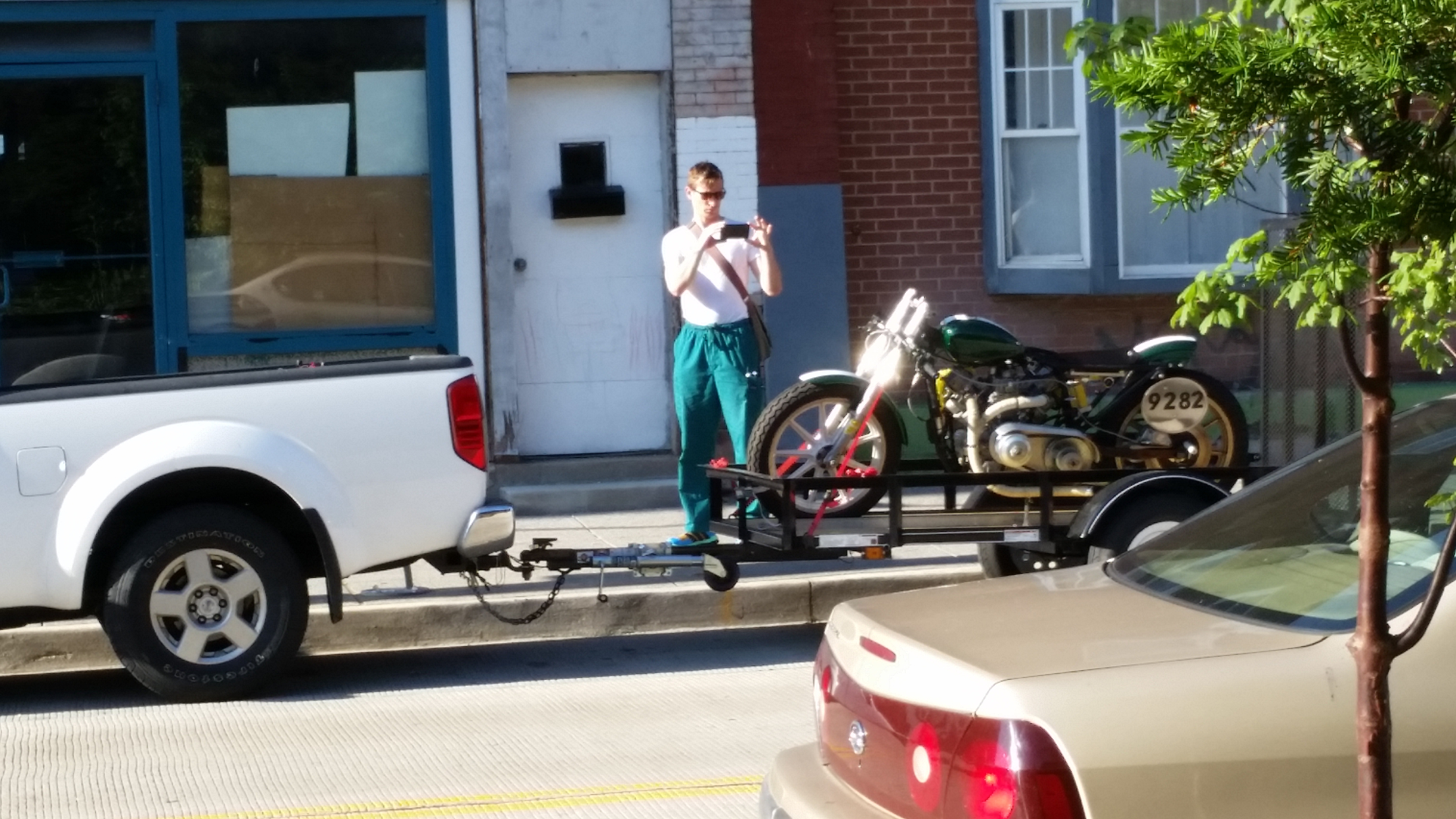

The trip began on Thursday. Anyone who has ever been to New York City will tell you that the traffic is insane, and the roads are Third-World, so I set aside an entire day just to get from Long Island to New Jersey. I loaded up all my parts and clothes, hitched up the trailer, and fought my way over the Hudson.
On Friday, I picked up my girlfriend, and we hauled across Pennsylvania towards Ohio. Along the way, we stopped in Lancaster to visit my grandparents for breakfast, and Pittsburgh to visit her cousin for dinner.

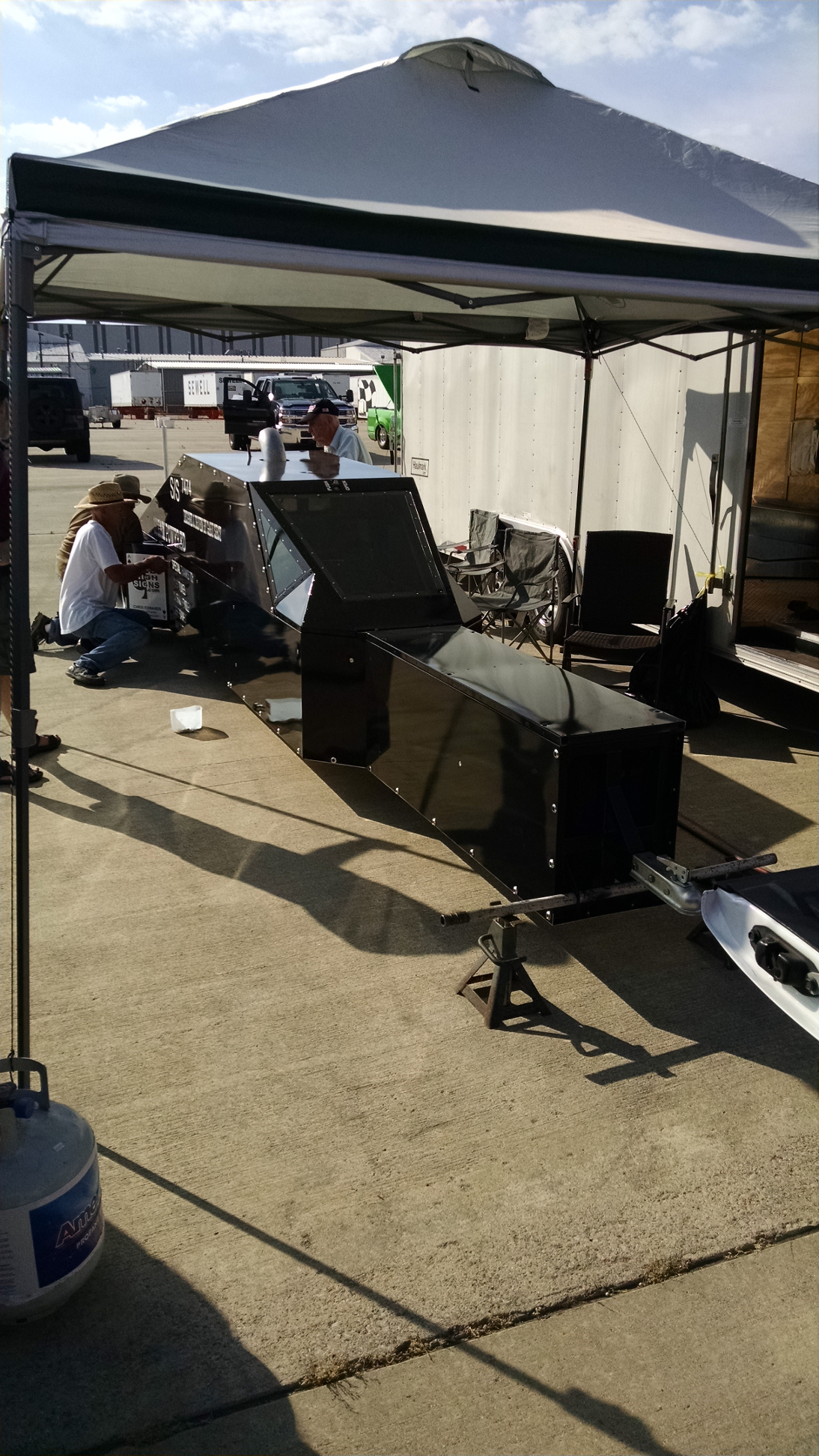

We rolled into Wilmington, Ohio around 1AM, overslept, and nearly missed the driver orientation meeting in the morning :shock: After rushing to the track, sitting through the rookie orientation meeting, and registering, we brought the bike to tech inspection, which it passed with flying colors :D

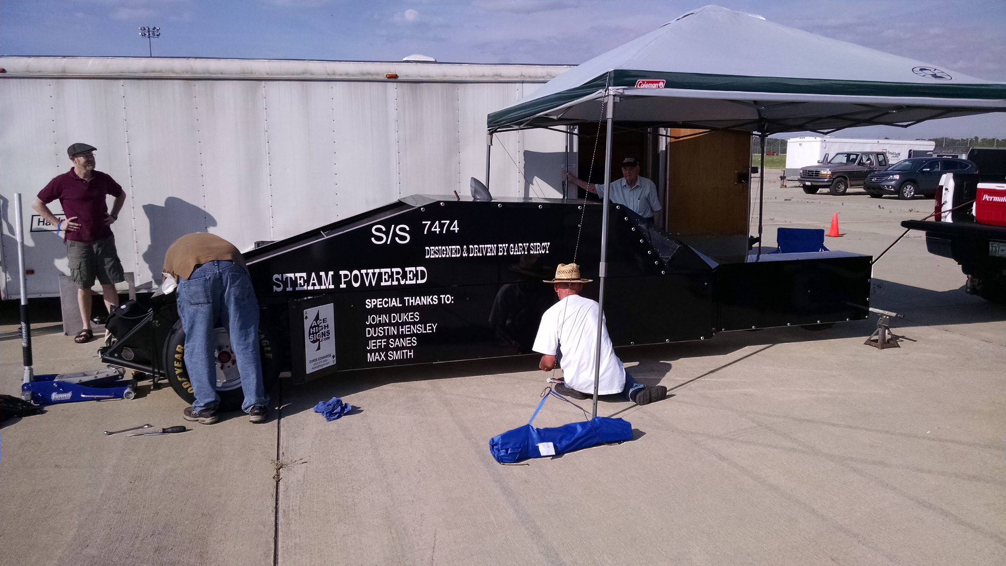

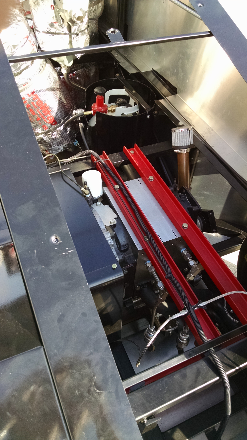

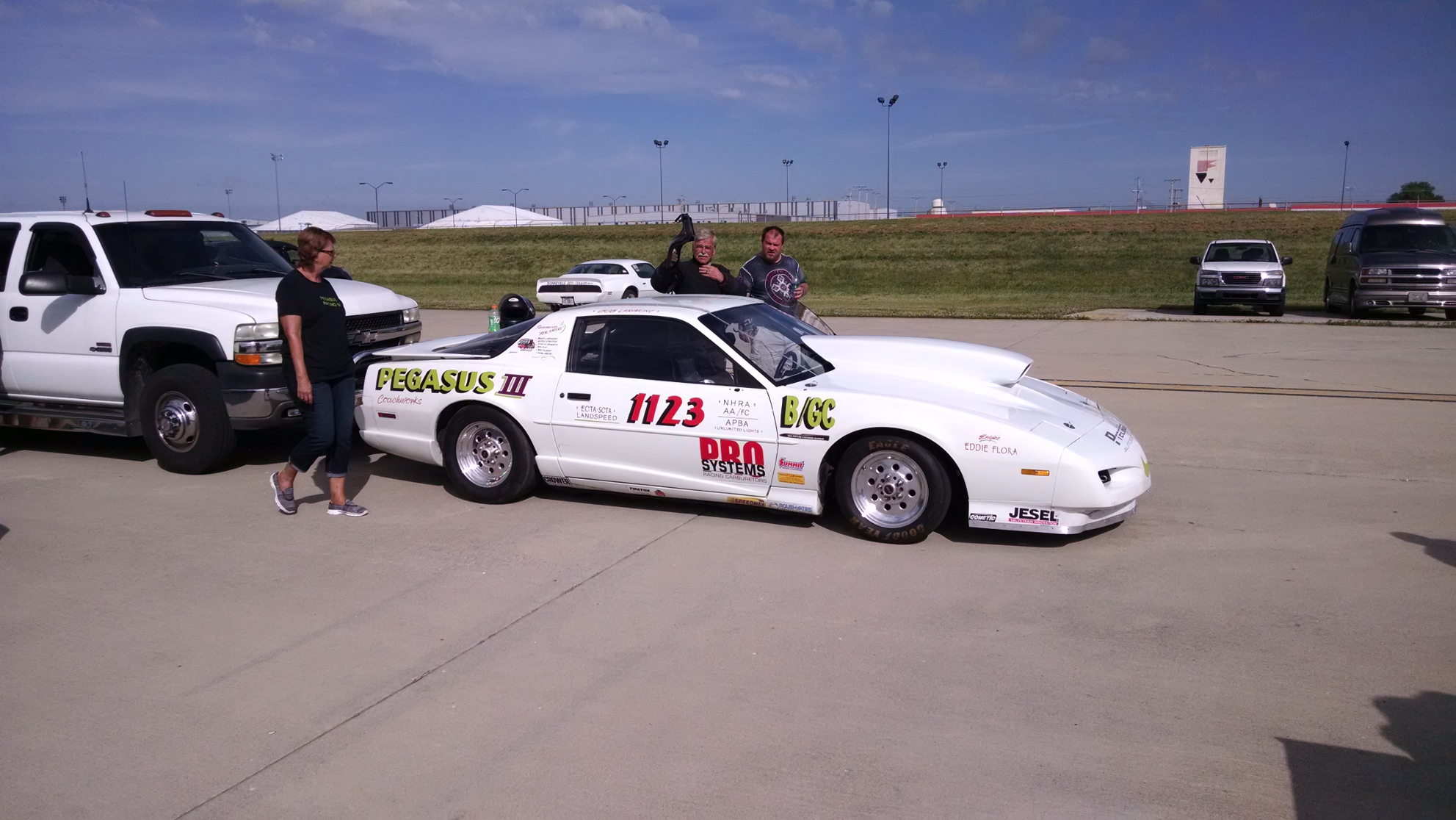

Here are some photos from the other competitors who showed up!
This is a homemade steam car :D
They used a Doble-style flash boiler fired by propane, and the engine is a heavily-modified Mazda rotary engine. They machined custom rotor housings out of solid stainless to prevent rust and optimize the port positions. Unfortunately, they suffered a valve failure on their first pass and had to retire without completing the run.

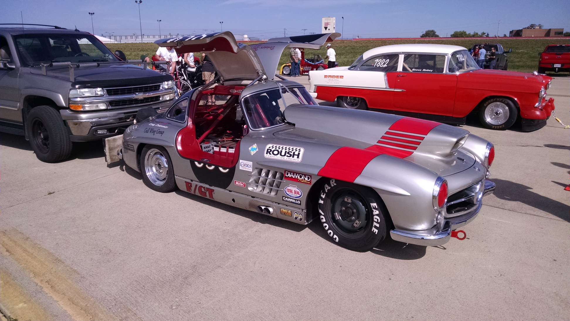

MERCEDES 300 SLR GULLWING!!!!

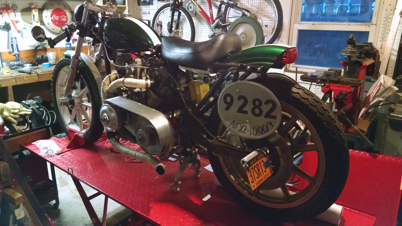

Following the race, the Sportster became a show queen for the rest of the summer and fall. I brought it to numerous cruise nights, as well as two Maker Faires. During that time, I was also steadily improving it. The first order of business was to repair a few assembly issues that I discovered at the race. I corrected some alignment issues in the wheels and CVT, installed a proper seat with actual cushioning, and tinkered with the CVT tuning. Once the winter weather kicked in, I started performing the major surgery:
- Installed a homemade fork-shortening kit to drop the front end by 1.5 inches.
- Removed the bearing seals from the rear wheel due to binding. I had installed sealed single-piece ball bearings, so the seals were unnecessary.
- Built an auxiliary wiring harness, and installed a headlight, taillight, horn, and brake light.
- Had the bike registered, titled, and insured.
- Installed a homemade plate bracket.
The goal of all this was to allow me to perform road-testing before taking the bike to the track, so she is now fully legal....though still hilariously uncomfortable.

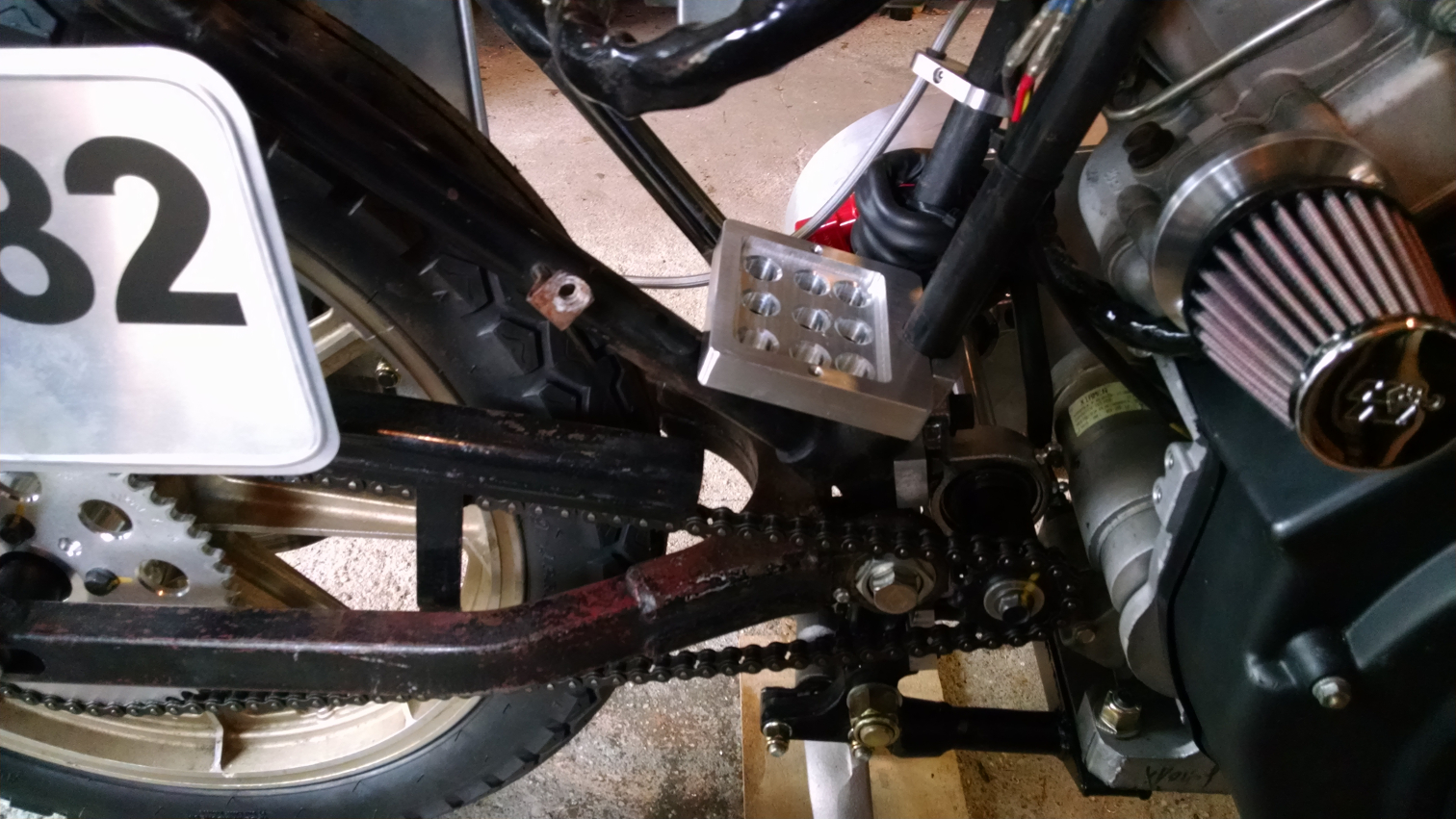

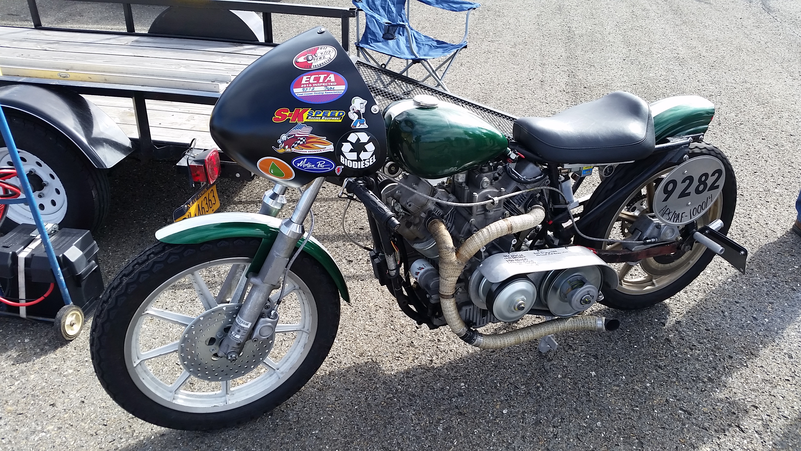

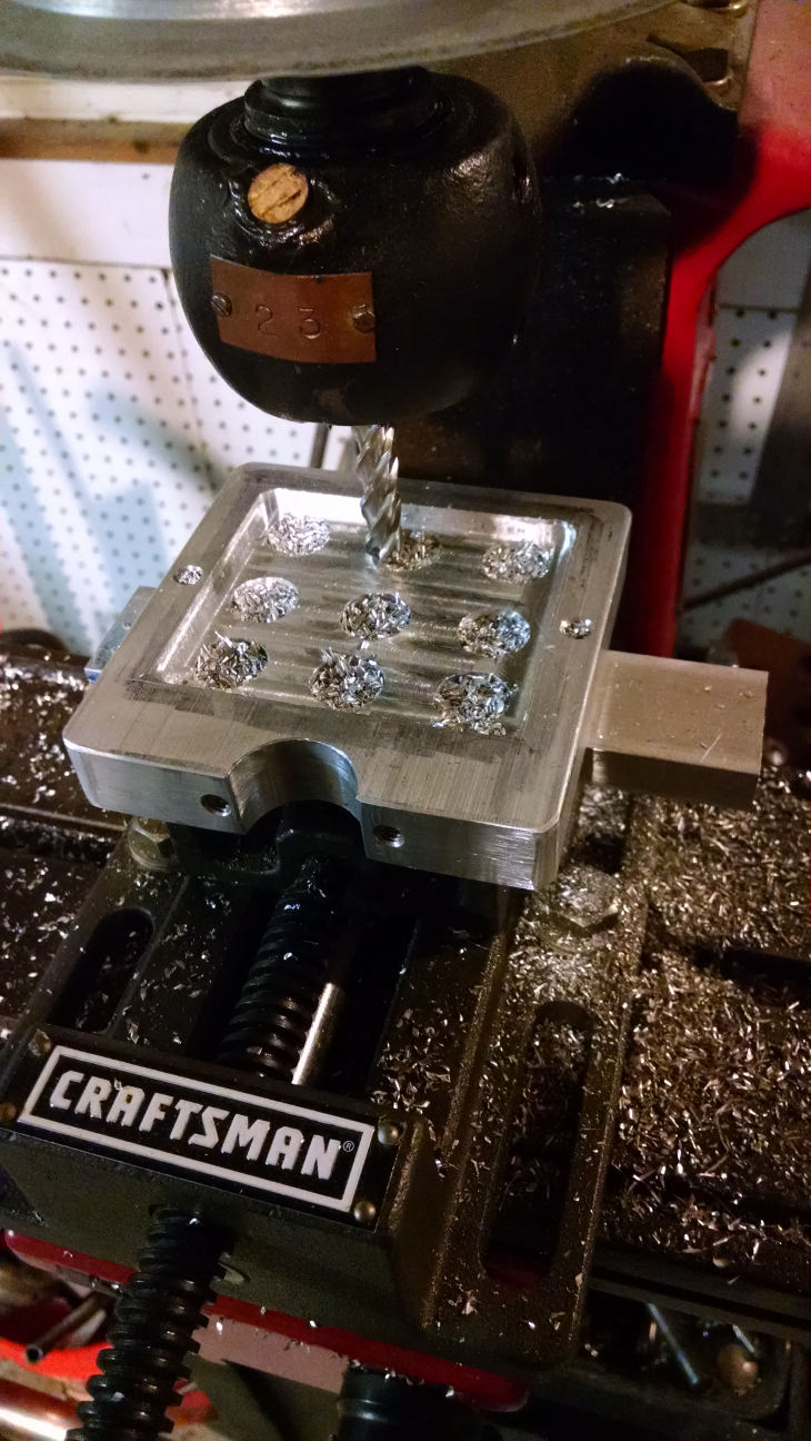

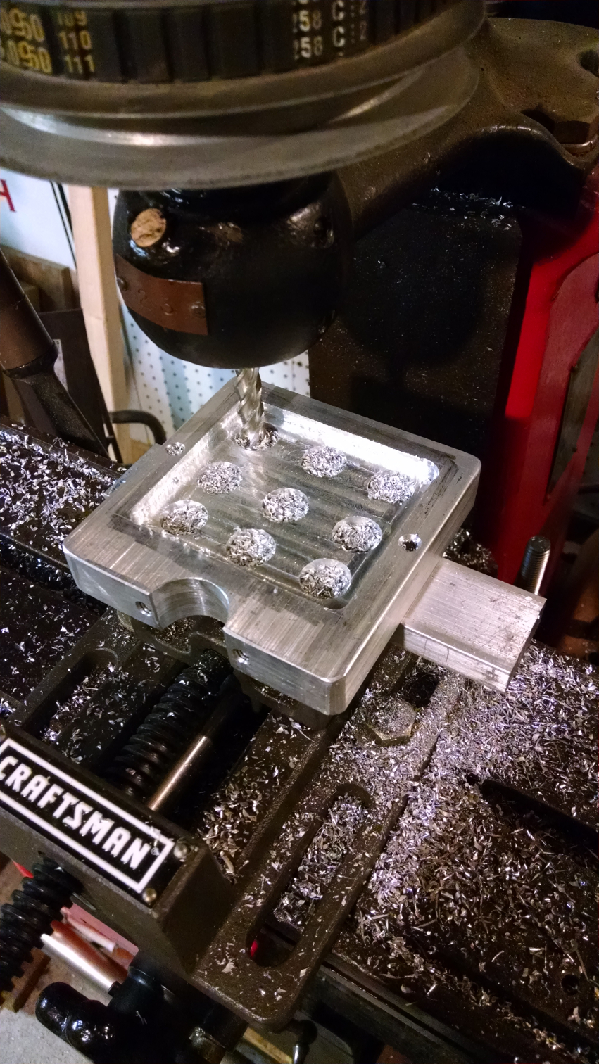

Here are some updates of the supercharger installation. I've fabricated the mounting brackets, remachined v-belt pulleys from the hardware store, and started welding up the plenum.
