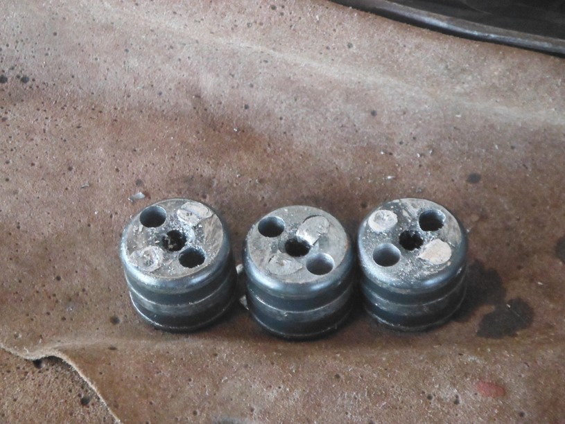

This is whar I did. I drillt 2 7mm holes first, whitch gave me only 4 g more. so I drilld 2 more holes and filled them. So I came from 126 g to 134 g. And I think it is quite good now.
Alex
Re: Diesel for Kawasaki EL 250
That looks really good. You can allways back it down some if need be by drilling out a tad bit of lead. Does the spring attach to the center hole? Looking at your other pics seems it attaches to a pin that runs thru center hole. Roller then rotates around the pin. If that is the case wonder if a little graphite in the center hole will allow roller to climb the ramp a tad bit sooner too? May only be 100rpm sooner but might be all you need if the new heavier roller leave you still needing just a bit sooner engagement.
