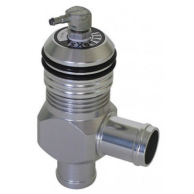

Here's the blow off that I'm going to use, it's adjustable, I already have everything out of the way so tomorrow I can start making the mounting brackets for the supercharger, and hopefully have it mounted by tomorrow night, been taking pics, I'll post tomorrow night. I also have a thread on Chop Cult, " Turbo diesel harley was it a good idea? "

Yes, many variables, I do have adjustable blow off valves like in the picture, if need be. Here's food for thought, my sister has a supercharged Pontiac bonnieville, older one, the supercharger belt and tensioner took a crap 3 years ago, she still drives the s**t out of it everyday town and highway, 0 maintainence, no problems. I know... how could anyone drive a supercharged anything without fixing the belt ?? so air is being sucked thru the sitting dead super, I drove it like that and it just feels like, no super, not bad, just no super.
