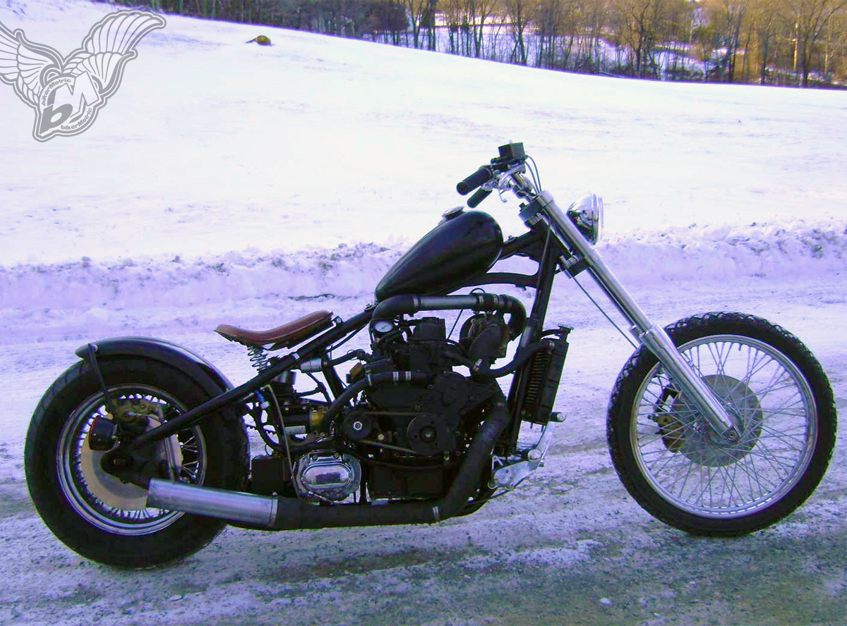

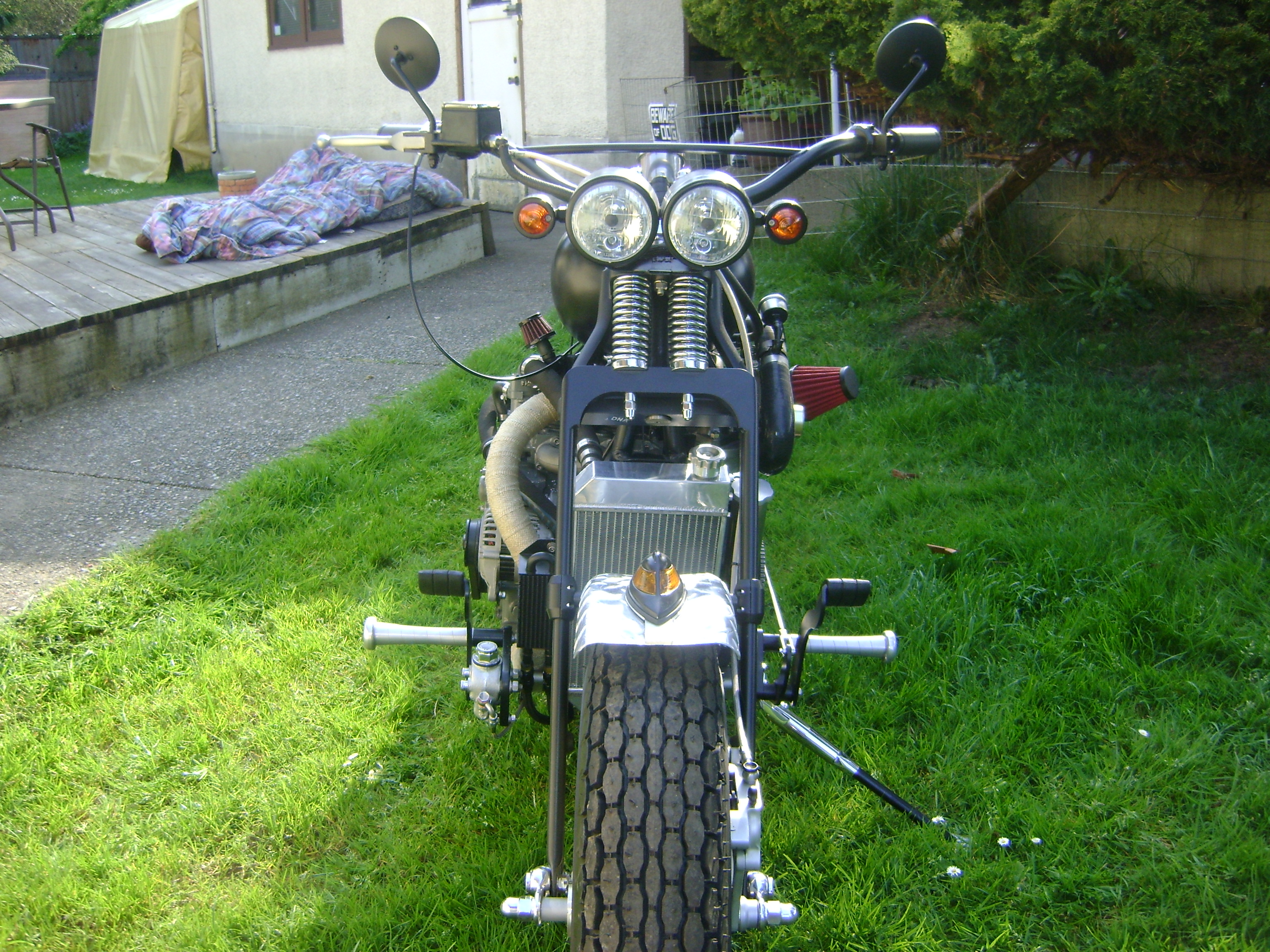

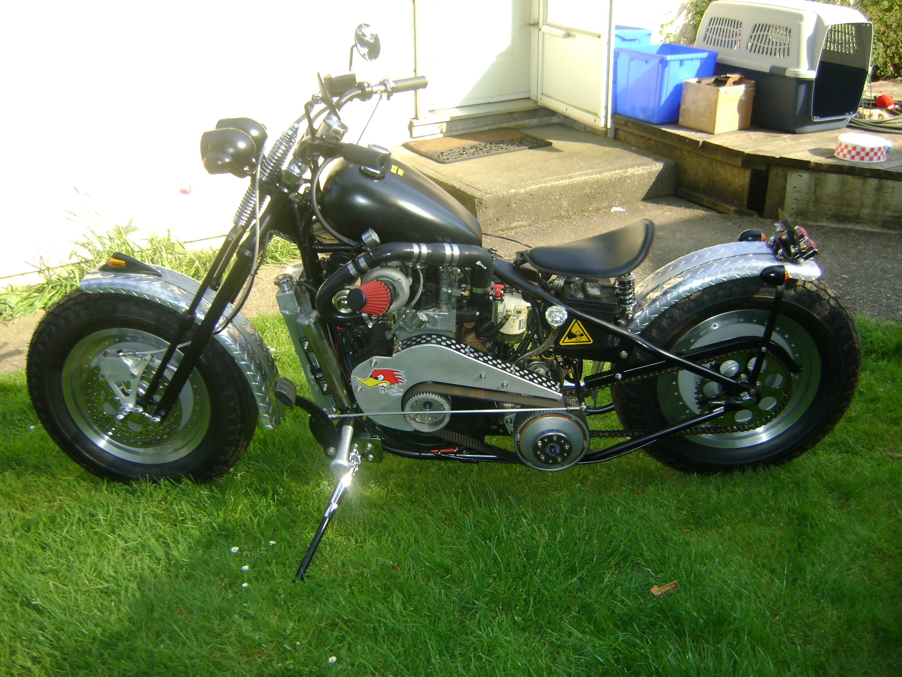

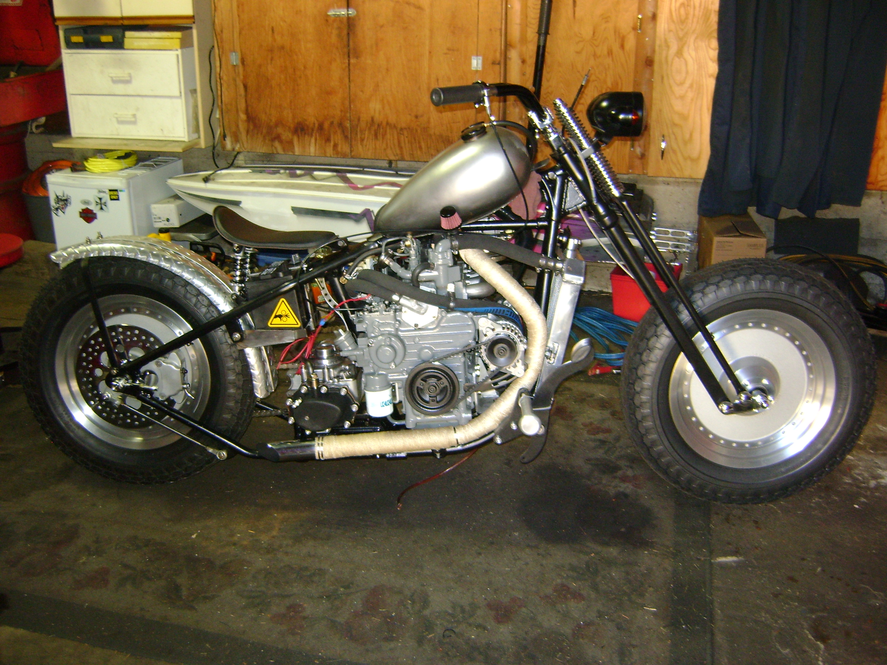

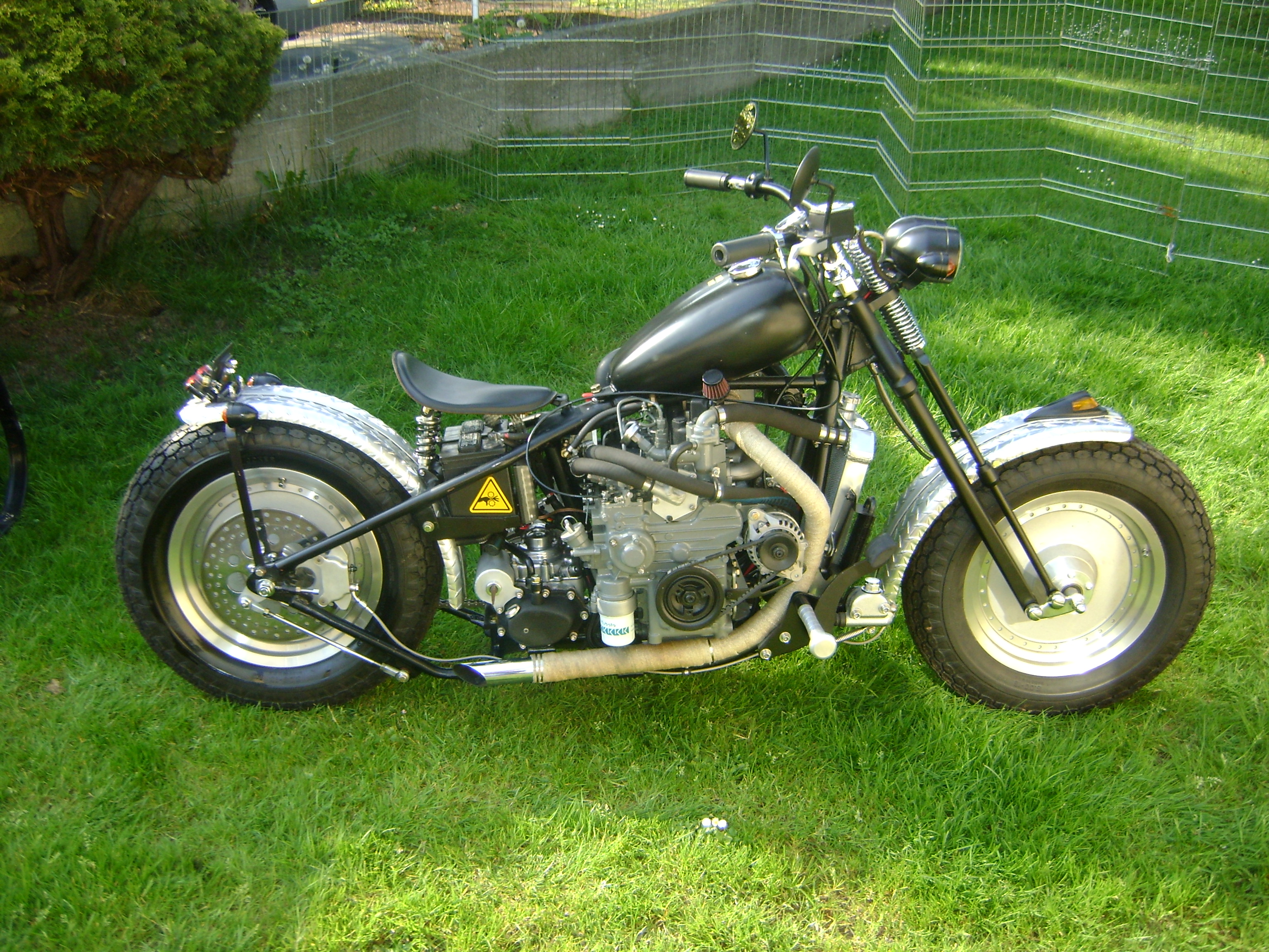

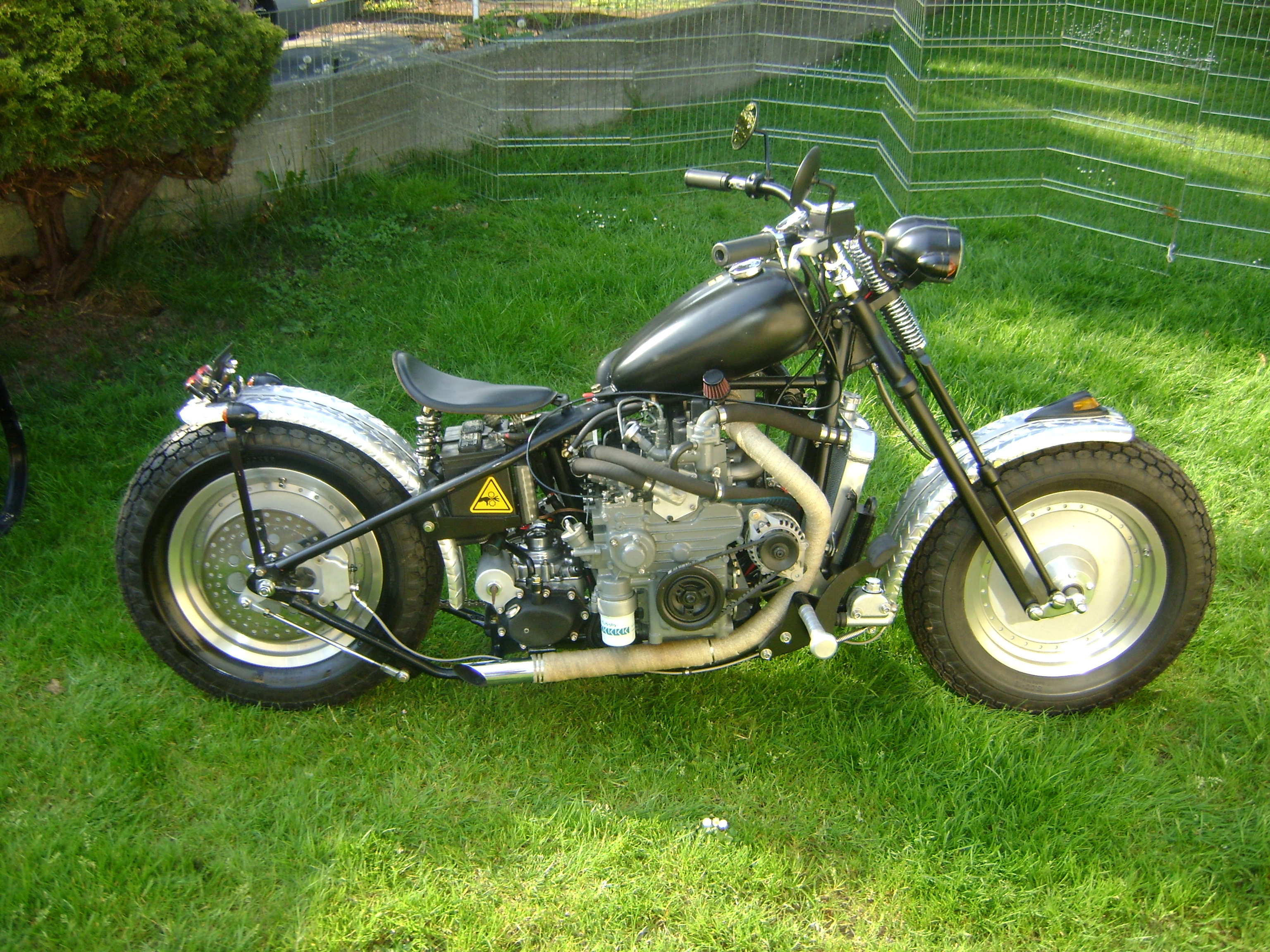

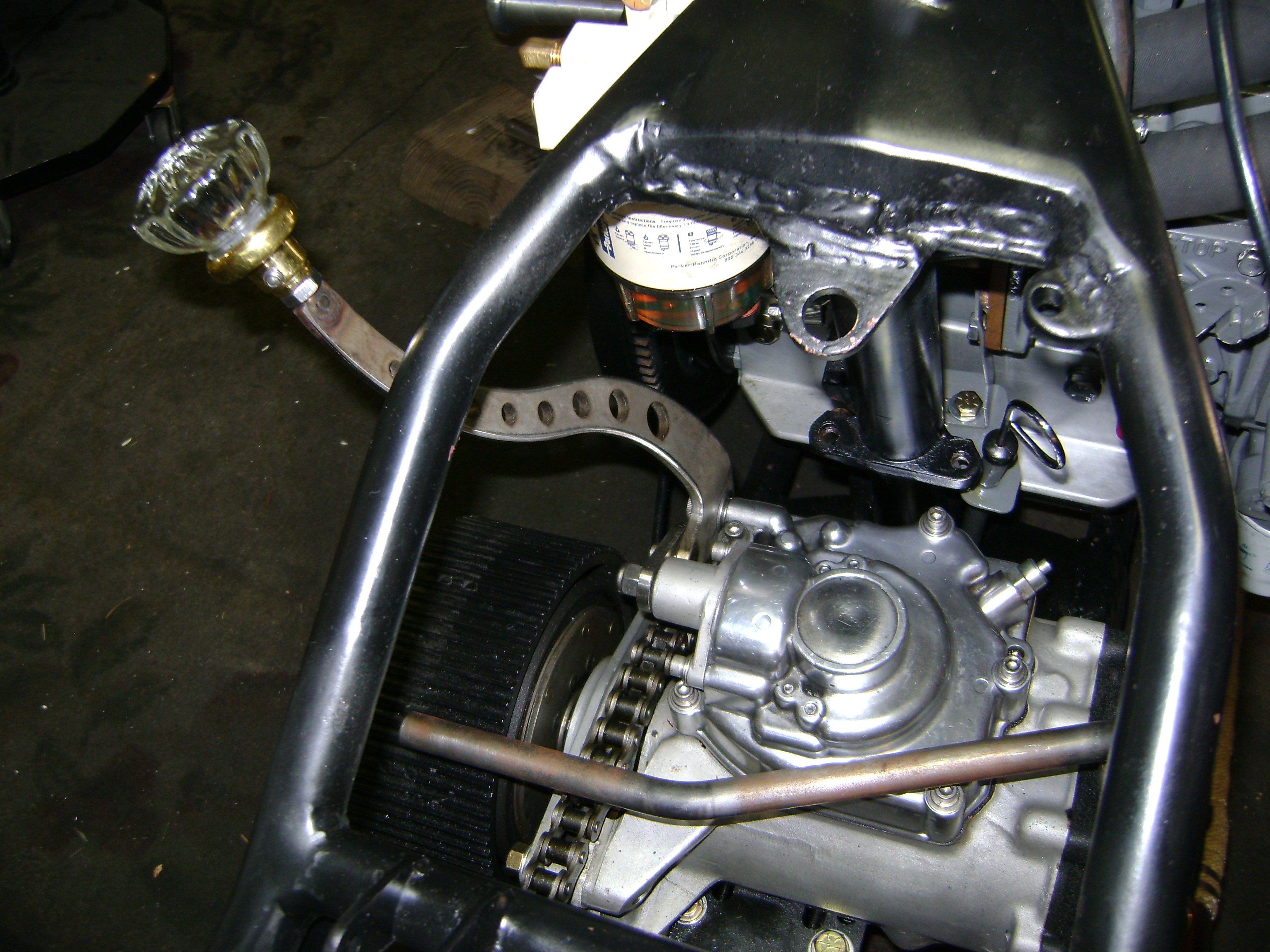

Hi, I'm located on Vancouver Island Canada, and came across this forum, and thought you people might like to see the diesel bike I built, 1961 harley frame, 4spd trans, D950 3 cyl. Kubota. I'll post a couple pics, if there's interest I'll post some more, I'm open to questions as well, Hope I can contribute to the forum and also learn.
Re: klondikekid Treg
"If there is some interest"??? is Santa Clause fat and jolly, does he have a sleigh, does he show up on Radar every freakin Christmas duuuhhhhhh
LOL
yeah throw in a build thread. We would love to know more about your trials and tribulations on building her as well as a ride report. Looks nice. Not my thing (more of an adventure bike fella) but yours is sweet and many will love it.

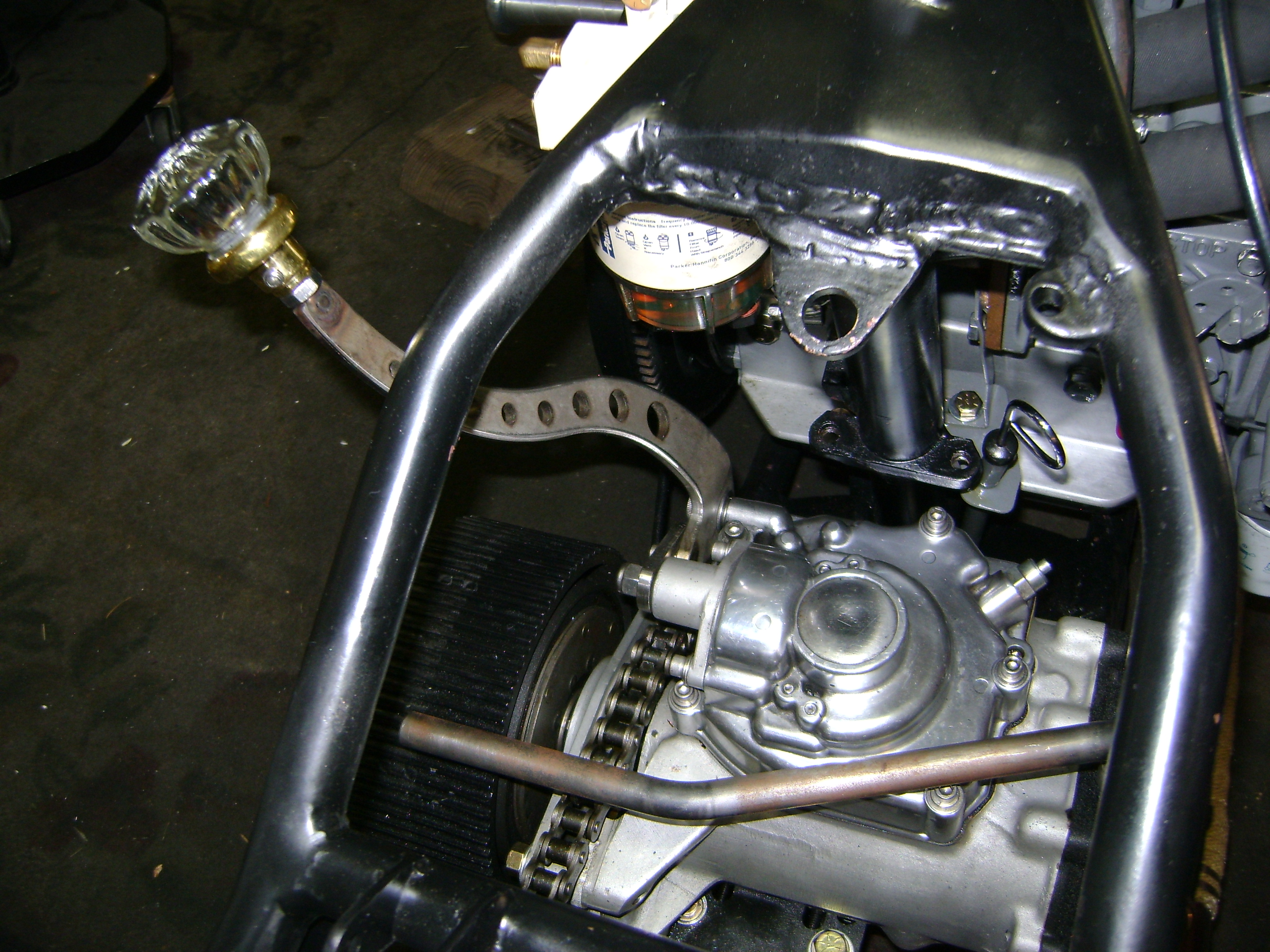

Hand shift tranny... interesting. What tranny is that? Like the fuel return to the tank cap or is that an air bleed.. or both.

Thanks, I'll be sure to throw up a build thread, just have to get thru Xmas, then I'll have some time to put it up here. The transmission is a 4spd Harley trans, while I was building it was easier to make the shifter pedal a clutch pedal with linkage to a clutch release arm from the trans, and bolt on a custom made hand shifter handle, and yes the hose up to the tank is a fuel return line. The build was a fairly easy build, I didn't have to cut, or modify the frame, well not entirely true, I had to cut off the top engine mount tab on the frame to clear the valve cover, could be welded back on. I haven't ridden it yet, I was so close, I got a used clutch drum and engine pulley for the open belt drive, and I went cheap and got a "good used one" on flea- bay, totally worn out junk, so I bit the bullet and got a new set, just finishing up the install now, doing wiring right now too. These x mas holidays I hope to finish up the wiring and finish the belt drive and ride it. p.s. the turbo is a GT15 from flea- bay, can't wait to hear it spool up, under load.

That's a really nice bike your got there.

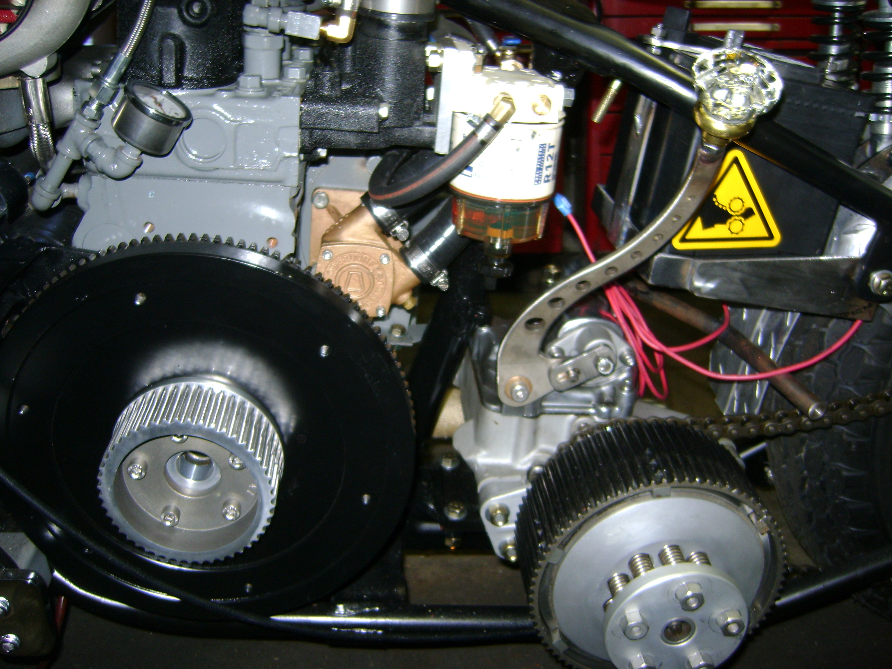

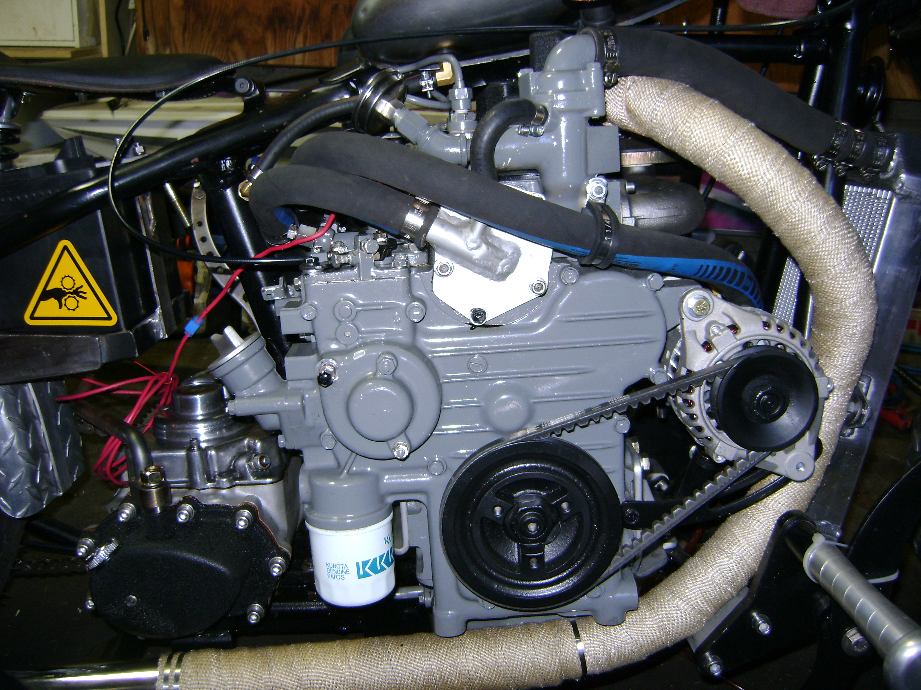

I see you've done away with the original waterpump, how did go about doing that? I'm looking into way's of doing that myself, but on a D722.

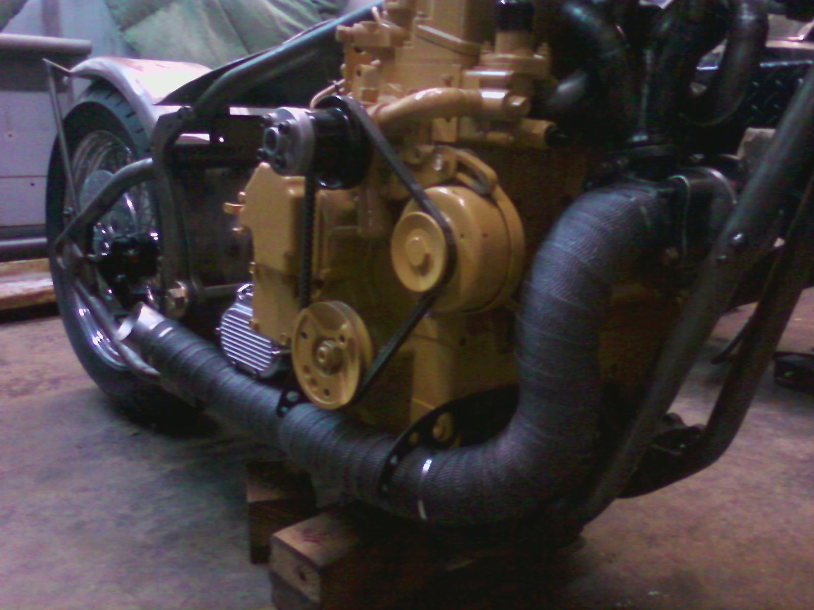

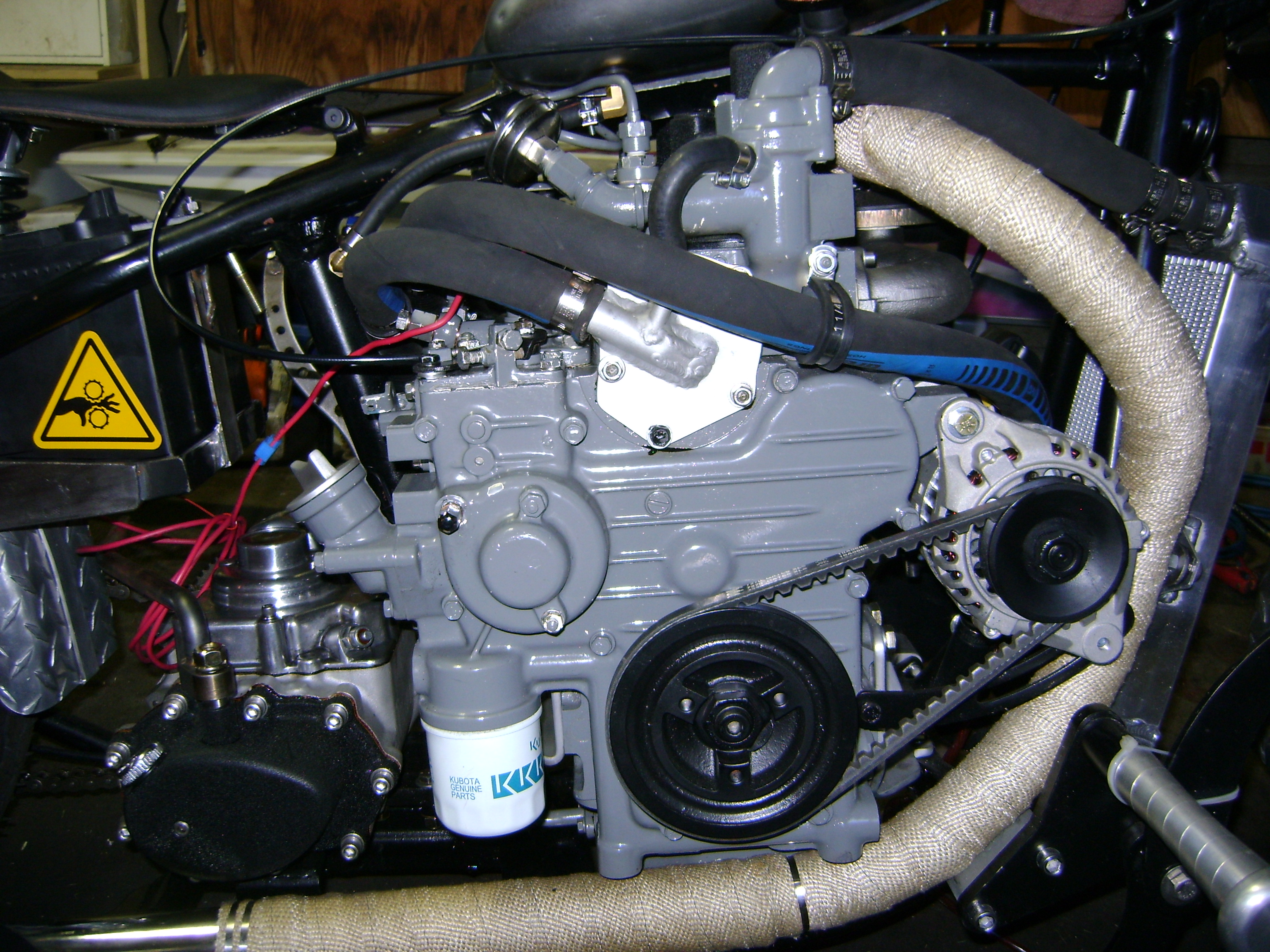

Thanks, the water pump I'm using is bolted on the back side of the injector pump, it came with the engine when I bought it, the engine was from a Onan boat generator, so the pump was for pumping sea water thru the heat exchanger, as you can see I made a plate to go over the spot where the water pump was, if you look at your engine you should see a plate with 4 bolt holes where the pump bolts on, behind that there is a shaft with a slot cut across it where the pump engages, a little looking around, maybe marine engine shop might know where to get one or Onan. Oh, that plate over the water pump spot, I cut all the pieces and mocked it up in aluminum and payed a friend in beer to weld it up.

All-right! No mucking about with electric pumps for me then! :D
Thanks you've saved me a lot of hassle.

klondikekid wrote:Thanks, the water pump I'm using is bolted on the back side of the injector pump, it came with the engine when I bought it, the engine was from a Onan boat generator, so the pump was for pumping sea water thru the heat exchanger, as you can see I made a plate to go over the spot where the water pump was, if you look at your engine you should see a plate with 4 bolt holes where the pump bolts on, behind that there is a shaft with a slot cut across it where the pump engages, a little looking around, maybe marine engine shop might know where to get one or Onan. Oh, that plate over the water pump spot, I cut all the pieces and mocked it up in aluminum and payed a friend in beer to weld it up.
sure that on the back of the IP is a water pump? The D950 was also used in Kubota Tractors and many of the AG (Agriculture) model engines have the hydraulic pump running off the back of the IP. From further reading have also found Onan/Kubota D950 was used as Gensets in RV's and also used the IP shaft to drive a water pump. Course if you know for sure it was a marine engine than this is a mute point..... except that it means someone.. (kubota or Onan?) made water pumps that fit on at least one model of IP they used on the D950 (probably same IP used on AG and Marine)
Note:further reading it appears Kubota made the IP shaft drive water pump

I put a new rubber impellor in the pump from the marine supply store, and it's a common size impellor, and it's for sure a water pump, not too sure where to get a replacement pump,There not too cheap, I had to buy one before for a boat I lived on, It looked almost the same just a different mounting, if you look in my pics you will see it from the left side behind the fuel filter, I left it glass beaded bronze. I'm right in boat country here and know lots of people in the boat repair biz I'll ask around and see what I can find out.

Klondike, could you tell the diffrence in volume pumped by the seawaterpump in comparison too the stock coolant pump? Is it actually sufficient for the job? Can the rubber impeller handle the heat?

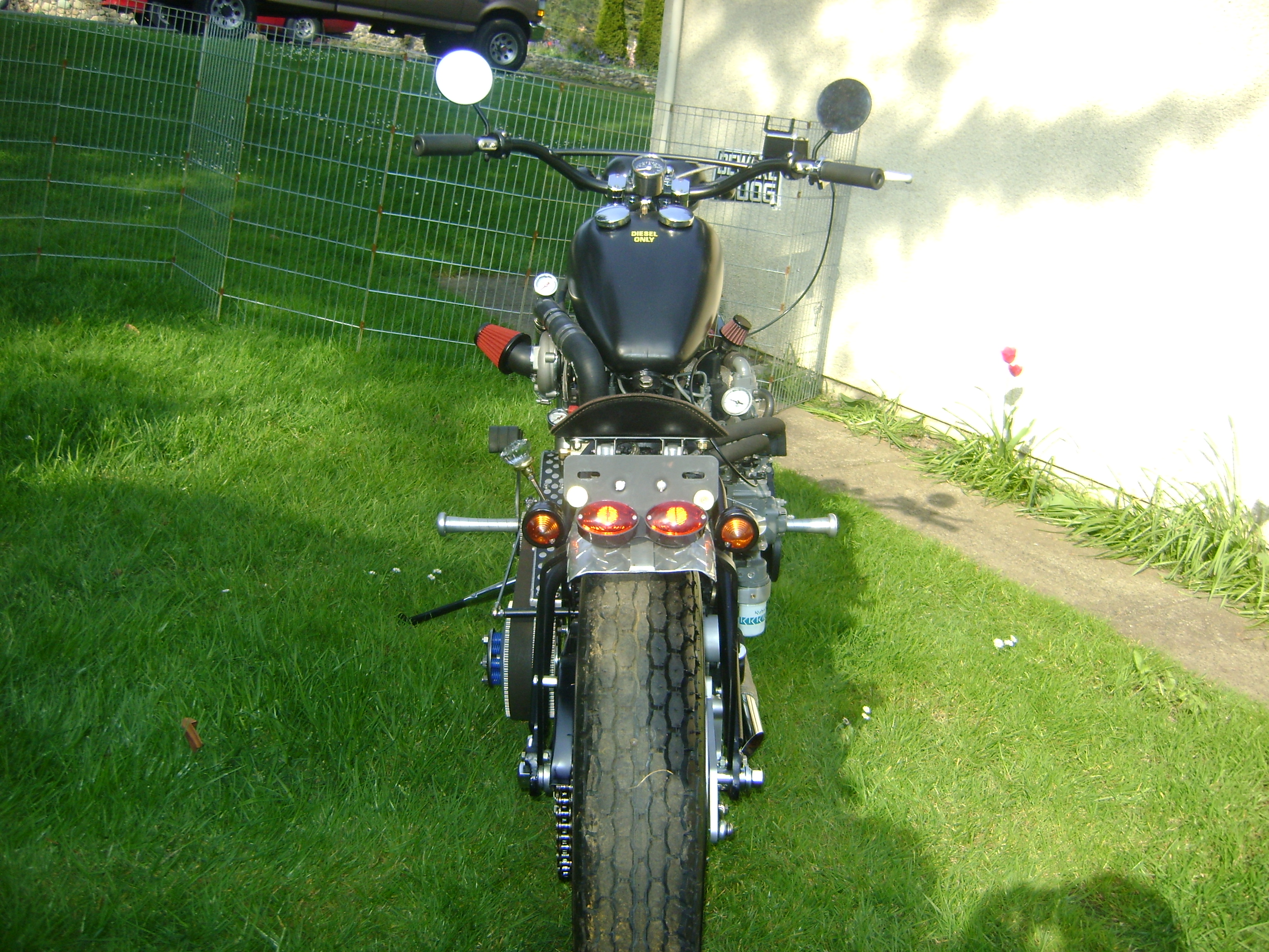

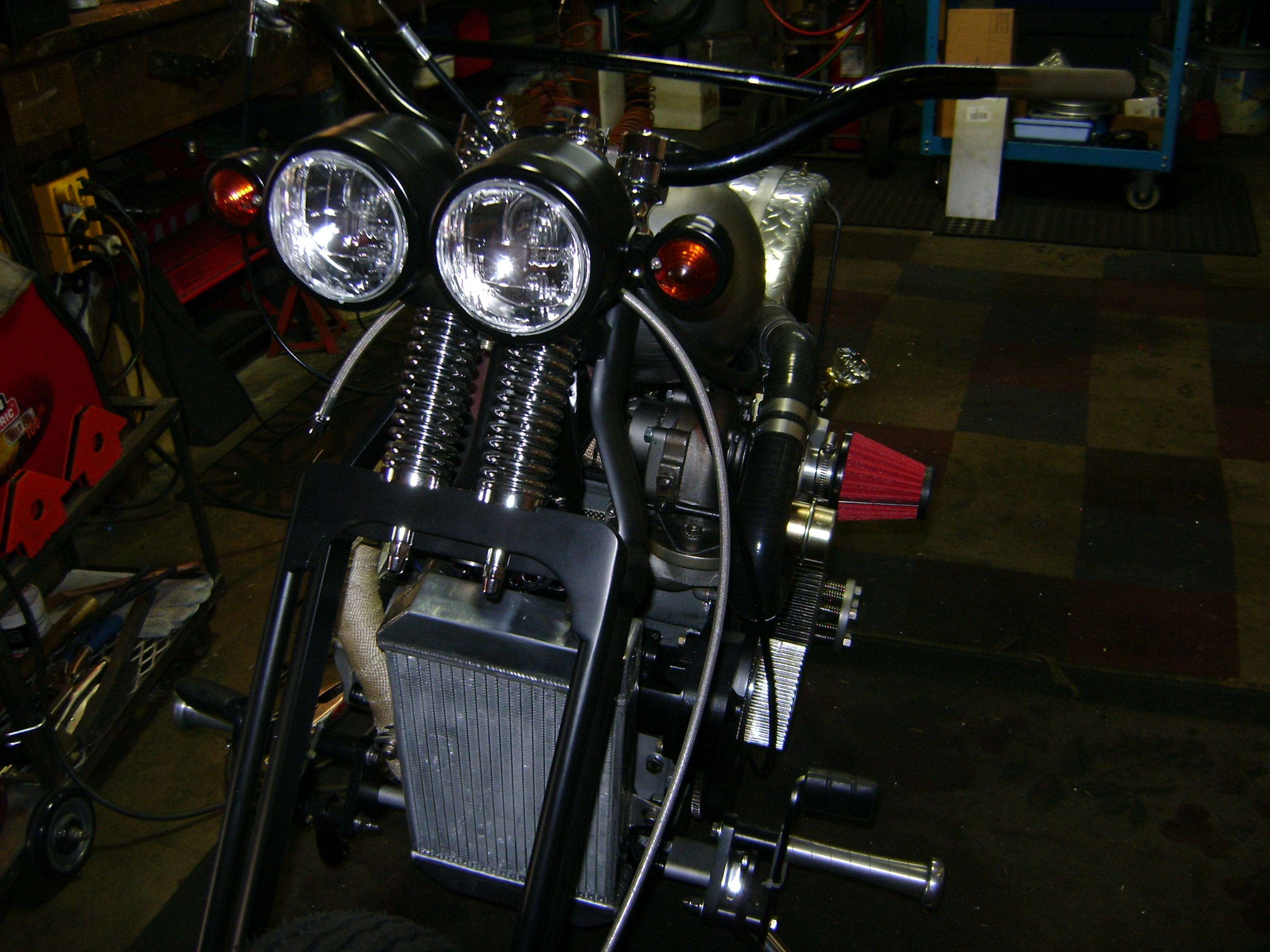

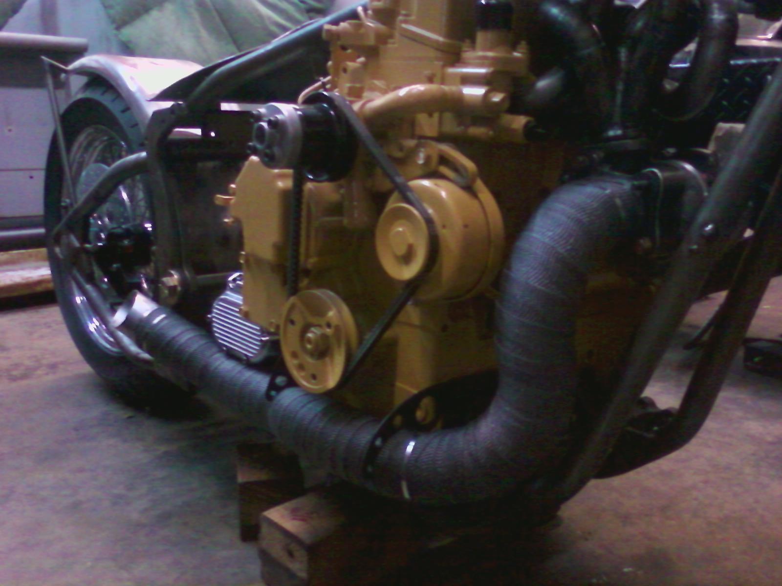

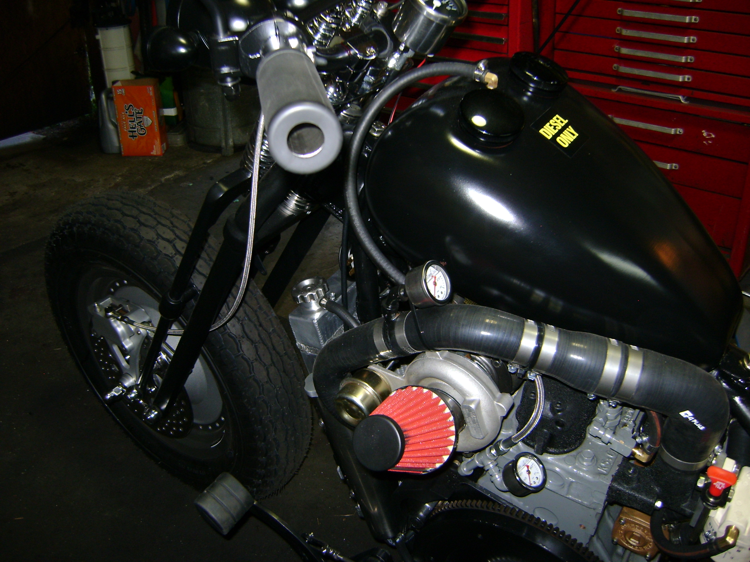

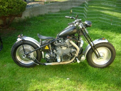

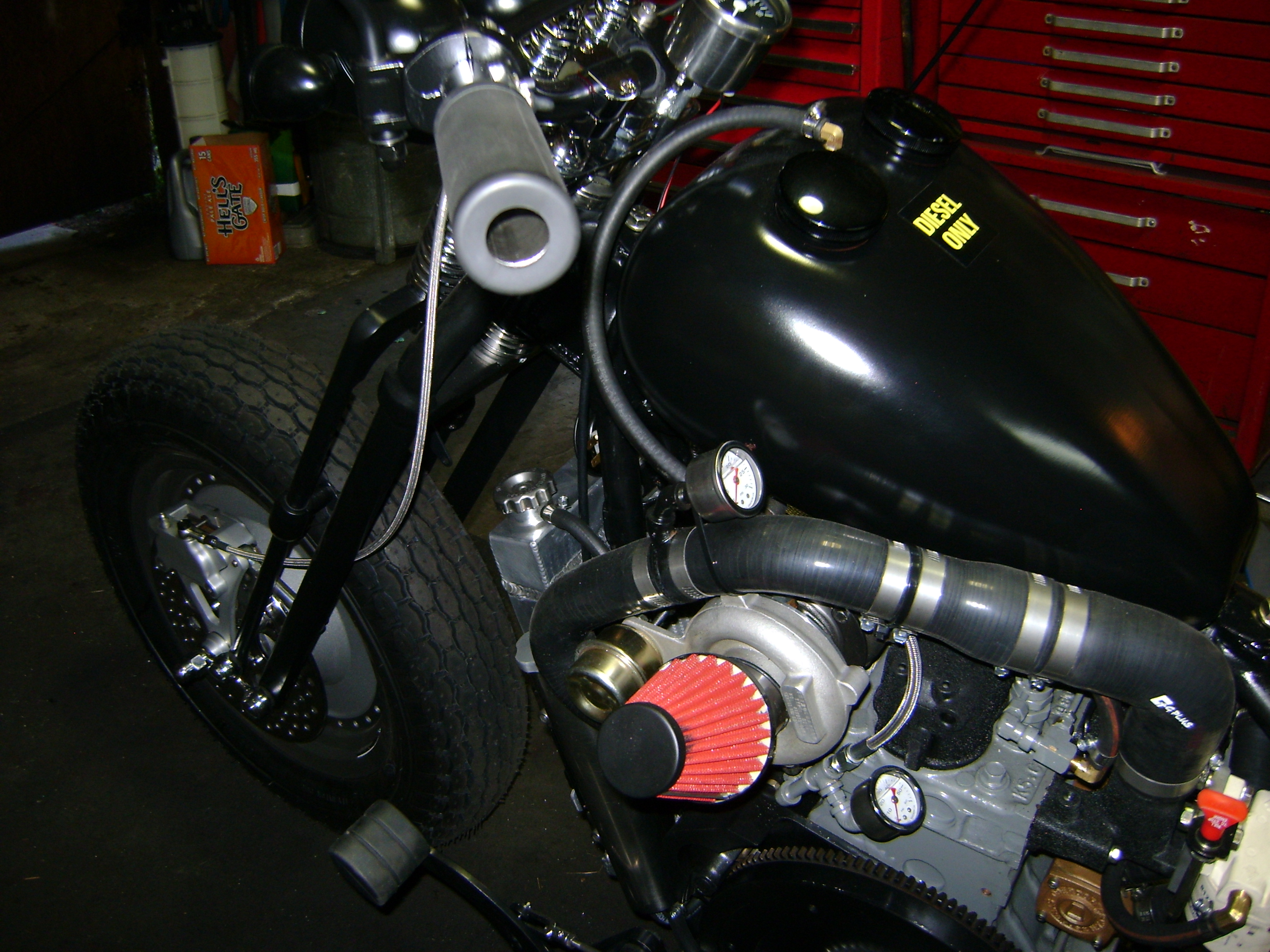

Heres some updated pics, I have lathed 12lbs. off the 38lb.flywheel for quicker revs, and no.. the engine doesn't vibrate that much more than normal, sure revs quicker though, also got rid of the e bay china clone turbo, it leaked and boost was crap. bit the bullet and bought a garrett GT12, it made a world of difference, the exhaust has the tell tale whistle now, very cool.

Post by klondikekid »

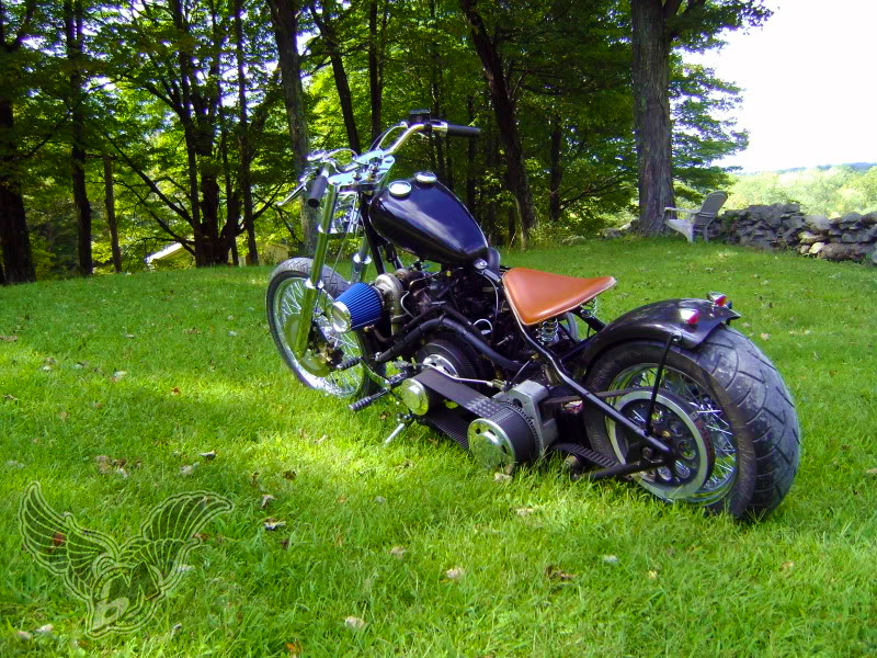

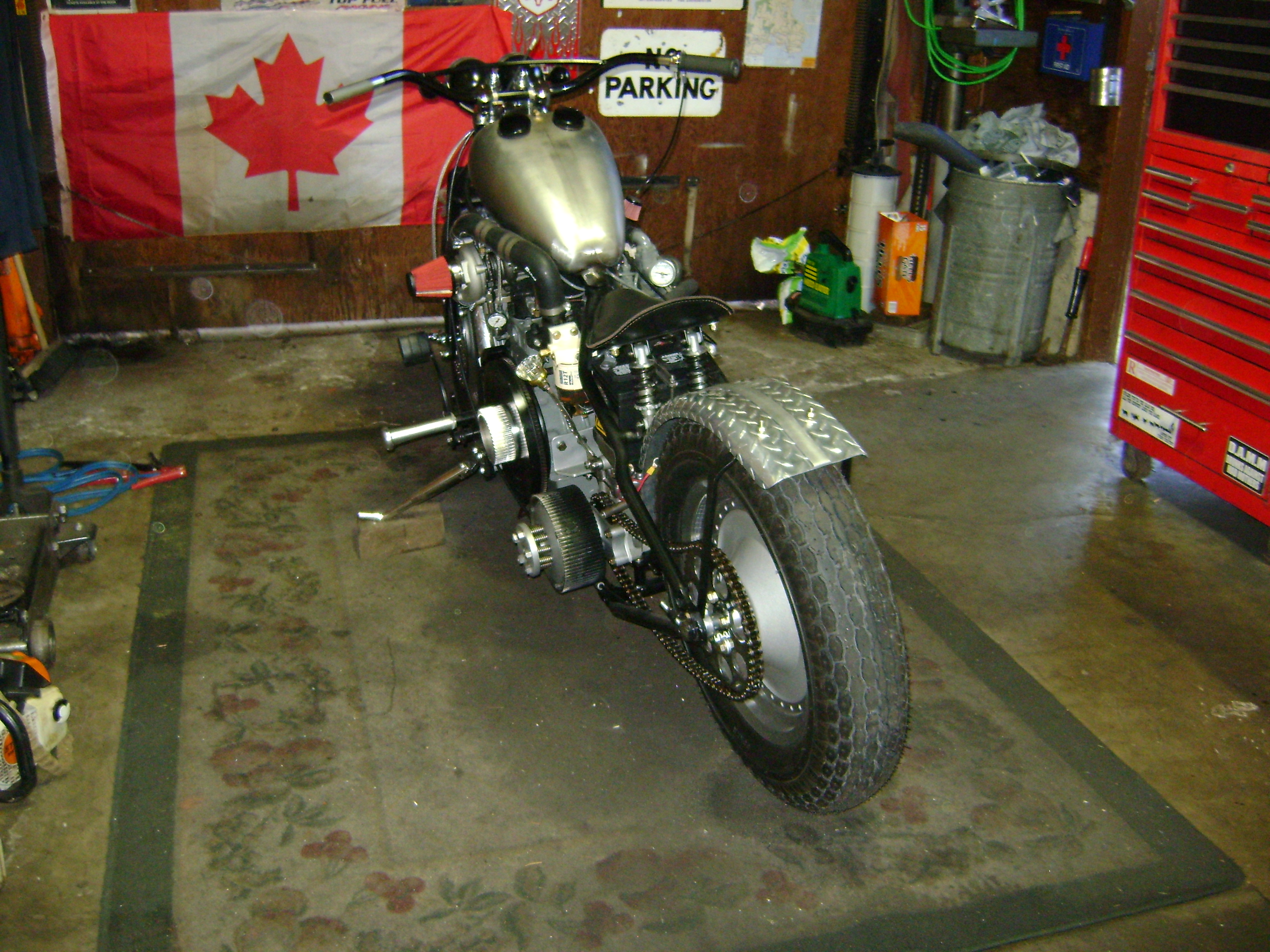

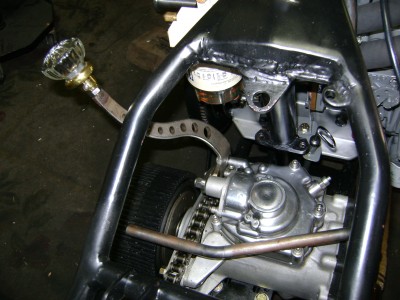

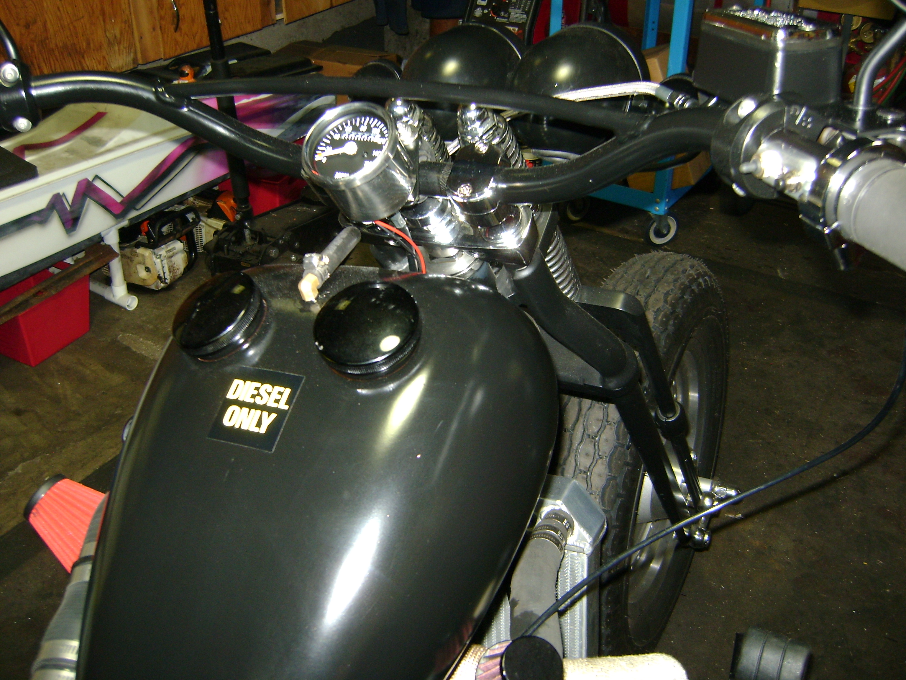

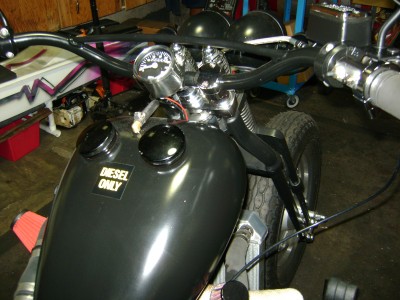

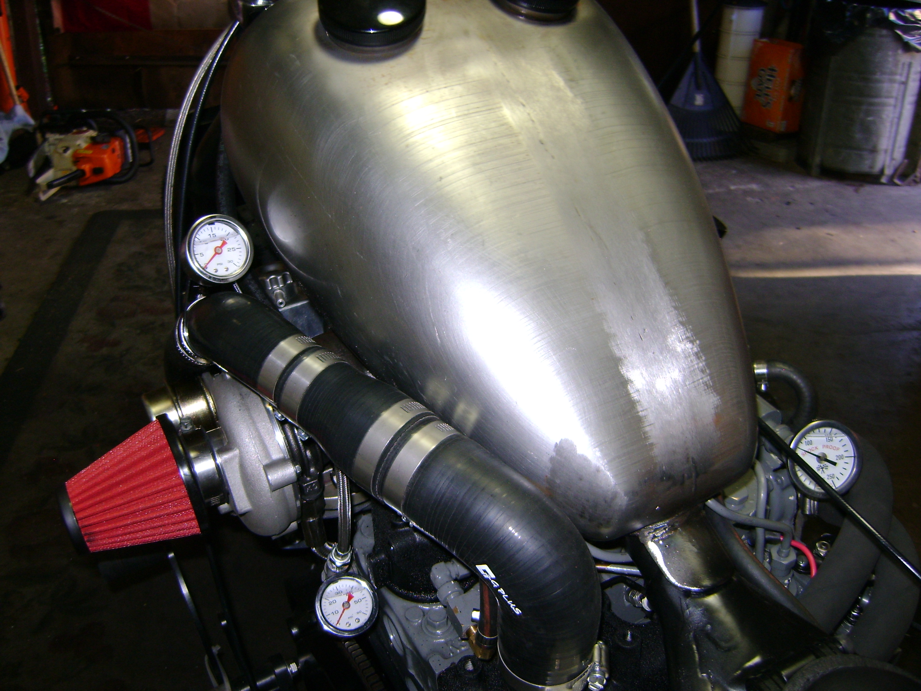

More pics

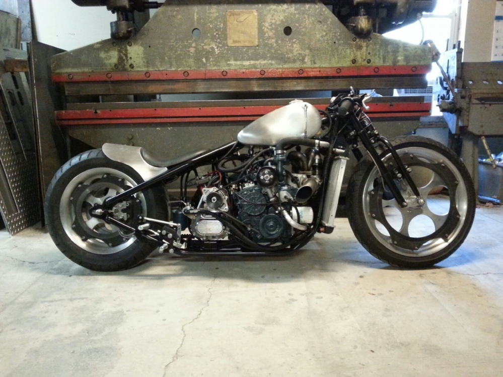

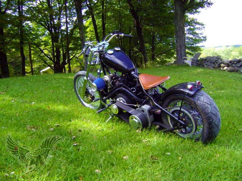

Heres some bikes that Sam at dethmachinefab has built his bikes inspired me to build mine. check out his youtube videos....you'll be blown away.
Deathmachinefab; a member here, has inspired many with his creations. Though he rarely pops in here we still accept him as one of our own :mrgreen:
You've done fantastic work as well klondikekid!!! Mucho thank you for the update.

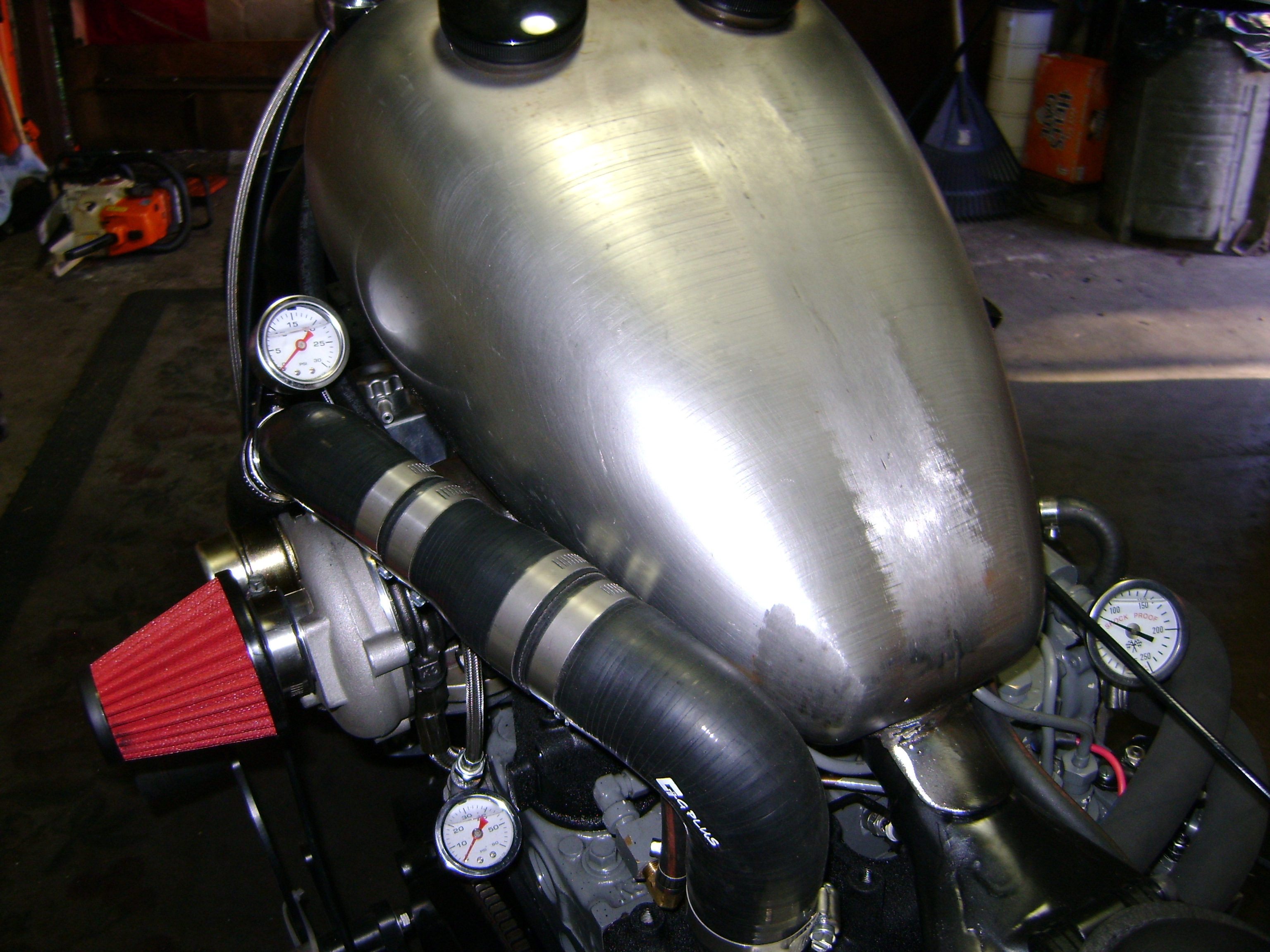

Winter is here again in Canada, well cold rain anyways.. so I got this urge to do a little upgrade on my bike, supercharged turbo combo, anyone have input on this? I know how to do it, I know it will add weight, but a turbo on one side and a blower on the other side...the cool factor is killing me...talk me out of it if you can, before I just do it.

Just have a bypass valve open at 5-8psi manifold pressure. You can ratio the supercharger more aggressively without overboosting and the turbo will take over once its built up its own boost.
Losses would be fairly low since the supercharger would just be moving air instead of compressing it when the turbo takes over.
A throttle body from a small gas engine would work with a wastegate actuator attached to the throttle lever.
Look up the silver series 2-stroke detroit diesels, they used a bypass system on their blowers to reduce pumping losses when the turbo spools.

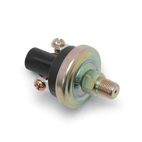

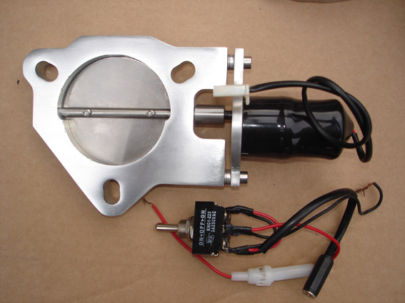

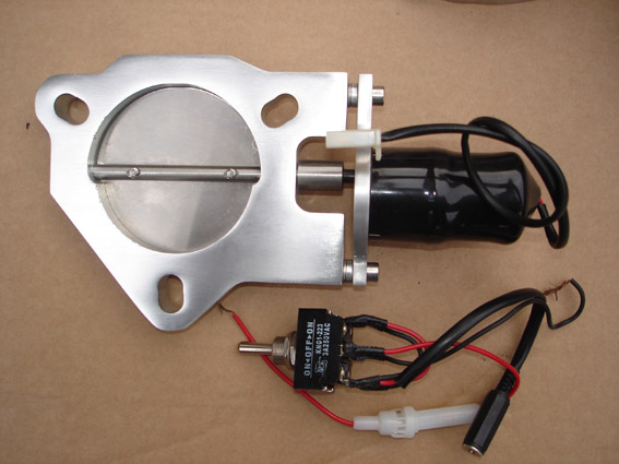

You've read my mind UAofE here's what I was looking at, Edelbrocks turbo pressure deactivation switch adjustable 3-20 lbs, and some sort of electric exhaust cut out valve, thinking the exhaust valve is designed not to leak,(exhaust leak) that i can modify to go in the by pass hose, I like your idea of trying different drive ratios for best performance, I'm like a kid waiting for X-mas now, super should be here by end of week, I'm going to try to keep things on the safe side, no crazy boost levels, I want it to be reliable and be long lived....until I find another D950 and rebuild it with some performance upgrades, maybe if i ask nice dethfabmachine might give me some of his trade secrets. I'll post pics as I do this.

A switch won't work, it has no hysteresis to prevent it just dumping open/closed at an exact pressure.
You need a system that will crack open at Xpsi and progressively open/close on demand. Thats why I suggested a wastegate actuator, they naturally vary valve position based on pressure.
Throttle bodies are better, a manifold leak through the shaft isn't desirable at all. An exhaust cutout can leak a little because it won't affect engine operation and its under the car where a small leak isn't a hazard.
Thanks for the input UAofE, you made some good points, makes a lot of sense having a vacuum style open close, I was thinking a fast switch open close would be kind of erratic...The more in put the better, It's cheaper and easier to build this just once. throttle body is an easy adapt too and cheap. feels like I'm half way there....
