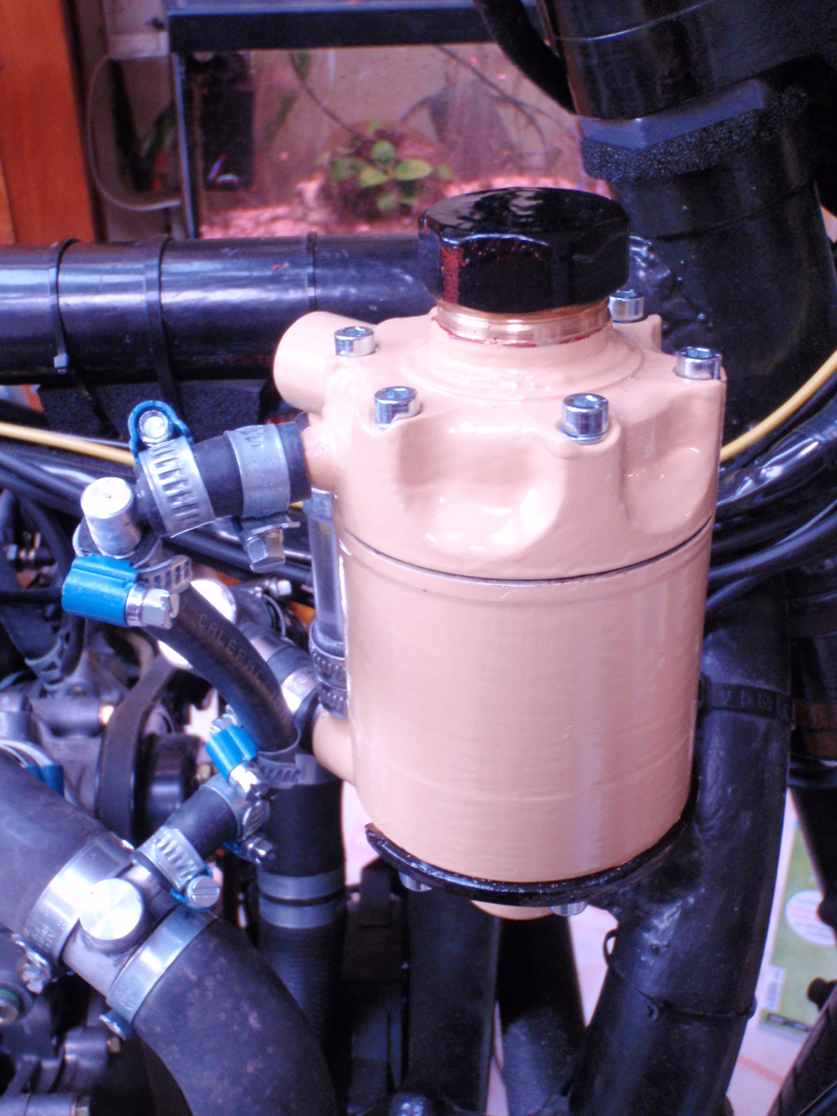

coachgeo wrote:Expansion vessel? Please explain it's purpose in this build?
Just guessing but such a thing is normally used in a closed cooling system, where the radiator cap doesn't have the common pressure pop-off lever. Instead as water heats and expands it overflows into expansion tank and remains there until engine cools and it can then contract and re-enter radiator cooling system.
There's advantages because pressurized water resists the tendency to boil. In essence, the coolant water can transfer a higher temperature exchange, allowing better cooling and also guaranteeing that water won't be lost in boiling away or evaporation.
Just guessing but such a thing is normally used in a closed cooling system, where the radiator cap doesn't have the common pressure pop-off lever. Instead as water heats and expands it overflows into expansion tank and remains there until engine cools and it can then contract and re-enter radiator cooling system..... :D
Agree on work of art. So it's a ahhhhhhhhh.... billet overflow tank so to speak.

The Daihatsu is watercooled.
When water is going hot it expands. The vessel works as an resorvoir and the pressure escapes in the open air.
One of the top nozzle]s is open , the other is for escaping air bubbles into the air catched at the highest point.
The bottom nozzle is for filling the system.The bras inlet can be open or closed with a hexagonal bras screwcap.
The vertical nozzles are for a watergauge.

Why that system over a typical pressurized coolant system with an overflow tank?

coachgeo wrote:Why that system over a typical pressurized coolant system with an overflow tank?
I cal it an expansionvessel, but it is the same as an overflow tank.
The system is without any pressure. Why pressure the system? The hoses can leak when the pressure is to much.

I was mistaken, CoachGeo, it is not a closed system as I described.

The expansionvessel mounted on the bike.

pressurizing the system raises the boiling point of the water making the radiator more efficent
