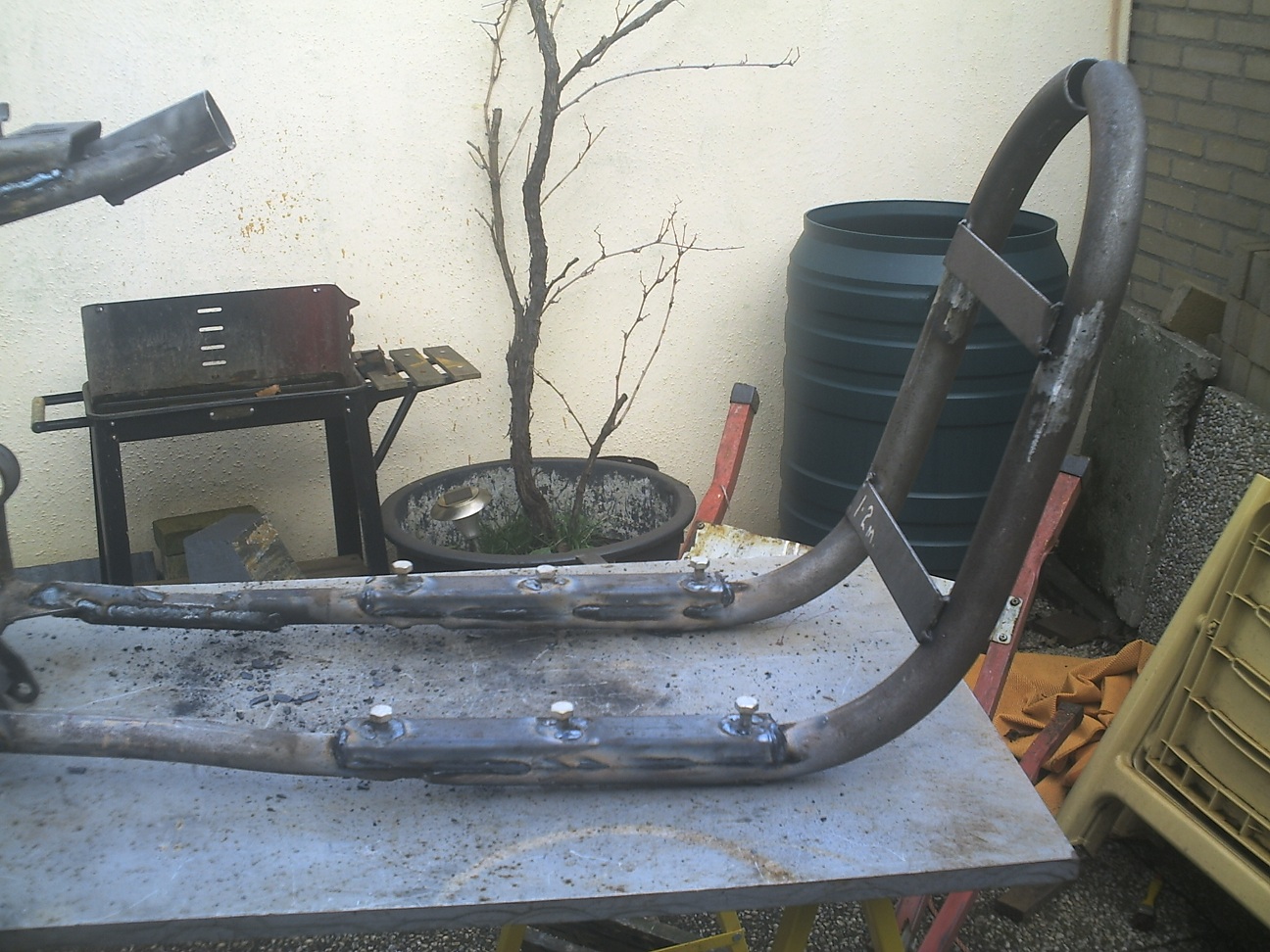

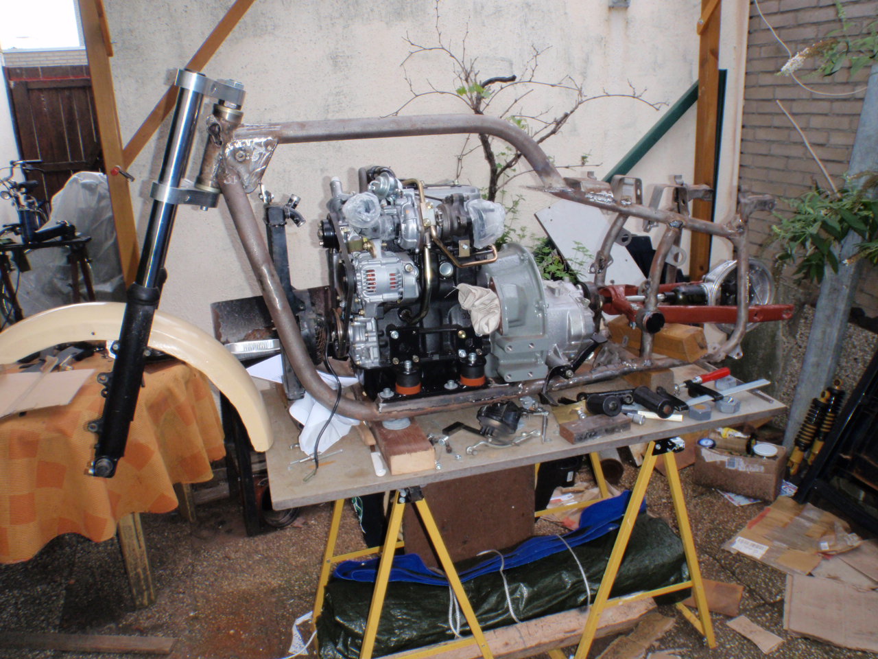

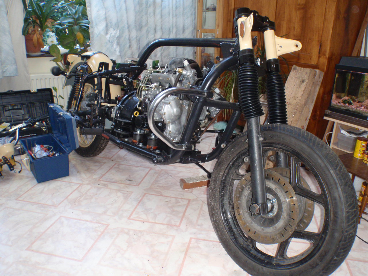

Hello,

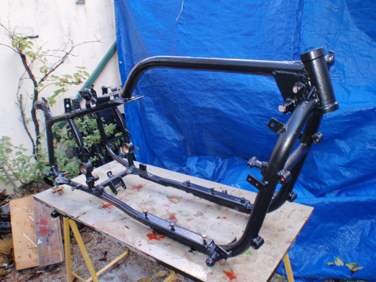

I am building a dieselbike, Never thought it would burned so much time.
My ambitions are high, I build one with reasonable power, Daihatsu 3 cyl. about 24 Kw.
I used the rear end of a Dneprframe and the rest I made of pipes to become a frame for fitting the big engine and gearbox.

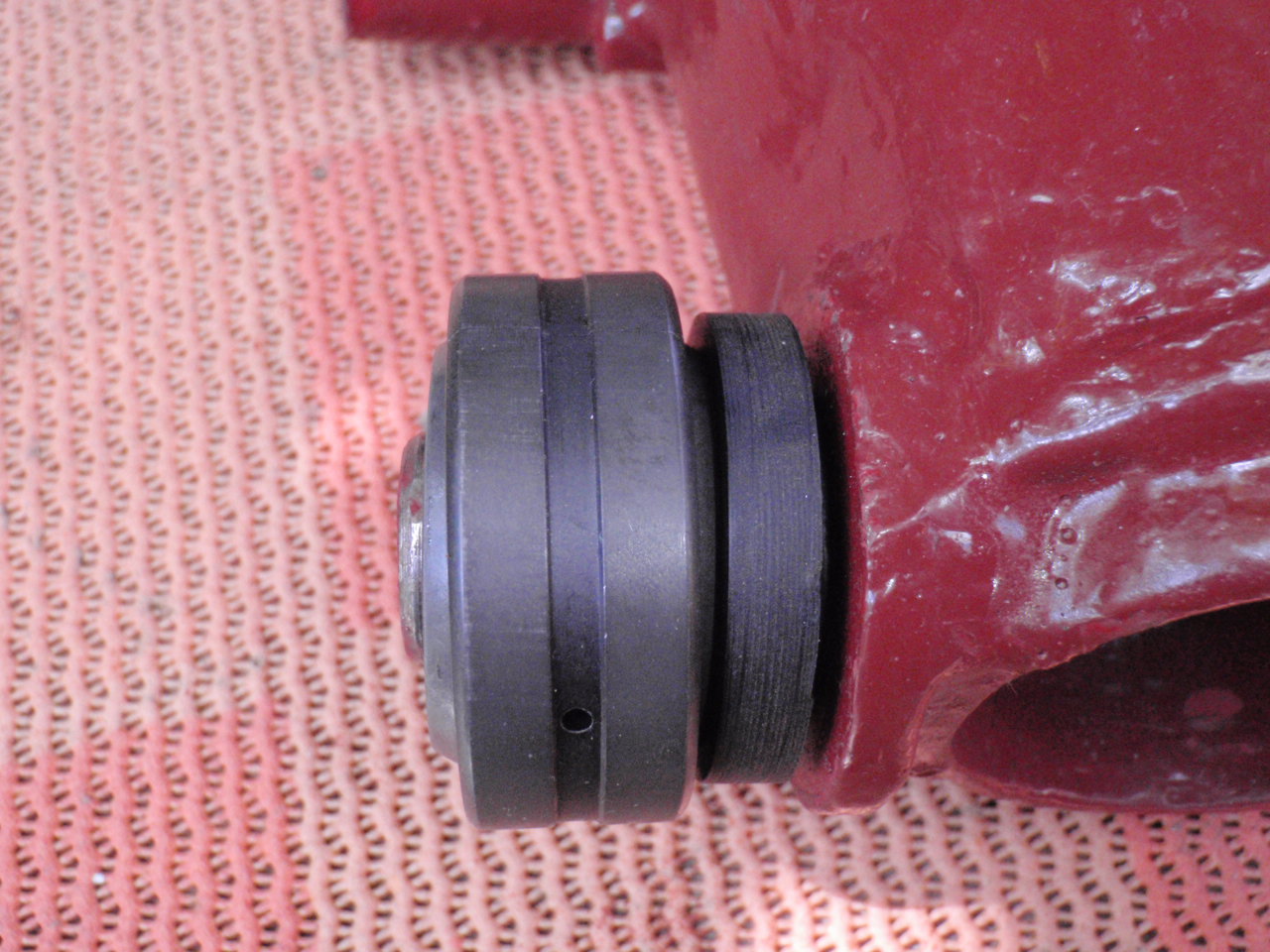

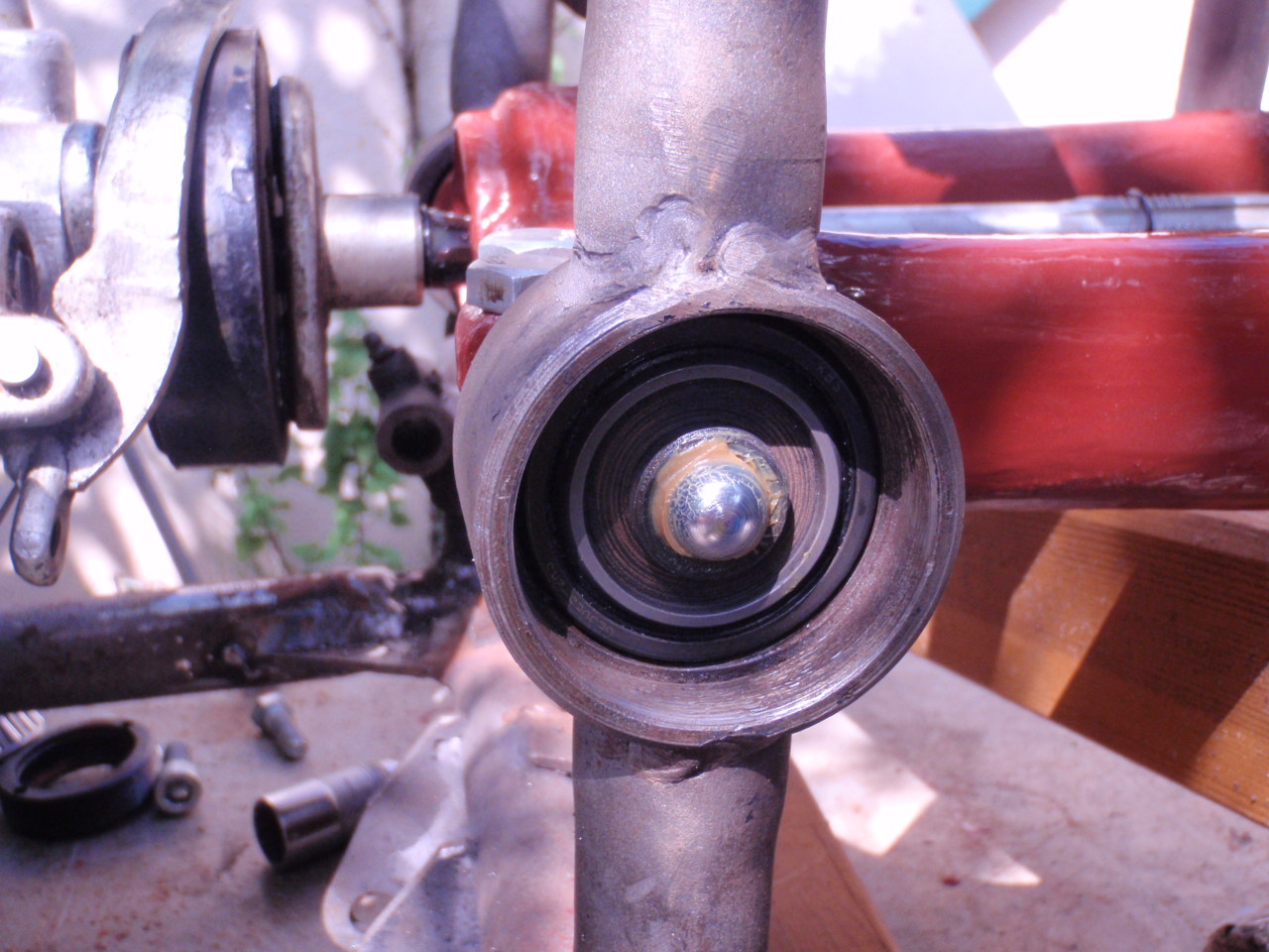

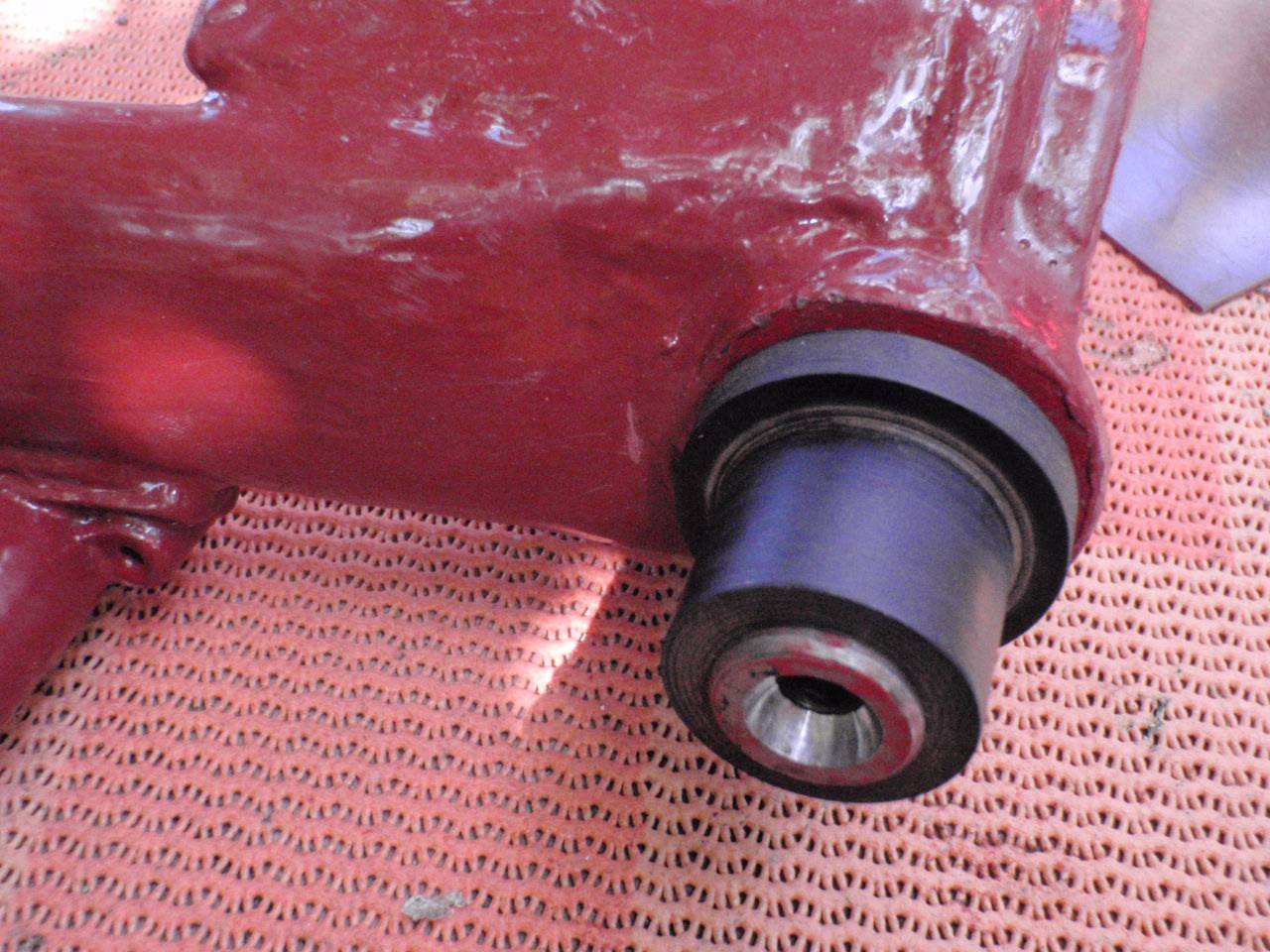

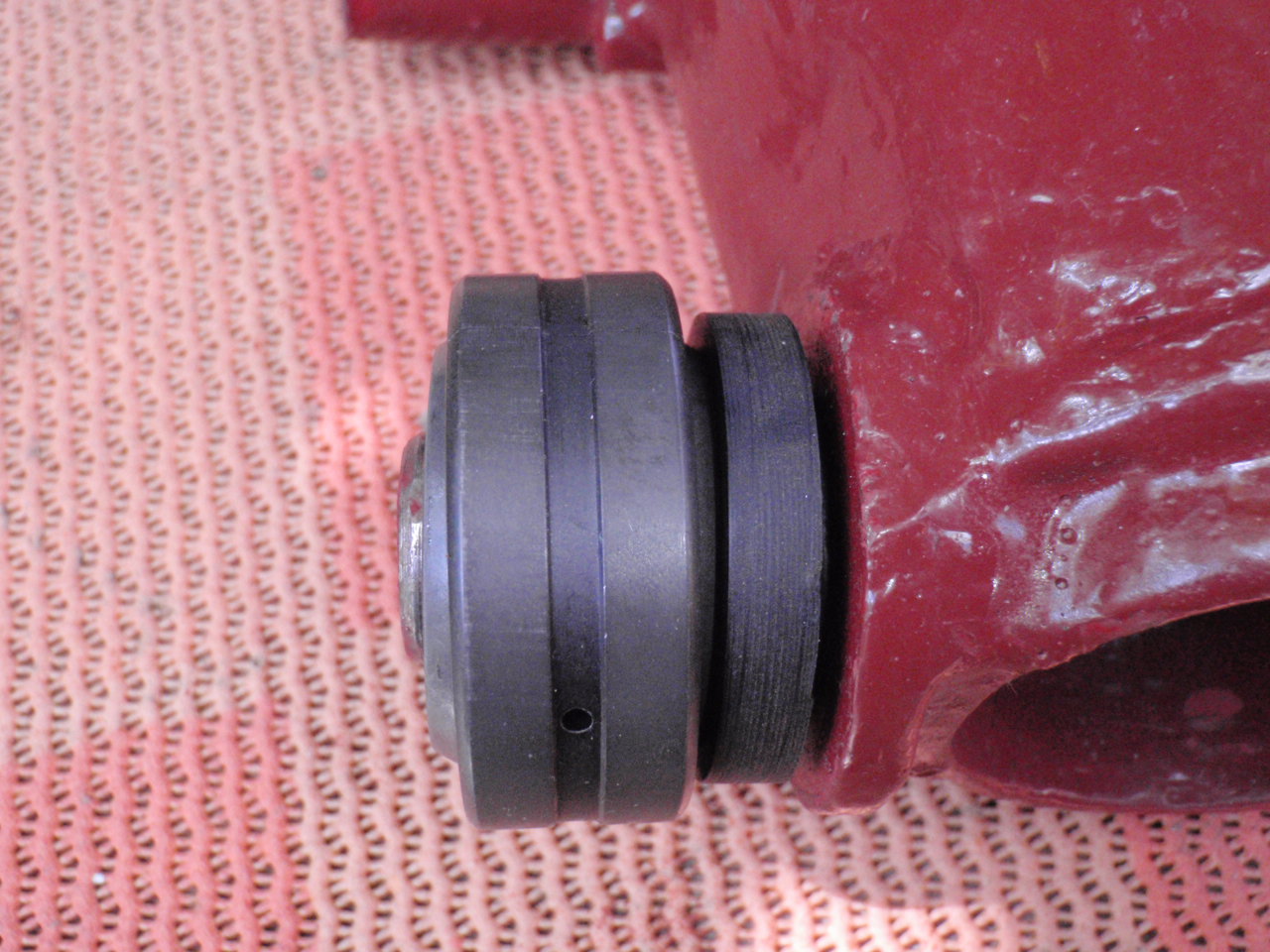

I use an Dnepr gearbox, 4the 1:1 finaldrive from solo.
I have a set 4the overdrive in the drawer , not using yet but when the bike has the papers I will experiment with this new gearing.
The rear is provided with new self adjusting bearings with seal. Axial forces are transferred with a single ball.

Re: Building a bike with an DM950TD

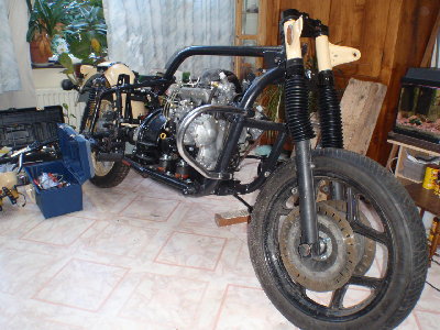

Fitting the engine in the frame.
Every step is a lot of work.

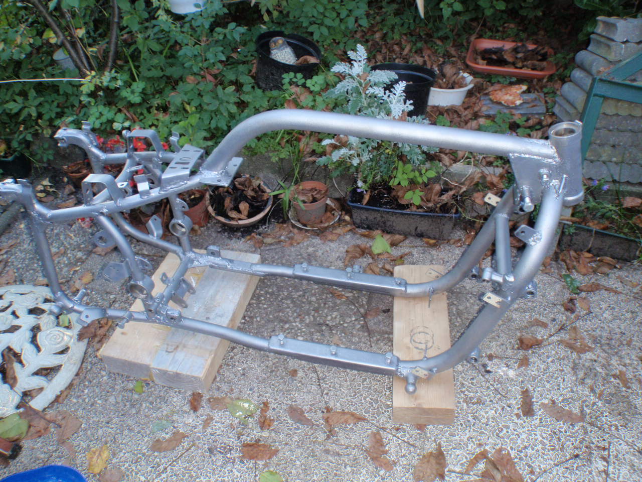

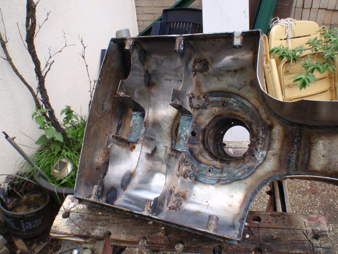

I blasted the frame with glass and painted with 2pack industrial primer, after the primer I painted theframe with black 2pack polyurethane topcoat. The topcoat is only for spraying. But painting with a brush is possible but not so smooth.

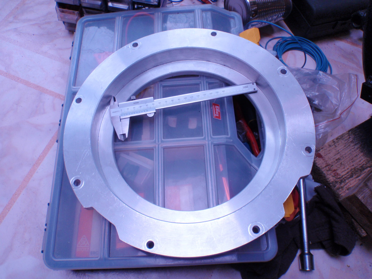

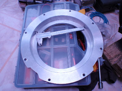

Fitting the gearbox to the engine is a job where you have to measure everything. The firsttime I did it wrong. The pict is the second flange.

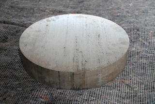

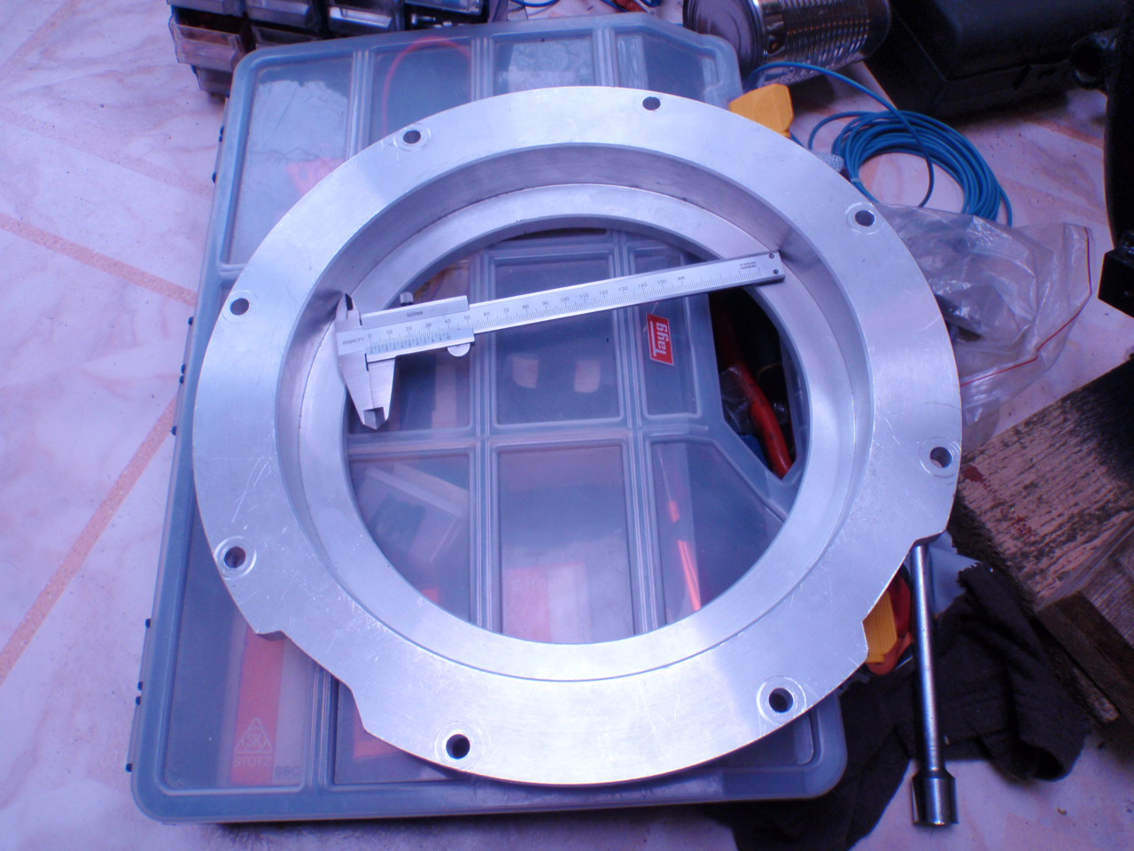

Make no mistake, Henk milled that flange from a solid piece of aluminium. Or should I say slab
Yes, is was a solid disk alumnium.
I bought it in Germany (internet) and they shipped it to my home.
Lucky we have a big lathe at the maintanance department. For a few apple-cakes they made the flange.

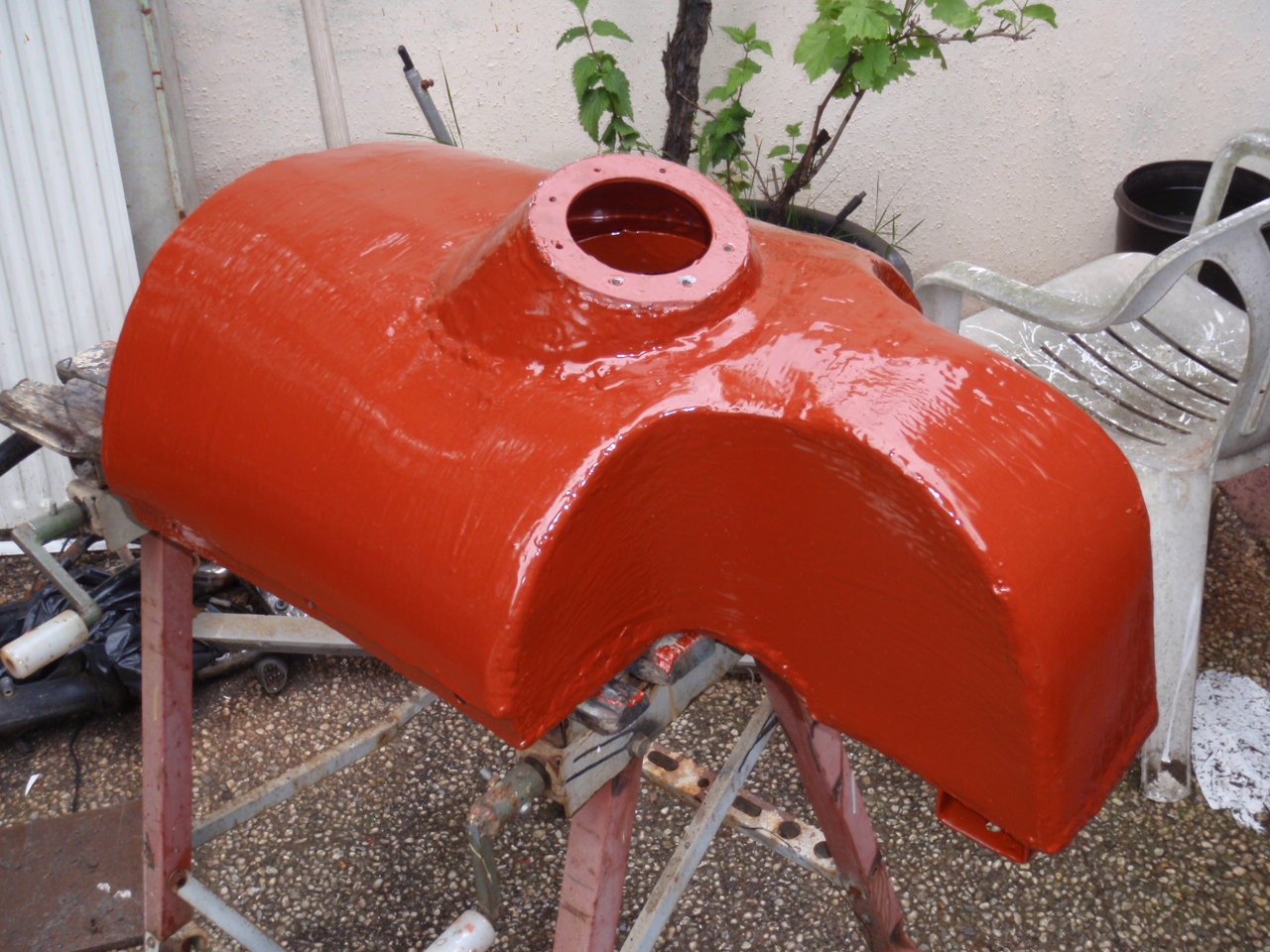

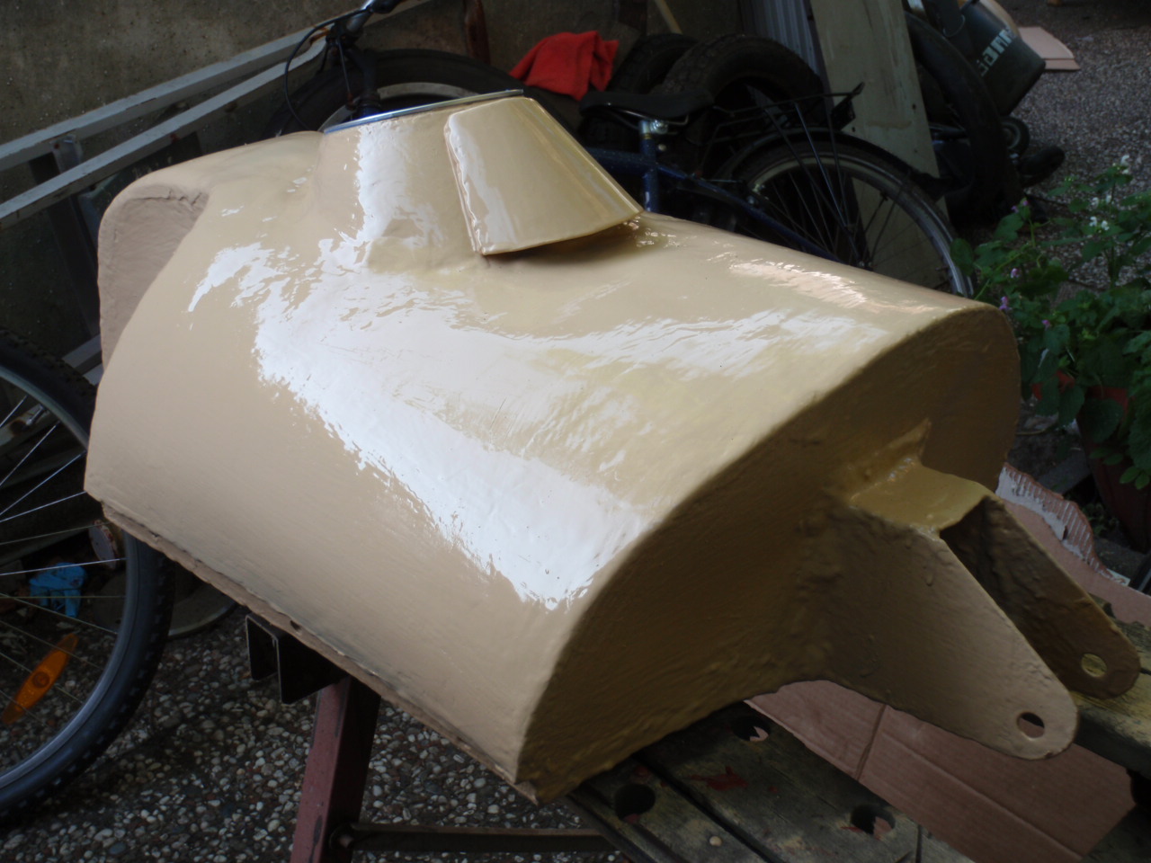

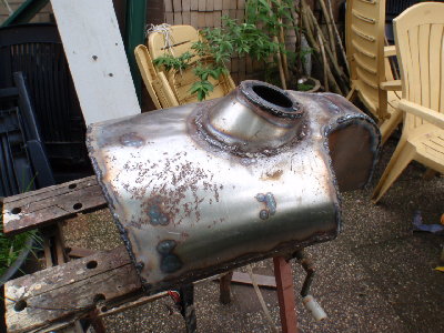

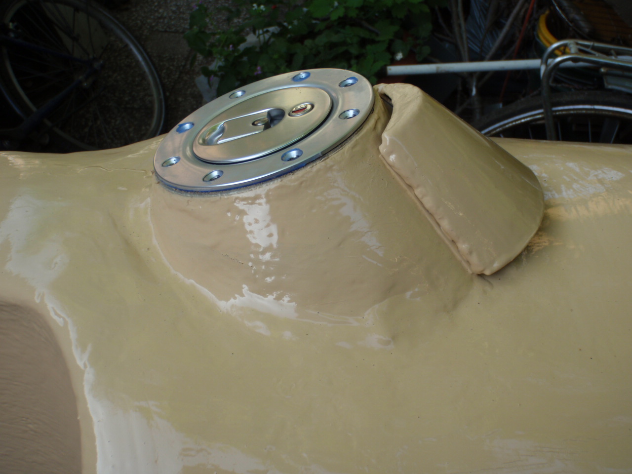

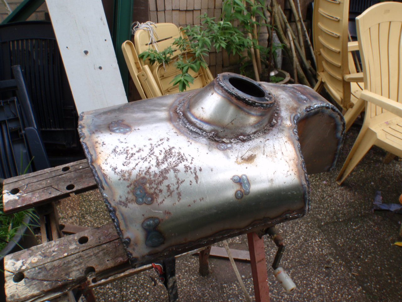

Another pict from the fuel-tank.
The red primer is very thick and sticky. It's like a tough sirup.
The topcoat is a carpaint, the color is old colour from VW, bast-beige.
In the top is made an littletube for even the pressure to avoid vacuum in the tank, the shield is protecting the hole for rain etc.

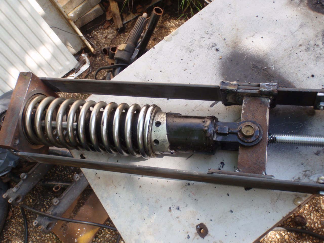

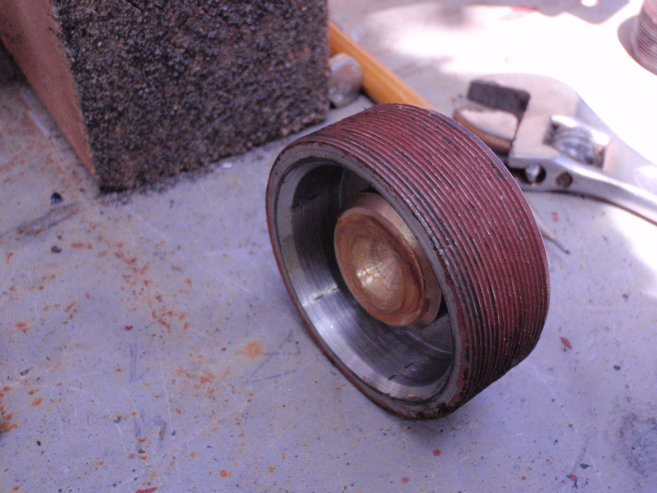

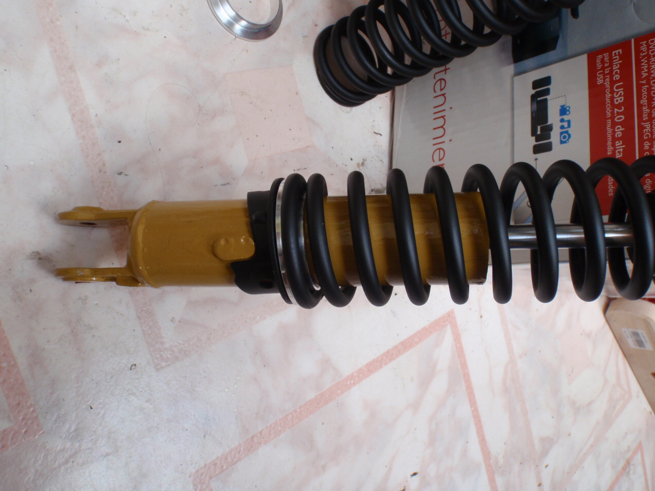

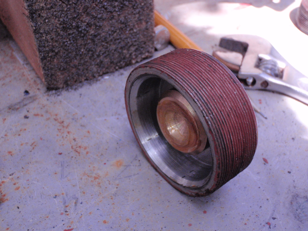

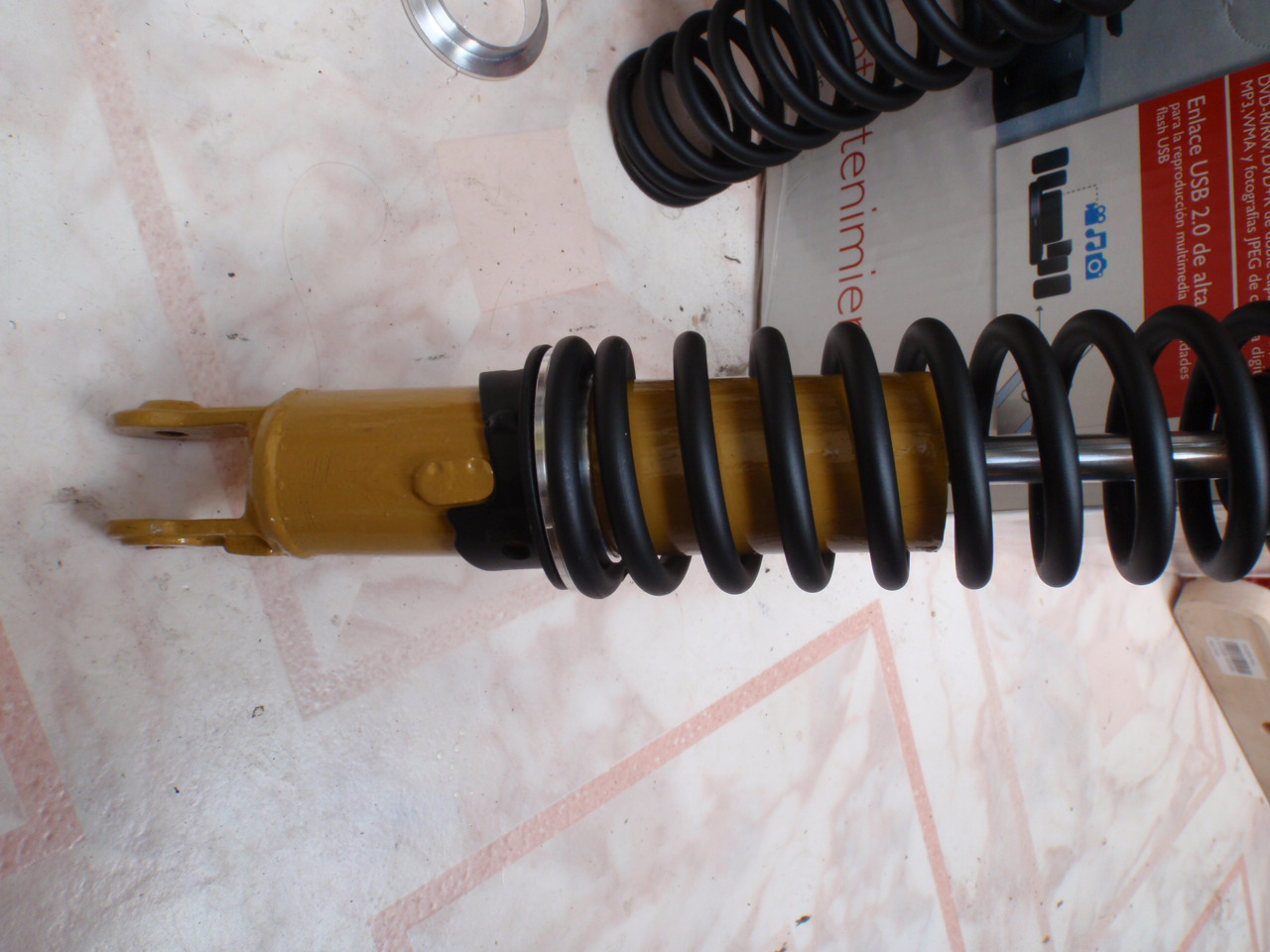

Here a pict from an self made tool to dismantle a rear shockbraker. It is rough but I don't believe I will use this tool very much.
After repair the shockbrakers I painted them over.

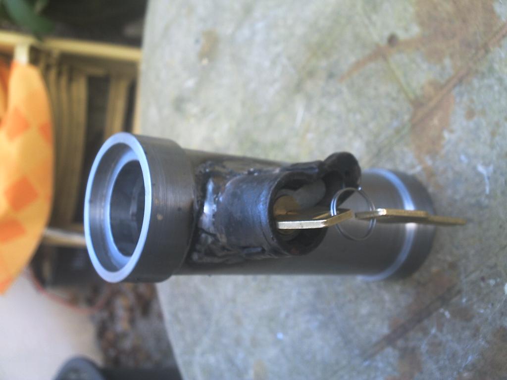

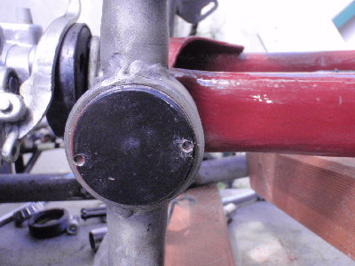

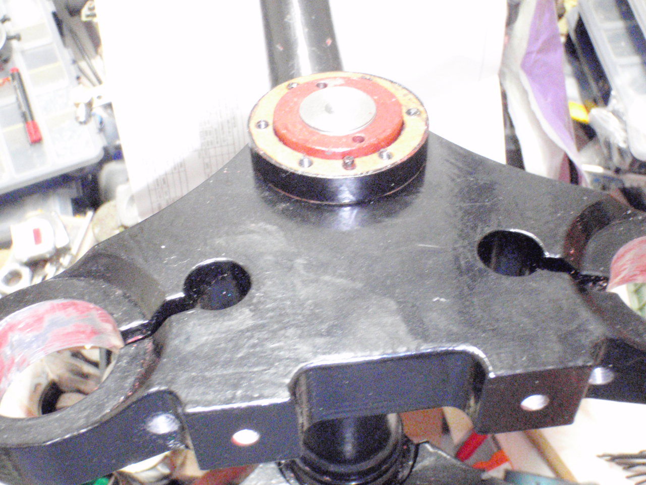

I found a pict. from the very early beginning of welding the frame.

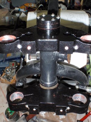

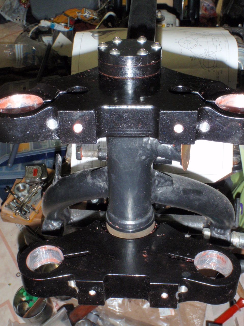

The steering section, I don't know the right name, just cut on a lathe and welded a key-house on it.
Nothing goes easy, while I place the pict. I remember the hard labour it cost's.

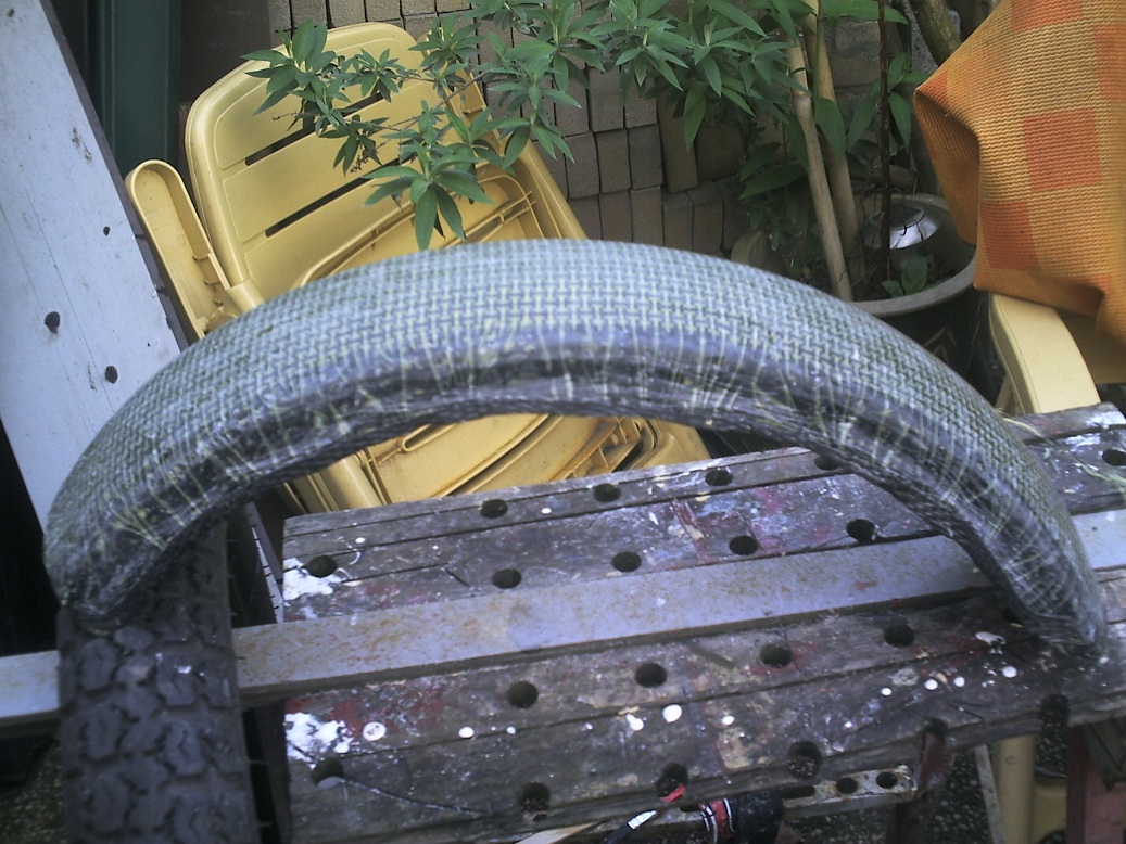

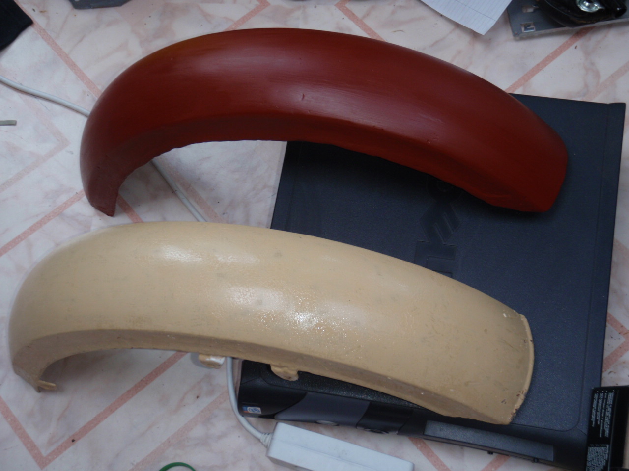

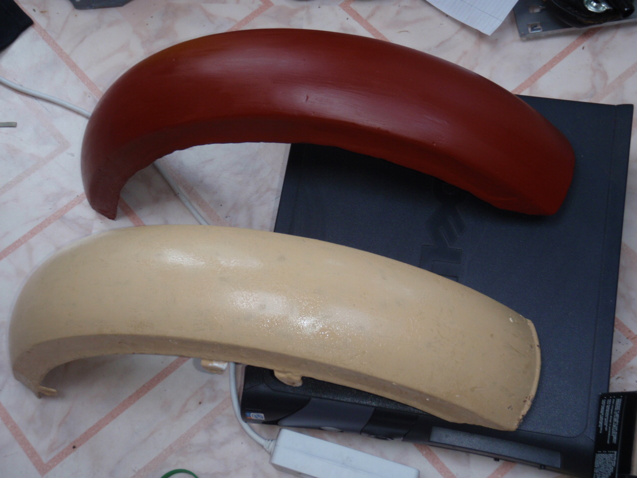

The lugs on the aluminium frontfork are to weak for a steel mudguard to my opinion.
I use the fork of a BMW K100. It consists of 2 front legs each apart and connected in the crownplate.
I suspect these came from a type with integrated mudguard instead of a mudgard mounted on the frontfork.
I have an steel mudguard from an Dnepr, 6kg steelplate, to heavy for 4 M6 lugs. the size is near 1/4 inch . So I made the mudguard by myself.
I copied the mudguard in polyester, peace a cake. Before I put the polyester on the mudguard I waxed it in.
Waxed the mold 4 times to, so the epoxy couldn't attached to it.
I put some carbon-aramide cloth inside the polyester mold and put the epoxy on the cloth. I used a paintbrush to handle the Epoxy.
The first one was a failure, I didn't mixed the Epoxy in the exact proportions. The mudguard stays soft.
The second time the Epoxy hardened.
The shape of the mudguard isn'n flawless, need more time to sand the rim's for a smooth look.
Paint the Epoxy with a primer , sand it for more smoothnes and prayed it over with a topcoat.
The pictures are an uncoated Epoxy mudguard,
A steel (original) mudguard sandcolour. The Primered Epoxy mudguard red.
The Epoxy Mudguard weights about 300 gram.

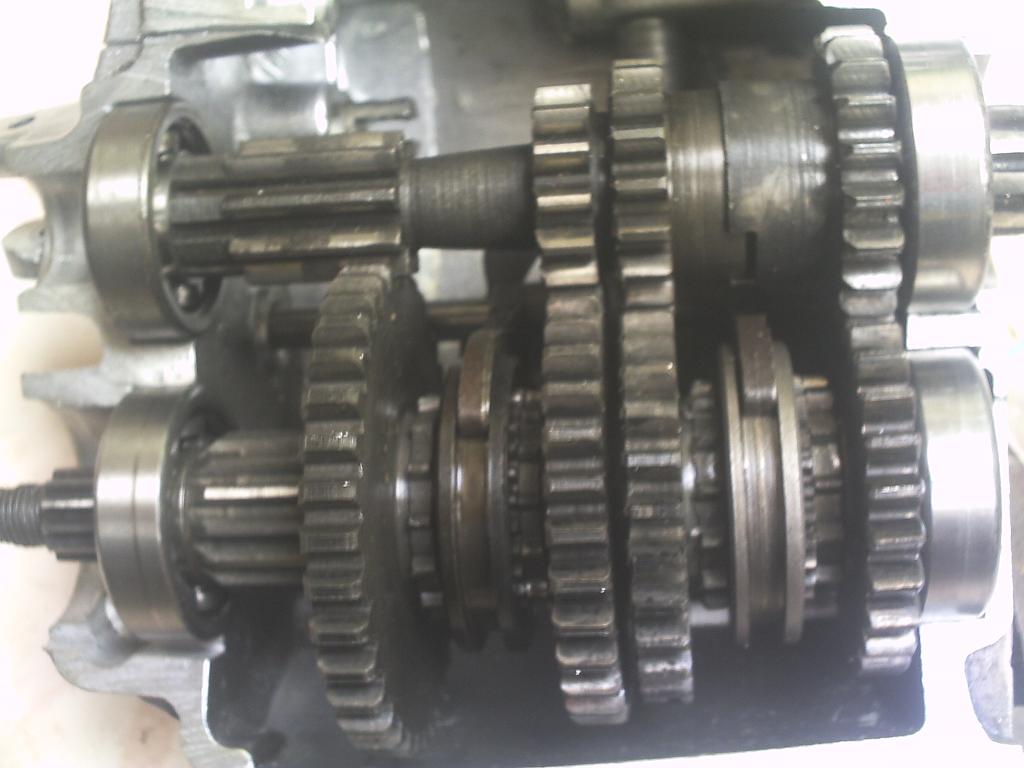

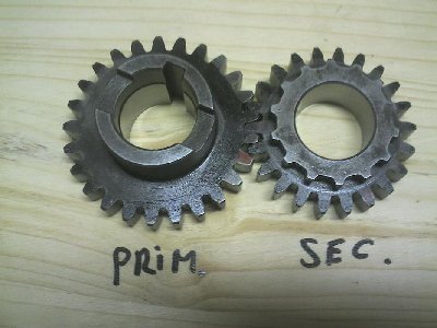

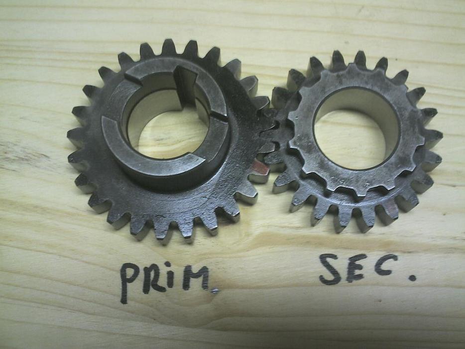

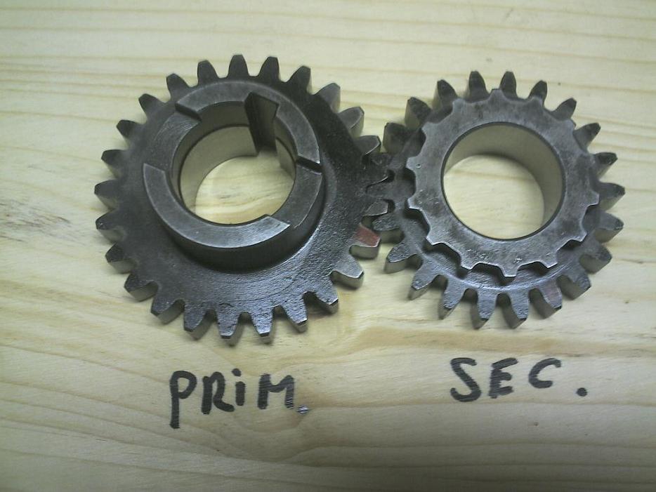

I have (some time ago) dismantle the gearbox completely and build it together with new bearings and a 1:1 4the gear.
To get it right I bought a defect gearbox and cut it in half.See pict.
So I got the distance's of the gears right when fitted in the half cut gearbox. It's russian so nothing is sure.

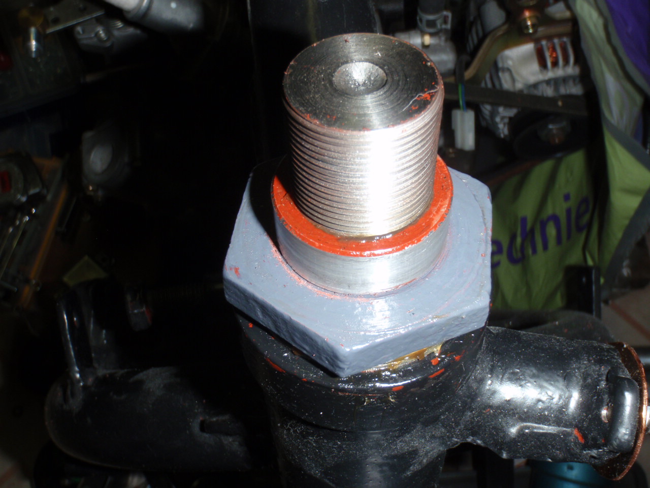

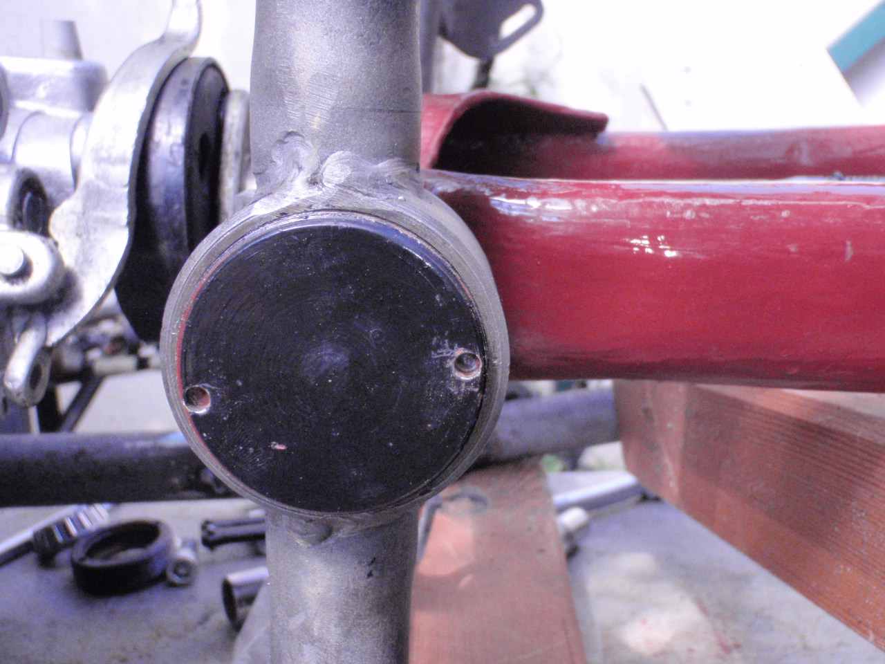

Connection frame and steer.

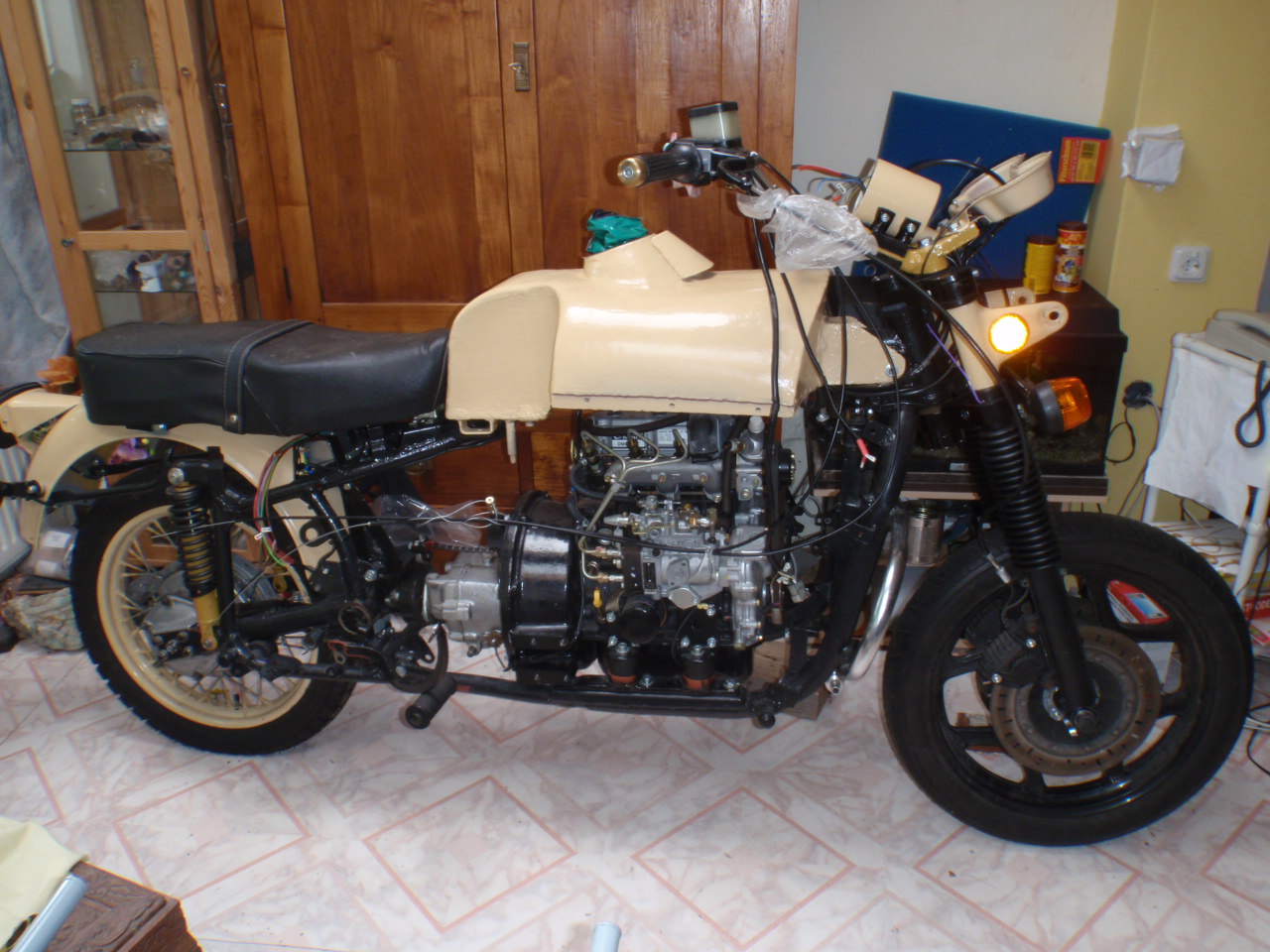

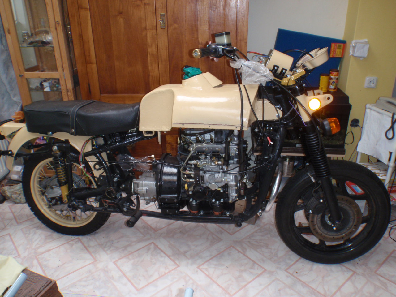

The dieselbike partly mounted together.
Those little things for finishing it right consumes costly time.

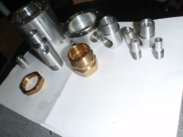

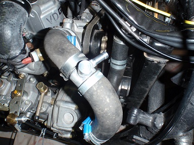

Wiring is completed.
Watercooling is in progress.
Hard to find the right rubberhoses for the cooling.
I cut the rubber hoses out the enginecompartiment of some car's , the cars wil be shredded anyway.

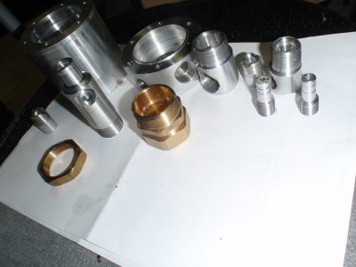

Make some aluminium couplers and connect the hoses together.
Looking for an expansionvessel.

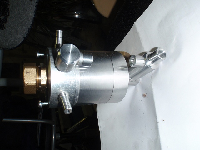

The expansionvessel for coolingwater is almost ready.
Expansion vessel? Please explain it's purpose in this build?
