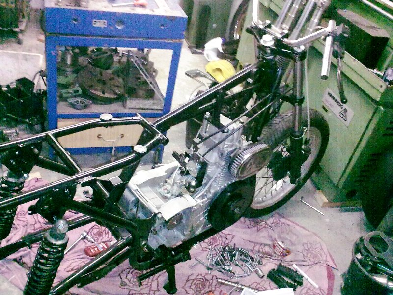

here's the frame before corund blasting/powdercoating; and after, with the new suspension parts fitted;

Re: Jawa / yanmar clone
And as the bike is being built so is Vincent's excitement!
Looks very good!!
Looks very good!!
