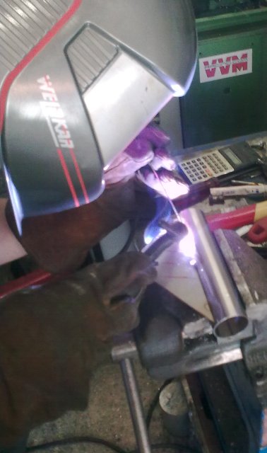

today was -as wel call them- 'headlamp ear' day.
Jeroen doing the welding;
pretty nice weld i must say.
after some more labour with four kinds of grinders & acid.
8)

Lovley bit of fabrication that ! :)
