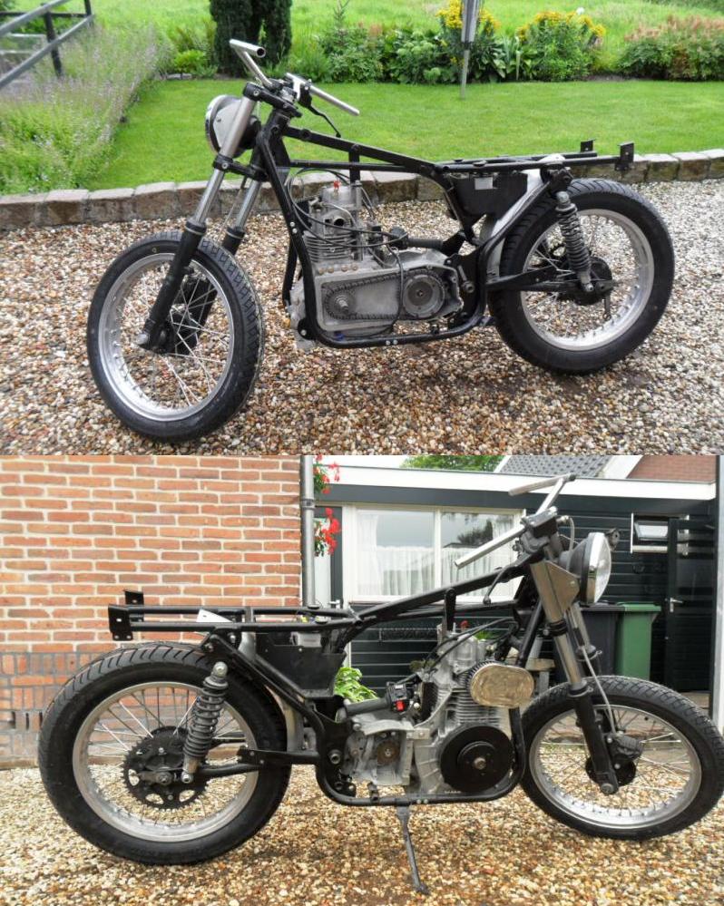

hi there, its been a while
the frame is at the powdercoater, in the meanwhile we tought lets do it even better and bought a paioli fork, brembo caliper, koni rears and akront wheels.

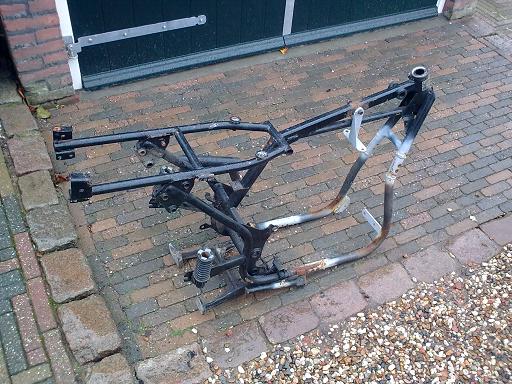

here's the frame before corund blasting/powdercoating; and after, with the new suspension parts fitted;
