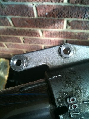

There was a loud knocking when I rode the bike which turned out to be the front mudguard clouting the tyre. Turns out the fixing screws/holes had been drilled out at some time. I had to press fit 3x M6 bushes in the end to sort it.
