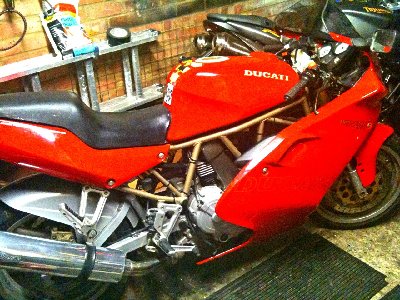

Been a bit occupied with my new toy of late so please excuse. Just need to get the fork seals done and then it's an MOT test for the road. Nice to experience the desmo engine even if it is a '97 one.

I ended up having to do the fork seals myself today after the mechanic got ill. Good thing really - saved a few quid :D
Done them both but only one side was leaking. Tube was scored a bit. I managed to polish the grooves out, just. Phew!
Homemade stand works well :D
There was a loud knocking when I rode the bike which turned out to be the front mudguard clouting the tyre. Turns out the fixing screws/holes had been drilled out at some time. I had to press fit 3x M6 bushes in the end to sort it.
