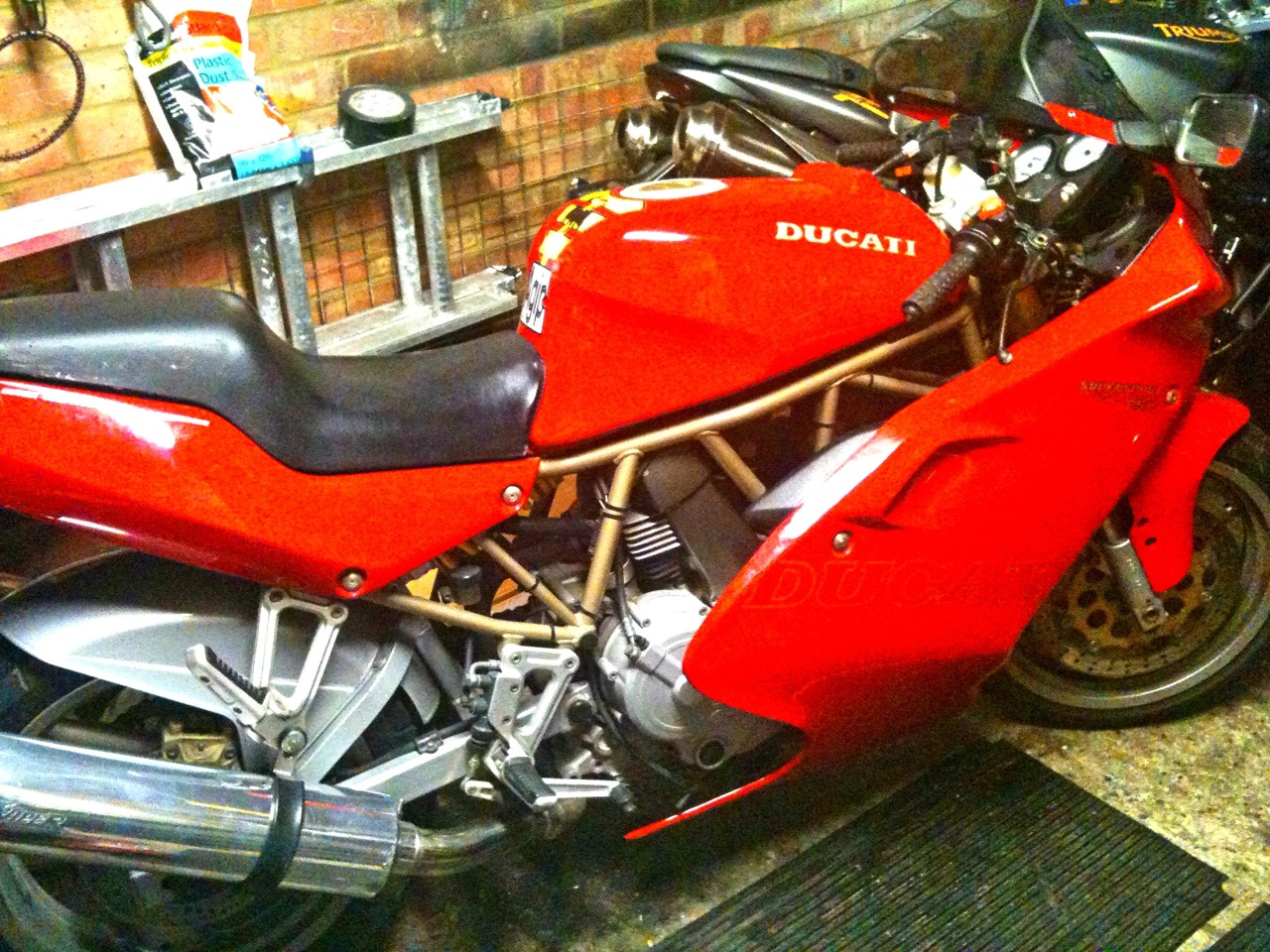

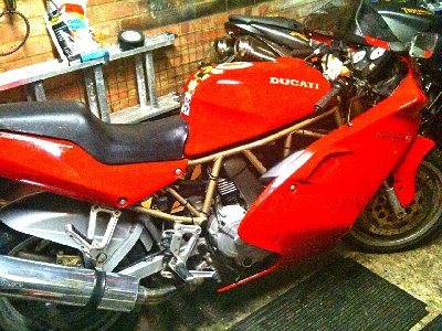

Been a bit occupied with my new toy of late so please excuse. Just need to get the fork seals done and then it's an MOT test for the road. Nice to experience the desmo engine even if it is a '97 one.
Ducati 750 SS

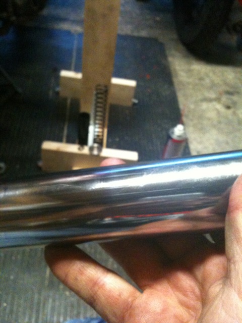

I ended up having to do the fork seals myself today after the mechanic got ill. Good thing really - saved a few quid :D

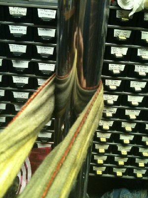

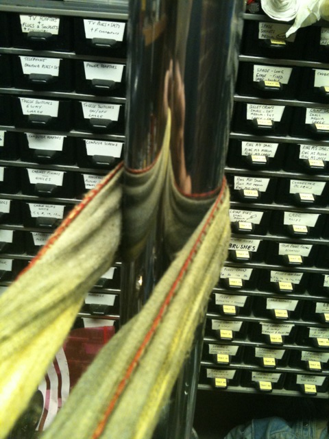

Done them both but only one side was leaking. Tube was scored a bit. I managed to polish the grooves out, just. Phew!

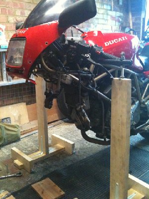

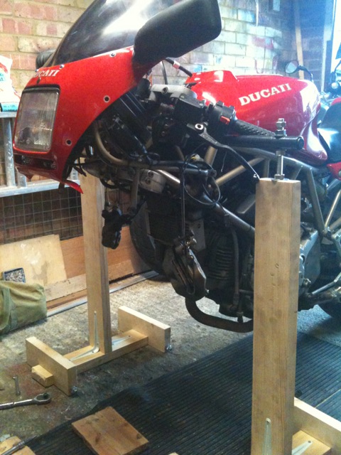

Homemade stand works well :D

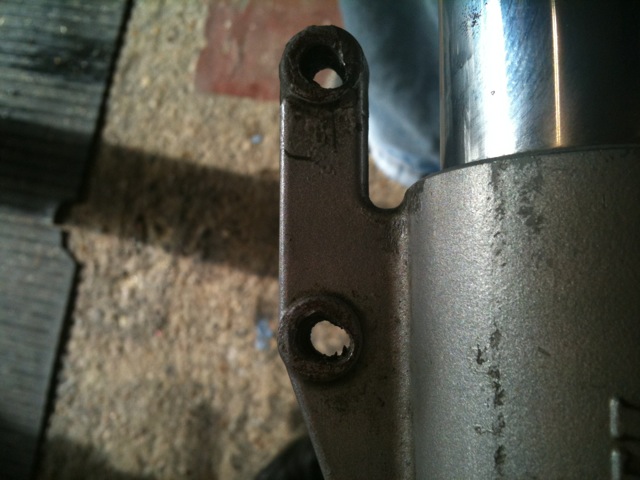

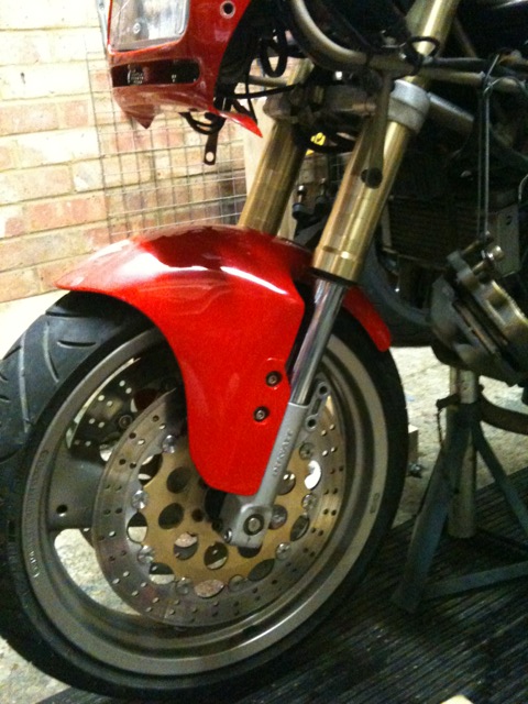

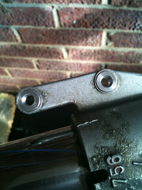

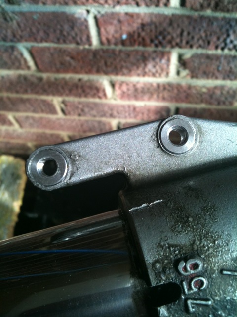

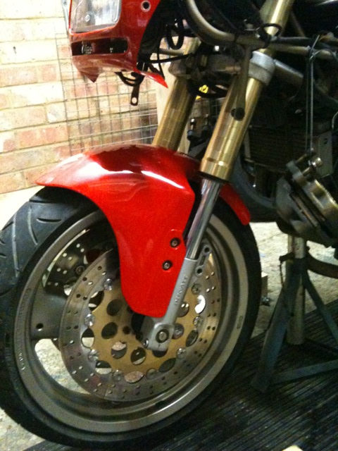

There was a loud knocking when I rode the bike which turned out to be the front mudguard clouting the tyre. Turns out the fixing screws/holes had been drilled out at some time. I had to press fit 3x M6 bushes in the end to sort it.

the forks off the bike
scoring on one tube
scoring on one tube
polishing the forks
polishing the forks
Mudguard screw threads been got at
M6 Bushes
M6 Bushes
wheel back on
wheel back on

I have a 95 Elefant and it has the same leaky forks.
I polished out one and never got around to finishing the other one. So here it sits waiting patiently.
