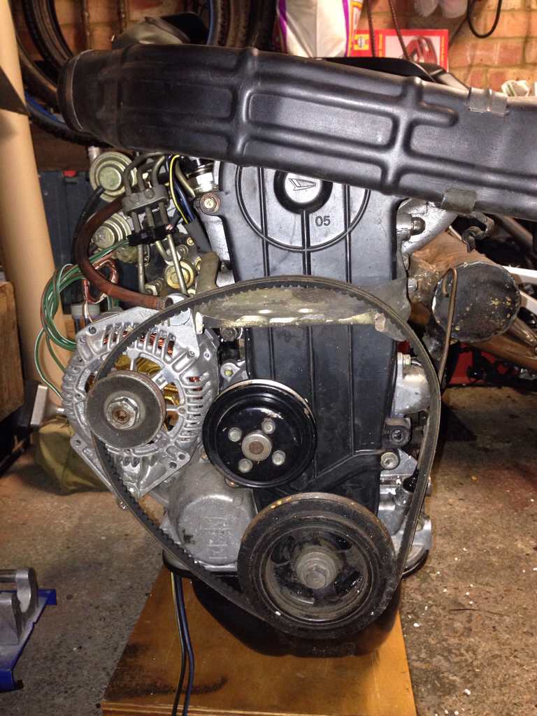

Ok, finally got the picture upload working here.

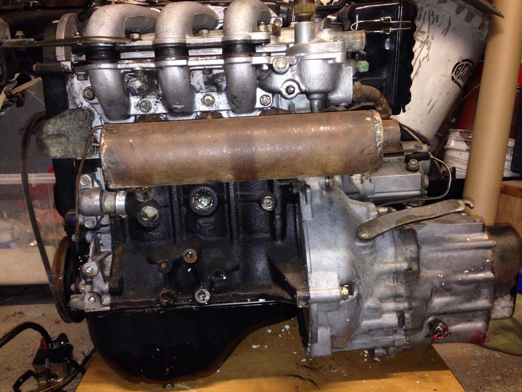

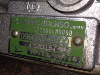

- Posts: 2234
Re: Ural-Daihatsu
Exhaust manifold seems to have a water jacket. Serial number is not quite laid out as the manual suggests. It's pretty clean with label saying belt changed at 98k km.

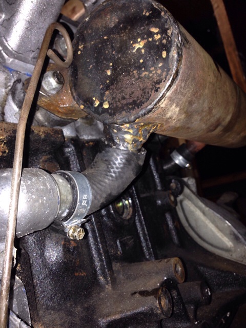

- Posts: 320
Re: Ural-Daihatsu
The exhaust manifold is a home-brew - perhaps for the boat application you mentioned. The standard one is a rather odd casting on the non-turbo engine - see Johnny Flatau's bike for an example. But perhaps you could use yours for making tea! Don't worry about the pneumatic actuators on the injector pump - you can remove them, and it will still tick over fine on a cold morning. The only one I retained changes fuel mix depending on turbo plenum pressure, which of course you don't have. Also don't worry about heater plug controller - a non-latching switch (so you don't forget and leave them on) which you push and hold, count to five, then kick (you are going to kick, right?
) will be fine.
What else - fuel solenoid is obvious and just in front of injector pump - apply 12v to switch on. You probably don't need a fan so themostat sender is prob redundant (on top of thermostat housing). The little connector on the side of same is for your temp gauge. Write when you start to worry about how to plumb the cooling system and which bits to blank off, and I'll take some pictures. Mine is fine with an (old) Mini radiator and no fan. Oh, and your alternator looks like it's already been changed for a nice small one, so oil send and return to the vac pump which sits on the back of the standard item (to run brake servo assist) must already have been dealt with...? Oil pressure sender is somewhere on LHS towards the back of the block.
Edit to add - also noticed plastic cover for inj. pump belt is missing. You'll need something to stop it eating your right trouser leg at the knee, if you go long-ways!

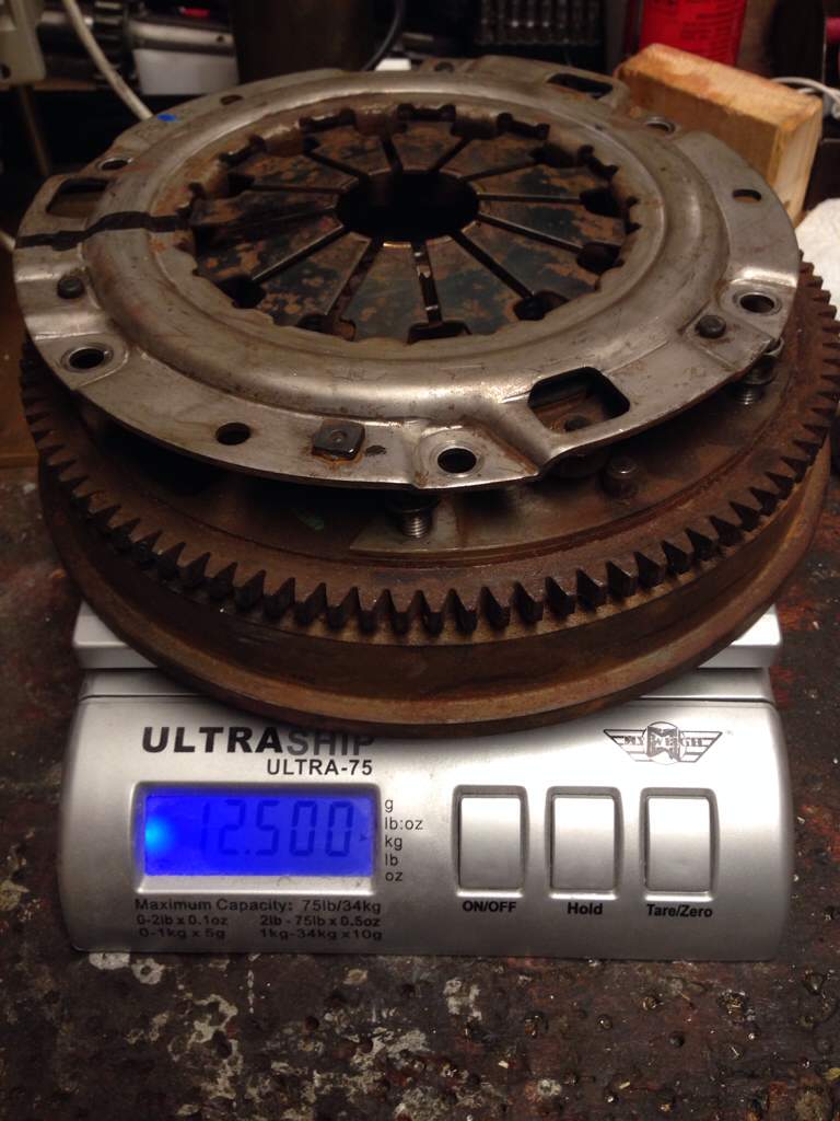

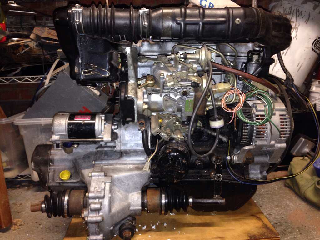

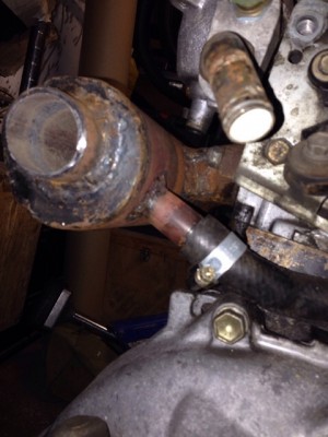

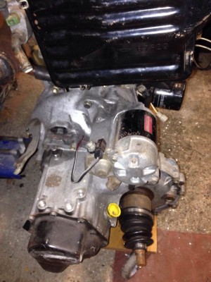

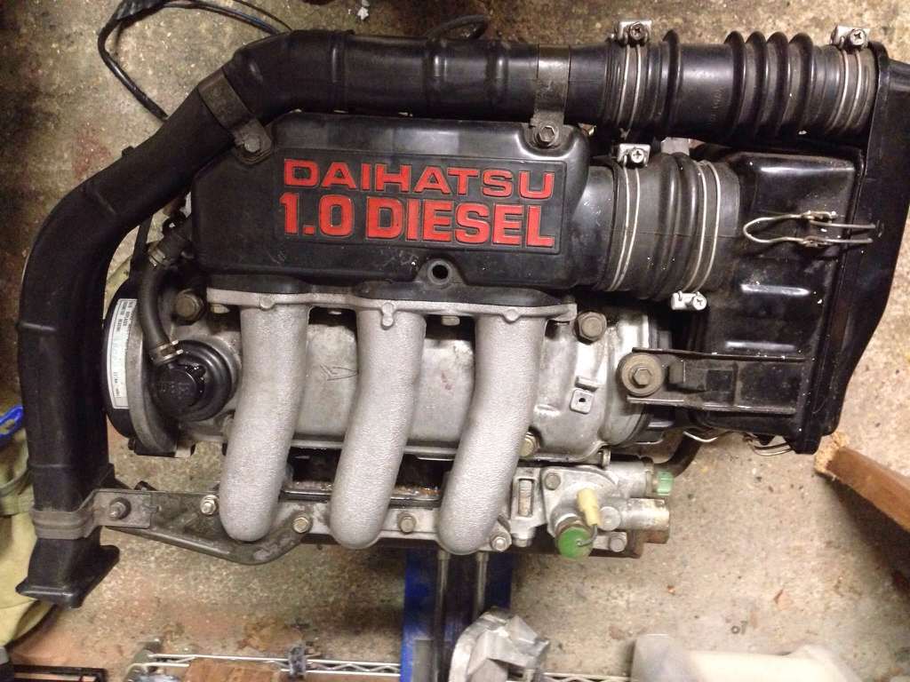

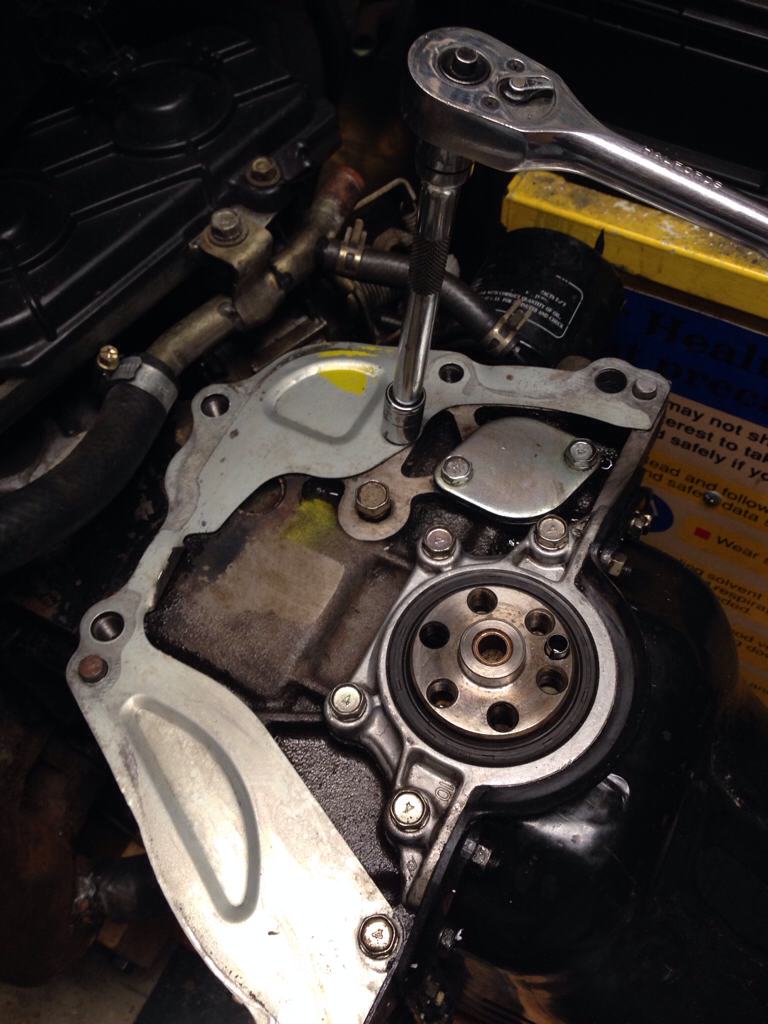

- Posts: 2234
Ural-Daihatsu
Just a few random shots going up of my Daihatsu engine. It's like new under the flywheel
- Posts: 2234
Re: Ural-Daihatsu
FYI: flywheel, clutch plate & push plate combined weigh in at 12.5 KG.
