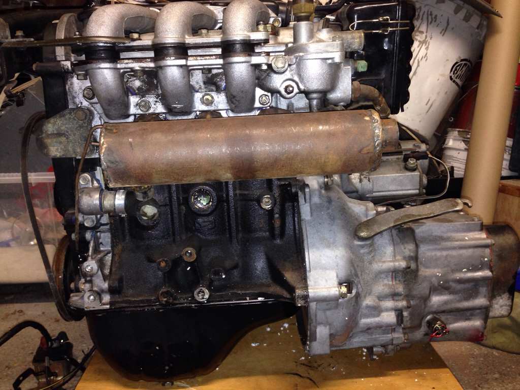

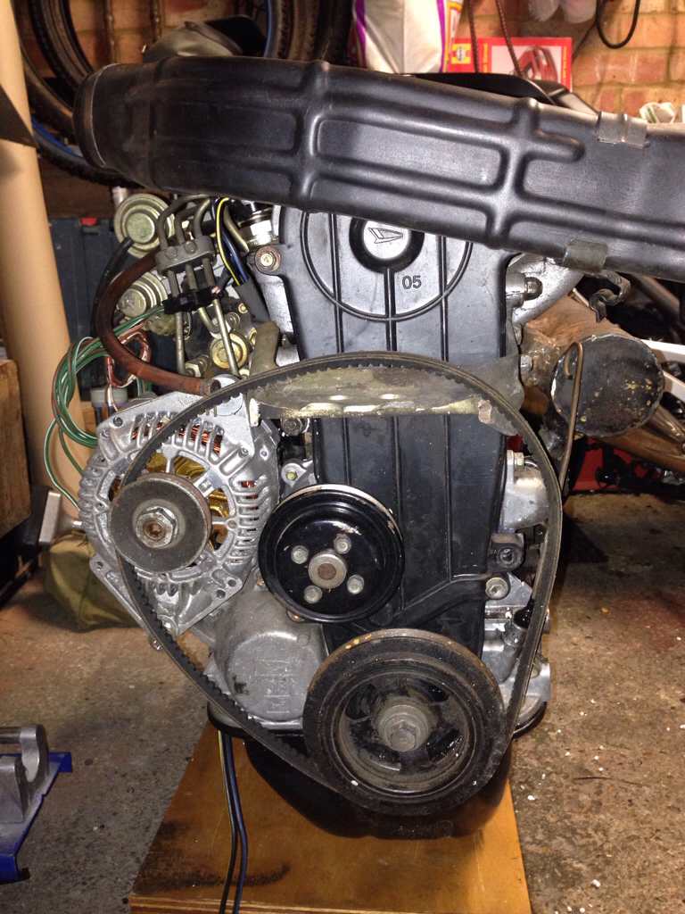

Ok, finally got the picture upload working here.

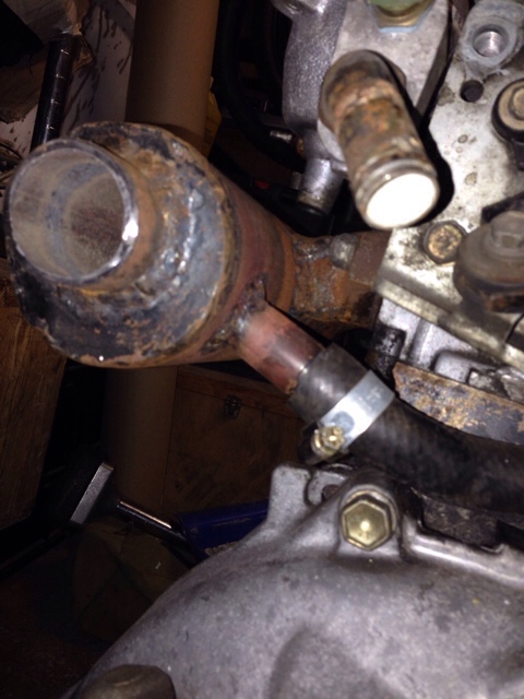

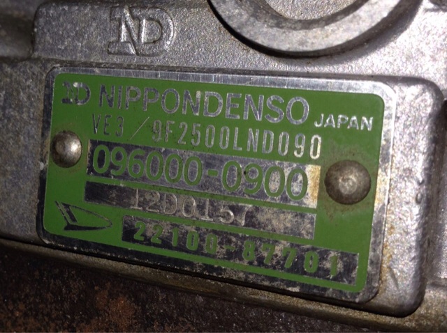

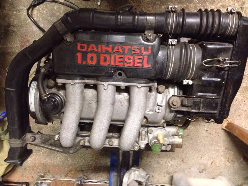

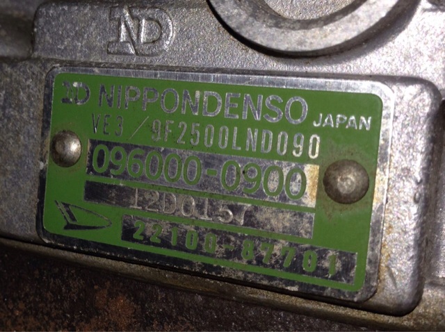

Exhaust manifold seems to have a water jacket. Serial number is not quite laid out as the manual suggests. It's pretty clean with label saying belt changed at 98k km.

The exhaust manifold is a home-brew - perhaps for the boat application you mentioned. The standard one is a rather odd casting on the non-turbo engine - see Johnny Flatau's bike for an example. But perhaps you could use yours for making tea! Don't worry about the pneumatic actuators on the injector pump - you can remove them, and it will still tick over fine on a cold morning. The only one I retained changes fuel mix depending on turbo plenum pressure, which of course you don't have. Also don't worry about heater plug controller - a non-latching switch (so you don't forget and leave them on) which you push and hold, count to five, then kick (you are going to kick, right?
) will be fine.
What else - fuel solenoid is obvious and just in front of injector pump - apply 12v to switch on. You probably don't need a fan so themostat sender is prob redundant (on top of thermostat housing). The little connector on the side of same is for your temp gauge. Write when you start to worry about how to plumb the cooling system and which bits to blank off, and I'll take some pictures. Mine is fine with an (old) Mini radiator and no fan. Oh, and your alternator looks like it's already been changed for a nice small one, so oil send and return to the vac pump which sits on the back of the standard item (to run brake servo assist) must already have been dealt with...? Oil pressure sender is somewhere on LHS towards the back of the block.
Edit to add - also noticed plastic cover for inj. pump belt is missing. You'll need something to stop it eating your right trouser leg at the knee, if you go long-ways!

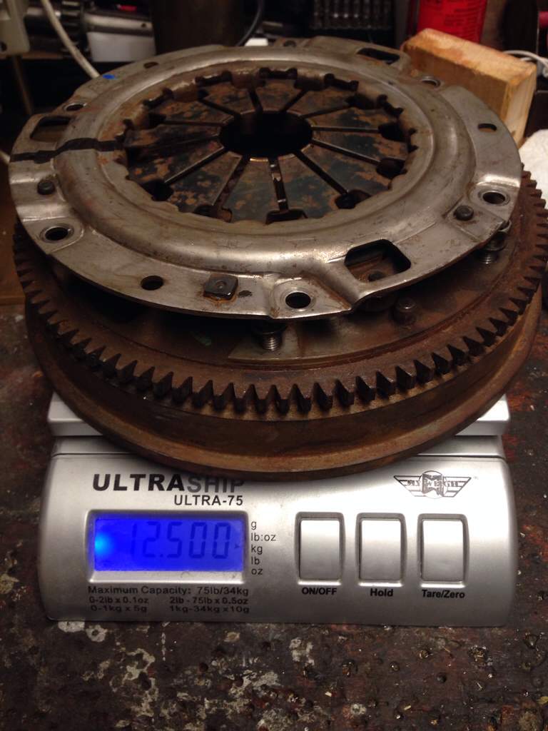

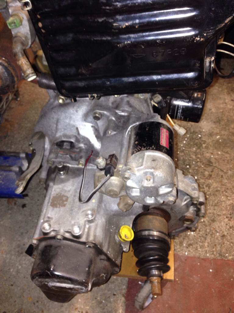

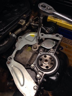

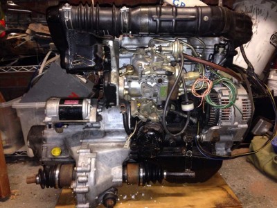

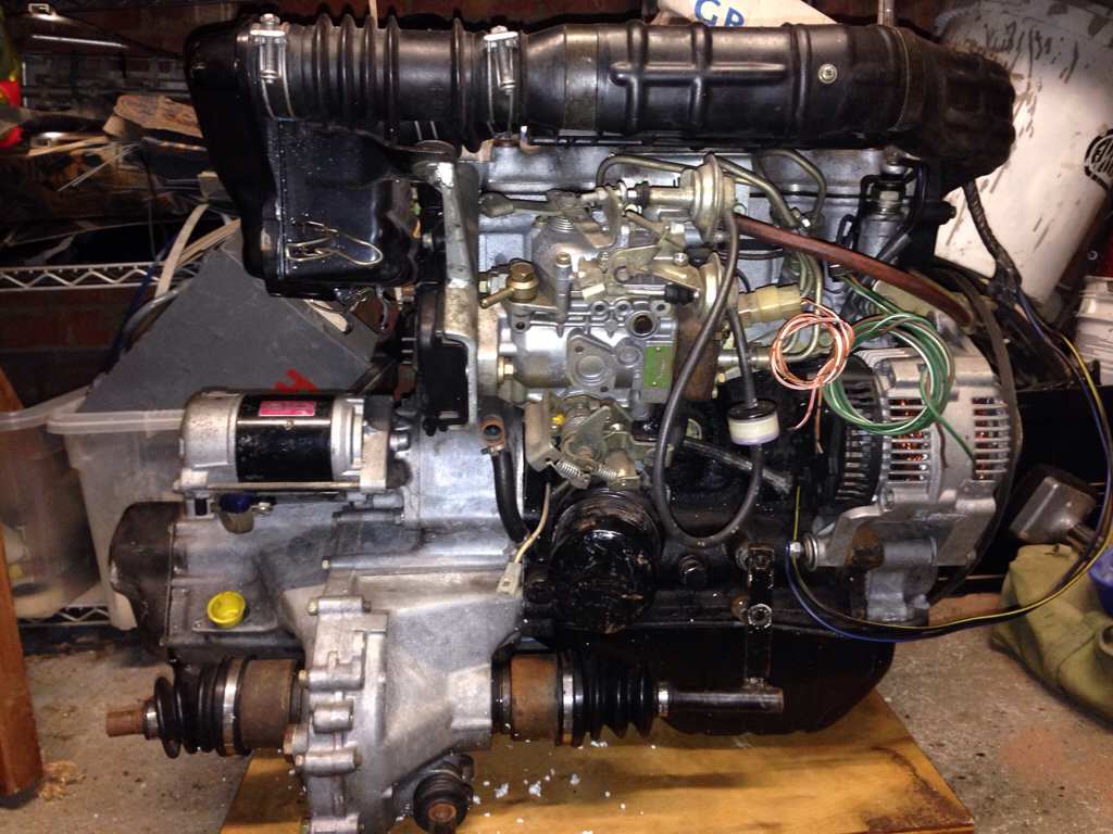

Just a few random shots going up of my Daihatsu engine. It's like new under the flywheel
Re: Ural-Daihatsu
FYI: flywheel, clutch plate & push plate combined weigh in at 12.5 KG.

I can certainly post a few shots of the engines areas you are interested in seeing. I've not looked at that side of things yet - I've started making the wooden template for the BMW gearbox just now.
Starter motor positioning is something I'd like to make different from other bikes I've seen. If I can get a more modern, smaller motor to fit then I will use that.

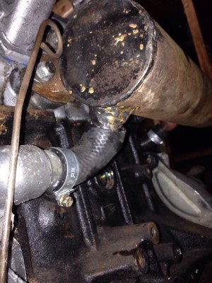

Well, head problems with my existing engine have grown to it blowing rusty water all over my left leg all the time, from the expansion bottle - so mystery spare engine has to go in, before I attempt head-off etc etc. I answered my own question upthread about mystery attachment low-down on injector pump, on this (later) engine compared to my original. Here: http://www.youtube.com/watch?v=oj8ElcsSNkA a Hungarian guy commented on elsewhere on this site, shows a bike with the same engine. Despite not understanding Hungarian, the knob connected to that mystery attachment is very helpfully labelled with a 'choke' symbol (!) - so there we go. Existing engine seems to do without this very well, even with my kickstart-only installation, but we'll see about this one - if it even runs!
