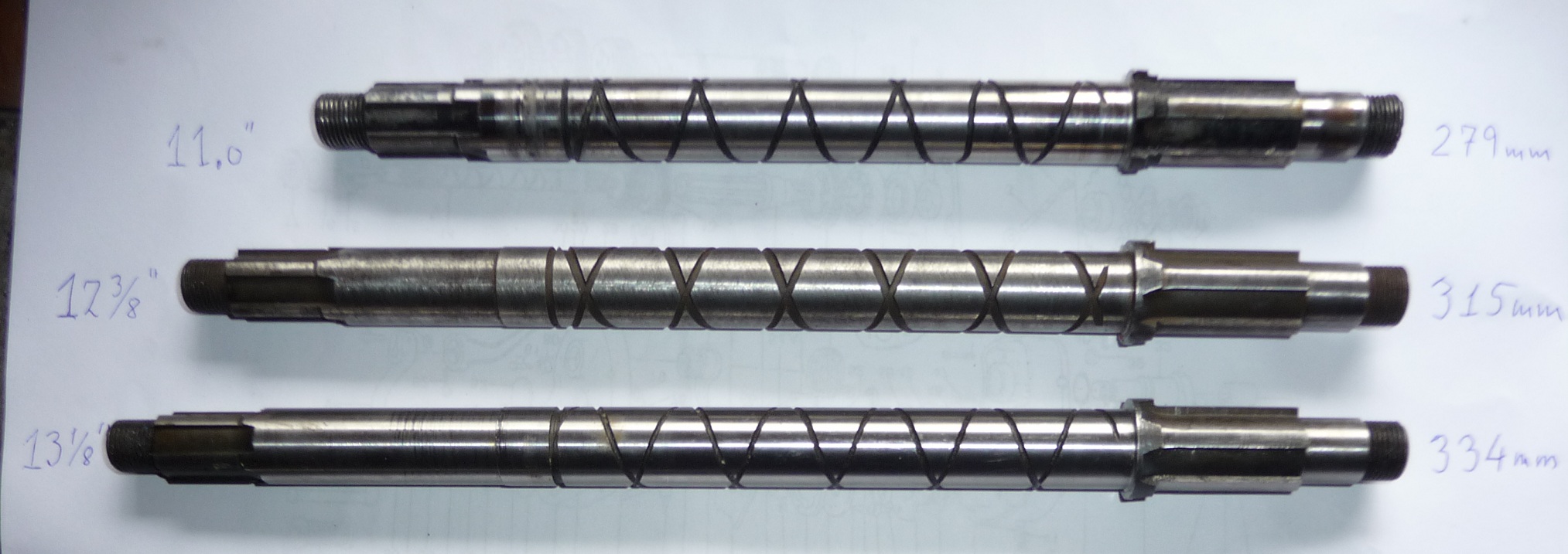

Re: Which longer mainshaft is better for R.E.??
Hi,
Yes, my experience is to keep the mainshaft as short as possible, keeping the engine balance ( in the frame ) in mind.
Standard Enfield mainshaft length is 11" or 279mm.
The one from henry price is as far as I know the longer version standard+55 mm, the one from Sommer is standard+40 mm, the original Taurus mainshaft is standard+36mm. Regards, Erik
Hi Stuart,Stuart wrote:I have extra support at one end in the shape of bearings.
How is the extra support made ? I am planning a housing for a needle bearing with innerring to mount in the original Taurus inner primary chaincase
regards, Erik
I have a standard length shaft which fits into an elongated rear on the clutch. It's the rear of the clutch that rests in 2 bearings.
Oh yes, I see it that way. The clutch with the rear bearing is kept solid in a fixed place. Probably needed to cope with the Ruggerini torque,
regards, Erik
Does anyone have a drawing with the measurements of the gearbox shaft? Since the lenthened ones seem to wobble, i am looking for a way to let it made at one piece.. at a fairer rate as the Sommer bloke offers..
And indeed which length is the best for an yanclone suited in the middle?
i think it would be best if the inner primary is bolted directly on the engine..?
