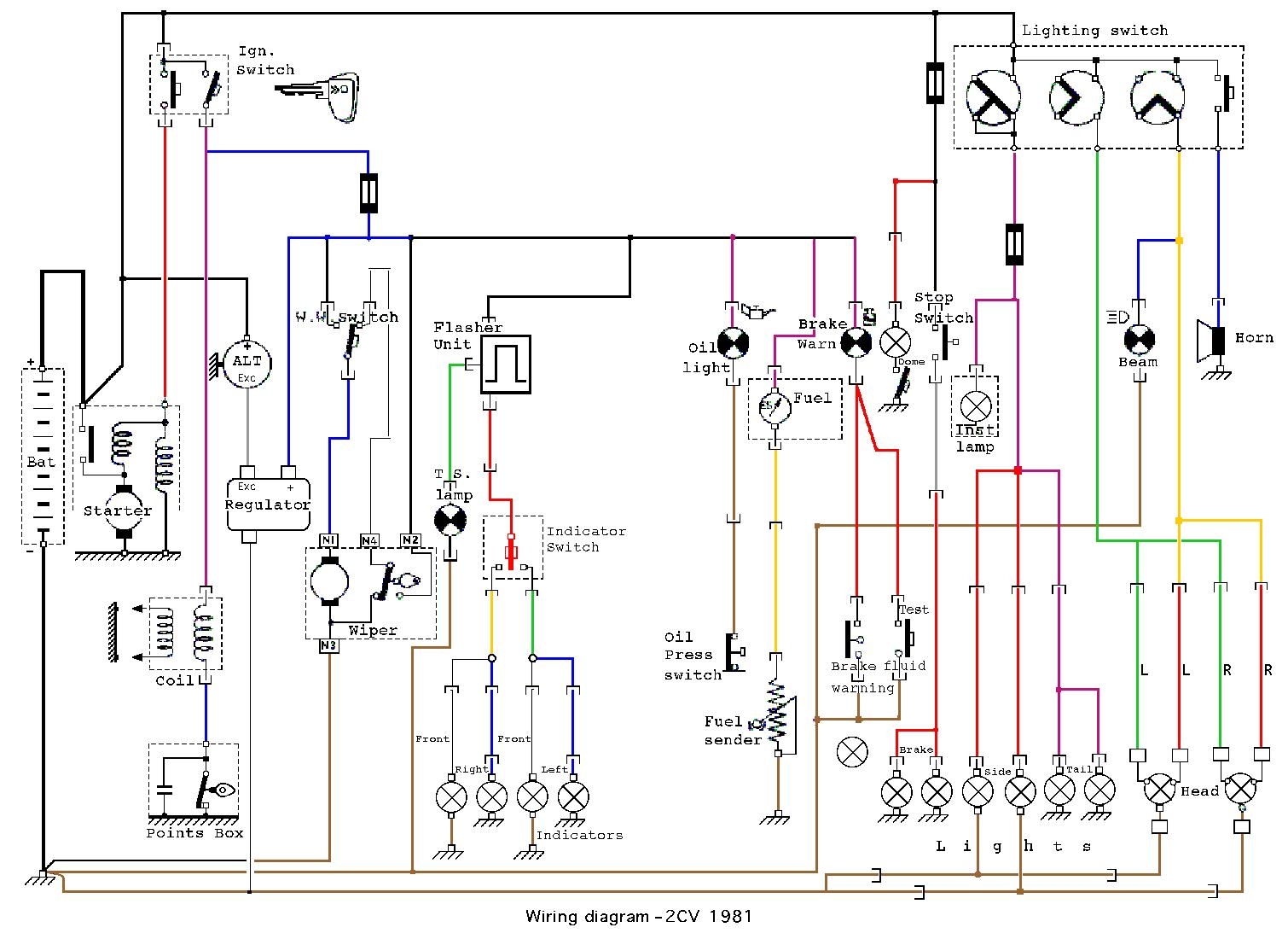

The electrics are simple and, as my bike is cvt and electric start with no pull starter, it was important that I knew my battery was charging, so, I bought the gammatronix led indicator. It is usually on orange after starting and switches to green virtually straight away confirming the battery is charging and up to voltage. It's more than just an led as it has a small circuit attached and by removing a small jumper link it can show different levels of battery voltage by colour/blinking. I've left the jumper on so it's green for good,orange bad.
I can attach a simple 2cv wiring diagram if you want it.
