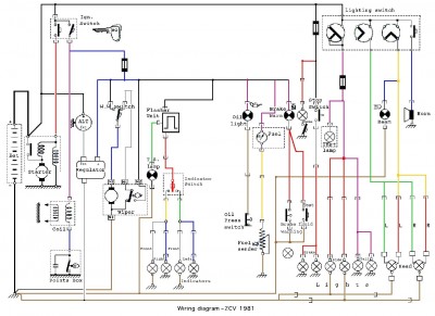

Here is the 2cv wiring diagram.
It's very simple. If you already have an inbuilt alternator cut/isolate or remove the wiring and make safe. No need to remove the alternator. You can if you wish BUT if left on the wiring has to be made SAFE.
We are now only talking about the 2cv alternator/regulator.
From the ignition switch or fuse box take a live feed (when ign. is switched on) through a fuse to + on the regulator.
Run an earth to the - on the regulator.
Connect "exc" on the alternator to "exc" on the regulator.
Run a lead from + on the alternator to the positive side of the battery and that's it!!!
The alternator is earthed through the mountings.
If you think you have "blown" the alternator or your used one doesn't appear to work it has a built in "printed circuit" type fuse bolted in.
Some 15amp fuse wire will be ok to test it but they are available from ebay or 2cv specialists. (not your local parts place)
Note the 2cv does not have an ignition light hence my fitting of a gammatronix.

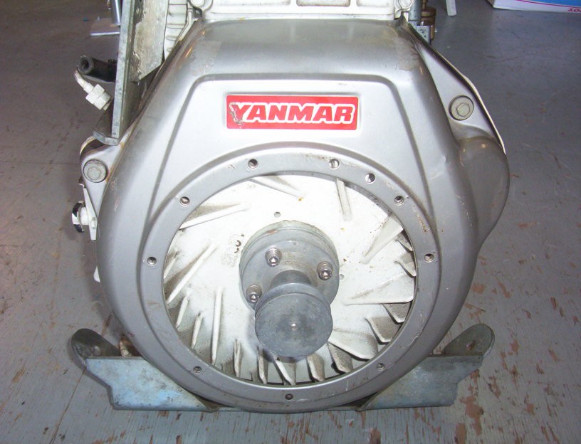

The Yanmar L100 pic below suggests that a flywheel drive adapter might be available from Yanmar. Just another option to consider given that you're not utilizing a pull start. Of course from Yanmar it would cost a bit.
