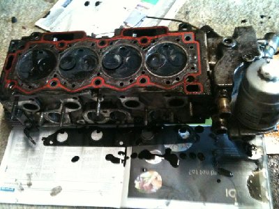

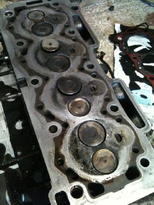

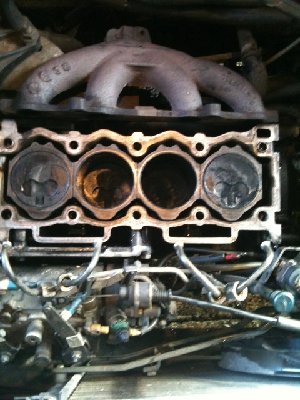

Well no sooner have I got my Ducati on the road than the car starts playing up. I had to take the head off last week as the head gasket was showing serious signs of being on the way out. The water system was being overly pressurised and shooting steam out from under the bonnet/hood. 9-10 hours and £55 later and it's all sorted.
engine
engine
head off
head off
cleaning the head
cleaning the head

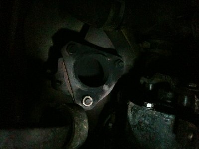

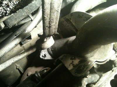

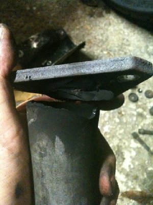

And then, after getting the new Duke Battery topped up with acid at a bike shop, the car exhaust downpipe decided to crack off on me :cry: Lost a securing bolt from underneath and it broke right up by the manifold weld. Put a new one on today which was easy enough but getting the bloody heat shield in there wasn't easy. I suspect the pipe was not exactly to original spec. All good fun though :D
All fixed. You can see one of the 3 nuts. And the shield!

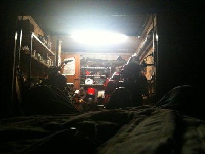

Took it off at night in the rain and cold.
The cracked off bit
The cracked off bit

I am glad to see that the arrangement of valves in the head is more sensible than on the old BMC B series engines. Having two inlets together give much better central cooling than having two exhaust valves sharing the same port.

What is your car? (apart from one with an IDI diesel by the look of the head :p)
