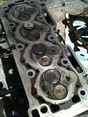

Well no sooner have I got my Ducati on the road than the car starts playing up. I had to take the head off last week as the head gasket was showing serious signs of being on the way out. The water system was being overly pressurised and shooting steam out from under the bonnet/hood. 9-10 hours and £55 later and it's all sorted.

I am glad to see that the arrangement of valves in the head is more sensible than on the old BMC B series engines. Having two inlets together give much better central cooling than having two exhaust valves sharing the same port.

What is your car? (apart from one with an IDI diesel by the look of the head :p)
Re: Car trouble
It's a Pugeot 106 1360cc. I've just replaced the radiator last week as well. Going wel now.
The problem has always been that my journey to work ends just as the thermostat is about the open. Engine is left steaming hot presurising the (relatively new) expansion cap and simulating head gasket failure. Perfectly good on a long run though as we took it to London last week.

How long is your commute? I've recently had to replace the clutch and belts on my 2.0HDi. If it weren't for a big piece of corrugated cardboard the radiator would be on that list as well; it only is minorly dented atm
Re: Car trouble
Apparently I have to drill a 2mm hole in my thermostat so the engine takes a little longer to warm up. Common problem it would seem. Bad design methinks.

Drilled it and yes, it's about 85% better I'd say. Very slight hiss from the expansion tank but no boiling water steaming out anymore. Perhaps I should have drilled it 3mm? Heater takes a touch longer to warm obviously but on a 20min journey the top of the front rad is now hot. Cool
From the Honest John website.....
"The TUD3 is prone to head gasket failure, due to small radiators, weak water pumps and a design of cooling system which restricts coolant circulation until the thermostat opens to the point at which localised overheating occurs, and eventually blown HG. I suggest you check the condition of the radiator, and fit a new one if it is at all deteriorated, and also modify the thermostat by drilling a 2mm hole in its flange, which will permit some circulation with closed thermostat, and considerably improve reliability. It will also make the system easier to bleed (which must be done with an extension, such as inverted 2 litre pop bottle with the bottom cut off wedged into the radiator filler, with engine run until thermostat opens)."
