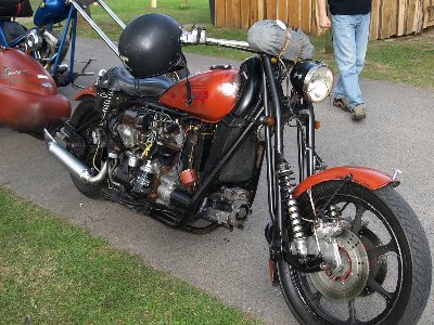

big vw engine would make a nice lump for a bike. There was an impressive one at Hamm this year, I have a pic somewhere I'll have to dig out. The engine was turned backwards and used the car transmission with shaft drive. The frame was particularly impressive for how the engine was squeezed into it.

Re: final drive
I suspect this may be the VW 1.6 being referenced that was in attendance at Hamm. If not mistaken, it hails from Holland. And there are numerous other pics of it here on Dieselbike.net from it's many appearances at Hamm.

Yes thats the one, looks like you beat me to it. Here is my pic. I was impressed by how the frame perfectly encloses everything, in particular the starter motor is very close to the downtube. I think it would be a big job to take the engine out of there if it needed anything done. Brilliant job though, shows what can be done.

Re: final drive
Annoying that I can't read the URL on the fender

tiz a nice machine that,see what you meen with the starter motor though.

The url is to the german diesel bike site dieselkrad.info.
