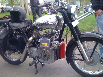

Interesting piece of work here. Unfortunately there was little text attached, but I have the translated version of it below. I do wonder whether the use of an Audi turbo suggest that it was too big to produce sufficient boost. The absence of a plenum/accumulator would also seem to problematic for a single. He clearly went to some effort to be certain the turbo was supplied with adequate oil.
Here's the text.
Royal Enfield with its own built turbo feed from Audi car. . Turbo gave around 1 / 2 kg pressure, but according to owner went Enfield better without the turbo. The red brannslukningsaparatet acted as extra oil system.
Here's the text.

For those who don´t understand: brannslukningsaparatet = fire extinguisher
that should do it

So the belt drive is to a seperate oil pump and the fire extinguisher is it's additional oil tank - ingenious.
Turbo's huge for a little 400cc single.
Sam the usual change for adding a turbo is to increase the break pressures in the injectors by about 10% - more than this is usually tricky getting a jerk pump to operate - you can pressurise in bound fuel supply with a higher pressure pump rather that gravity feed and this will help too.
Injector part numbers for the Lombardini LDW series are the same for Turbo and non-turbo models and only 130-145 bar pressure.

Now that is interesting....
It looks like a fuel pressure balancer so that when intake boost is present then injection pressure rises also.
Very cool, keeps costs & wear down by keepin injection pressures reasonable and only rise when needed and balanced against additional combustion chamber air pressure.

That is an overfuelling device , more turbo pressure , more fuelmark_in_manchester wrote:Comparing Daihatsu Charade Turbo (which I have) vs non-turbo (which I've seen / have a manual), the injector pump for turbo version has a diaphragm actuator on top which is supplied with intake plenum pressure. I don't know whether this is used to vary timing, or something else - I'd be interested if anyone knows.

I'm with Nanko. Same thing on the early vw TDI's with mechanical axial distributer pump injection (no ECU). Increases fuelling by increasing injection duration and possibly advance too (not sure). Extra fuel compensates for the extra air. The Bosch ones on the VW's were dead easy to play with too so you could wind up the fuel for smoke and power. Alas we need computers and expensive software to do the same thing on modern engines.

If you have excess fuel, as seen by smoke, you can add a small turbo and with more air it will not smoke as much when you get into boost. VW added a turbo to their 1.6 normal asperated IDI and called it the Eco-diesel(the old 80's VW's were not TDI, IDI had prechambers) It had the same pump as the normal asperated 1.6 without boost enrichment, but they put a turbo on it to cut down on smoke and be a bit more eco-friendly.
The question I'm wondering is if the little yanclone could stand the extra cylinder presures and not break...??? without more fuel or proper sized little turbo, you might not make too much boost.

what are we looking at in your picture? Not sure what it is that sneezed side of it's nostral out. Looks like a small tranny in the grass orrr??pietenpol2002 wrote:In the interest of simplicity I would be considering a supercharger..... I figured I'd just wrap my legs with flak vests in anticipation of the big sneeze.
