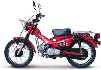

Just been trying to find any info on what Aussie Postie's use and found this line on a forum elsewhere:
"Ex postie bikes (Australia Post) CT110 (the biggest selling motorcycel in Australia).." And a shot..
Not sure where the 400cc come from? Maybe Kev could be more specific about what bike he's seen in use
