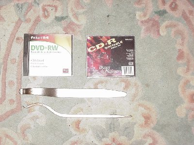

Looking at all the little tyre levers available i decide to treat myself to these.
They will go well with the 24 and 30 mm spanners needed to change rear wheel. Not sure where to fit the trolley jack though Larry
