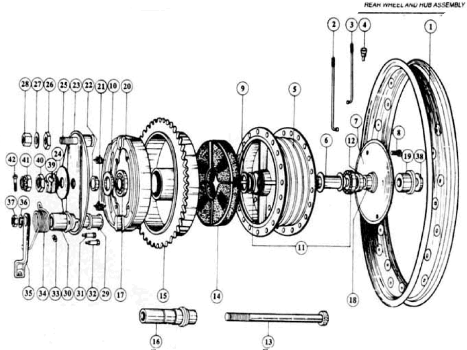

I am looking for detailed pics of a QD wheel, to see if and where I went wrong. My Bullet is a '92 model.
The front wheel is pretty much finished except for a slight drag somewhere in the revolution, but the rear wheel has not been assembled to my satisfaction. I have a QD wheel, but one part of the axle assembly does not match the drawing I have. I'm also left with a flanged ring (spacer?) that fits inside a big ring, but can not be mounted anywhere in combination with that ring.

Do you have the speedo drive coming off the rear wheel?
I'll assume that you don't.
The first thing to check is that the carrier bearing is properly positioned and the hollow stub axle can spin easily without binding.
Next focus on the wheel itself, It's not unknown for the spacer to be the wrong length between the bearings and when you tighten the axle it puts pressure on the bearings and causes binding and premature failure. Make sure that the spacer seats between the inner races before they bottom out in the hub.
I have found ne example where the stub axle had spacers inserted to maintain clearance or the drum would bind.
Cheers
Cheers

My speedo is front wheel driven. The hollow axle cannot spin freely and seems to be wedged between the two bearings. I suppose this means I need to by new bearings again, because removing the bearings is not possible without applying a fair amount of force.
What is the "carrier bearing" ?

Sphere, hope this helps. taken from the parts book
Click on it for full size picture. ( better yet copy it and rotate it)

Hey Larry, thanks for the pic! It looks still different from my wheel, and the pics I have. One is from the Snidal manual, another is a harcopy of a derived version of the Snidal (possibly others) manual with a different pic. My rear hub has a flanged portrusion through the dustcover on the righthand side. All the pics I see encourage you to put stuff on either side of the dustcover but that's not possible with my hub.

Any with detailed pics of a QD wheel?

the one I posted is a qd rear wheel, although fairly modern ( 2005)Sphere wrote:Any with detailed pics of a QD wheel?

The flanged ring is probably similar to (3) in oldbmw's image, and is intended to provide clearance between the spacer and the grease seal. Otherwise the distance piece will crush when the nut on the other end is tightened.
Mystery solved, thanks for the help Pics of the finished product (wheels) are below.
