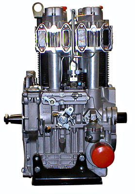

The 1120cc 9LD561 Lombardinin I picked up the other day weighs 120kg and the Hatz 2G30 912cc weighs in at 84 KG. I guess that mean I will have to use the Hatz because the Lombardini is just too much extra weight for not enough extra power.
The KZ550 engine that was in the bike weights in at 70.5 KG with the transmission and makes 54 hp. I have to put that out of my mind though, or I'll never build a diesel motorcycle!!!
2cyl Lombardini, Hatz, and KZ550 weights
