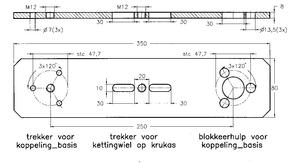

Re: Remove clutch housing
Created by Hans Taverne, taken from http://www.drive.to/recn
What is the bolt size for the 2 sprocket holes, 1/4"?
