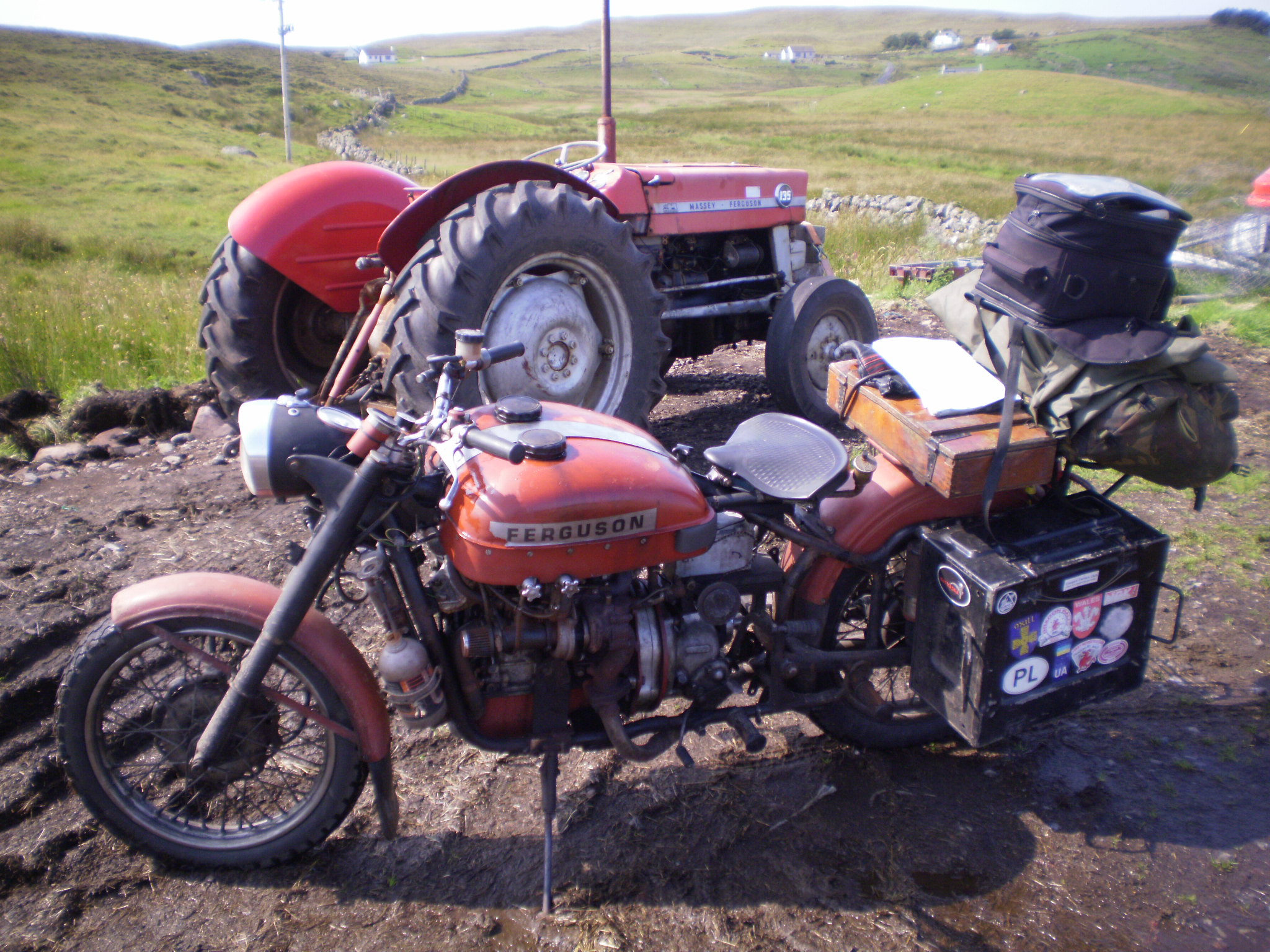

I took 5 days over it - Manc-Mallaig was a long-ish shot and on the way back I did Iona-Manc in one go (well, with a couple of ferries), most of it in heavy rain. It was...damp! I ended up with no front brake, but apart from that nothing more unusual than the normal not-quite-right cooling situation and slight water useage. One day I'll take the head off... Here's a couple of pics, 1400 miles in all which is a long way for me. You sound a bit pissed off with your kubota option - is the increase in power not worth it? Womble who just showed up on here is my mate, and is planning to build a Z482-superdream - I keep suggesting he buys an enfield and follows closely in your footsteps! And another friend near here, Adam the Pole, has a Z482-V50 which has been all over the place, but like me no chains (primary or otherwise) to deal with. Does make gearing it correctly, expensive though.
