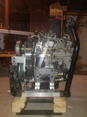

Fully slid forward
Exhaust side mount past vertical tube. 2 1/8" clearance at top of cap to tube, 1 7/8" clearance at middle of cap to tube where filter is the widest. My filter is 3" diameter.-
- Posts: 93
- Joined: Tue Jul 02, 2013 4:38 am
- Location: Mansfield, Ontario
Re: CX500 Kubota
Much better access to transmission.
For anyone with oil filter fitment issues definitely try the method pietenpol2002 mentioned first, much cheaper and would function just as well. For me it was no bueno.-

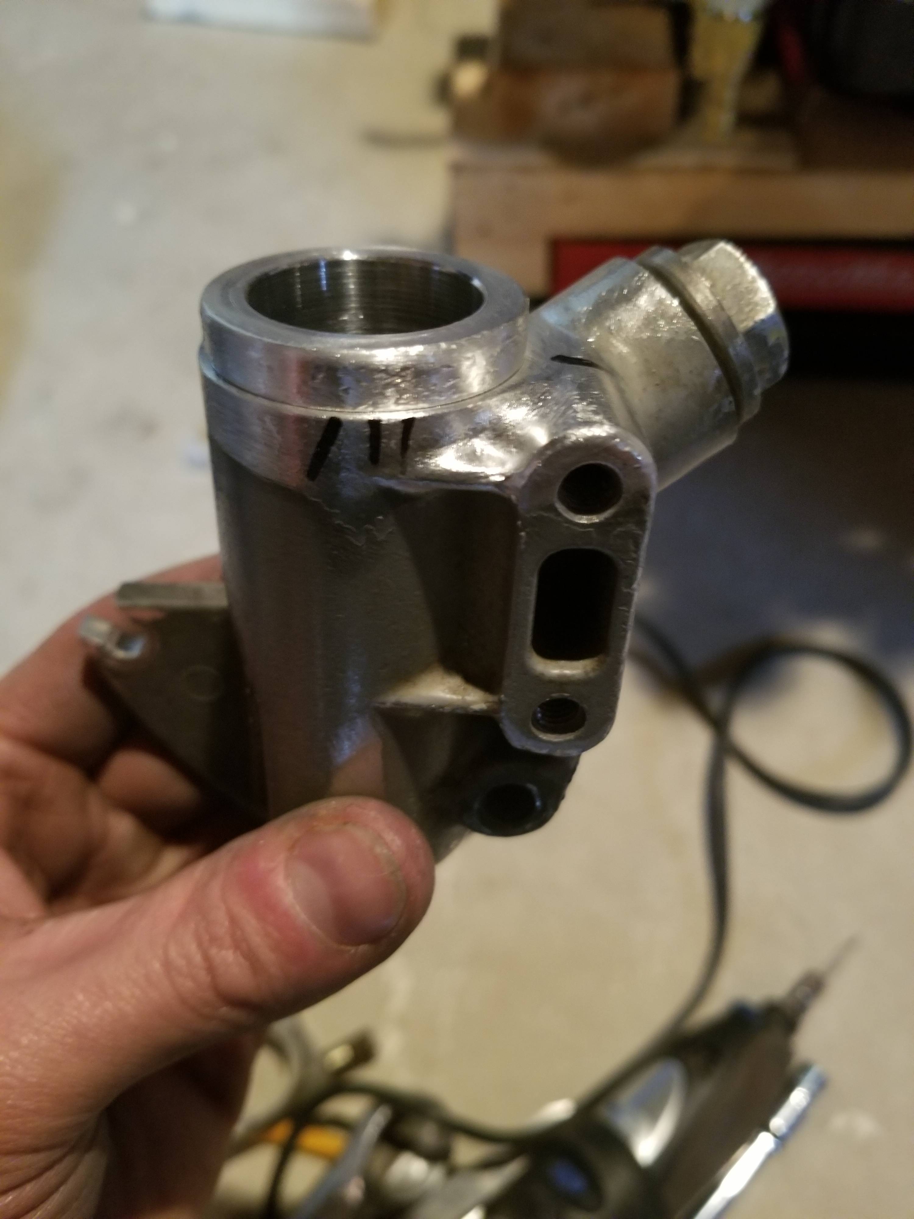

Re: CX500 Kubota
Some may have noticed the thermostat housing cut off. This is because it did not fit under mt frame. I have had to shorten the coolant exit port by removing the thermostat housing from that spot and reconnecting the 90 degree elbow lower down. It will be welded together and I will use an inline thermostat.
Shortened housing with adapter ring for the modified elbow Modified elbow with mount holes removed. Together back on the bike.Just clears the bottom of the black frame plate for sliding engine forward.
