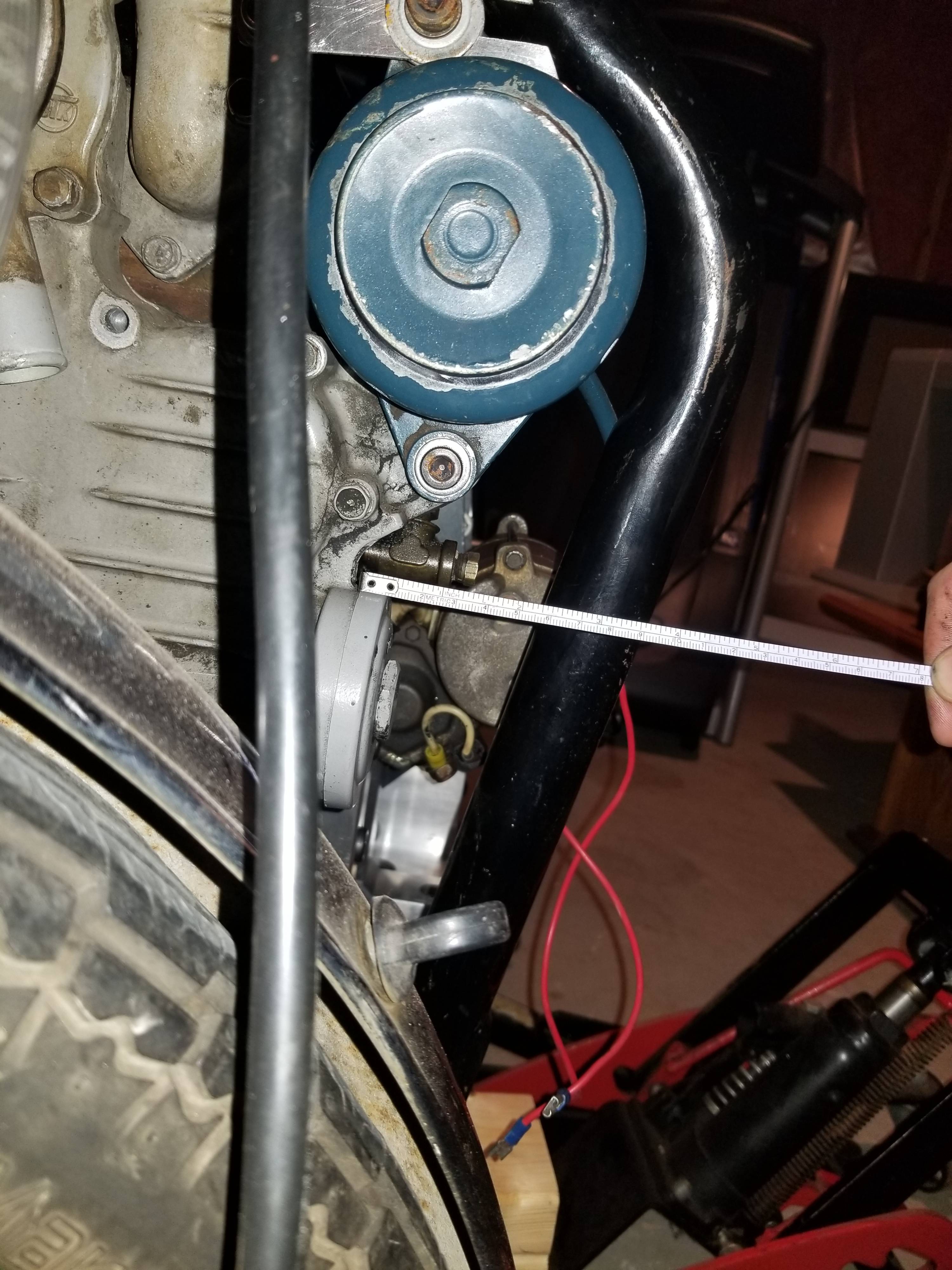

Fully slid forward
Exhaust side mount past vertical tube. 2 1/8" clearance at top of cap to tube, 1 7/8" clearance at middle of cap to tube where filter is the widest. My filter is 3" diameter.
