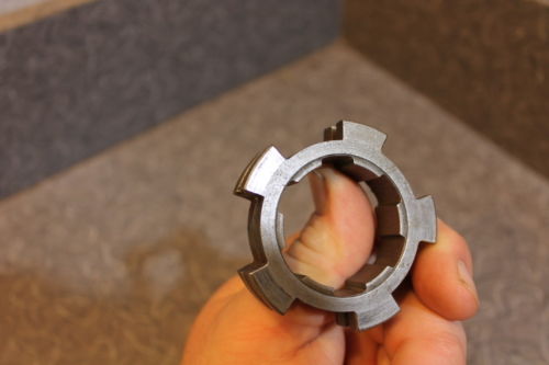

Trans is working good now, it was kind of frustrating that it kept jumping out of gear on the maiden voyage, just after you left I pulled it out and tore it down, turns out when I rebuilt it earlier I put the 1st 2nd gear slider in backwards, the pic doesn't show it but the teeth are beveled in one direction, so if you let the throttle off it jumps out of gear, I just picked the bike up in Victoria today from a ICBC claim centre, they had a guy over from ICBC in Vancouver to do a visual for the paper work, next step now is wait for a call from the bike shop that is going to be doing the inspection and installing the VIN tag, once they get it from ICBC. The Royal Enfield was just a matter of replacing the leaky float and mastering the start procedure. I just added pics as usual? Bell intercoolers was a nice place to shop, their web site is easy to use, pick your core size, then tank ends, inlet / outlet sizes, they send you a blueprint before you commit, the exchange and shipping sucked though. Any time your out this way again make to let me know and this time I'll take the ride up Island. Cheers.

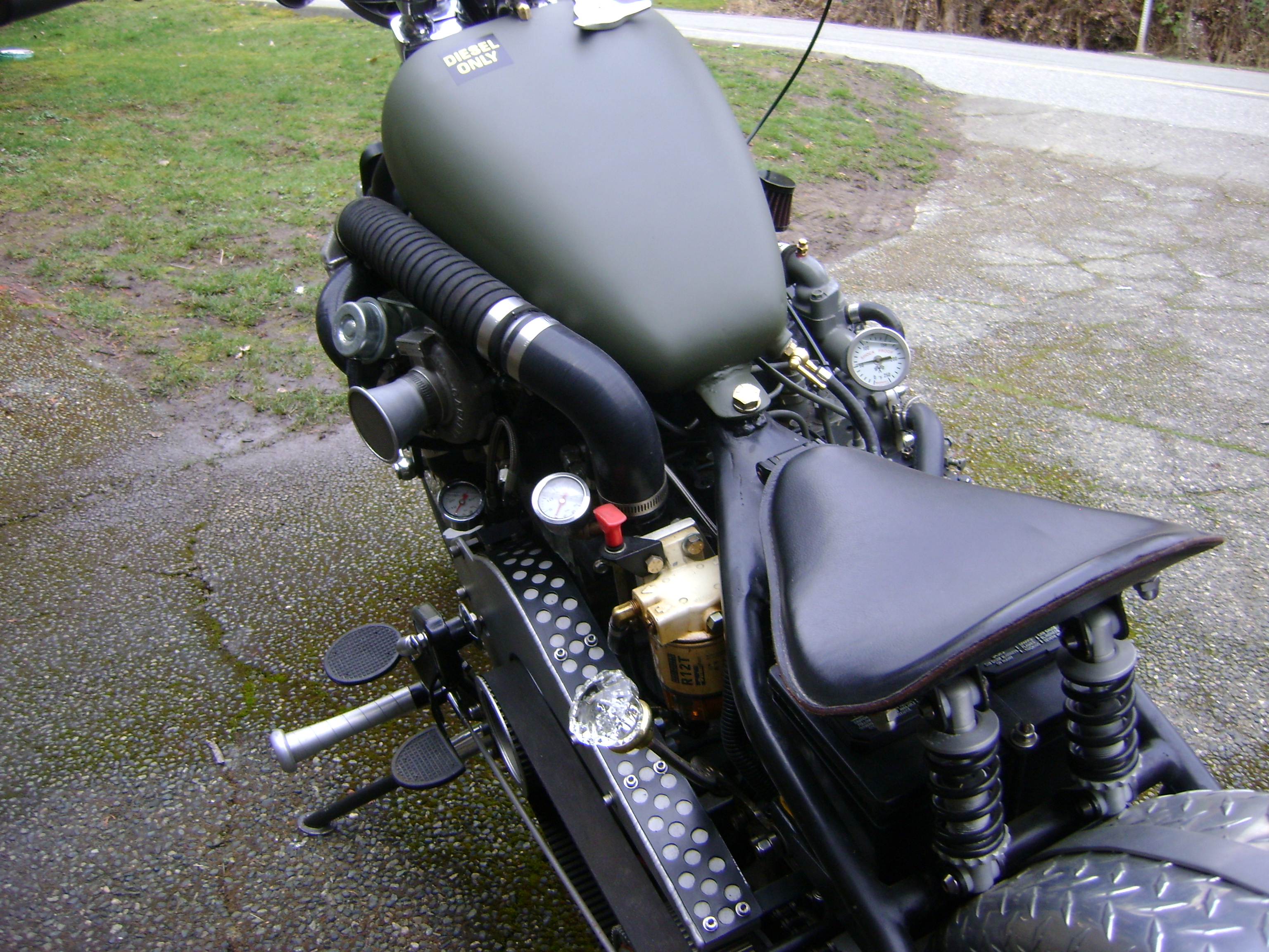

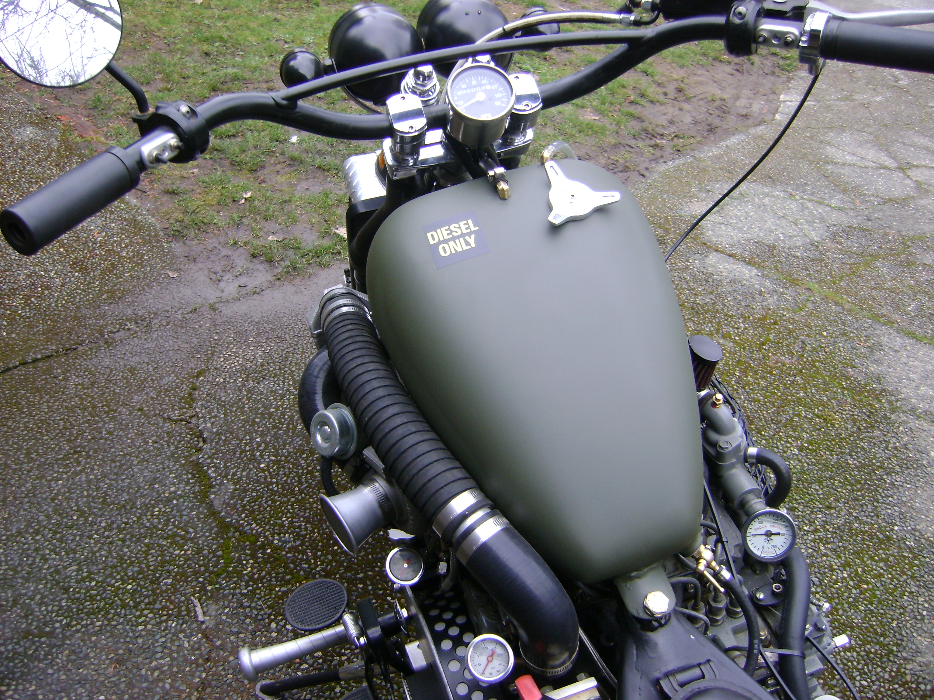

Did some tank work, added a Mooneyes aluminum gas cap, had to put in a threaded bung for it and seal up the other cap, also added the viable fuel guage, and a fancy brass fuel tap. and changed the intake hose along side the tank, the old silicone turo hose flattened as it curved along the tank...drove me nuts to see that.

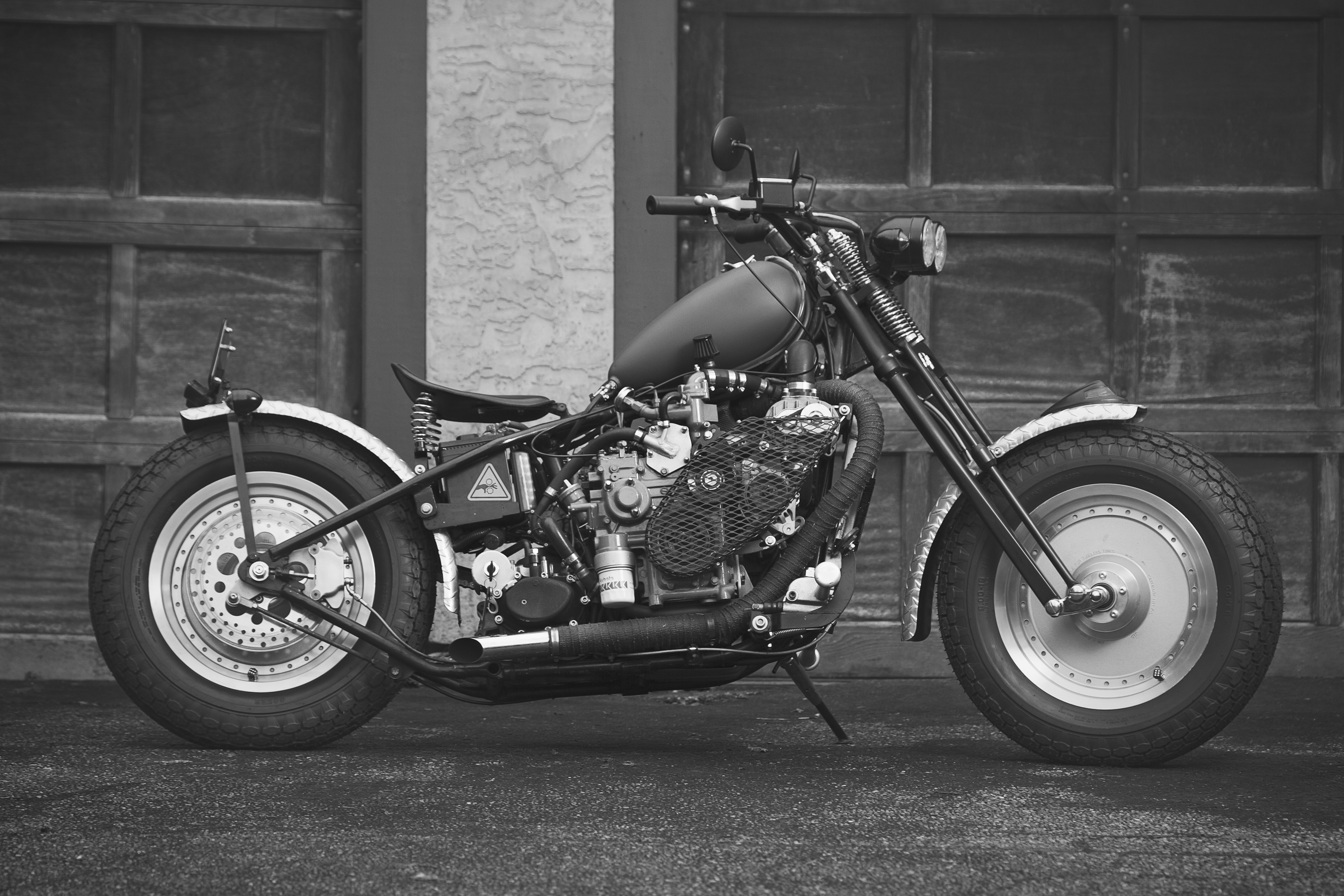

A buddy did some pictures for me
