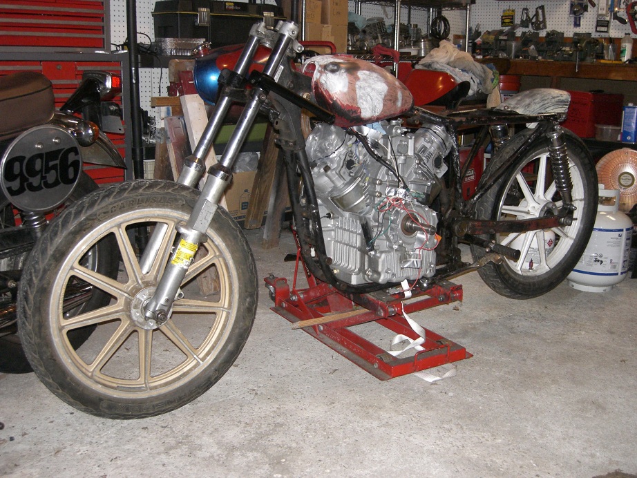

During the summer, work has slowly progressed on the second diesel bike. The first major milestone was installing the welded motor mounts on the Sportster frame. I hit a snag when a hidden rotten section blew through, but I was able to clean it up and cover it with a welded patch.

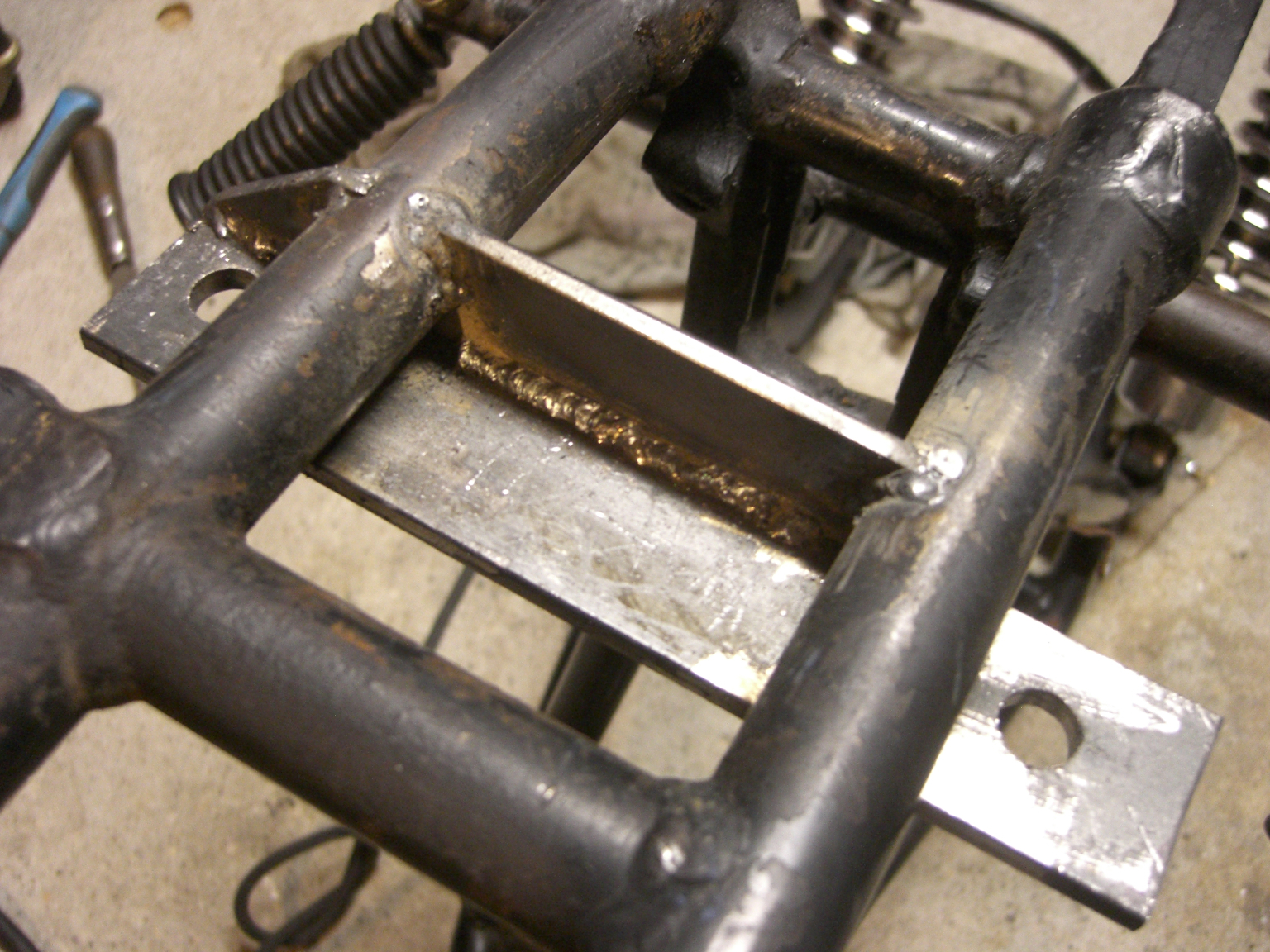

The next step of the project was to fabricate and install the front engine mounting plate. This required a bit of headscratching, because it was necessary to carve a clearance into the engine block, in order to avoid modifying the front frame bend. As a result, the frame had to pass THROUGH the mounting plate.
I accomplished this by machining a pair of slots into the plate that allowed the tubes to pass through. Next, I welded a brace underneath the tubes that joined and strengthened the three edges of the plate.

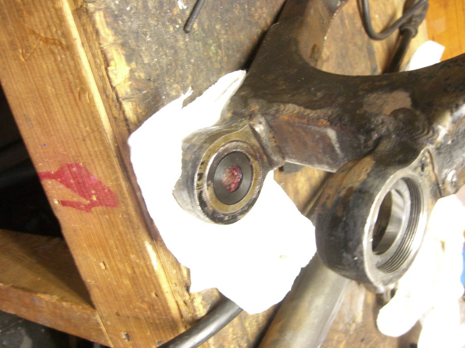

After the frame was finished, I replaced the wheel bearings with a set of homemade tools. I took the opportunity to upgrade from the old two-piece tapered bearings to single-piece ball bearings.

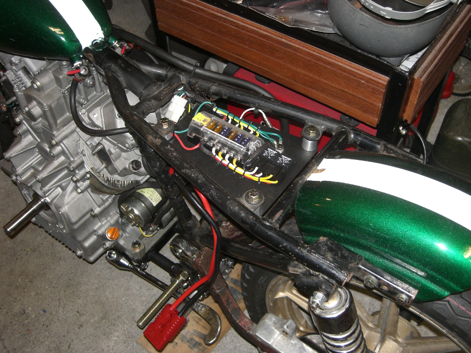

The engine in the Diesel Sportster is 3 times larger than the engine in my first bike, so it requires an electric starter and a fuel pump to operate correctly. It also has a heavy-duty solenoid that holds the governor open, and snaps closed to shut the engine down when the kill switch is used. These are all relatively high-amperage systems, so a single fuse and normal switches were not enough to safely control them.
For the electrical system, I used a marine-grade 6-fuse block and a pair of automotive relays. The fuses protect every individual circuit which will simplify troubleshooting, and by using relays I can avoid sending high amps through the relatively fragile handlebar switches. All of the wires are color-coded, with yellow wires for the starter system, white wires for the governor solenoid, red for main power, black for control switch power, and green for ground.
The fuel pump is another marine-grade unit which is rated for most types of fuel, including biodiesel.

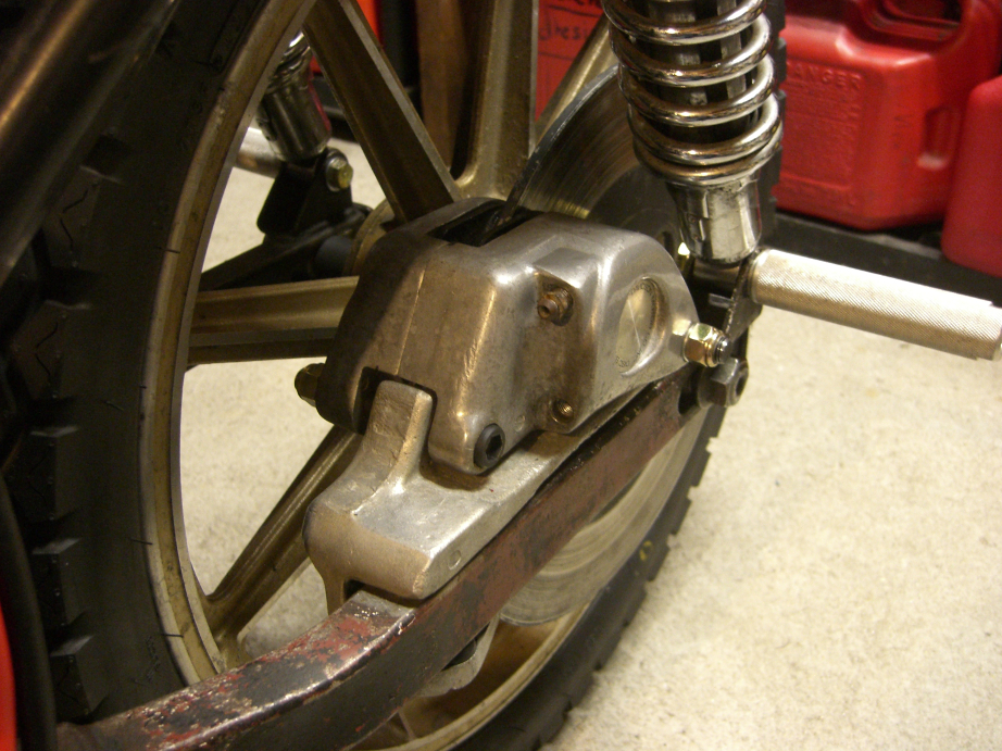

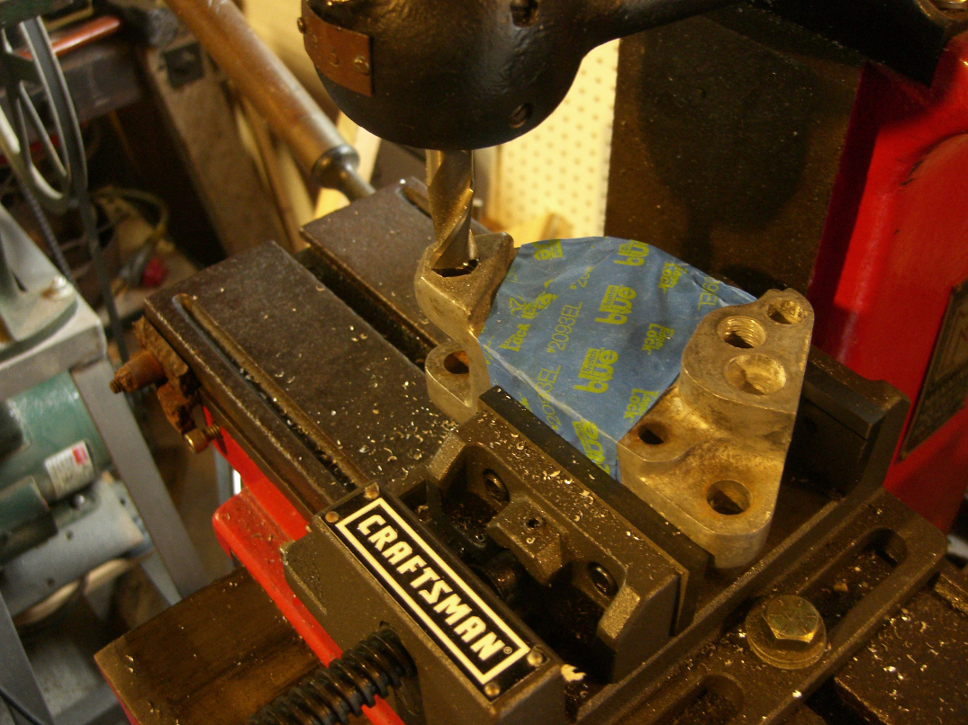

Now that starting was done, it was time to focus on stopping. The original Harley calipers suffered an extreme design flaw. The bolts that held them to the swingarm screwed into nuts that were captured in hexagon-shaped holes in the alloy caliper body. Unfortunately, when these need to be removed and rebuilt, the bolts have inevitably seized from rust and the nuts tear open the hexagonal holes, wrecking the casting and making it impossible to tighten the bolts correctly during reassembly.
The caliper I purchased (for cheap) of course had been discarded because of this damage. I drilled out the old shoulder bolts, milled the hexagon holes round, installed steel spacers to keep the new nuts from gouging into the alloy caliper body, and installed modified 7/16 diameter socket-cap bolts and locking nuts.

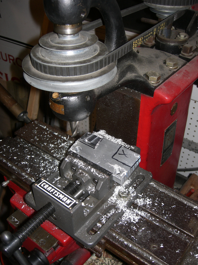

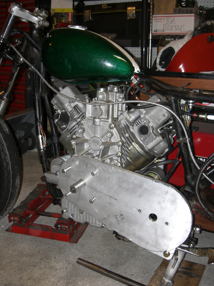

The transmission mounting plate is one of the most important pieces of the entire motorcycle, and took 3 weeks of planning to properly fabricate. I do not have access to CNC machinery or a large mill at the moment, so it was necessary to manually carve the plate using a band saw, a drill press, assorted hand files, and a block sander.
The plate must perform several functions. Most importantly, it serves as the mounting surface for one of the countershaft bearings. For the CVT transmission to work correctly, the center-to-center distance of the two shafts must be set to a precise dimension (in this case 9-3/4 inches). Therefore, the placement of the bearing block on the plate, as well as the plate's mounting location on the engine block, are crucial.
Additionally, the plate acts as a major structural component. On one end, it is tightly bolted to the engine block. On the other, it is fastened to a large threaded rod that is mounted in the central frame casting. This is extremely important, because it allows the force from the engine to be transferred through the heavy aluminum plate, rather than through the frame tubes. It also improves the rigidity of the whole chassis.
Step 1 - Layout the overall dimensions on the material.
My "Manual CNC Machine"
Step 2 - Begin carving outer shape, and drill layout holes. Use 1 inch holes for the shafts so that the plate will accurately locate on the crankshaft
Step 3 - Locate the plate on the crankshaft, and determine the position of the hole for the large threaded rod.
Step 4 - Drill hole for threaded rod, and finish carving the rough shape.

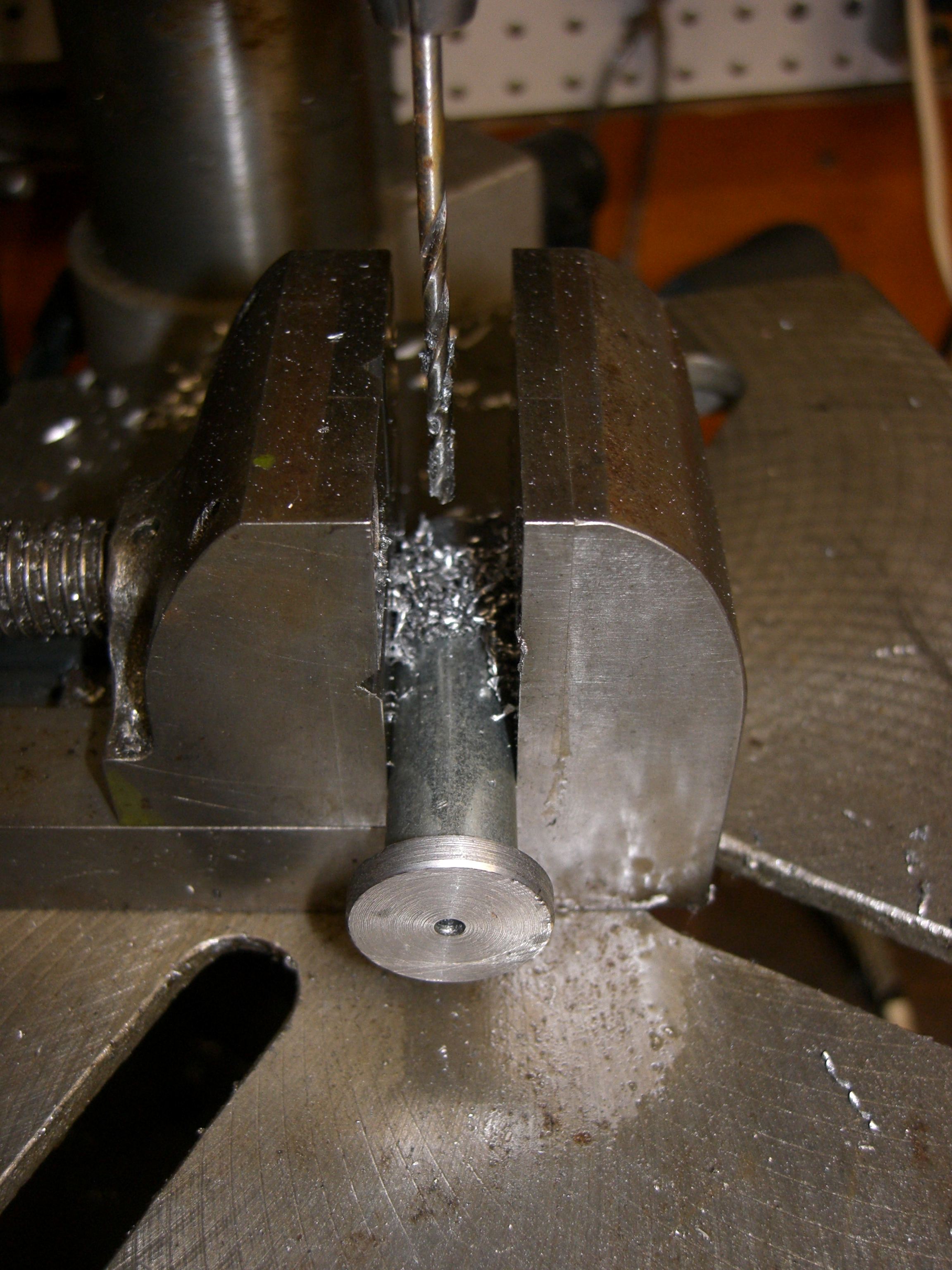

Step 5 - Prepare threaded transfer punch.
Step 6 - Install the threaded transfer punch in each engine-block bolt hole to be used, and hit plate with a hammer to punch the locations for the bolt holes to the plate.
Step 7 - Mark out the locations of the mounting holes
Step 8 - Drill and test-fit the mounting holes.

The main drivetrain bearing is mounted to the central frame casting on a pair of machined aluminum blocks. This bearing had to be perfectly aligned to ensure that the secondary shaft was perfectly parallel to the engine's crankshaft. Additionally, the bearing must be strong enough to support the full force of the engine's power while transmitting to the rear wheel.
I made the bearing blocks out of 6061 aircraft aluminum and assembled the parts using automotive suspension-grade flanged bolts and nuts.

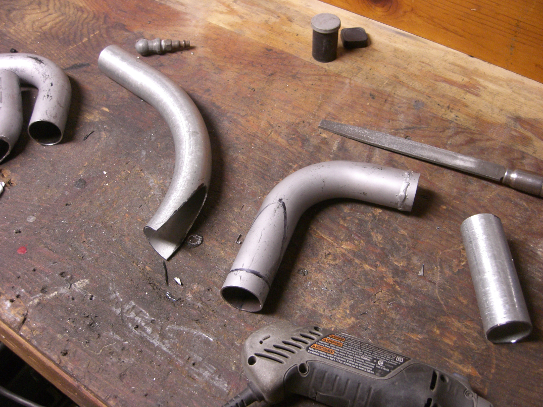

I decided to build a 2-into-1 slash-cut exhaust (which is to say, I had just enough leftovers to make it work, and I'm feeling cheap after shelling out for the CVT transmission).
This is my first attempt at building an entire exhaust system by myself, so the welds are snotty, the whole thing was made from leftover scrap pipe, and ultimately I covered the whole thing in fiberglass heat wrap to hide my shame. Here is the whole process in its gory, splattery detail!
