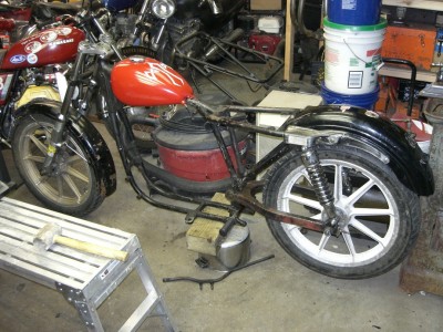

I've started collecting the major parts for the next land speed racer project. I have no intention of making this one road legal, it will be specifically set up for speed. No front brakes, no lights, nothing that doesn't need to be there. The donor bike is the carcass of a 1979 Harley Davidson Sportster that I picked up on Craigslist. The bike had been stripped for a chopper project, so I picked up the forks, frame, swingarm, and gas tank. I am going with a Harley because of the enormous space for an engine in the frame. It will give me plenty of option for engine, transmission, and turbo/supercharger combinations.
After I brought the bits home, I discovered that a small peanut tank I had purchased years before was a perfect fit. I traded the stock tank back to the previous owner in exchange for the correct rear fender struts.
I also machined some bushings so I could install a pair of shocks that I had laying around. They had come from a different model year and used larger bolts, so I modified them to fit.
Finally, I temporarily installed a spare wheel to make it easier to move around the garage.

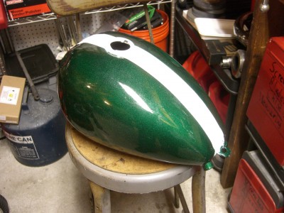

I've been at this on and off for too long, and now I've got all the major parts gathered up. Time to kick this build into gear.
The tank was sandblasted, and I then had it powdercoated. This should resist staining from leaking fuel.

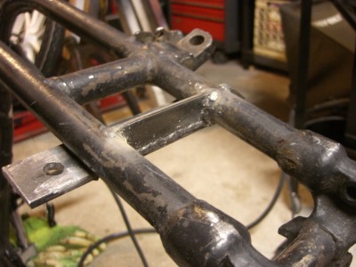

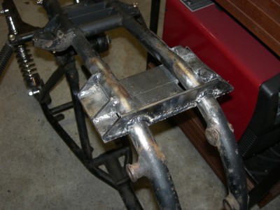

Progress pics from fabricating the rear motor mount. First time I've done serious welding in a long while, so it's a bit rough. Gonna have to do a lot of grinding!

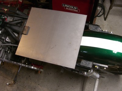

The next step of the project was to fabricate and install the front engine mounting plate. This required a bit of headscratching, because it was necessary to carve a clearance into the engine block, in order to avoid modifying the front frame bend. As a result, the frame had to pass THROUGH the mounting plate.
I accomplished this by machining a pair of slots into the plate that allowed the tubes to pass through. Next, I welded a brace underneath the tubes that joined and strengthened the three edges of the plate.

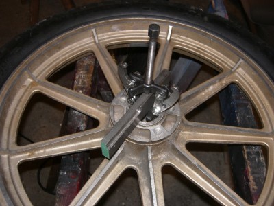

After the frame was finished, I replaced the wheel bearings with a set of homemade tools. I took the opportunity to upgrade from the old two-piece tapered bearings to single-piece ball bearings.

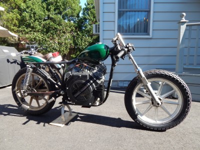

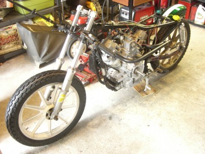

I am jumping ahead a bit, but here is a quick status picture

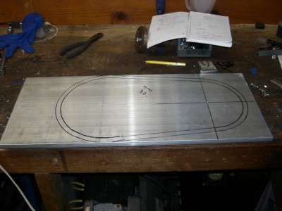

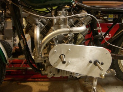

The transmission mounting plate is one of the most important pieces of the entire motorcycle, and took 3 weeks of planning to properly fabricate. I do not have access to CNC machinery or a large mill at the moment, so it was necessary to manually carve the plate using a band saw, a drill press, assorted hand files, and a block sander.
The plate must perform several functions. Most importantly, it serves as the mounting surface for one of the countershaft bearings. For the CVT transmission to work correctly, the center-to-center distance of the two shafts must be set to a precise dimension (in this case 9-3/4 inches). Therefore, the placement of the bearing block on the plate, as well as the plate's mounting location on the engine block, are crucial.
Additionally, the plate acts as a major structural component. On one end, it is tightly bolted to the engine block. On the other, it is fastened to a large threaded rod that is mounted in the central frame casting. This is extremely important, because it allows the force from the engine to be transferred through the heavy aluminum plate, rather than through the frame tubes. It also improves the rigidity of the whole chassis.
Step 1 - Layout the overall dimensions on the material.
My "Manual CNC Machine"
Step 2 - Begin carving outer shape, and drill layout holes. Use 1 inch holes for the shafts so that the plate will accurately locate on the crankshaft
Step 3 - Locate the plate on the crankshaft, and determine the position of the hole for the large threaded rod.
Step 4 - Drill hole for threaded rod, and finish carving the rough shape.

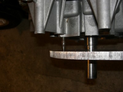

Step 6 - Install the threaded transfer punch in each engine-block bolt hole to be used, and hit plate with a hammer to punch the locations for the bolt holes to the plate.
Step 7 - Mark out the locations of the mounting holes
Step 8 - Drill and test-fit the mounting holes.

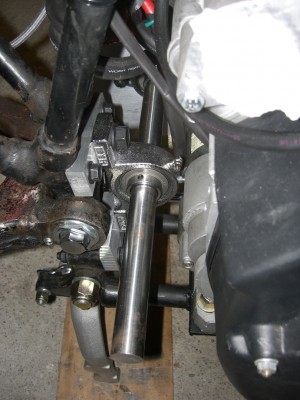

The main drivetrain bearing is mounted to the central frame casting on a pair of machined aluminum blocks. This bearing had to be perfectly aligned to ensure that the secondary shaft was perfectly parallel to the engine's crankshaft. Additionally, the bearing must be strong enough to support the full force of the engine's power while transmitting to the rear wheel.
I made the bearing blocks out of 6061 aircraft aluminum and assembled the parts using automotive suspension-grade flanged bolts and nuts.
