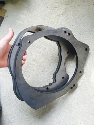

Feel free to grab this drawing guys as it was used to laser cut my plates. They are on a raw state & will need a tiny amount of filing to fit I'm sure. Also dowl points x2 have yet to be opened out on the gearbox plate.
My project isn't being made public on here in its entirety as it's taking too long etc but things like this may help inspire others to crack on. Please grab the drawing, just in case! FYI my engine plate is 6mm & gearbox 8mm thick.
As you can see, I had 2 of each cut

Here are the plates coming together with the bell housing. Close to finishing this part so will get another shot up when I have.

Hi Stuart,
How thick is the bell house plate, and most important, the width of plate, e.g. the distance between the adaptor plates.

Gearbox plate = 8mm
Engine Plate = 6mm
Bell house thickness = 10mm
Bell house length = 111mm
I'm sailing close to the wind to get full starter motor engagement on the flywheel/BMW clutch clearance. Anticipate having to remove more metal.
Wish I hadn't had the Gearbox plate holes laser cut out at M8 (same as gearbox fixings) as I'd like to have screwed into that plate. Opening up gearbox holes to M10. The two keyway holes will have to stay at M8.
