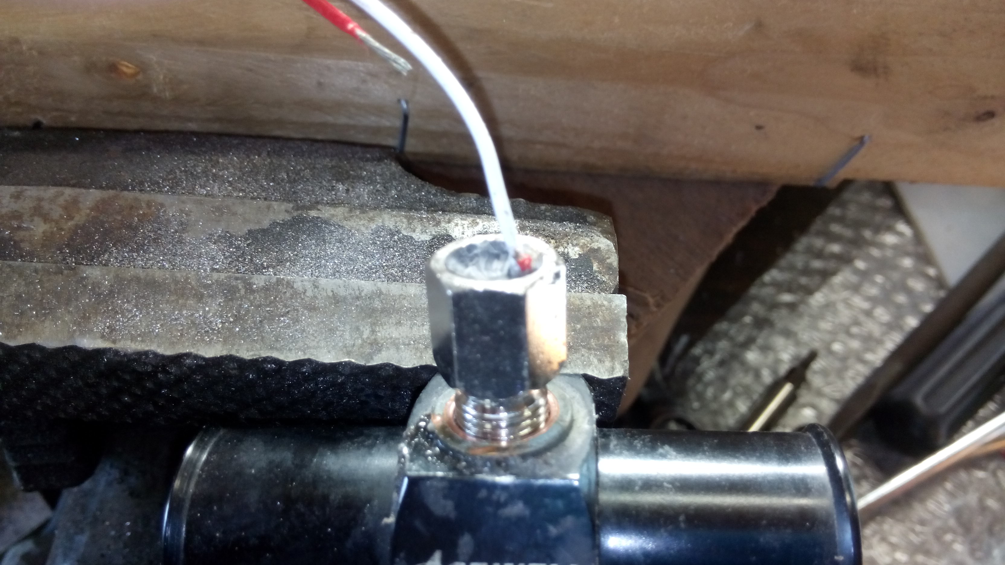

After 10km's on the road i noticed this:
I went home again to find the problem.
So the afternoon was spend trying to find the cause and fixing the temperature sensor.
The broken wire was soldered and covered in heatshrinktube and silicone sealant.
And finally fitted it together again.
Apparently the silicone coolant hoses can be fixed by applying a small amount of silicone sealant. I'll see how long it holds.
I then went for a evening ride and the bike runs well for atleast 100km now. So i'll check it tomorrow in the light again.

I had to redo some connections because i lost a coolant hose connection hehehe.
And solder/insulate the broken temp indicator wire.
