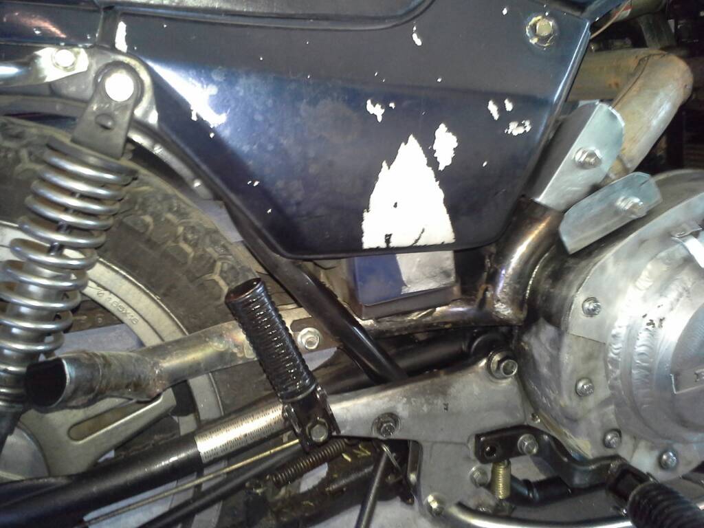

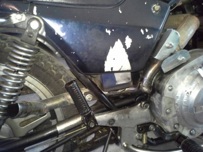

I have a nice long intake on mine so as to keep it quiet and my exhaust is just a straight pipe.
I have a lot of extra weight on mine and a top box as well which probably affects economy. I still think they are pretty good on fuel. If their fuelling was a bit more advanced though they would push 160+ I think without issue.

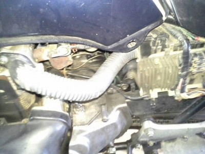

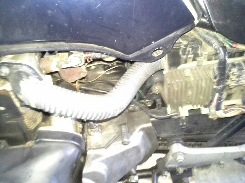

My intake pipe is about 15" long and corrugated. And my exhaust, while unmuffled was built out of one of the original Honda twin wall pipes cut and rewelded poorly at angles. I know my some had to escape through a couple of joints that maybe have an area of 1 square inch. Probably part of my problem...

I think you have pinpointed the problem.
Bigger diameter pipes may be an advantage, specially if it is 2 into 1.
I know that a convoluted hose mixes the air around, but I'm not convinced to the benefits, as there are swirling vanes in Ruggerini cylinder heads.
