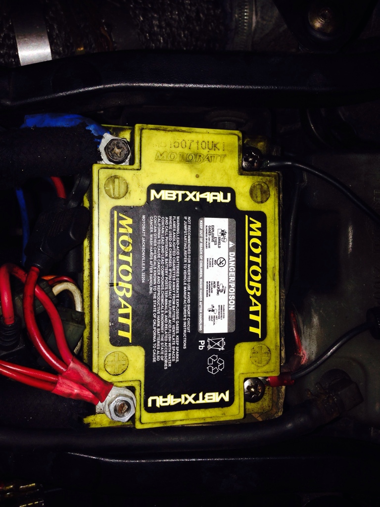

here is the Tiger battery coach. Hope that helps.

Thanx. Does the LDW1003 in the bike have glow plugs?

I have an mbtx20u in my yanclone. I could probably crank it for 5 minutes heh. 280cca and I pre heat the injector lines for 2 minutes or so before starting.
