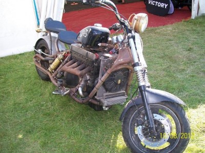

Here are some shots supplied by Ian who made it to the Bulldog Bash. Obviously the bike isn't finished & was just there for the run up the strip. I've no idea if this happened as yet.
Re: Whisker's New Build
what a beast. Guess the rider will need asbestos lined pants on the exhaust leg

The first few pics had me worried because of the size of the tank and all the pics make me wonder about the front end, it looks kinda flimsy for such a big bike?

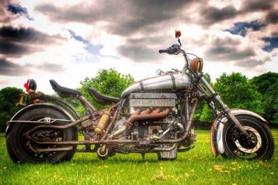

Here's a few more arty shots.
And more....

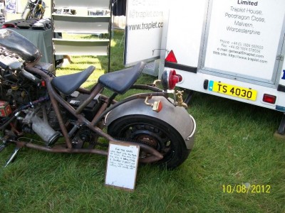

Saw Whiskers last night after he came along to a gig my brother was playing at. They are still working on various clutch ideas.
Rather smallish chain to rear wheel was only put on as tempory measure to move it at Bulldog Bash.

Love it! It's got kind of a steampunk vibe going on. Big beefy monster of a bike too.

Hi, not posted for ages but this bike is the nuts, very original, very very cool and i want one for crimbo
