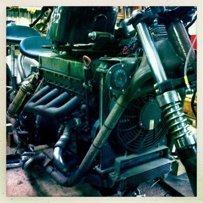

Here are some shots supplied by Ian who made it to the Bulldog Bash. Obviously the bike isn't finished & was just there for the run up the strip. I've no idea if this happened as yet.
Re: Whisker's New Build

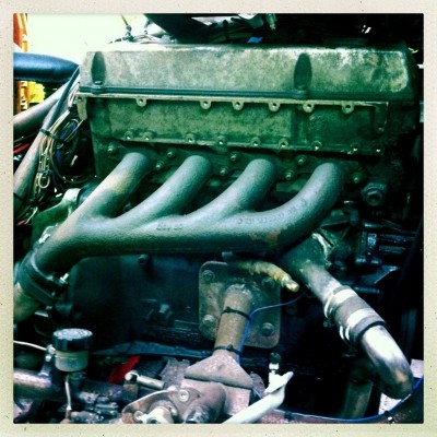

what a beast. Guess the rider will need asbestos lined pants on the exhaust leg
Whiskers phoned earlier with an update. He had clutch problems at The Bulldog and didn't get to take it up the strip. The bike got quite a bit of attention I'm told as it was parked near the entrance to the exhibition tent.
Whiskers says they are looking at perhaps going the servo route for a decent clutch action as a hand operated clutch is not very suitable for such a bike.
He further said that it's ok to ride and on pull away has the same sideways shudder that you might get on an old Beemer R65.
I will try & get some other shots soon if I can.

The first few pics had me worried because of the size of the tank and all the pics make me wonder about the front end, it looks kinda flimsy for such a big bike?

Here's a few more arty shots.
And more....

Ohh very nice! How is the drive, via the clutch to a welded diff? Is there no gearbox then :)
No gearbox just a saw bench bevel box.

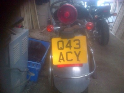

Does that tap on the rear house the license plate light then?
Yes, the bulb is in the body of the tap, not the spout.

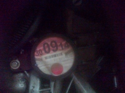

Ok! I've just heard that The Sprocket (as the bike is called) is now road legal in the UK :)
Hats off to Whiskers for attending various face to face meetings etc to finally get his machine on the road :)
A place that had to be visited in person to push things through..
