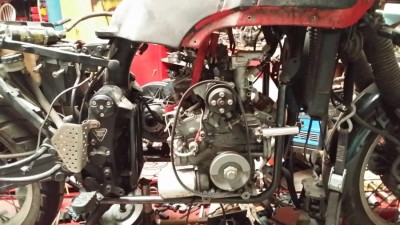

Here is the cradle tubes for the engine in mock up. These are not the actual tubes. Curtis will give more detail when time comes

Re: Kubota Charging system from scratch
few more pics from curtusCurtis in Texas wrote:Almost have the alternator ready to mount. Will post pictures when I get it done. Broke my special little sander I need to finish it. Looks like I'll be buying another little belt sander. No surprise, because I've abused this one for years.
Alternator housing slotted to create a tightly tucked close into the engine alternator. This is pivot point for adjustment. Mounted to OEM tab on block (tab end modified slightly for clearance). Pic is shot from above with alternator swung out wide on pivot point created with this slot
Front View. Note the Alternator housing's mount tab sitting closest to block. This will be the one utilized for belt adjustment setup. Will at some point cut off 3rd mounting point on the Alternator housing to keep nice clean lines and unnessisary width
Just enough room for Headers. Note how using the Triumph Alternator end cap puts the breather holes toward the bottom where the Suzuki were more exposed to the elements. But then again. Ground muck kicks UP off the tires while clean rain kicks down... hmmmm. so maybe Suzki would be better after all??

Alternator almost done. I want to build a brass insert in the engine tab for the bolt to ride on since the tab is aluminum. Here's the Alternator with the new belt on.
It will work like this but for a longer trouble free life I think the bronze bushing will be just the ticket.
Here is the adjuster I made out of aluminum.
Doesn't look like much in the picture, but I milled it out of solid 1/2 inch aluminum plate. Might anodize it before we ride the bike! Then it would look a lot better.
AND, I might still cut that extra mounting hole off of the alternator. But I think I'll wait to see if it causes a problem once we start mounting the engine in the cradle. FYI the alternator sticks out just a little more than the starter motor, measured off the face of the block. And I"m only talking about 1/2 (26 MM), so I don't see it as being a mojor obstacle.
So George, we can pretty much call this problem fixed. Well, we do have to test this alternator to see if it's going to work, but, even if it doesn't it will just be a matter of getting it rebuilt.

Curtis got side tracked a bit with beautiful results. He was hired to build some racks etc. for a set of bikes on there way to do some exploring in Alaska if I recall right. Here is the results of one part of the project.
He's back at the Tribota now. Experementing with brackets to mount jackshaft to engine and making of a Stub shaft.
First was making a centering pin that sits in the pilot bearing hole in the fly wheel to ensure everything stays centered as being made. From there some round plates will be cut out and made to screw into the flywheel clutch bolt holes Primary Clutch in the lathe. The white hub will get basterdized for part of the stub shaft building. the black collar on back of the Clutch will be ground down. It is only needed for the orginal OEM application of that clutch (a UTV) Newer bolts in the flywheel shows that the plate shaft gets welded too will be about 5"? diameter (flywheel is 8.5"). The actual stub shaft will be keyed and it too will be milled down like the centering pin above so part of it will sit in the pilot bearing hole in the crank. This will give it more strength. The stub shaft will be designed to get that Primary clutch tucked in as close to the flywheel as possible.
Side note. Keyed shafts (jack and stub) along with ecentric locking pillow blocks for the jack shaft (7/8") are in shipment so some of this will have to wait

Some images of Sub frame/Engine Basket. Decision was to do to go this route and not keep the hanging engine structural member of the OEM. Decided this to make it easier to help isolate the vibrations from OEM frame and rider to increase comfort and reduce vibration stresses to the OEM product not designed for them. Engine will be mounted on isolatng mounts within the Basket. Trying to put isolating mounts into the hanging OEM engine design would negate it being a structural unit it was intended to be by OEM. We didn't want to go and open that can of worms though it might be a years down the road it becomes an issue..
All kudos go to Curtis not me. Im a humble bystander

Curtis tried to post up more info about above but got logged out automaticaly somehow and lost his hole post in never never cyberland. If anyone has any idea why this keeps happening to him please speak up. On average he's only been able to respond, or post here randomly for a long time due to this same issue. Usually the random is when it's something meaninfull of course. Go figure.
Anyway more on the basket on and...... also in the plan is that the basket can be dropped and/or tilted down for easy engine assess etc.
