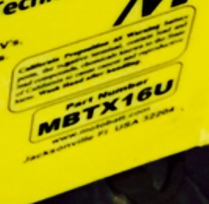

Using one of these on the Tiger.

Stuart wrote:Using one of these on the Tiger.
Thinking of my Tiger. Do you have that battery in stock location? Need any mods to fit it in there if so? Feel free to PM me so not to hijack this fellows thread
touchwoodsden
Posts: 224
Joined: Sat Oct 24, 2015 2:20 pm
Location: North Wales, UK
Re: Battery Cranking Voltahe Help...!!!
Post by touchwoodsden »
Thanks Stuart.
The dimensions of yours MBT16XU are 151 X 161 X 81
the dimensions of the standard BMW (which would be MBTX30U) are slightly larger at 166 X 175 X 126..
Therefore, if the one you're using is okay, I'm certain that I can get away the size of the original battery albeit that I might have to go for a higher spec in the same size.
So I'll answer Coach here. That battery is actually bigger than the original Neil put in my Tiger. In between I tried the new Lithium with wasn't up to it on cold (June!) mornings at the rally [SMILING FACE WITH SMILING EYES]. But I'd had to enlarge the compartment slightly for the Lithium and found I could get the better & bigger Motobatt in. A few more amp hour on that.
