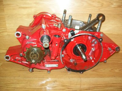

the shaft rotation is anti-clockwise as viewed in this second picture.

my daughter's 50cc pee-wee in the background of pic 2 is also a no-no :lol: .

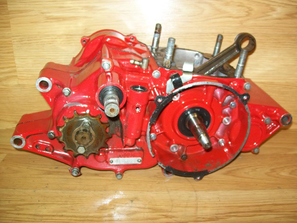

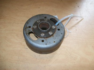

Next, could one drill out the rivets on the magneto flywheel crankshaft hub (or call it what you will) and bolt/rivet the driven sprocket/pulley to it instead. Or is it too small to take the torque?

Hi Ron... that engine looks perfect for my needs, but ATCs never really took off over here.... The Rotax 350 lump is similar, and yes I do plan to stand in on end!
Matt
