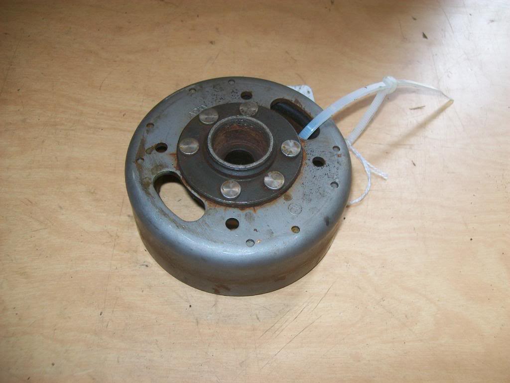

got the yanmar L100AE.
Many thanks to Neil (Sserpent) for the sale.
the shaft rotation is anti-clockwise as viewed in this second picture.
